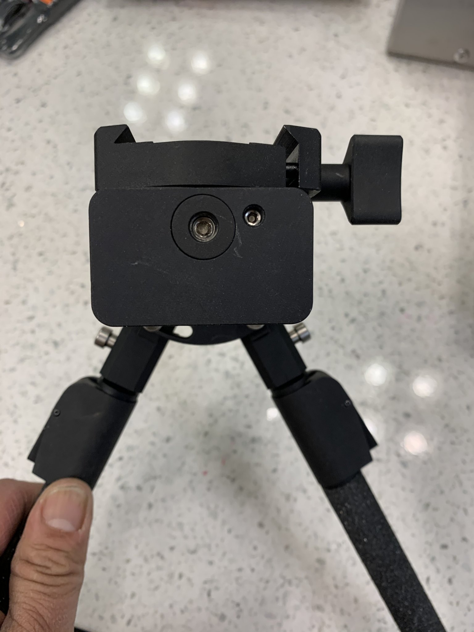

Heres’s the difference i noticed from my buddy’s gen 1. I havent held a gen2 in my hands so cant compare to it. I ordered and paid for a gen 1 blem
Reactions: MDT_Josh
If thats what you got, I'm excited to see what they sent me. Seems like you have a gen 2 but with an old style cant lever adjuster. Id take that since you can lock out pan and get more stability.
Thats actually the Short Action Precision cant lock. I bought it before the ckyepod arrived knowing most everyone replaces the stock cant lock. It came with the large metal knurled knob thats actually quite good
To clarify, that is a Gen 1.5 ;) You have the Gen1 legs, wings and hub but the locking pan feature off of the Gen 2!

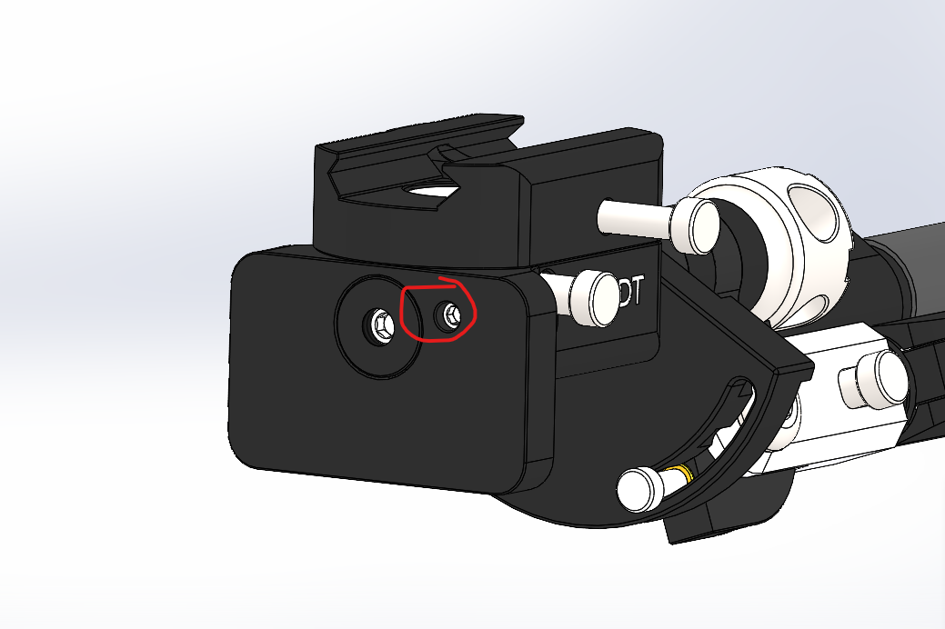

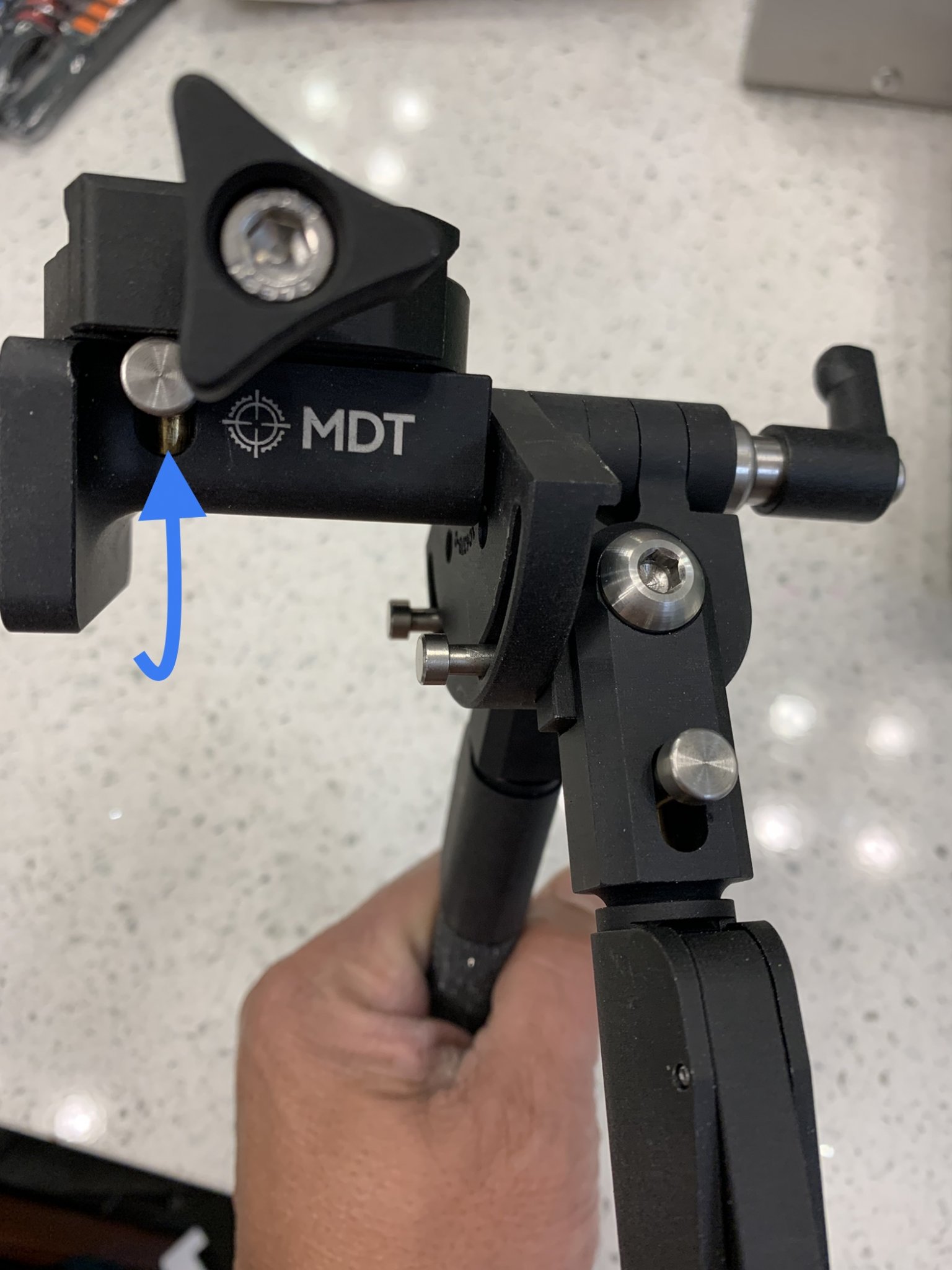

Someone who knows more can probably weigh in here but I messed with the set screw immediately “above” the detent pin. It seemed to help.
I messed with that but that screw sets tension for panning and to be able to lock and unlock the Detent on mine the panning tension becomes nonexistent.
So got my gen 1.5. Does anyone know how to adjust the detent pin to be less stiff to lock and unlock panning? Mine is currently ungodly tight to manipulate.
This little set screw is what is holding the tensioning spring on the detent in place. If you back it out a little bit with 3/32 allen key, then that should make it a little easier to manipulate. We ship them tight and with loctite to ensure that nothing backs off during shipping and handling :)
