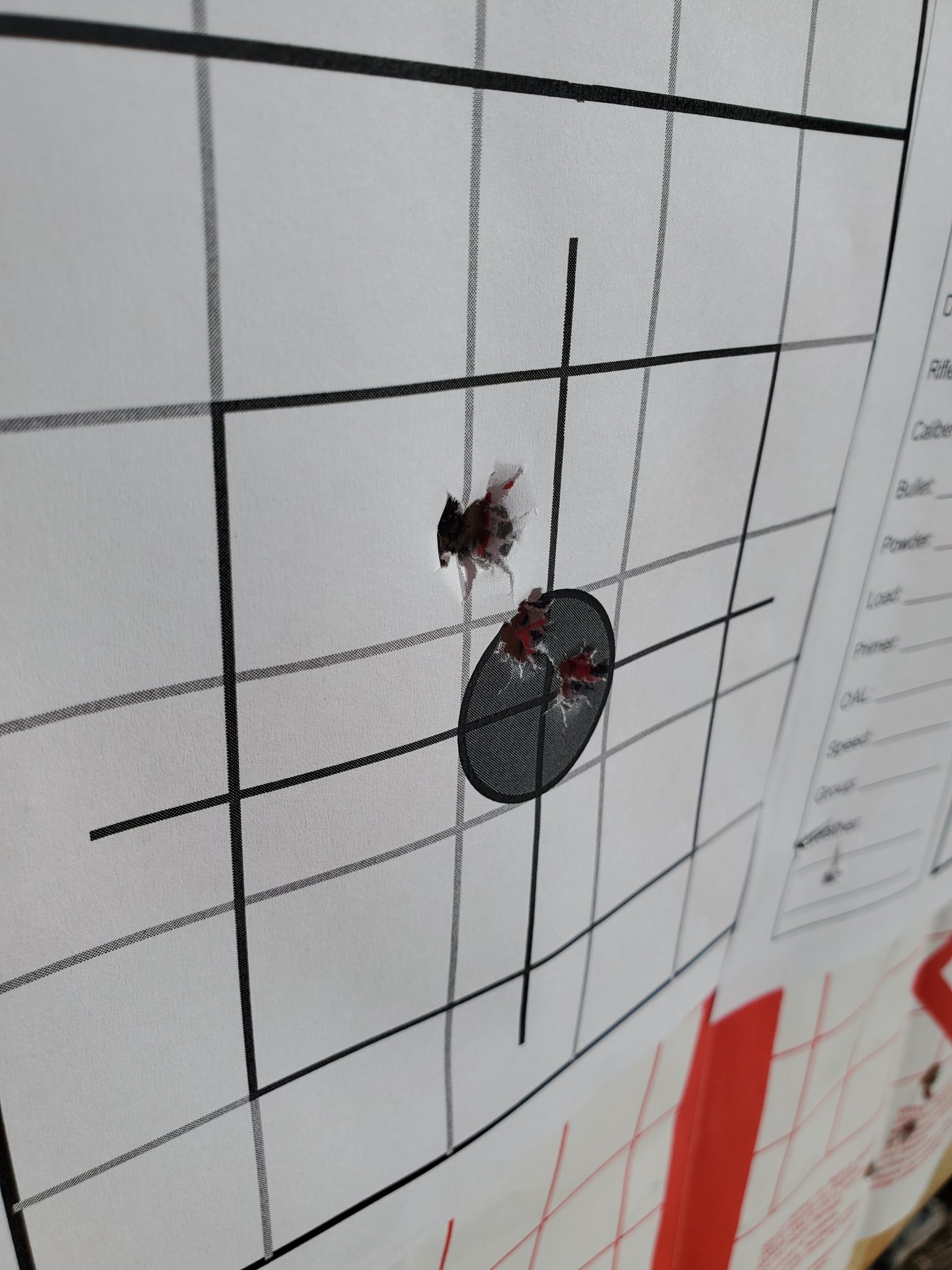

All combinations do about the same @ 100 yds on paper. About 2 MOA on a good day.

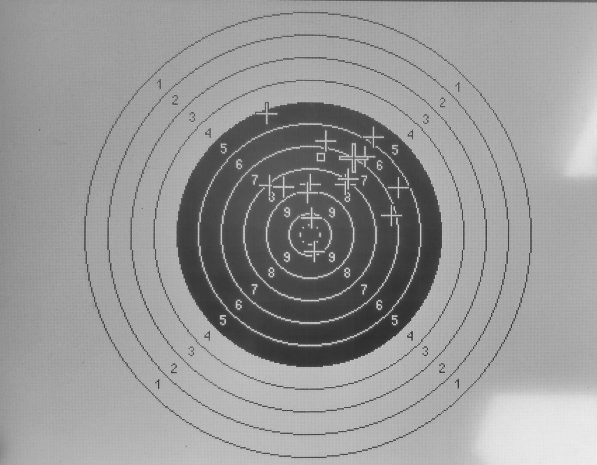

According to the original manual the rifle is succesfully zeroed if a 3 or 4 shot group lands within a 15cm circle on a 100m, otherwise it would go back to the armorer. (And at that time they were fresh from the factory) From my experience that is what you can generaly expect, after all these are weapons of war, so your main target is a minute of torso.
I guess that they put more effort / hand picked the ones that shot well for their sniper rifles but these originals are hard to come by. So a 1MOA Mosin is definitely not impossible but I would say that they are very rare indeed.

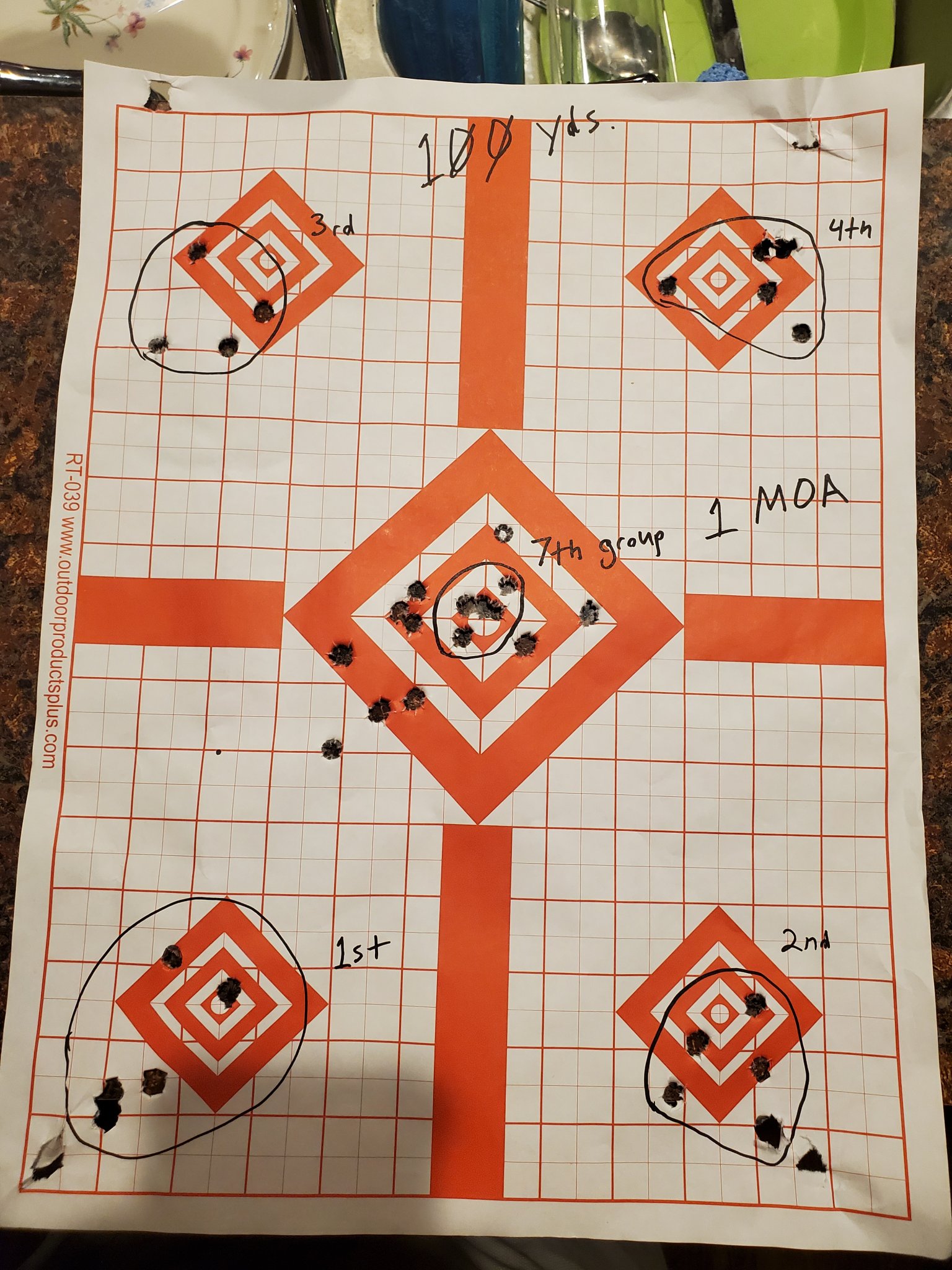

I'm not really a fan of the Mosin and I think expecting 1 MOA out of one is ridiculously high hopes unless you're restocking and floating the barrel. However I do have one Russian Mosin (and a Finnish M39 but that's a different animal) , and what I've found after shimming the barrel is they have a lot more potential than I originally gave them credit for.
Mine shoots about 2-3 Moa groups as is and I am happy with that result.

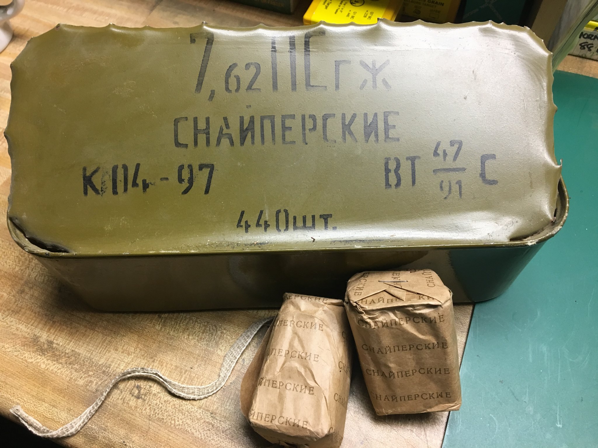

Most 91/30's were mass prepared and stored sometime after WWII. Most of them suffered from serious cleaning rod wear in the muzzle area, and the generic mass-fix was to counterbore the muzzle down to a distance that reduced the bore diameter to a reasonable size. This was a very fast and uncritical process. The end of many/most bores was a crapshoot, complicated by upwards of 50-80 years of general neglect in long term storage; cosmoline can only protect so much, for so long. Expect much corrosion where a 'recessed crown' should be.
Then there's the ammunition. The steel case/steel jacketed USSR/GI spam can ammo was purely 'cannon fodder'. It goes bang, mostly. Aside from applications like massed musketry, it was probably always substandard; and age has not improved its performance.
If you have a 91/30 that shoots 1 MOA with any ammunition, don't let it out of your sight.
Are there accurate ones? Oh yes. They tend to be battlefield pickups from the Russo-Finnish "Winter War" that were carefully researched and very dutifully rebarreled, restocked, and refurbished as Finnish factory arsenal (later to become SAKO) M-39 Rifles. Finnish ammunition is also special (7.62x53). The bores and bullets are often described as .308 diameter, which is even sometimes true.
There are also some original 91/30's that defy the odds and refuse to suck.
For general purposes, a cosmoline excavated 91/30 and Spam Can military steel case ball ammo will probably deliver accuracy in the 2-5 MOA range, or worse. As a perimeter defense rifle, it's moderately satisfactory out to 100yd.
Oh, and they tend to kick like mules. If you get into the 180gr loads, you need serious recoil protection for extended target practice (i.e. more than ten shots).

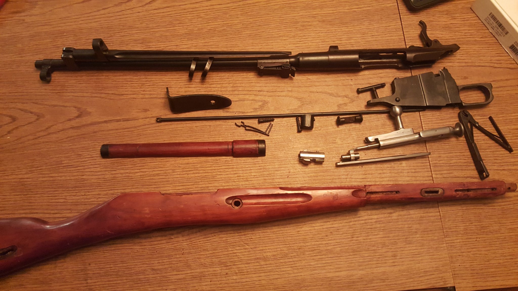

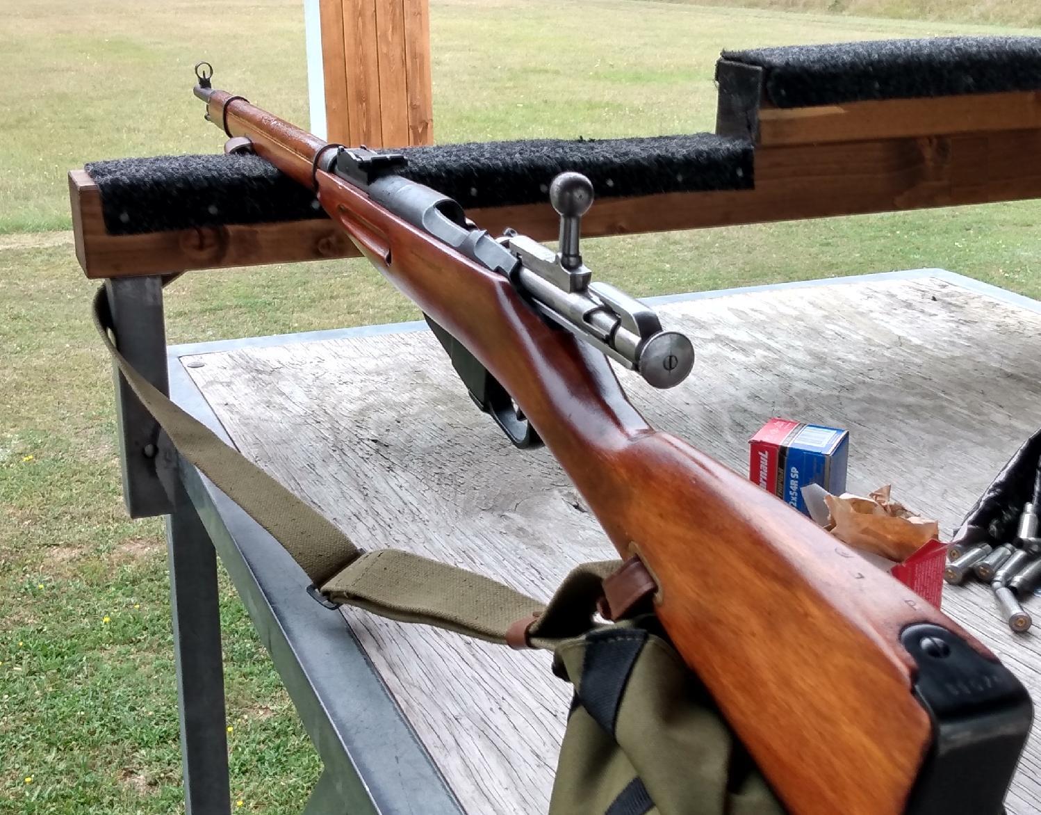

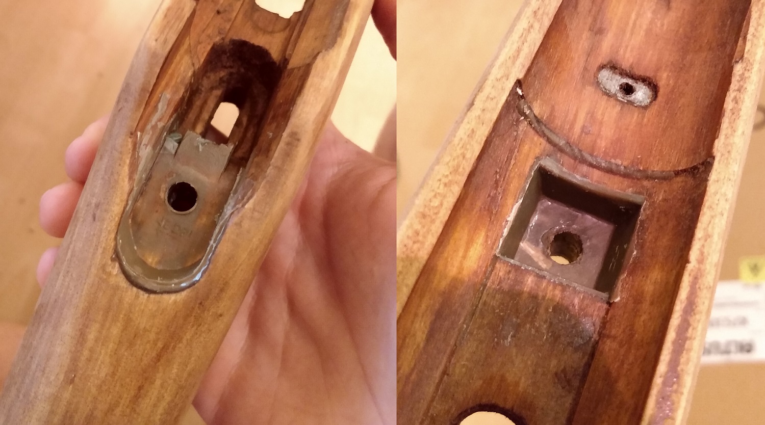

Is there a guide on where to shim the barrel exactly?
Here's the 'easy' button...
You can either order the kit or just follow the guideline on the page. I wish I'd known about this site before I went thru the hassle of cutting soda cans but I might still try out one of the guys front sights. My recommendation would be to get the shim kit (or make your own) and swap the trigger for a Finnish trigger. I still wouldn't expect a 1 MOA gun, but shimming my Mosin took it from about 6 MOA to about 2 MOA.
When I shimmed mine, I used Foamies Sheet Neoprene foam cut into 1/2" wide strips that were long enough to do one wrap of the barrel. FWIW, the 6mm sheets can be used to fashion Cheek pads.
I wrapped the shims around the barrels at two points, directly under the two barrel bands. This turns the stock into a crutch that helps support the barrel better.
This process is an effort to reproduce the wartime practice of 'corking' the barrel, which used sheet cork to do this same technique. The Smith site deals with is especially well, and is a wealth of excellent advice and components for the M-N.
The other shims, under the action, are a compensation for wood shrinkage, and can restore the stock to its original dimensions. One place where this can be especially helpful is when bolt closure while feeding a round is very rough and difficult. These shims should be made from a firm material that does not compress, otherwise, action screw torque becomes an unmanageable issue.
I did this to improve accuracy, which it did; and it also fixed the hard feeding issue by restoring the interceptor/trigger guard/magazine alignment so it worked properly again.

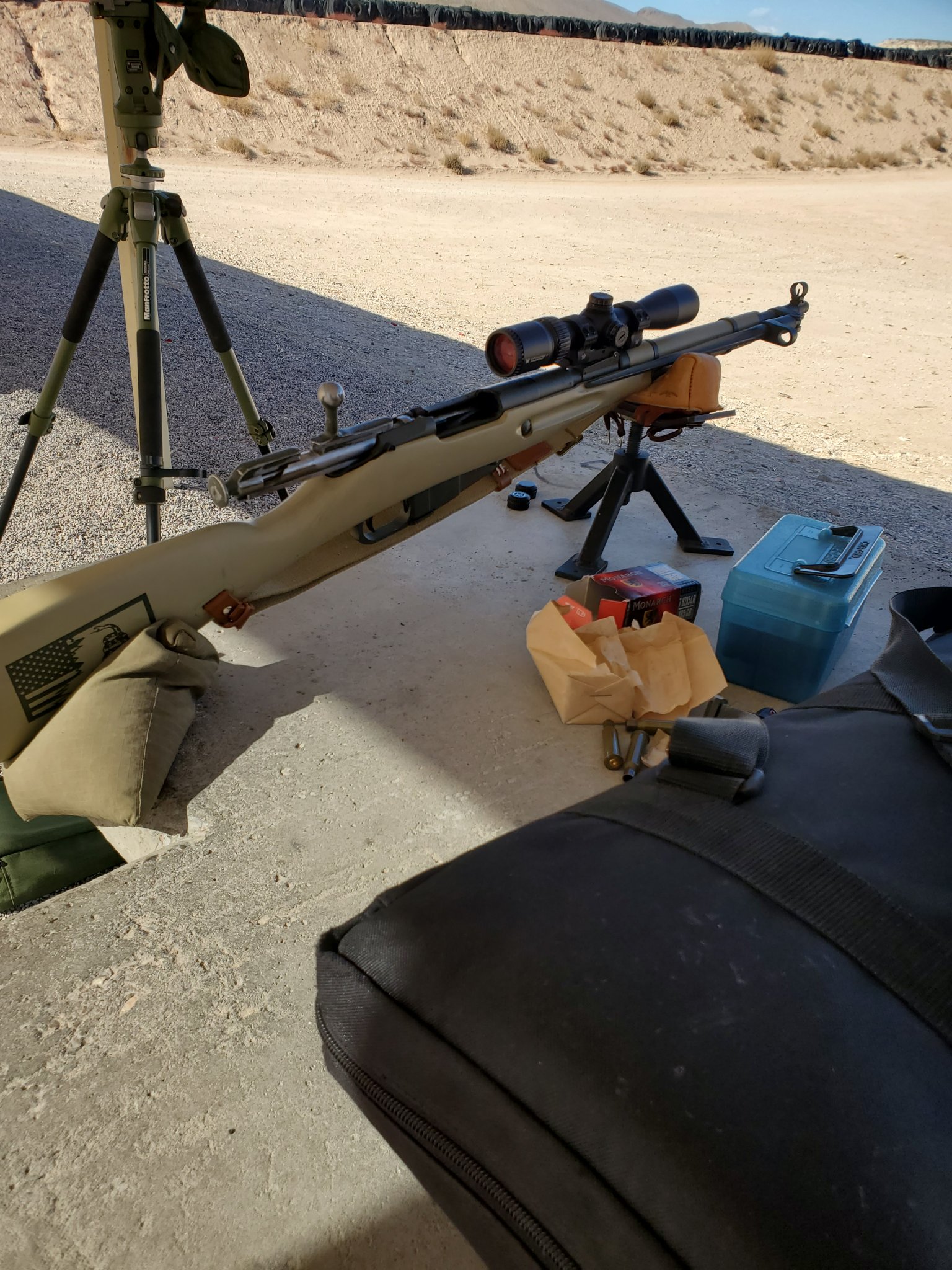

My M-N has been idle for far too long. At this point I'm down to one rifle, the rest are now in younger hands within the family. I did an Archangel stock replacement as well as a rather barbaric attempt to clean up the counterbore, but priorities overtook the project, and the rifle still awaits testing to see what, if any, improvement these latter steps have achieved.
I run the Hornady 150gr .311 Interlock in PPU brass, with 50.0gr of IMR-4064, and a CCI 200 Primer. It's a very close duplicate of my Garand load, except for the case and bullet diameter. It's a stiff load which utterly devastates the deer population, and kicks like that proverbial mule. My SIL is the scourge of the woodlots during deer season, and loves that M-N like a Baby Sister. Pay attention to primer flatness, and be prepared to back off the charge if that occurs in a serious manner. His rifle is provided with a 1" thick Limbsaver Slip-On, which improves LOP, and tames some of the kick.

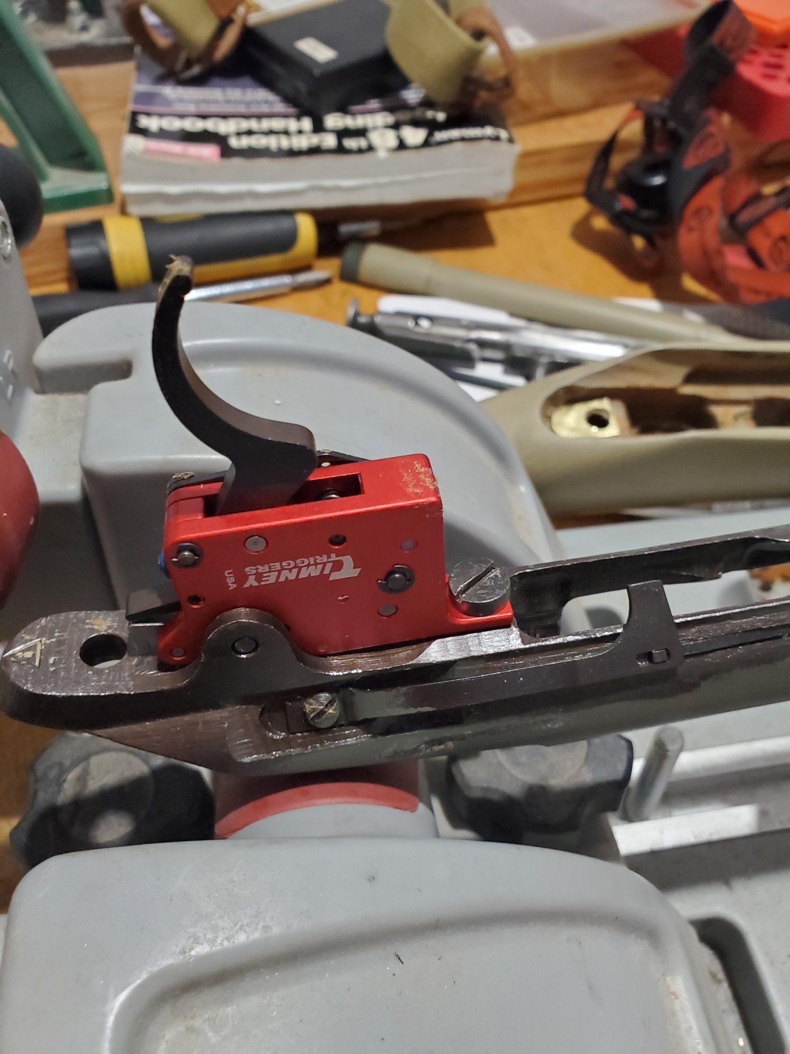

The stock fitment usually is not good, and, therefore, shimming the receiver and pressure padding the barrel are generally called for.
Additionally, a good two-stage trigger and improved sights are usually called for, as well.

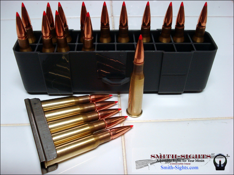

Hello,
In my not inconsiderable experience, Mosins are more than capable of shooting MOA, so long as the barrels and crowns are in halfway decent condition.
Handloads are generally essential for good precision, as well, as most surplus I've found has variable powder charges and bullet weights, even between cartridges of the same lot.
Regards,
Josh

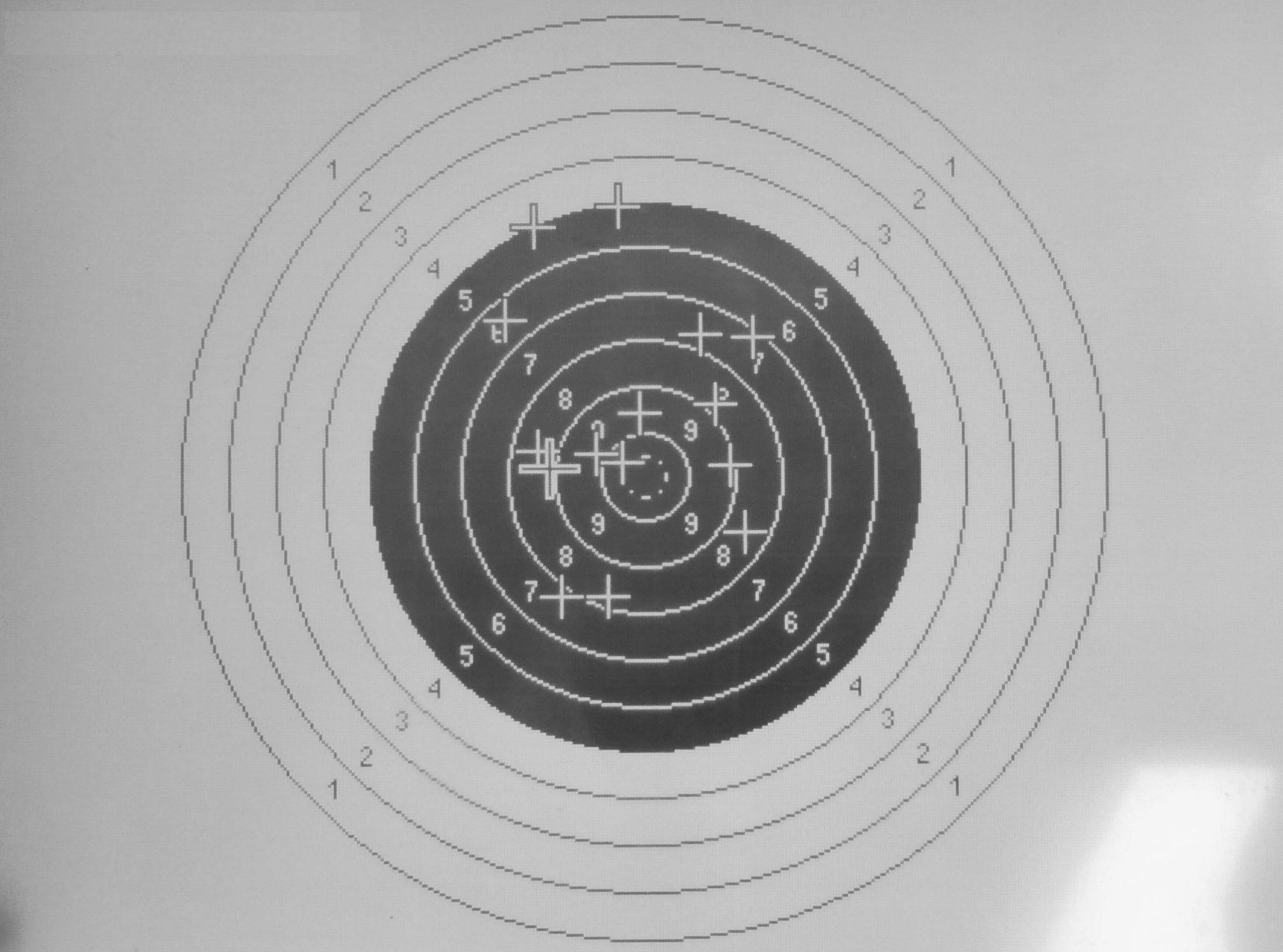

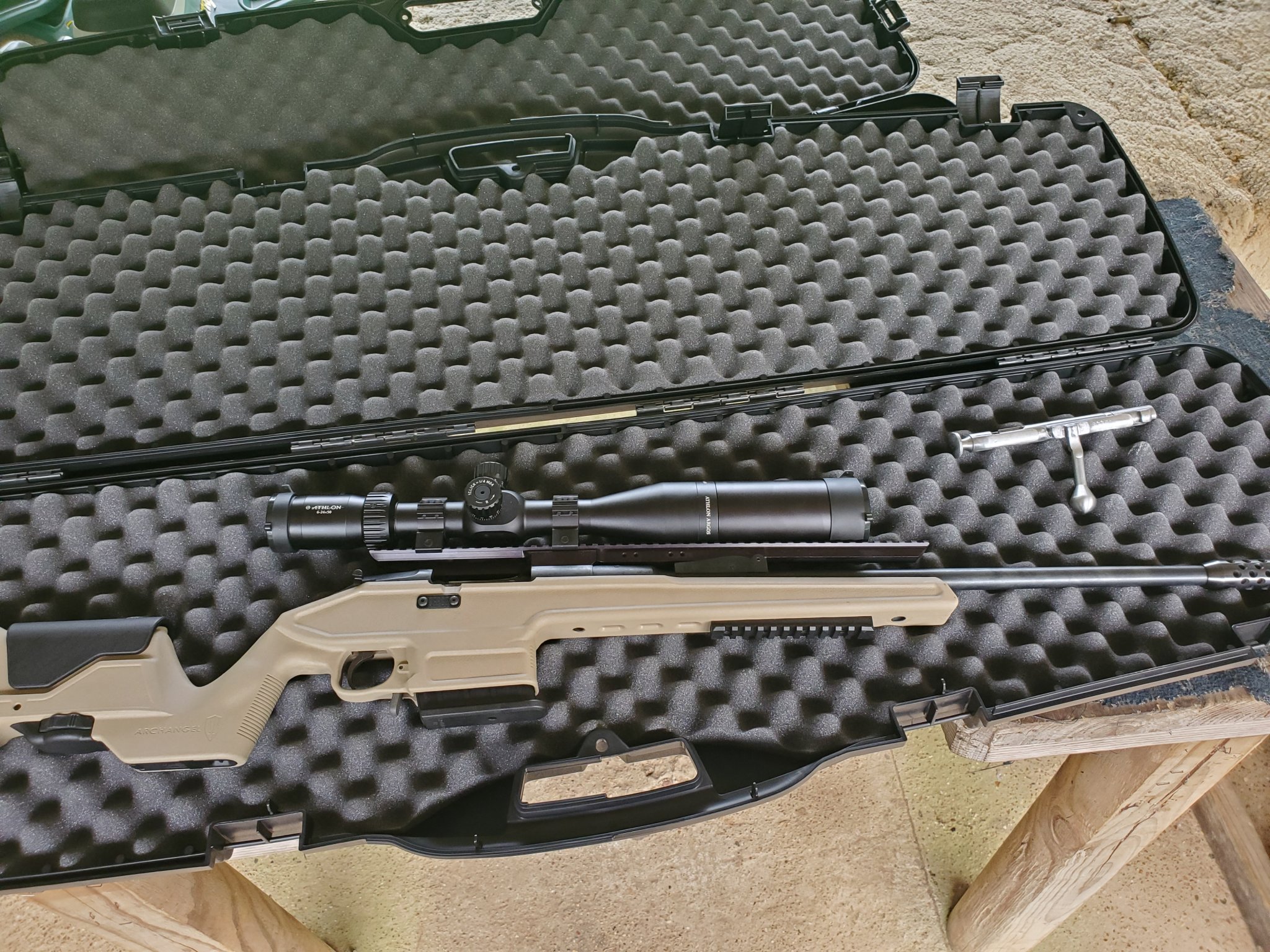

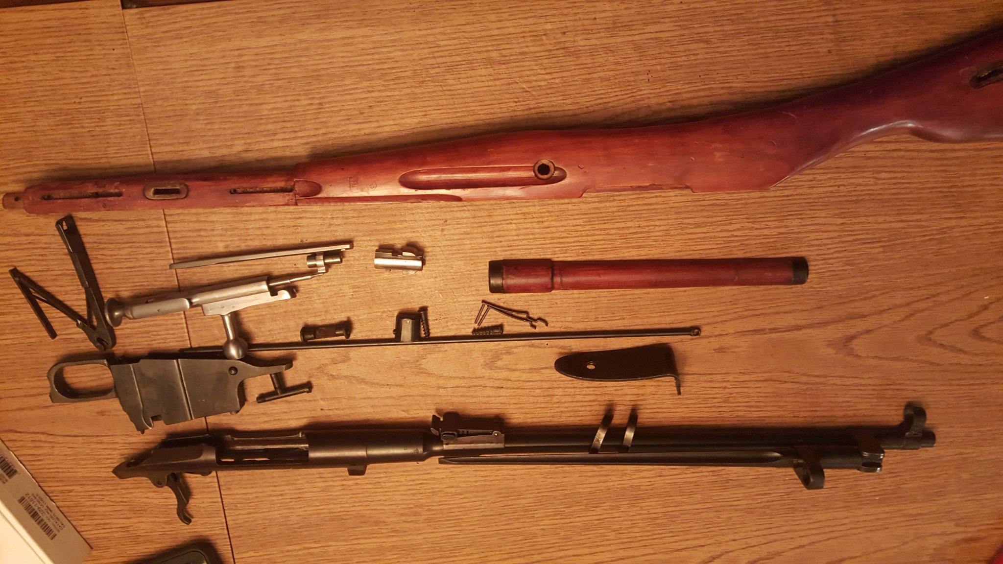

I finally got around to do the bedding of my Mosin and shimmed the barrel at the front with some cork. (And in the process remade the outher finish of the stock) Today I got to try it on 200m and I think it and I will get there. (Rings are 10cm/20cm/... - Black Circle is 60cm)
Biggest problem for me was to find and consistantly hold my aimpoint due to a rather poor rest, so I am the biggest variable in those groups. But still for an 86 year old rifle, with iron sights, trash ammo, and me behind it, it is not bad and I would say. :) With a better rest and more practice the group will shrink significantly, I think.

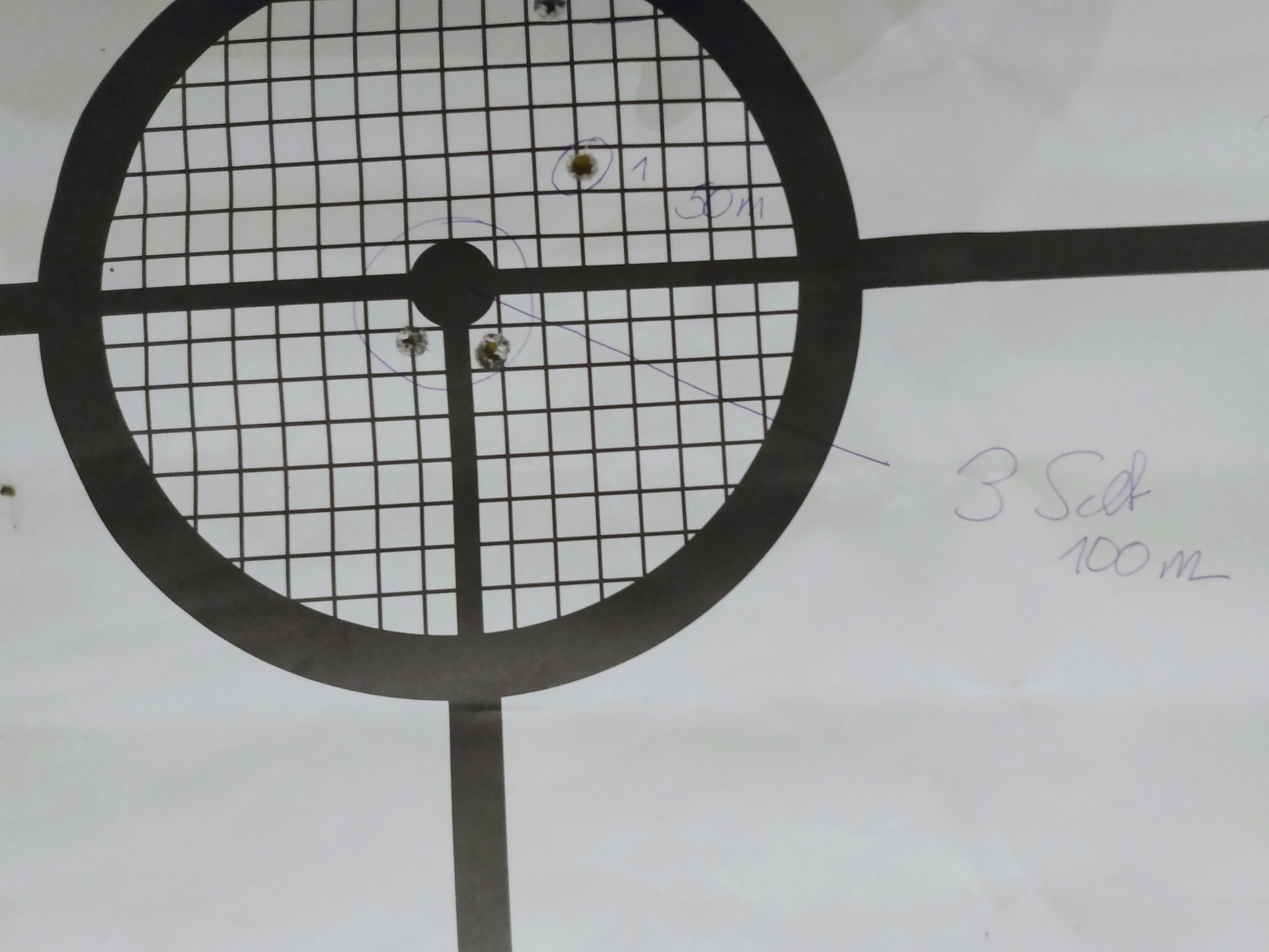

Hey guys, I'm new to the site, ran through a google search looking at moa groupings with a Mosin and came across this. Not sure if it's worth reviving this thread, but just thought I'd say hello to yall, and also share what I did at the range the other day at 100 yds with my 91/30. It's modded a little bit, but I seemed to get under 2 inch 5 shot groups. Lots of shooter error here, not too much experience with range shooting, just now really getting into it, but I felt like it performs well. Mine is a 1939 tula build and from what I read, it's the last year that they were really well made. Anyways, here is the target, and a pic of the rifle. Pay no attention to the writing, you can kinda see for yourself. I shot six 5 shot groups and one 4 shot group I believe. The last group was me adjusting my hold on the rifle and tweeking my windage and I hit 5 shots in the one inch mark. Could have done better on the previous 2 groups

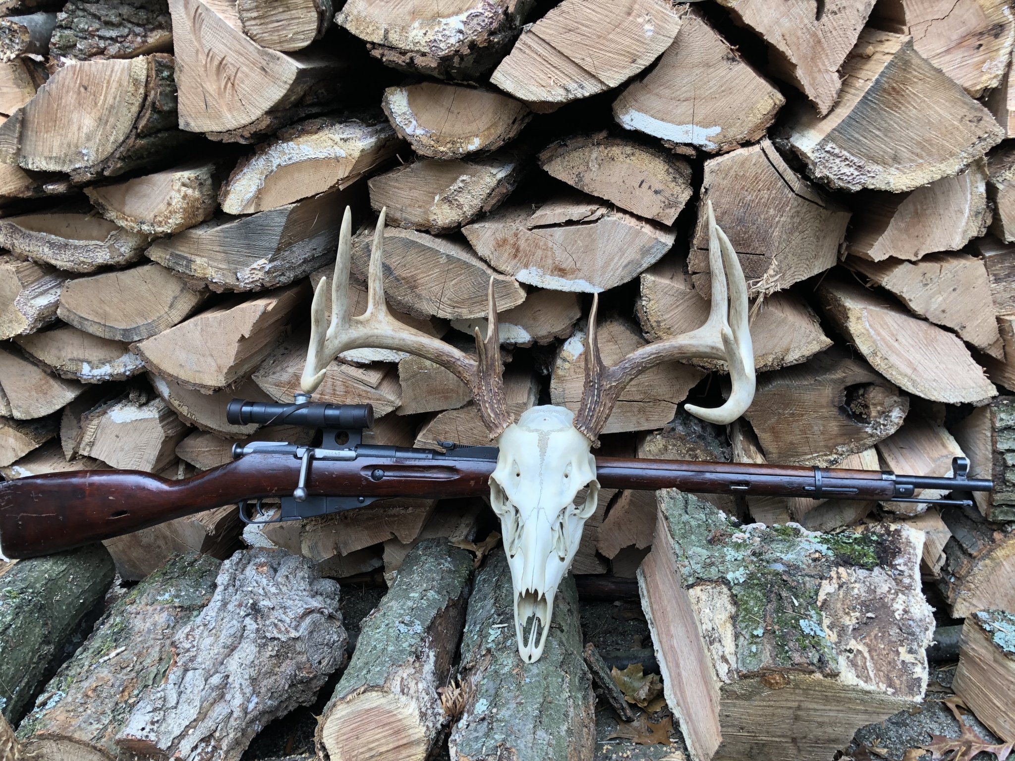

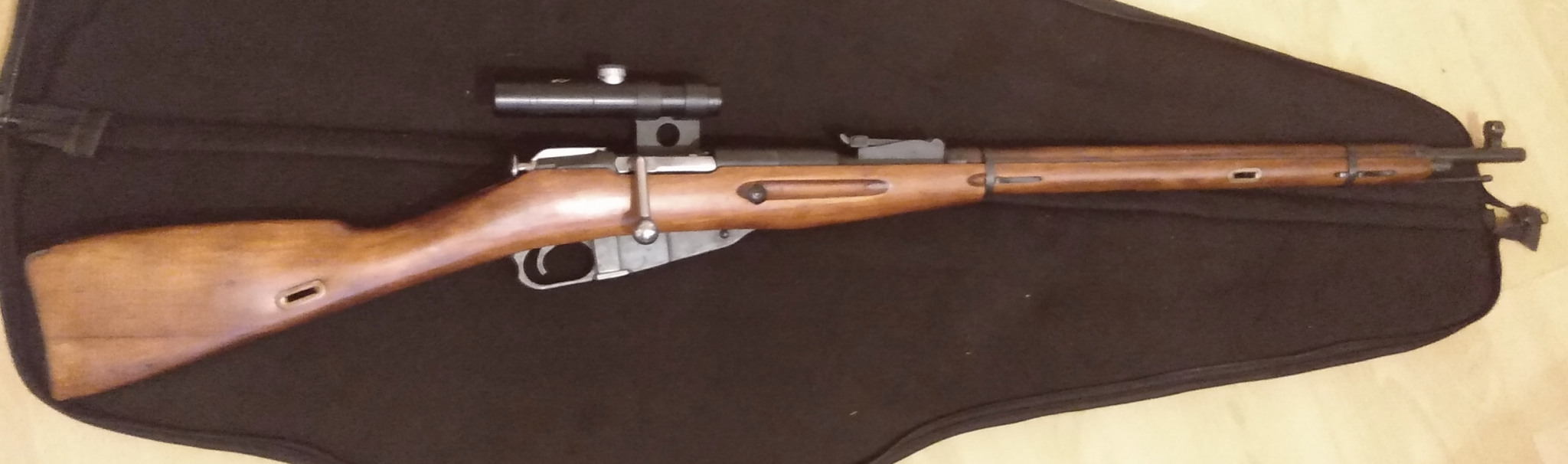

I finally got my good old mosin back from the gunsmith. So the replica PU is mounted and the groups my gunsmith shot look promising. (Its just a 3 shot group though - Sellier&Bellot FMJ 180gr) I will keep you updated about what my results are.
Well, age, health, and some challenging temperatures (hot and cold) here in AZ, not forgetting the CV-19; the Mosin Project is still languishing on hold. This means the Muzzle recounterbore remains untested. I also just received a bunch of Speer 308 165gr Grand Slams which I had ordered by mistake, intending to get 150's. They are now slated for the 30-06 hunting rifle, and may also find a home in some PPU 7.62x54r brass.

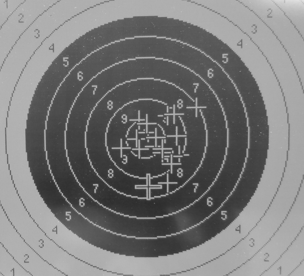

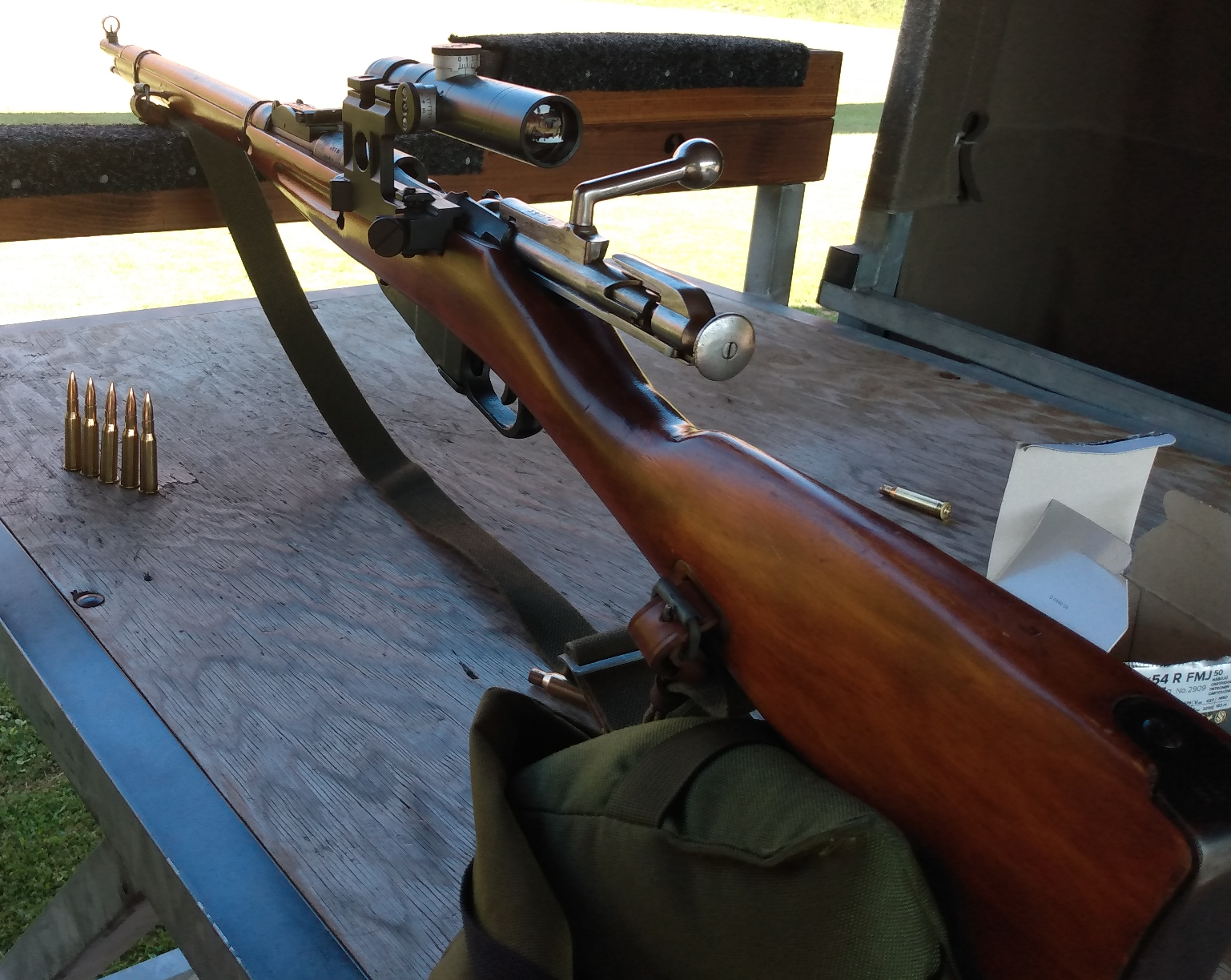

Had the opportunity to shoot 500 meter for the first time with my Mosin. :) I made the wrong wind call and 4 shots went completely off the target but over all I am very happy with the result. The repro 3.5x optic works suprisingly well but is pretty much at an end at 500. (at least with my eyes) Everything beyond that needs quite some work to walk it in, I think.
With some work on my form, a more stable rest and also better ammo I think there is alot of room for better groups.
Reactions: sandwarrior

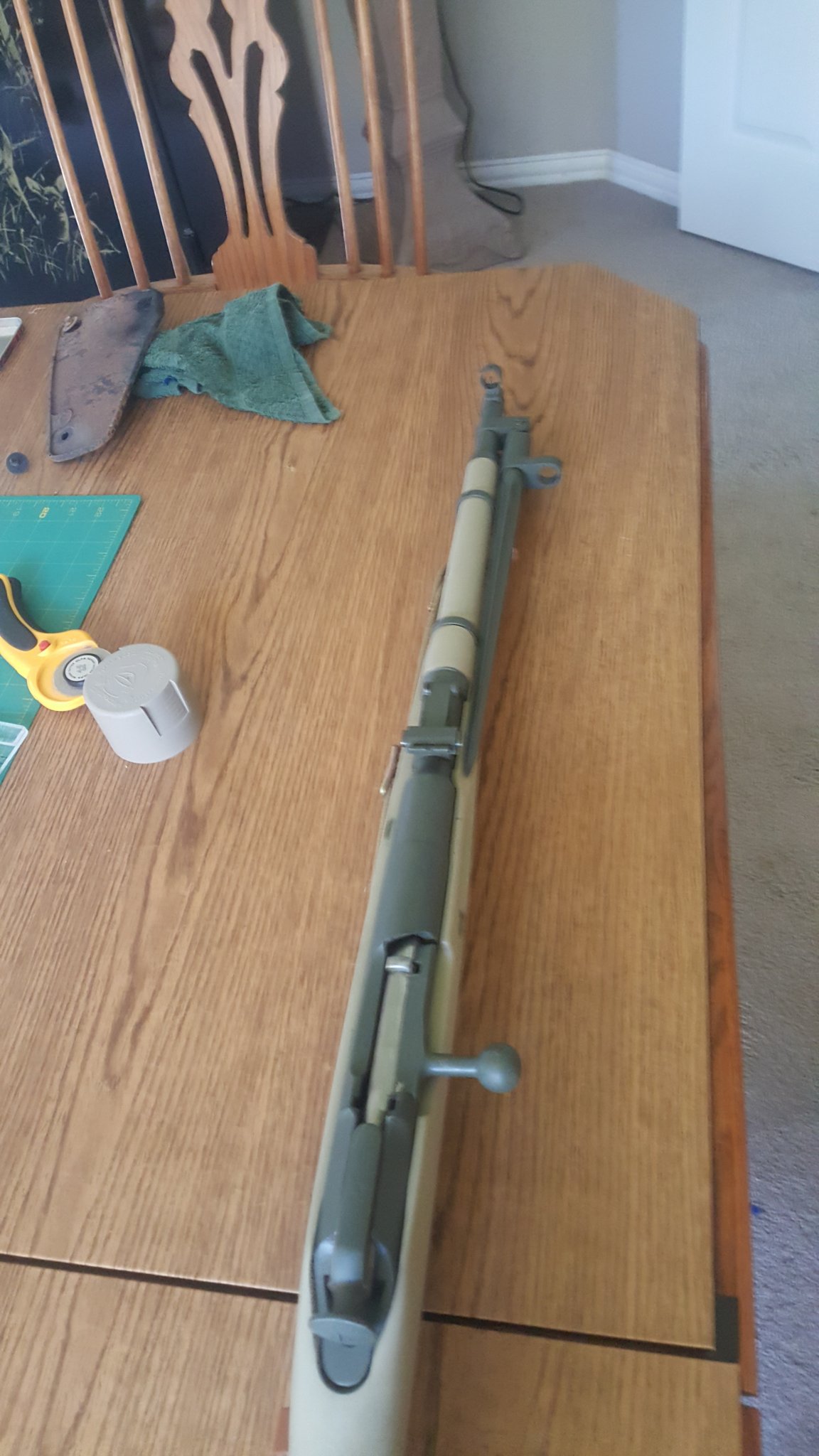

So this thread got me interested in accurizing and otherwise improving an M44 I have. Truthfully I wanted somehow improve the looks first. Here it is disassembled.

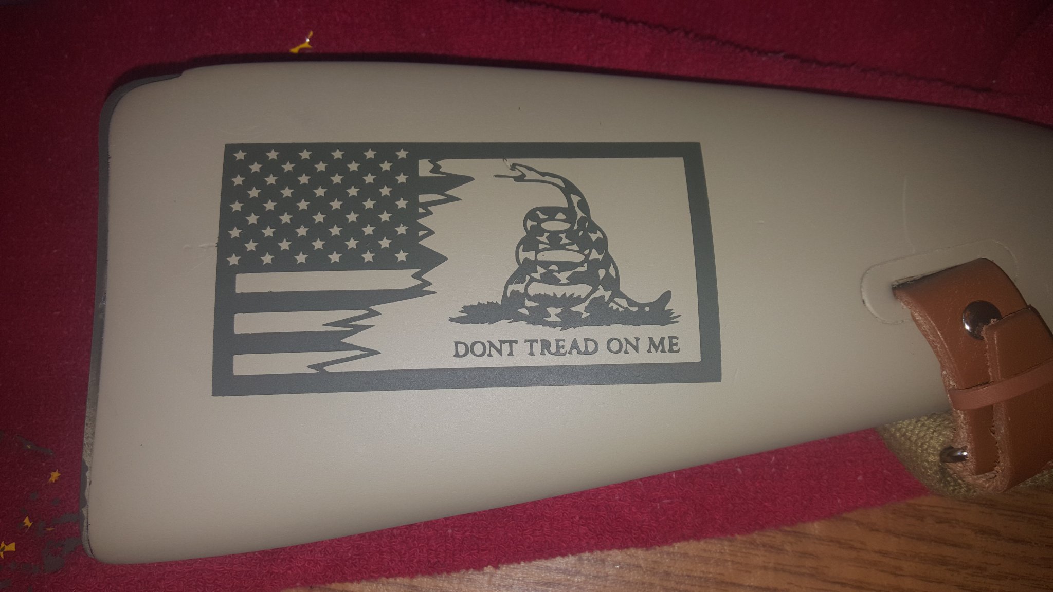

So I removed the orange laquer, sanded, and linseed oiled it but the wood was too hard to absorb the oil and was still butt ugly.
So I painted it with rattle can cammo colors. I think it turned out ok.
So a few months ago I started shooting it more and thought about how I could make it shoot better. I bought the accurizing kit from Smith including cork and brass shims and trigger spring. That helped exactly NOT AT ALL. Still shot 5-6moa.
Next step was to replace the trigger which was the worst I've ever felt. So I installed a Timney with safety lever. Pretty much had to butcher the stock to make room but dang thats a nice trigger!
The next step was adding a scout scope. Tried Leuppy but eye relief was too short so I went with the Vortex 2-7. At $150 I had zero expectation of tracking or repeatability but we will see. Here it is at the range.
Unfortunately it still shot like crap with spam can garbage ammo.
So I ordered dies and 195gr bullets. Had some H4350 on hand and worked up a load but still 2.5 to 3 moa was best it would do. So tried 150gr Hornady and Varget. I know you guys are thinking, "Why waste unicorn tears on a Mosin?"
Anyway, with 44.7gr of Varget and 150 Hornady soft Point this little M44 shoots pretty dang good. 1 to 1.5in groups is typical. Man what a difference good ammo made!
I'm very pleased. Next weekend I'll hang some steel at distance and see if the Vortex can keep up.
