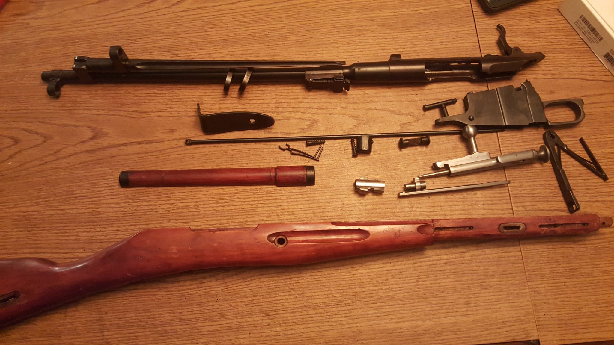

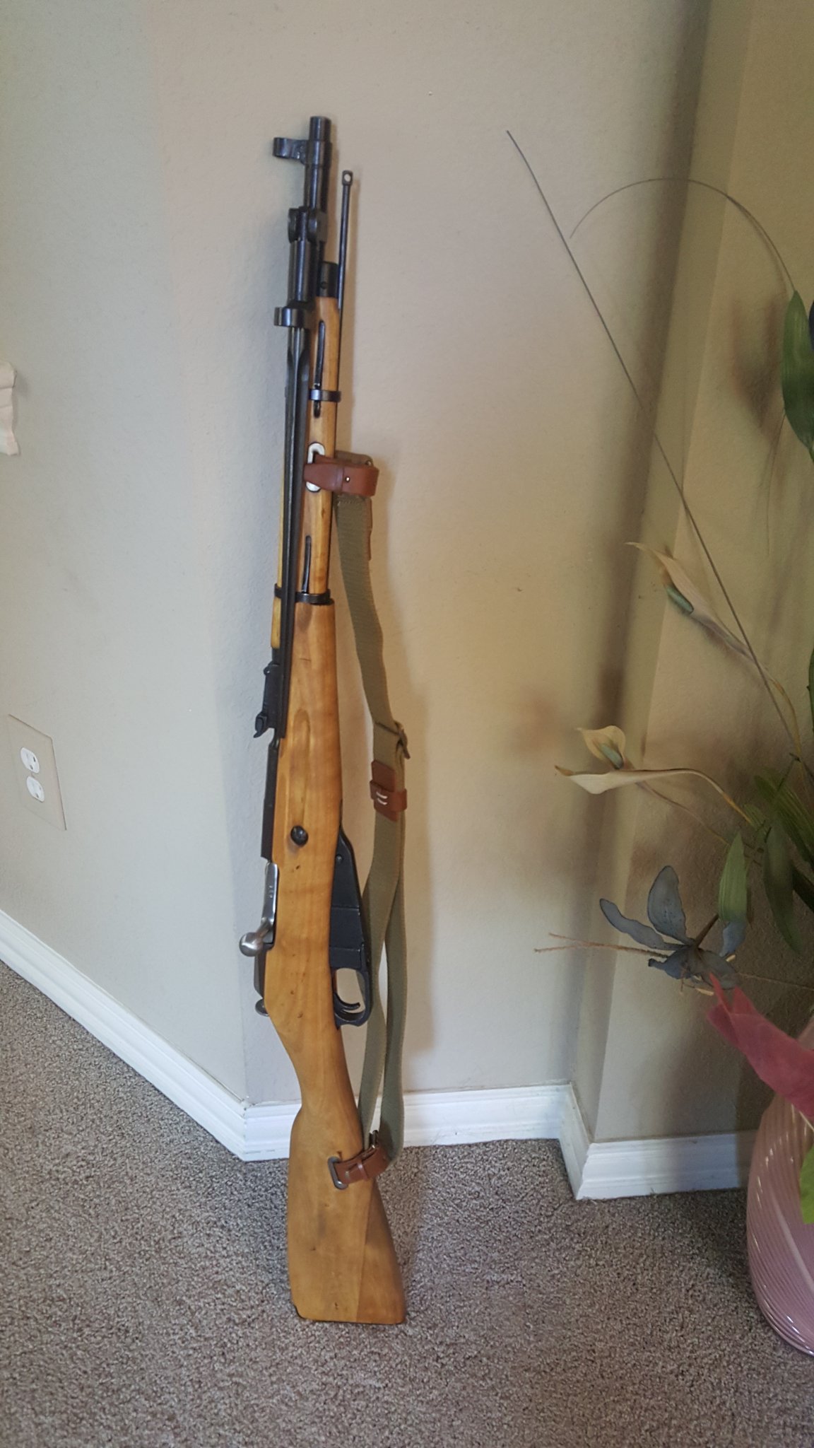

So this thread got me interested in accurizing and otherwise improving an M44 I have. Truthfully I wanted somehow improve the looks first. Here it is disassembled.

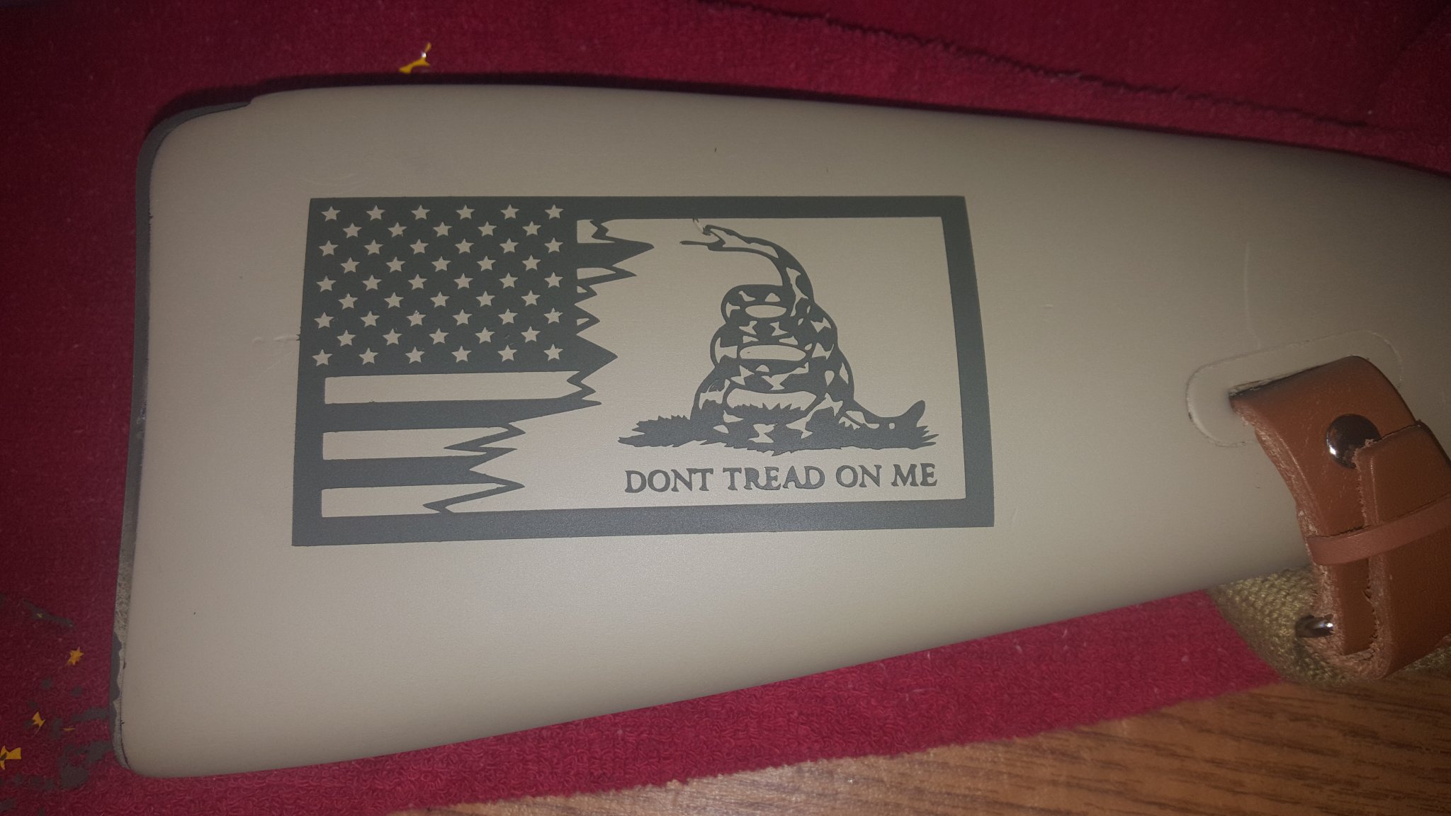

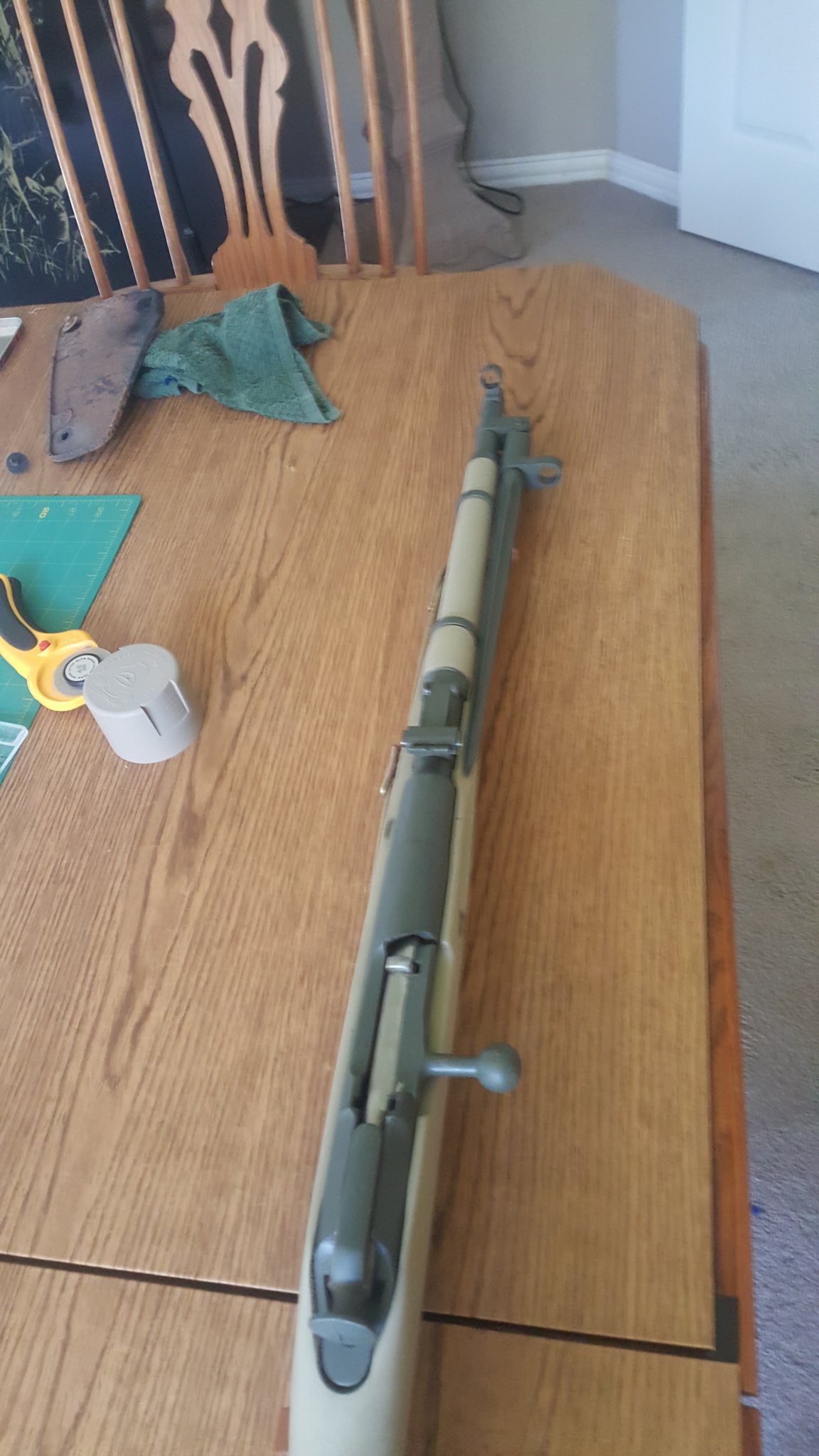

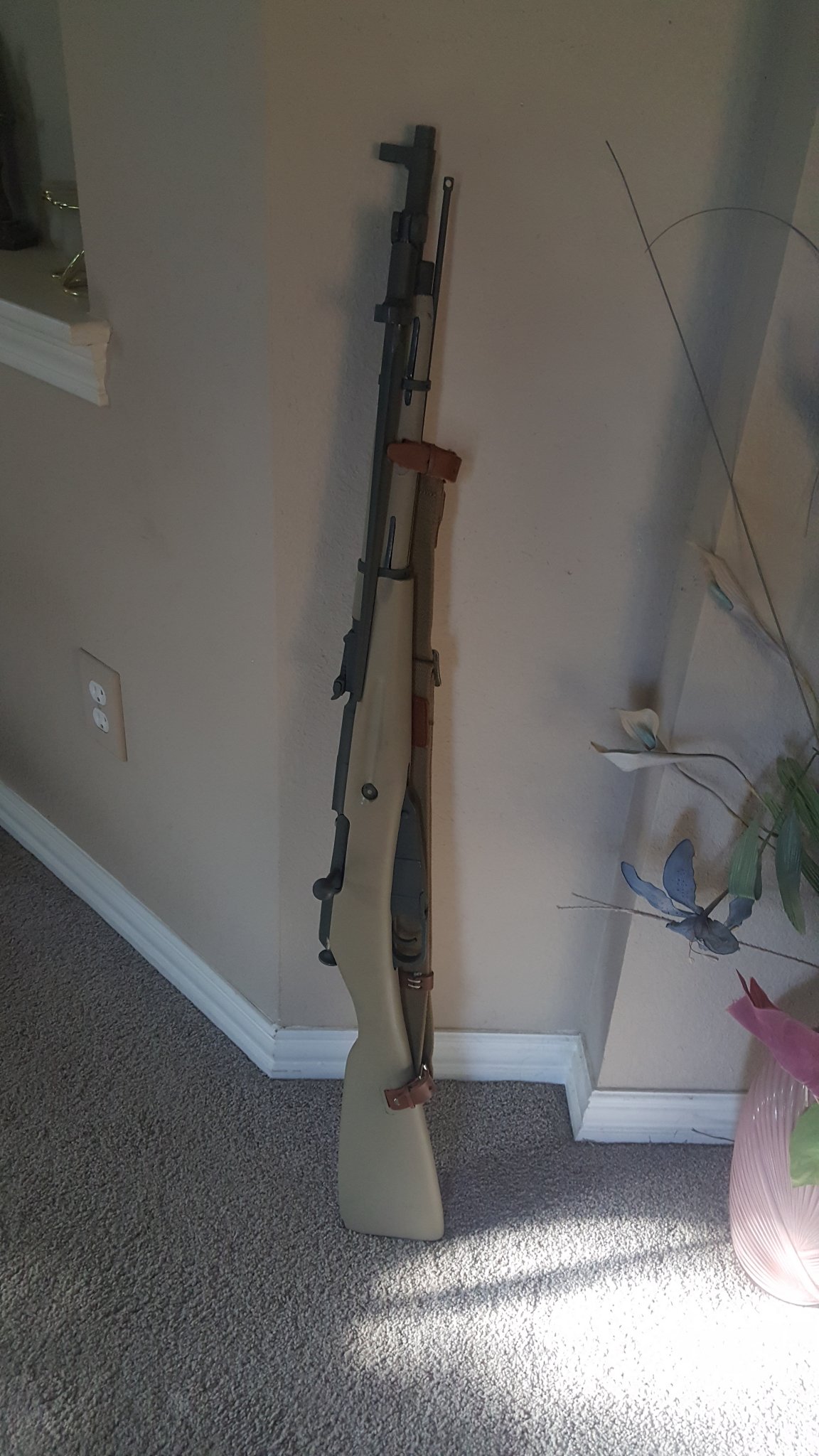

So I removed the orange laquer, sanded, and linseed oiled it but the wood was too hard to absorb the oil and was still butt ugly.
So I painted it with rattle can cammo colors. I think it turned out ok.
View attachment 7538907View attachment 7538908View attachment 7538909

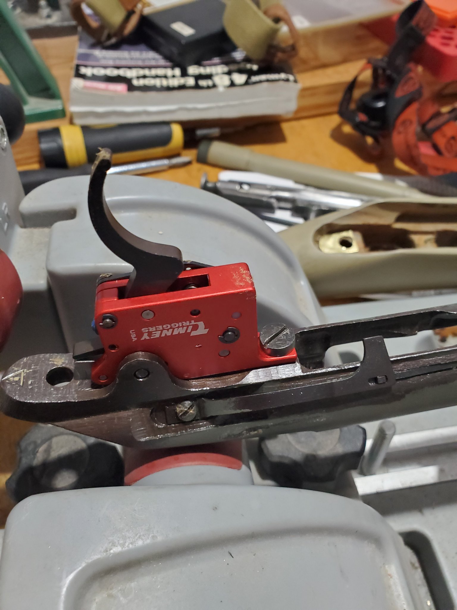

Next step was to replace the trigger which was the worst I've ever felt. So I installed a Timney with safety lever. Pretty much had to butcher the stock to make room but dang thats a nice trigger!

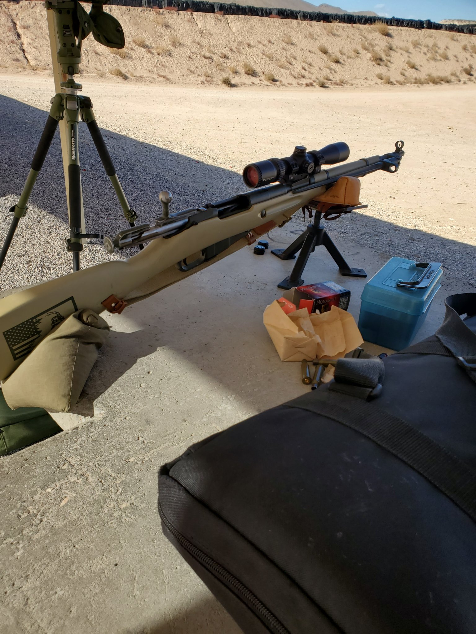

The next step was adding a scout scope. Tried Leuppy but eye relief was too short so I went with the Vortex 2-7. At $150 I had zero expectation of tracking or repeatability but we will see. Here it is at the range.
Unfortunately it still shot like crap with spam can garbage ammo.

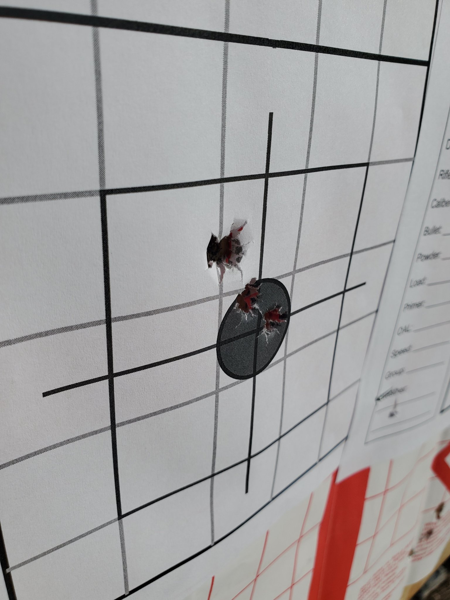

So I ordered dies and 195gr bullets. Had some H4350 on hand and worked up a load but still 2.5 to 3 moa was best it would do. So tried 150gr Hornady and Varget. I know you guys are thinking, "Why waste unicorn tears on a Mosin?"
Anyway, with 44.7gr of Varget and 150 Hornady soft Point this little M44 shoots pretty dang good. 1 to 1.5in groups is typical. Man what a difference good ammo made!
I'm very pleased. Next weekend I'll hang some steel at distance and see if the Vortex can keep up.

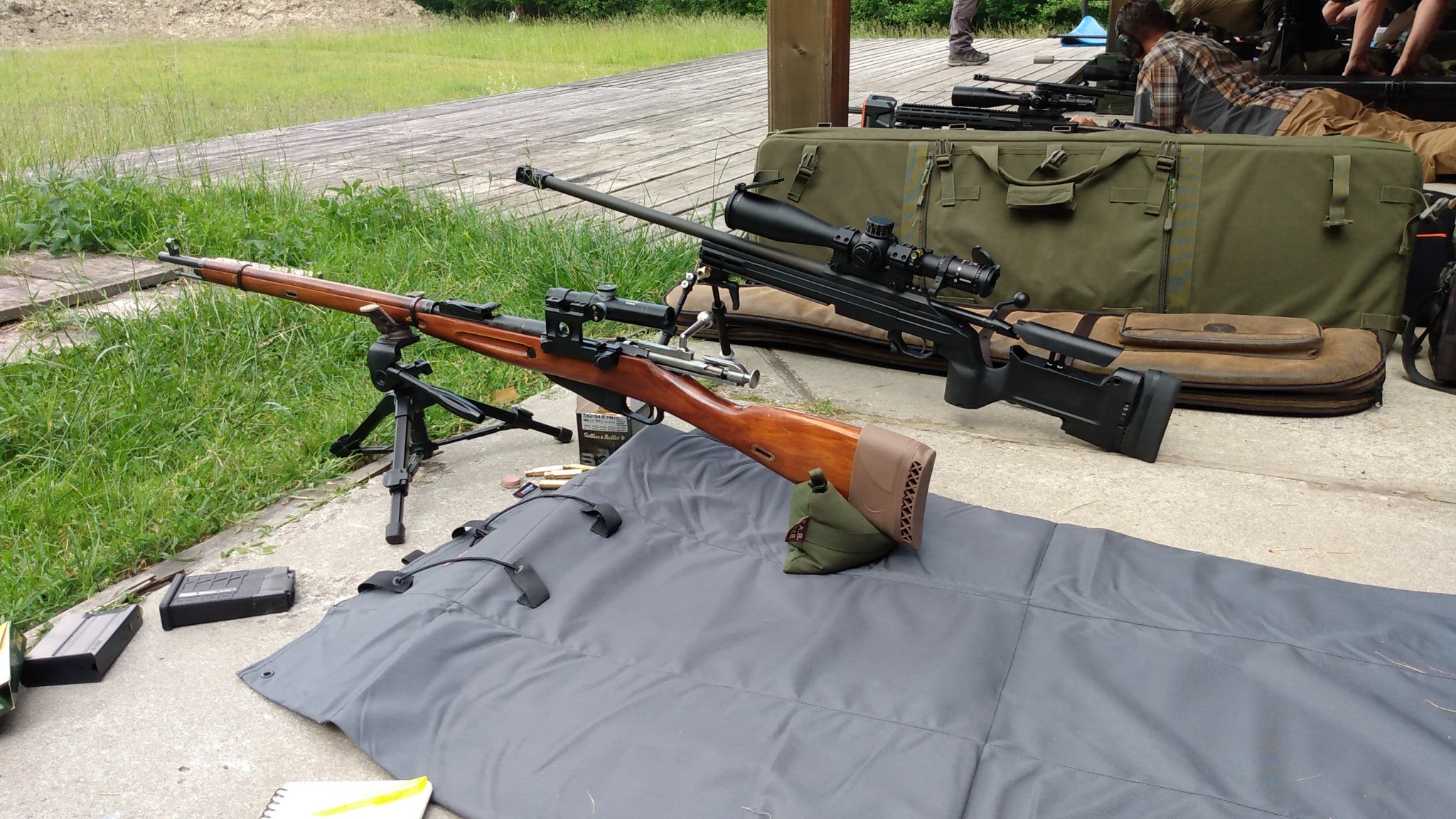

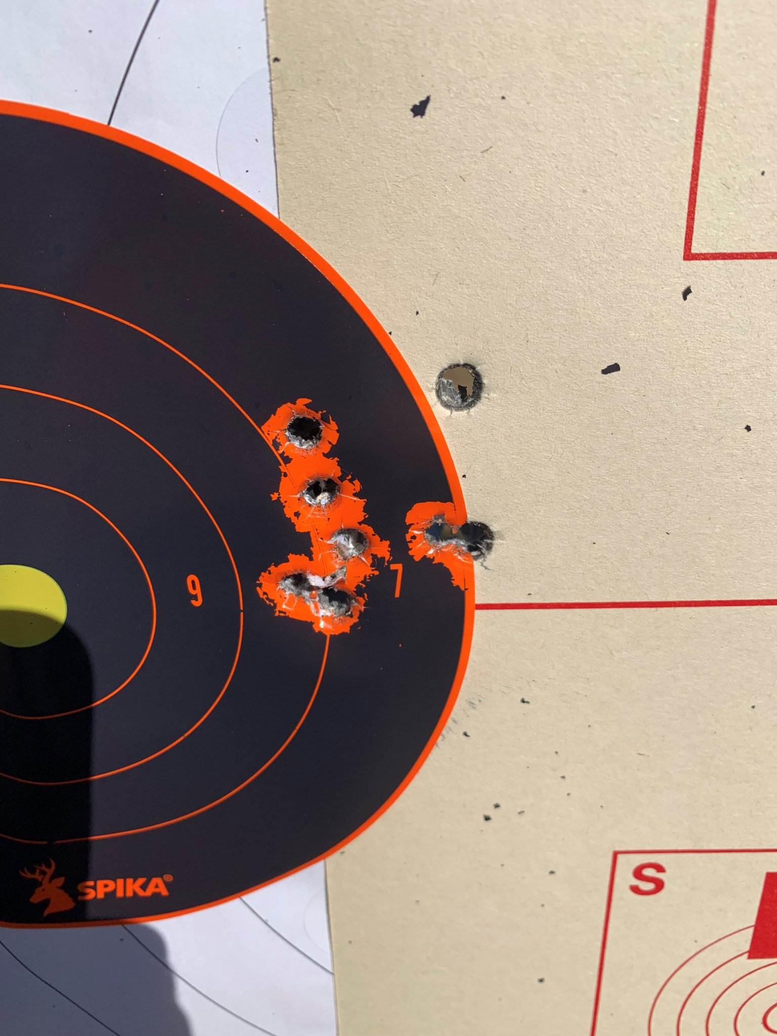

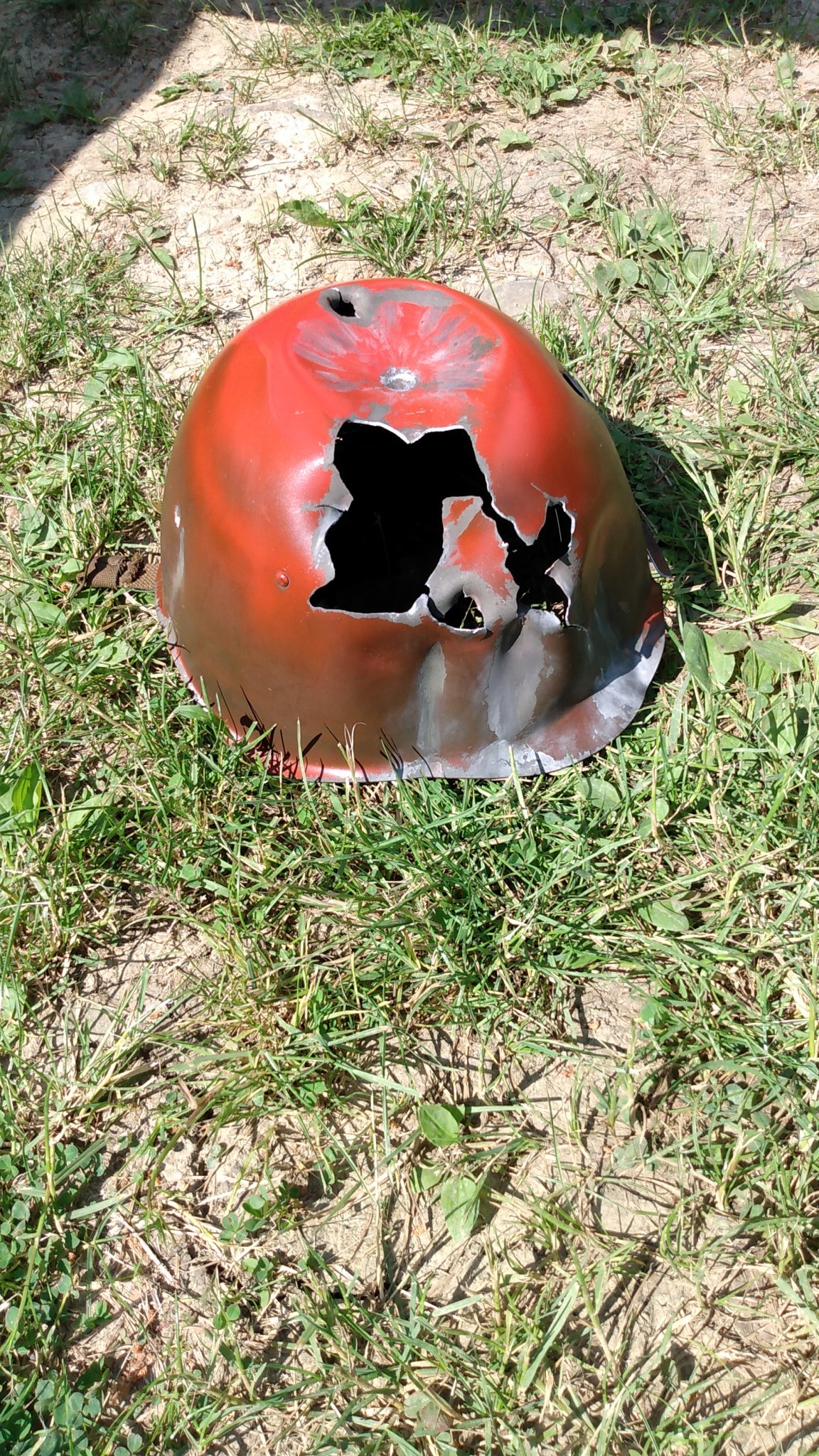

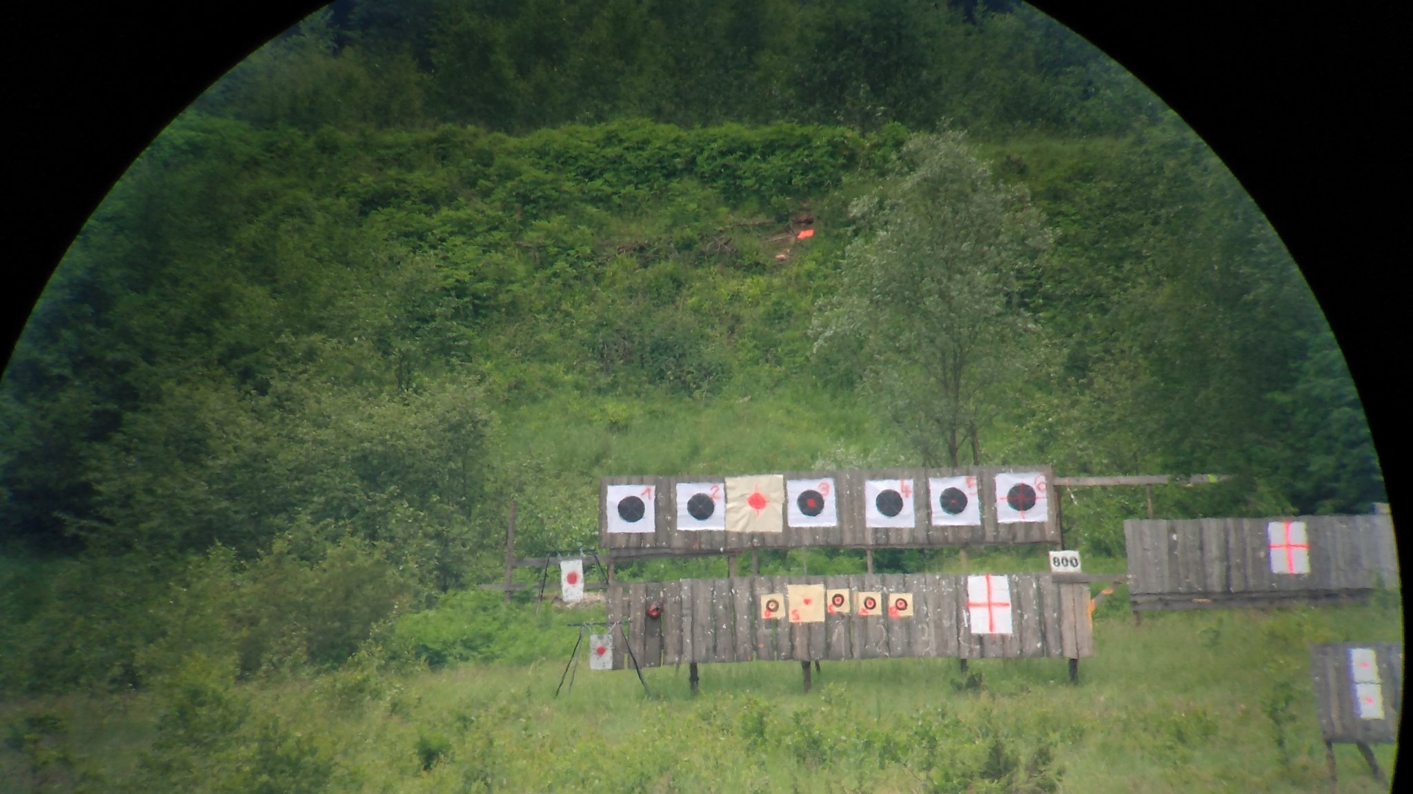

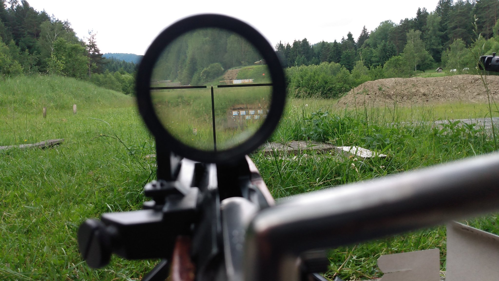

Sorry to resurrect, but as an update, I broke a new personal record yesterday with a succesful hit at an old helmet at 800m (The big bump that did not go through) and kind of consistant hits at the plate also at 800m. :) Also a view through the scope at 500m and a view through the spotter at the 800m targets.

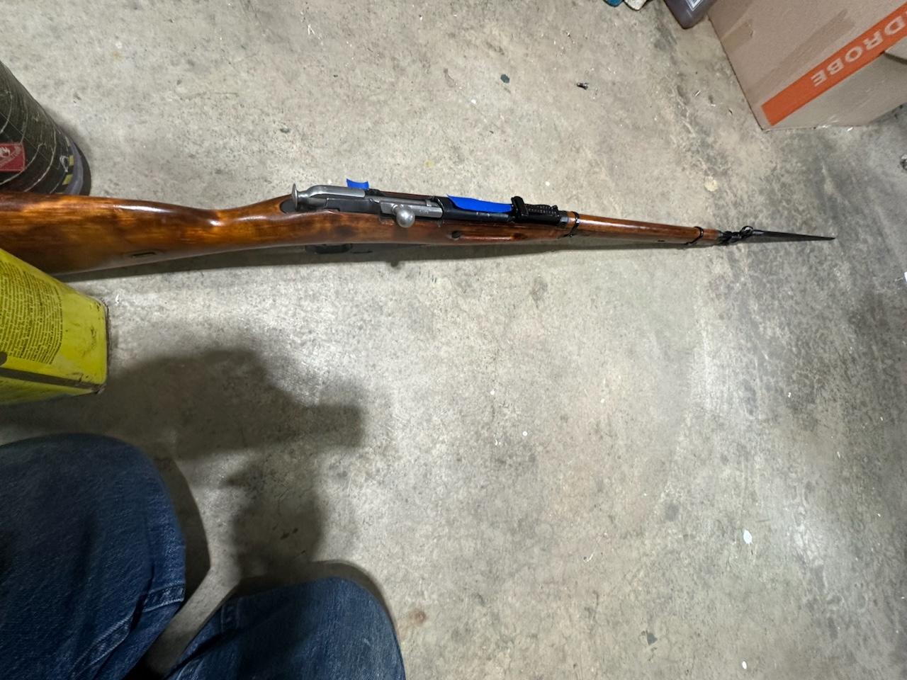

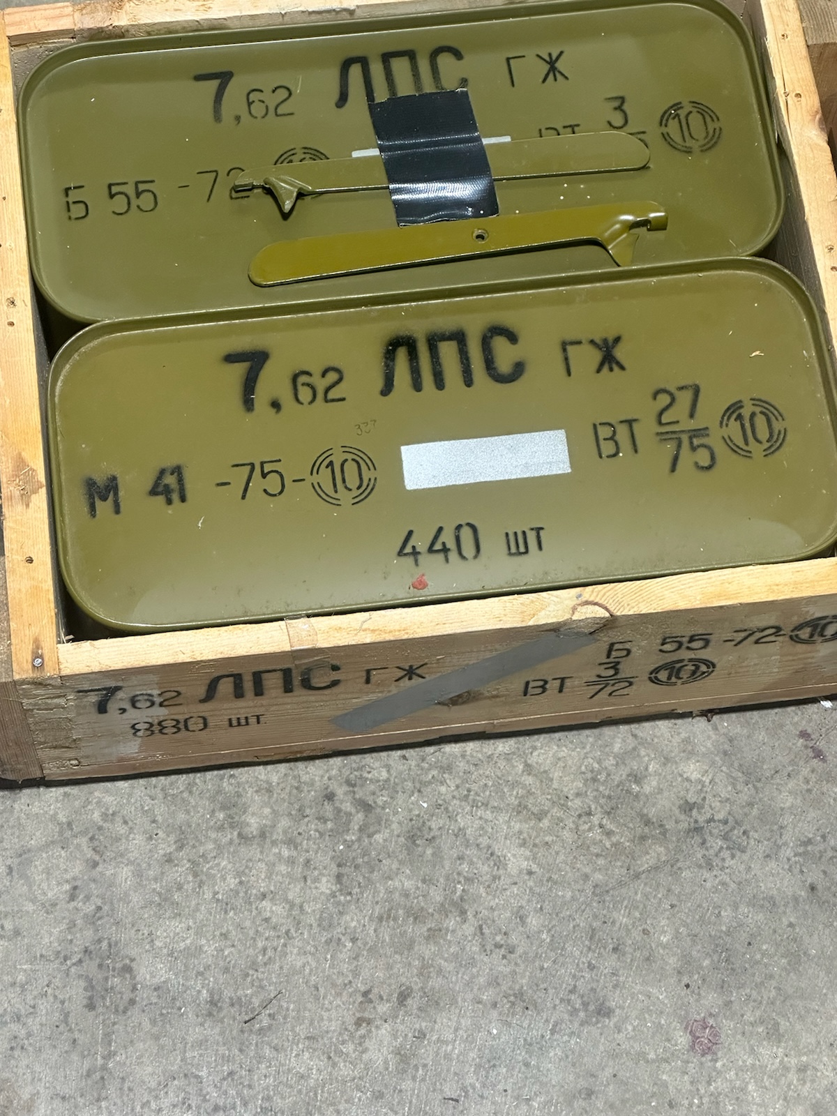

I know this is an old thread, but can anyone help me identify what this is? I'm suspecting it might be for a Mosin Nagant, but that's just a guess. Thanks!

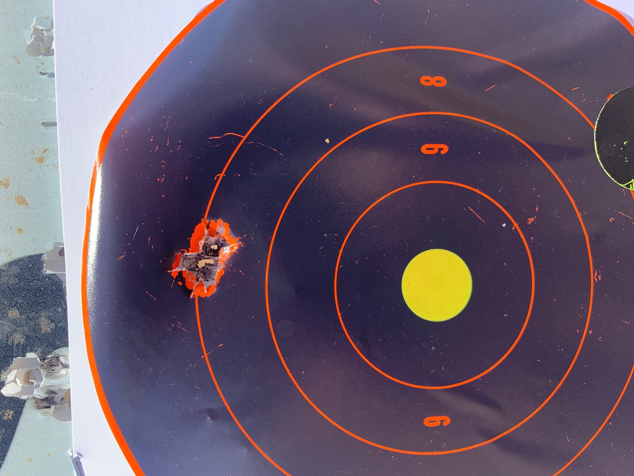

While I'm here, I have an "MOA" Mosin Nagant. At least once anyway.
I've owned a few off and on over the years, but the only one I ever kept was the first one I bought, because it's the worst looking (as in badly manufactured) one I ever ran across. I bought a bunch of surplus ammo with it when I got it. At 100 yards if you shot carefully you could keep all the rounds on a torso sized target. So needless to say it didn't get shot a lot, it became a novelty gun I just let people shoot from time to time who'd never seen or fired one. As such that original batch of ammo lasted many many years. Eventually I bought more, again surplus stuff.
I brought it to the range one day for a friend to shoot and he was. At one point he says to me "I don't know if I'm even on paper". Knowing the rifle I suspect he probably isn't, my friend was a good shooter considering he was a very occasional shooter, maybe a few times a year. Anyway I'm looking at the target through the spotting scope and I don't see what I'm expecting. I ask if he's shooting at the right target? Then I start to question whether I'm looking at the right target? I double check again, counting the benches, then counting the target stands. I look again expecting to see holes scattered all over, if any at all. Then I think he's screwing with me and I call him on it. He had a scoped Browning .30-06 with him, figured he was shooting that and is just messing with me since I told him what to expect from the Mosin. But nope, that's not it, it's still in the case. I couldn't believe it. He had a 5-6 shot group about the size of a quarter @ 100 yards that he'd fired with the battle sights, out of a rifle that looked like it was crafted with a horseshoe rasp. I was stunned. What a difference a batch of ammo makes.
(Ironically it shot better than his A-Bolt)
Yes
lol 440's the right quantity for 7.62x54R, past that I got nothing.

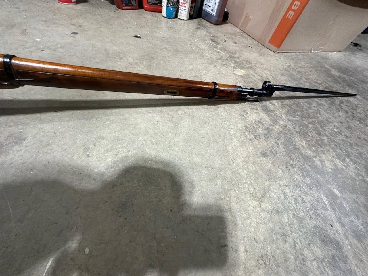

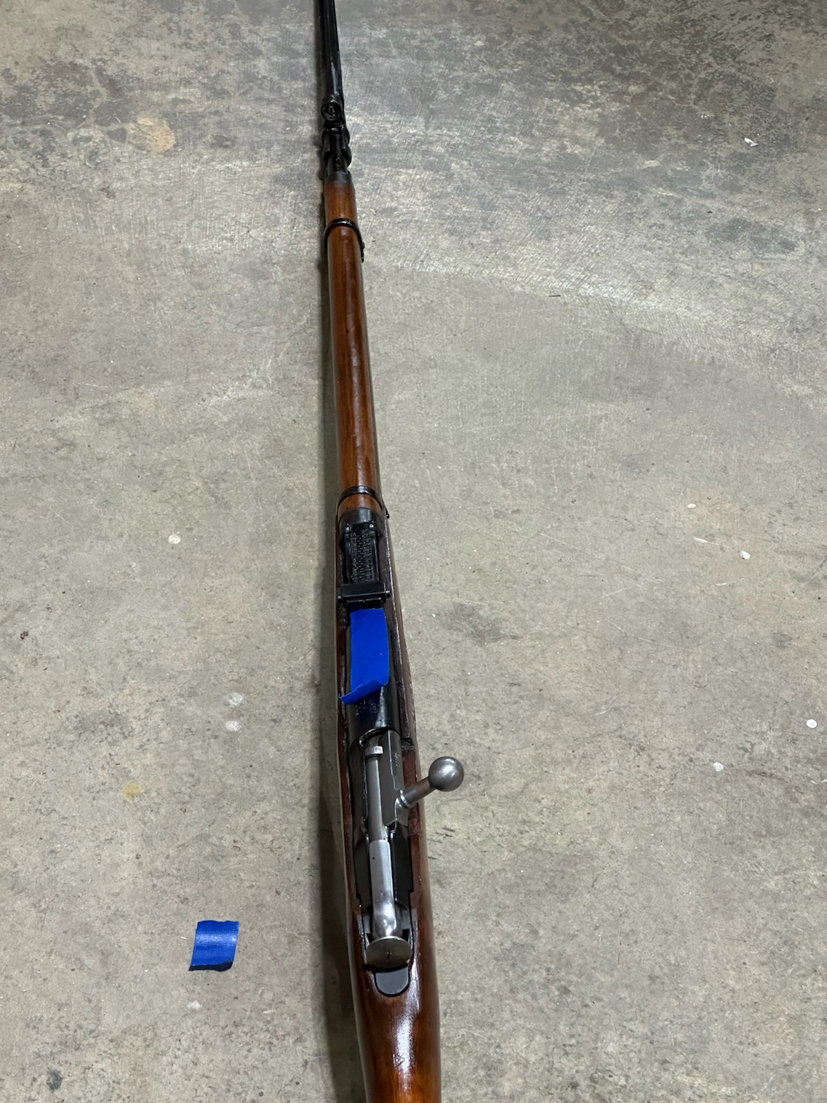

Awesome. Thank you cas6969. A friend just gave my brother a very nice Mosin Nagant or at least what he called a "battle ready" rifle, along with those spam cans. But he gave him a bunch of other stuff and what asked what those cans contained, he just smiled and laughed and said "enjoy! I'm still waiting for a picture of the rifle and I'll post it if anyone is interested.
Remember that stuff is corrosive as all hell.
Story time:
I was out shooting with a buddy, the wives decide to meet us for lunch. We toss the stuff in the trunk and eat. About 3 hrs later and I am home and the rifle is FULL OF RUST. That fast. This was a Missouri summer with humidity in the 90's easy. Now I just pour some water down her nose and all is good.

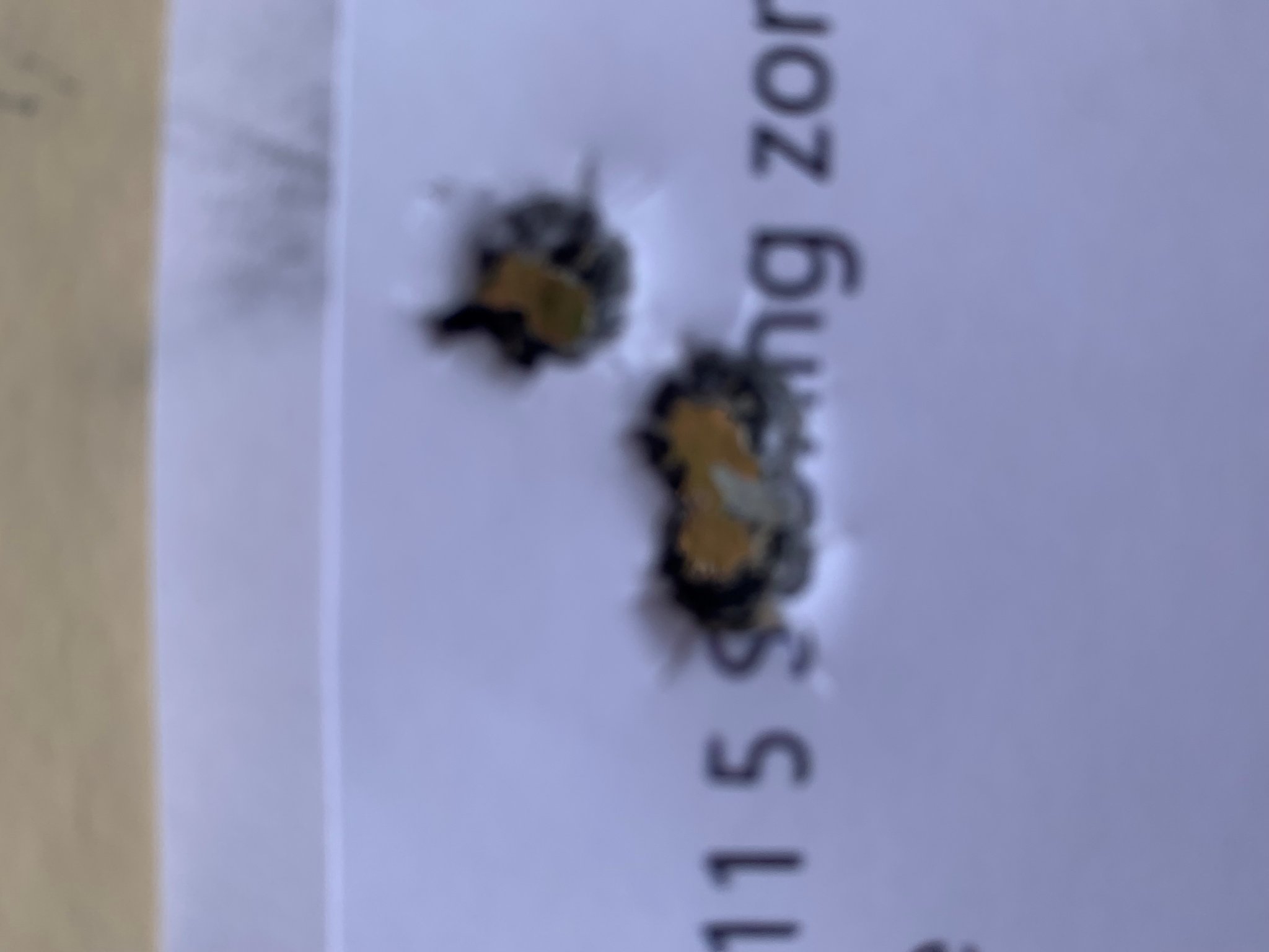

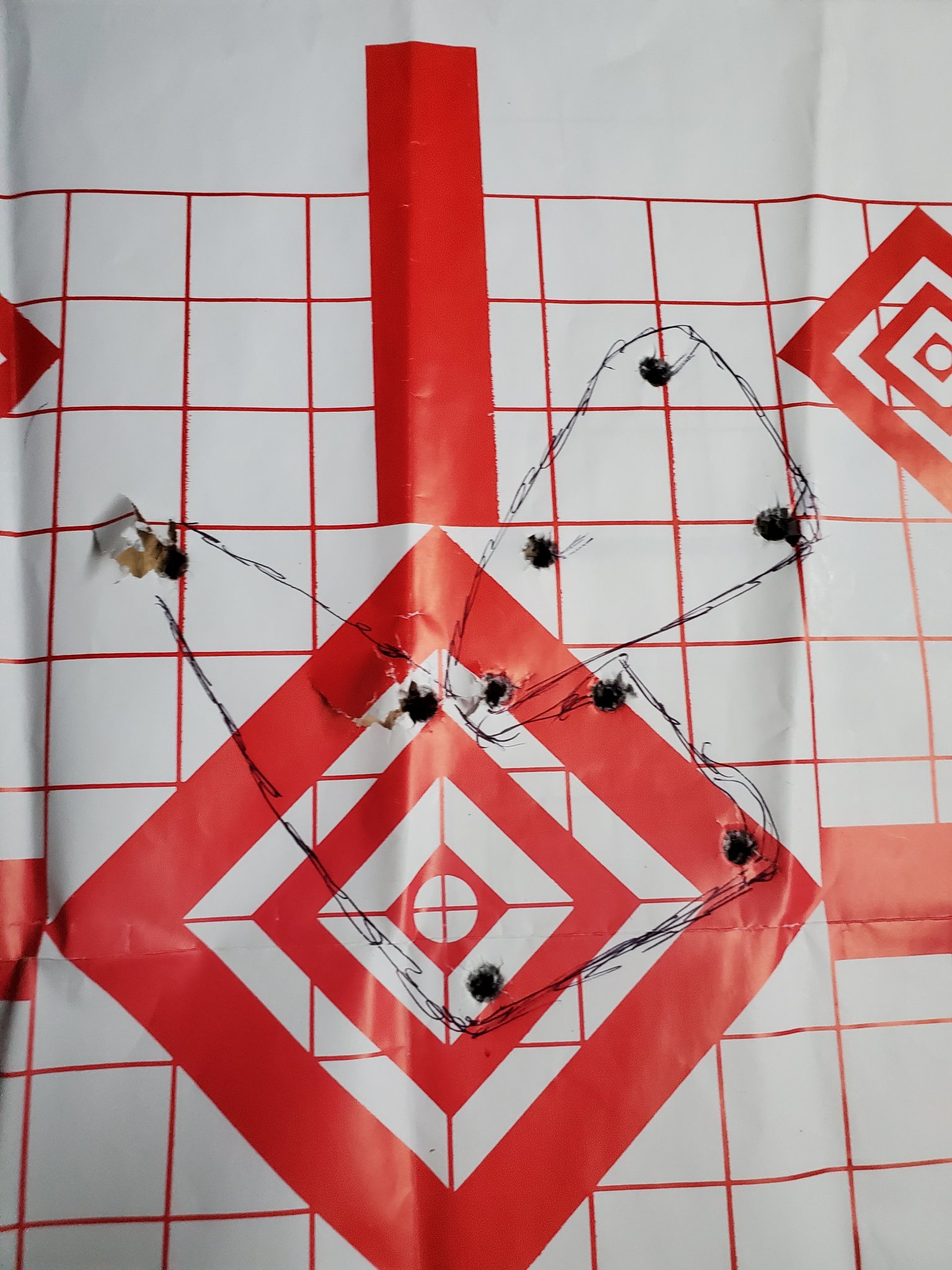

Here is some groups from 100m. Mix of reloads and 180 grain sellier and bellot.
