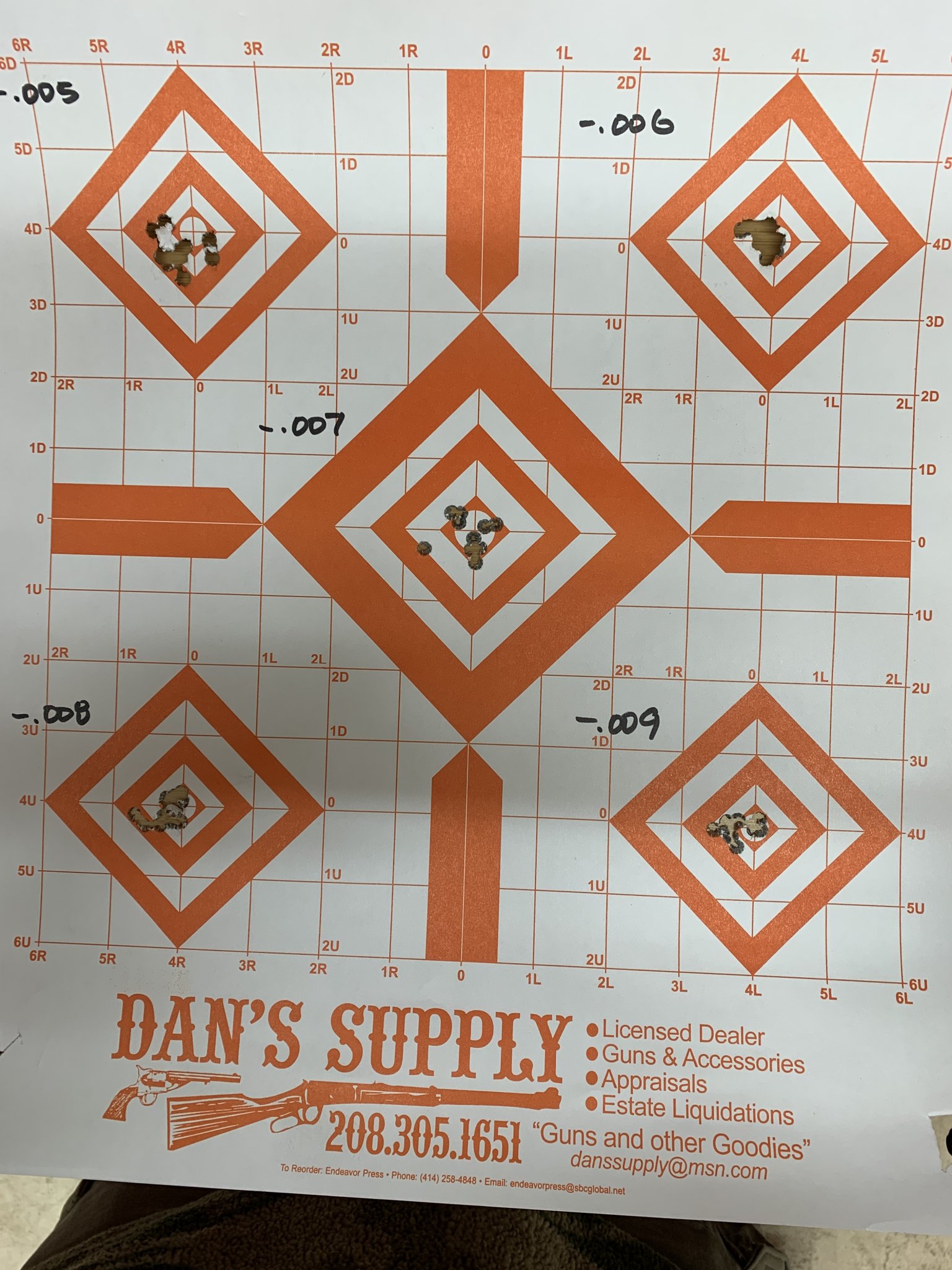

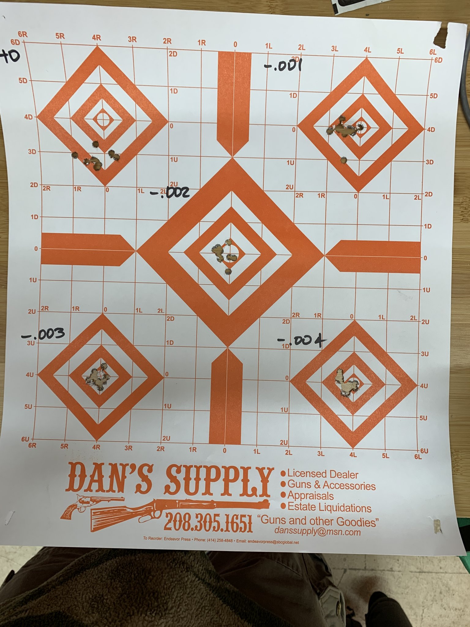

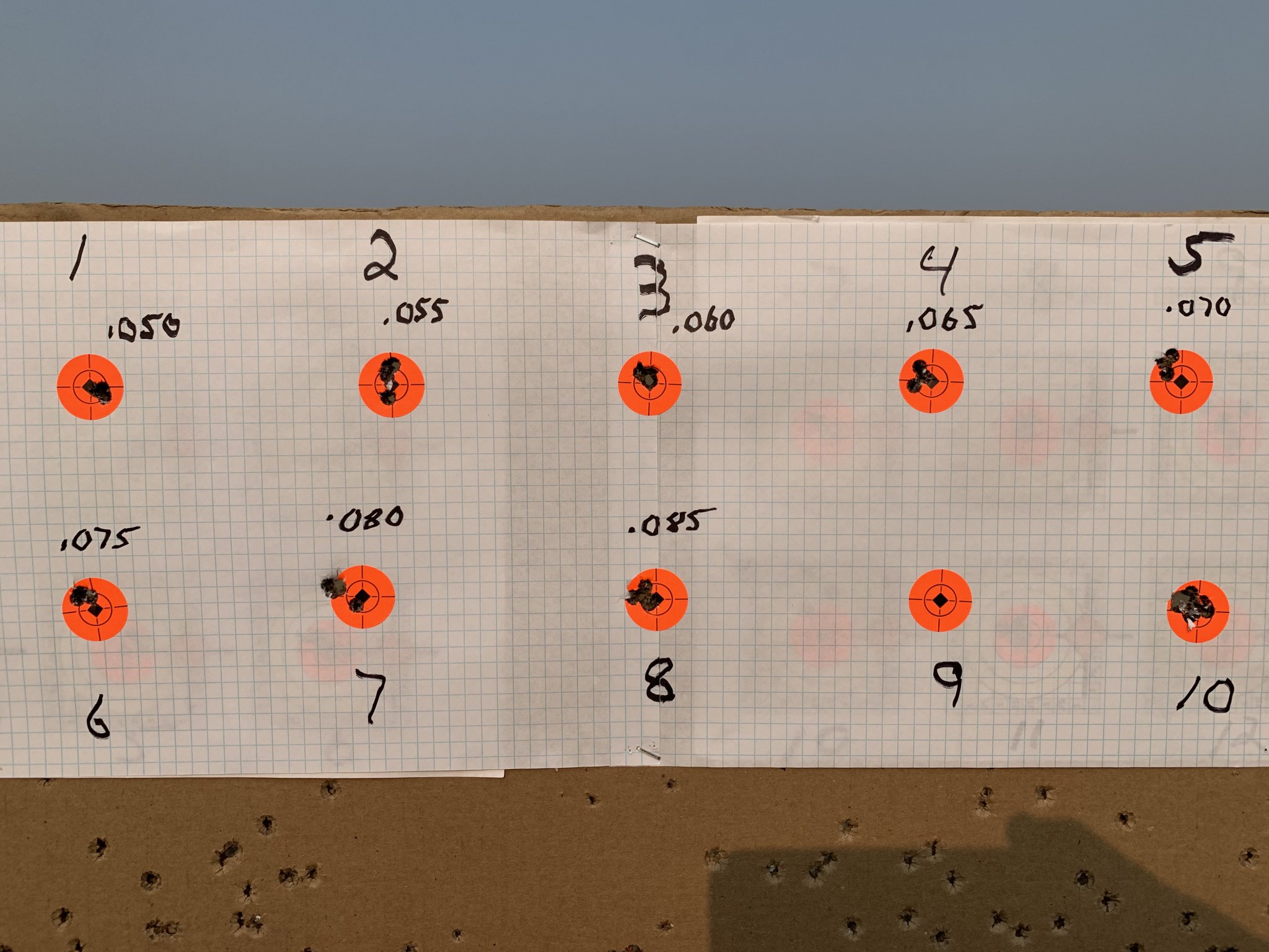

Does a thousandth or 2 matter? I leave you to decide.View attachment 7724528View attachment 7724527
Does it matter if the measurements you recorded are all based on a zero number that’s exactly at the lands, or maybe .001” engraved? No, because you’ve tested to find the best load anyway, and as long as measurement is repeatable, that’s all that matters.
The exception would be if you’re trying to seat bullets right at the lands, but I’d have thought most of us knew it to do that anyway; either crush or jump a little bit for consistency.
