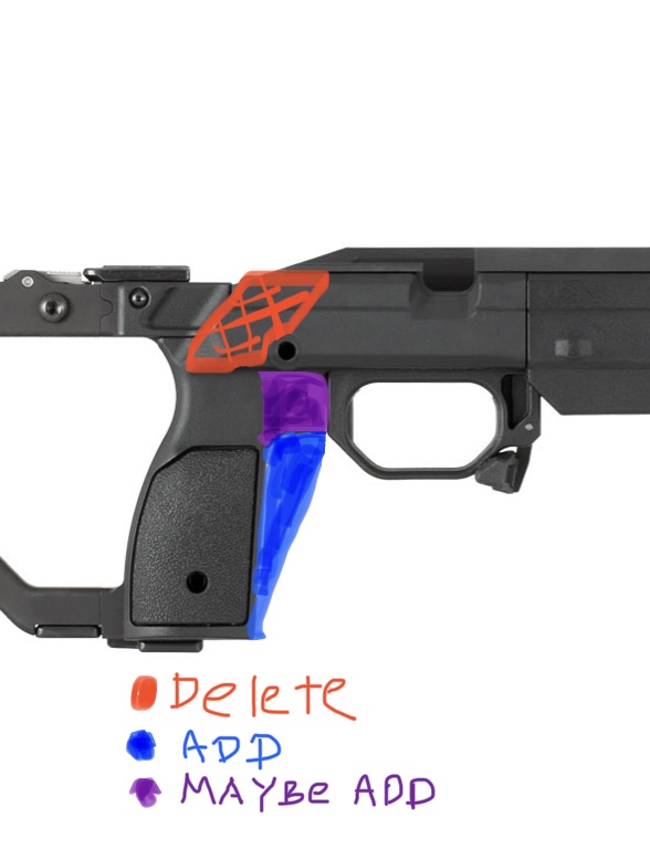

I own a KRG Whiskey 3, 6th Gen. I like it, but the grip’s distance from the trigger, thumb shelf placement, and grip angle isn’t ideal for me.
On a lark, I was goofing around with a wiebad cheek pad and some tape and found an arrangement that was really comfortable. But, it is flimsily and looks like ass lol.
Is there a material that people sculpt grips out of? Something you can add to as well as sand away? Or a process to follow? No sense in reinventing the wheel.
I know some people use bondo and I’ve used Sugru, but maybe there’s better ideas out there. I’ve considered getting some balsa wood or pine and carving it and handing that off to @LongRifles Inc. for a sexy finished wood grip or something.
Below is my idea. At one point I took the right grip panel off and found resting my thumb on that upper grip bolt was amazingly comfy. But I’d have to remove a bunch of material and fill in the voids as the grip is not solid…it has reinforcing ribs on the back.
The purple bit is a trigger finger shelf like MPA has.
The good thing is that I have three sets of grip panels to experiment with.
Or I could buy an entirely new chassis lol. But I don’t really want to do that as I like the chassis except for this area.

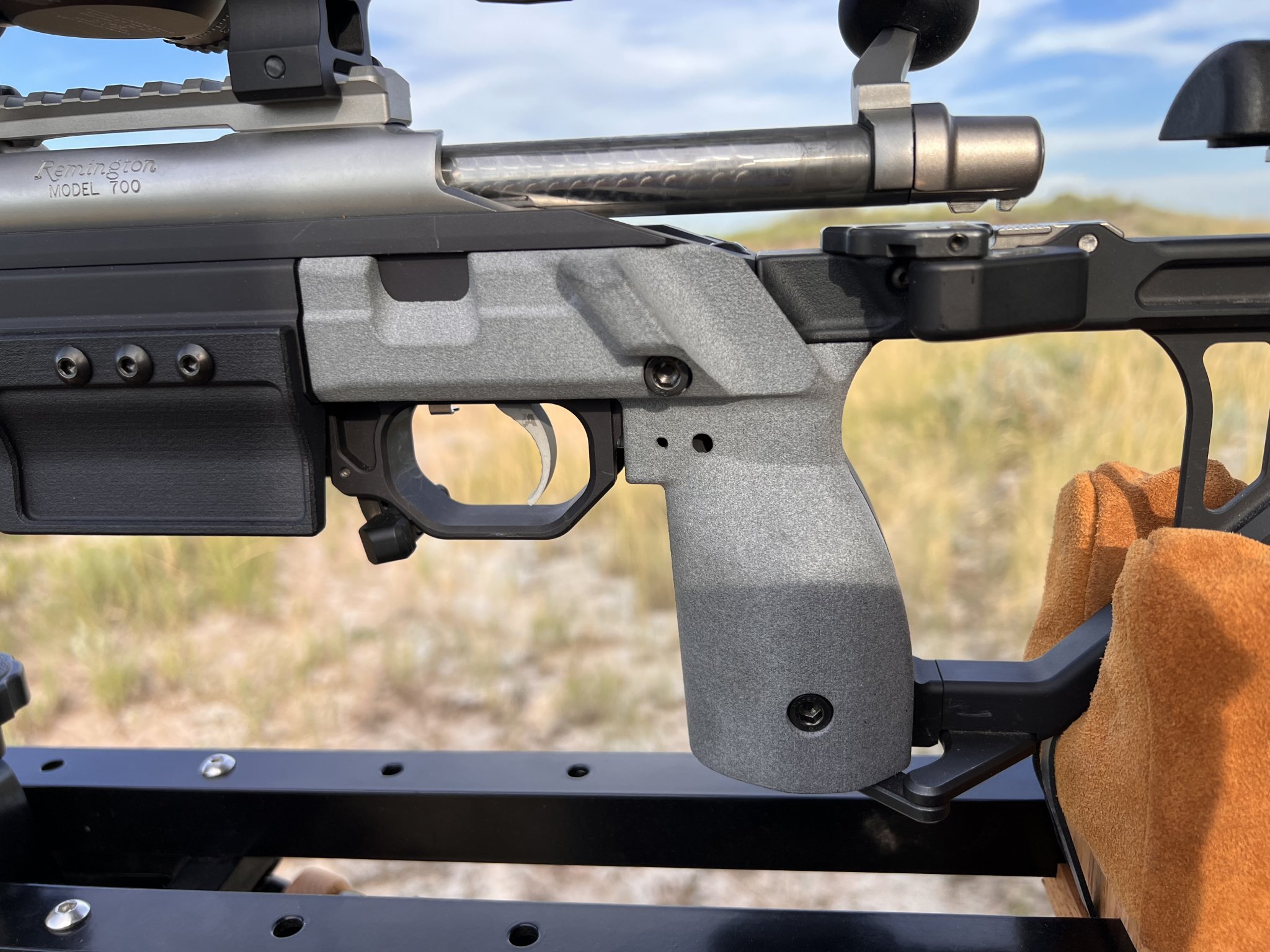

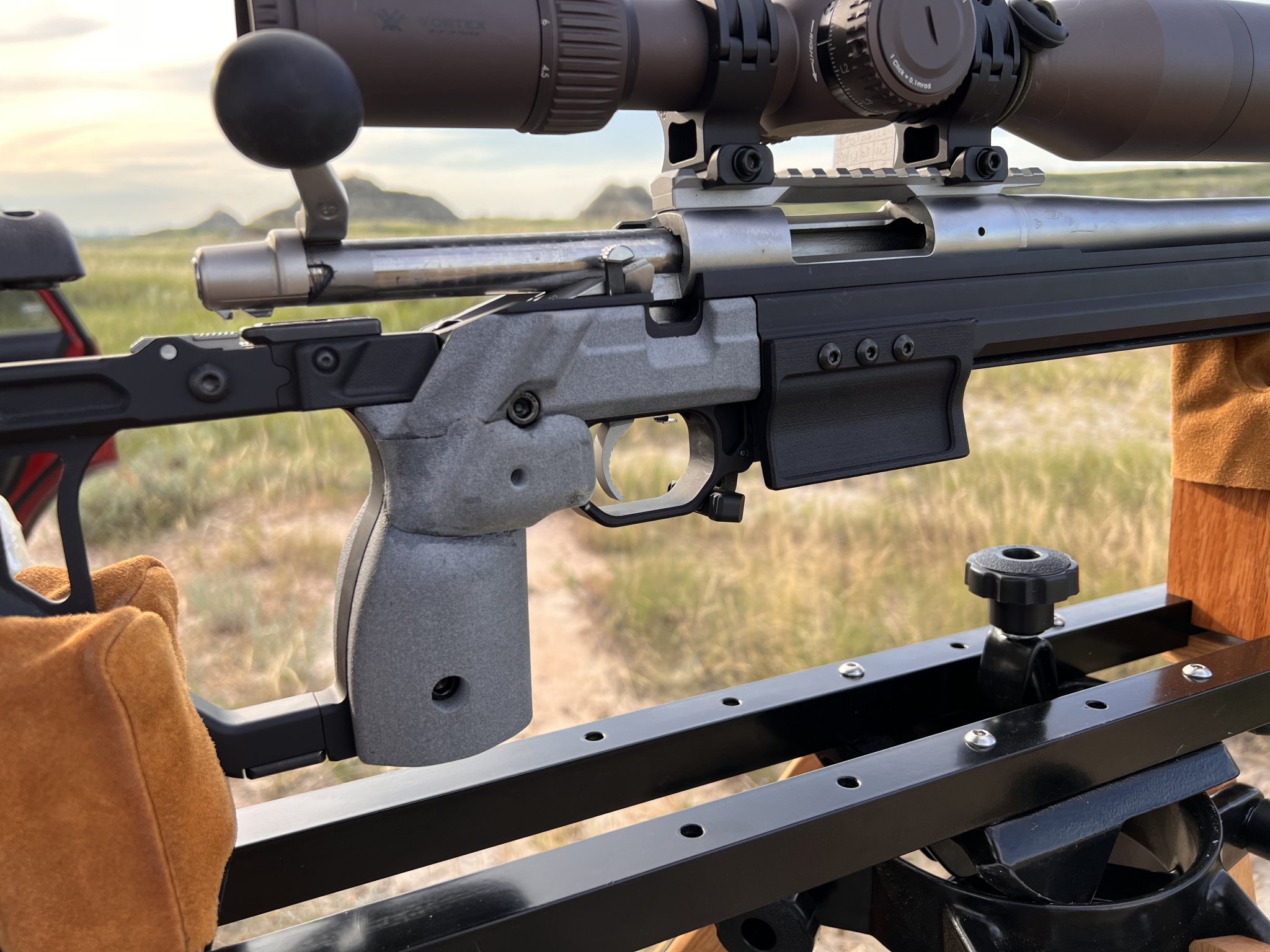

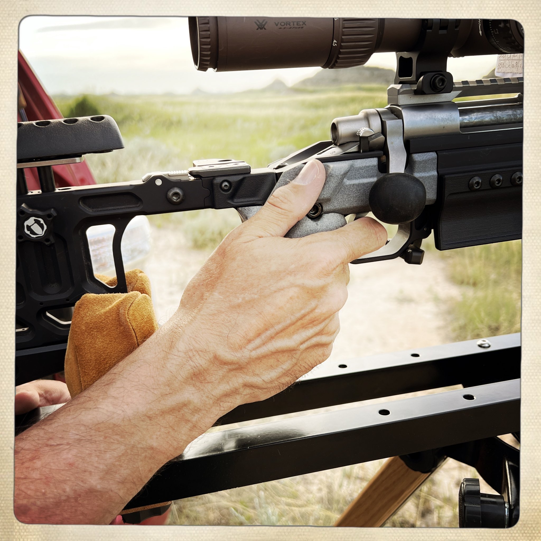

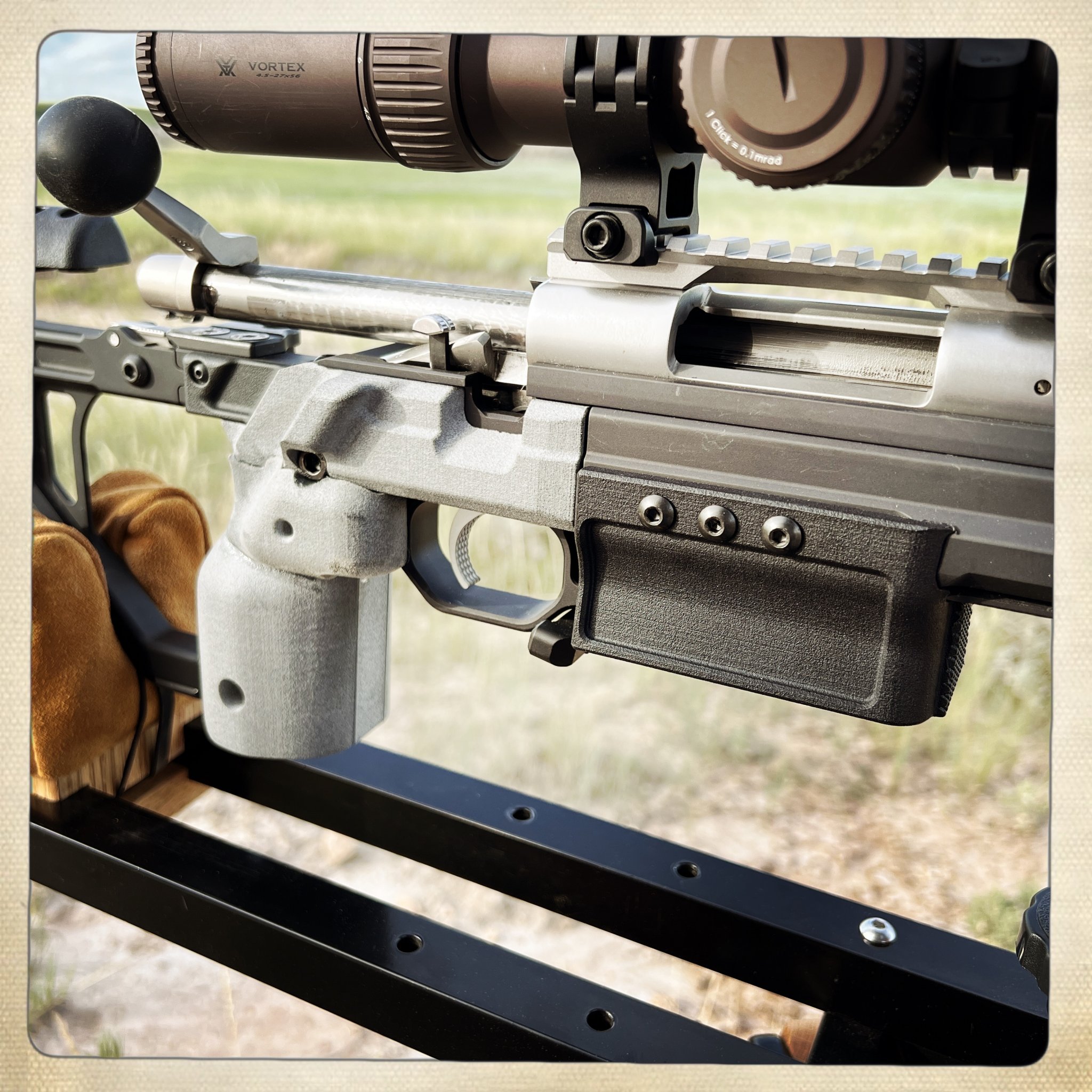

Ok, so I sent in my W3 to MK Machining / Tyler in April for him to scan it and to come up with some grips like I sketched above.
I am SUPER SUPER happy to say that the work he has done is amazing! I am going to write up a review and post it on a new thread, but here are some pics. He also gave me a flared magwell to try on my 9-day prairie dog trip in July.
The way it's designed is that the "index finger bump" is optional. It's supposed to screw on, but MKM forgot the screws, so I bought some epoxy and glued it on there. This is a prototype and I'm sending it back for him to scan again as I sanded it down in a critical spot, but I'll explain more in the formal review.
I told him it has really transformed the chassis for me. The finger-to-trigger distance and awkward factory thumb rest were the only thing sthat sort of bugged me about the W3, and Tyler's EXCELLENT work made this chassis super comfy. So much so that I need to get a thumb rest for my AIAX as now that feels sort of like ass lol.
MKM also forgot the correct bolts for the flared magwell, but hey, they're busy right? So I used some KRG bolts I had lying around. It too is a very nice piece, and it did help guiding the mags in. But more later.
Edit: Here’s a more in-depth review: https://www.snipershide.com/shooting/threads/review-mk-machining-improved-grip-for-krg-w3.7133930/
P.S. Forgive me my big rubber squeeze-on bolt knob lol

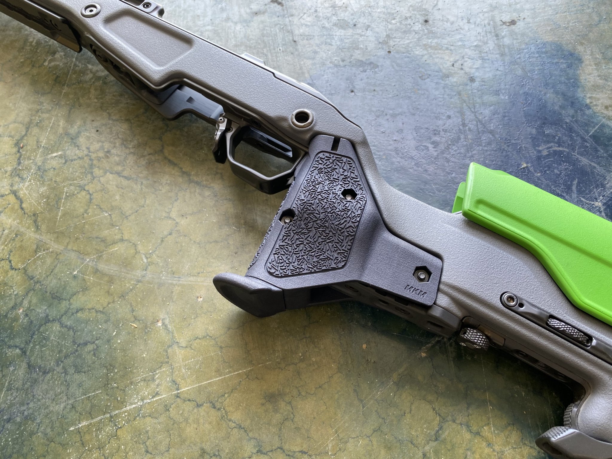

I did have my MKM JAE grip Cerakoted....now, dunno why J Allen Enterprises called this FDE...its sort of a grayish green. But, local vendor was able to get pretty dang close to the color of the rest of the furniture to the point that I'm happy and nobody looking at the gun noticed any difference.
I see your chassis is black so straight from MKM might be exactly what you want...but if you do ever want to Cerakote them, the Nylon 11 handles it very well. No problem.
Reactions: carbonbased
Thanks for the info. This new grip is made out of some ultra tough material. I think it’s not nylon 11; Tyler told me the name but I forgot it. I did hand sand it a little bit on one spot to customize it and it took literally about 1.5 hour of hand sanding (with a block) to remove an quarter inch.
Anyway, I’m sure they’ll offer it in a bunch of different colors. I’m going to send this prototype grip back so they can scan it with my small modifications.
