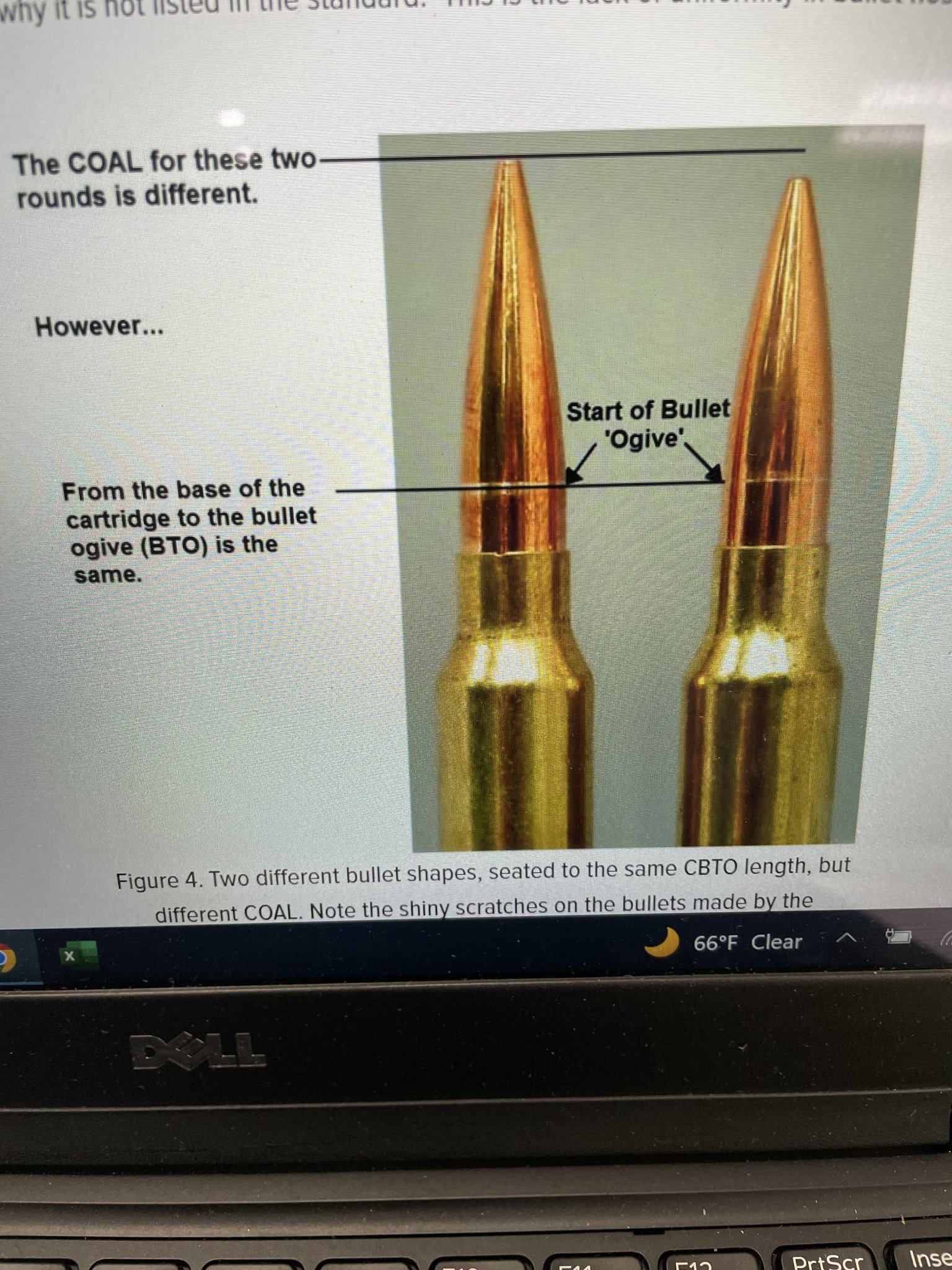

Thanks for the reply - what makes you certain it’s unsafe or a bad idea? The COAL differential would only be a reduction of .05 inches
That was short answer. Home from work now and have time.
Me, with my limited knowledge and experience. I would say no to you because you sound inexperienced.
But I would record all COAL on a number of rounds and average. Pull projectiles on a few and weigh charges.
Record data again and find out what powder it is and look at the available charts.
You said "308 sight unseen" and "vendor failed to mention the rounds are over SAAMI specified COAL".
Who are you buying your ammo from? Is it factory? Who? Is it reloads?
Non the less you should be perfectly safe to push them down .05 and shoot.
I would just personally pull some and measure because that's what I do. I just experimented on some tula ak ammo. I pulled a few and measured powder. Added a longer, heavier projectile and loaded to max mag length. I don't know the true accuracy but they shot minute of cutting edge in the field at 100.

Readers Digest version of 80+ posts: Measure at the ogive, since tips/meplats always have some slight variation in shape and aren't a reliable measuring point.
Ordered a Davidson Depth Checker with Base and a .30 bullet puller after some research on tools and hope to add some facts to all of this.
