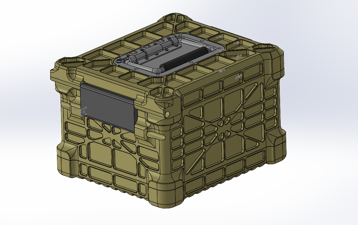

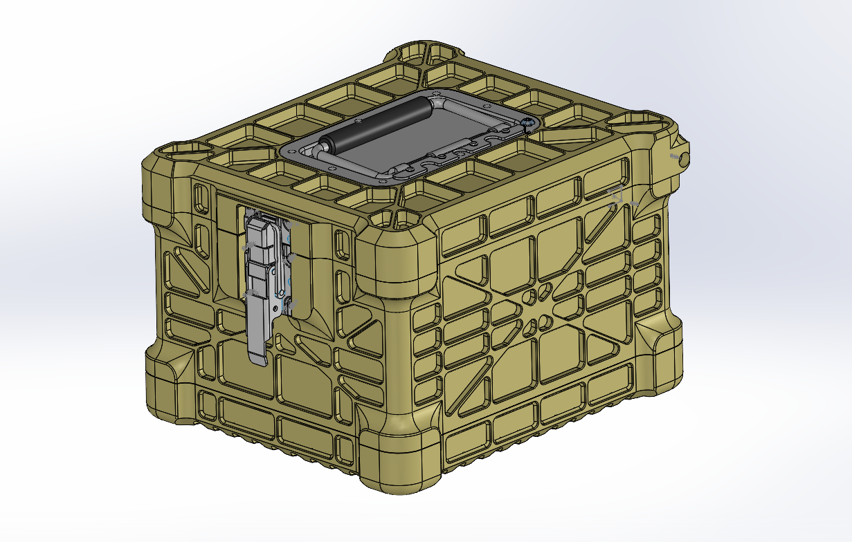

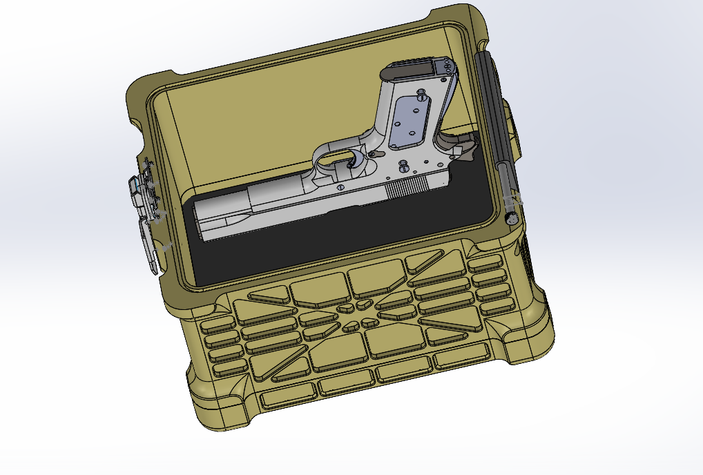

how do you guys like my billet aluminum gun case , can fit at least 3 pistols in it
planning on machining it soon . middle section will be wire cut out using edm
it will have an o ring around the top lip to keep it nice and sealed up

Carry handle is off center when it is deployed, the box will tilt and be a PITA to carry. The weight of the aluminum will magnify this.
EDM it last so that if you make a mistake you are not scrapping that sunk cost as well. And let us know the final all-in cost you think it will be. What are the dimensions of the raw stock you are using? Going with 6061?
You could just drill the corners and mill out the inside. If you have the skills for the outside you have the skills for the inside. A lot of the machining in there isn’t precise work it’s only removing material.
Reactions: LeftyJason and TACC
the inside is 4"+ in depth and I need a small radius if I where to use a .75 em it would have to be 5 times D , that em no matter how slow you go will chatter and be mega expensive . and if I edm the inside I get yet another big block of alum out of it instead of turning it into chips
I do that deep with a standard 3/4 reduced shank EM frequently, no chatter. But I get it with the extra block. Good luck.
