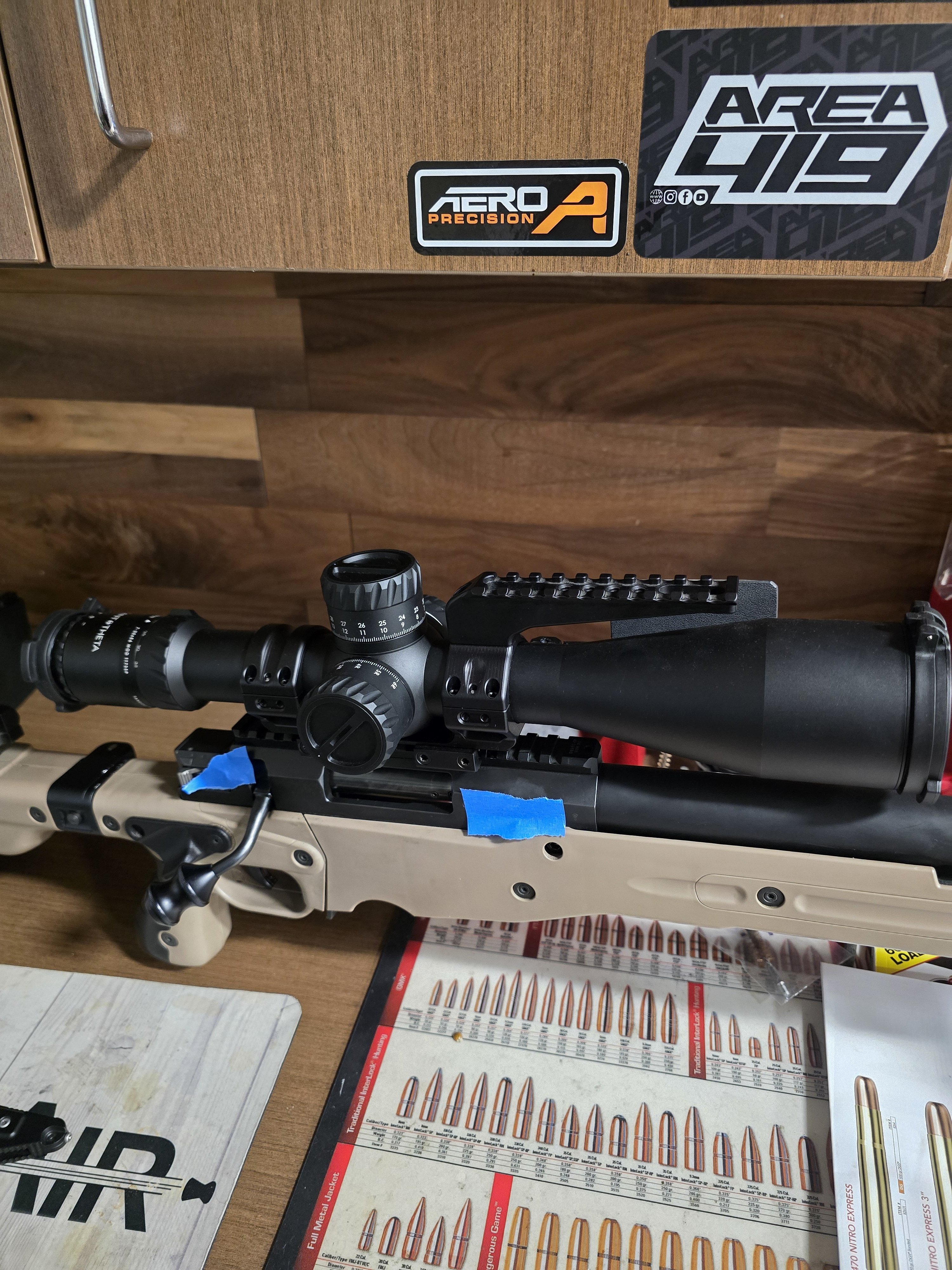

Just received my new area 419 scope mount along with the send it level the area 419 mount for it and there level. I'm very impressed with packaging and quality. That is a very good setup. I torque the the base screws down but never fully torqued the ring cap screws just doing mock mounting. The pins on the scope rings really help with pulling the rings straight down and the screws being snug the scope wouldn't move at all I had to have them very lose to move it where I wanted it. I'm coming from ARC scope mount which are super handy to mount scopes but I feel the area 419 is just as easy.

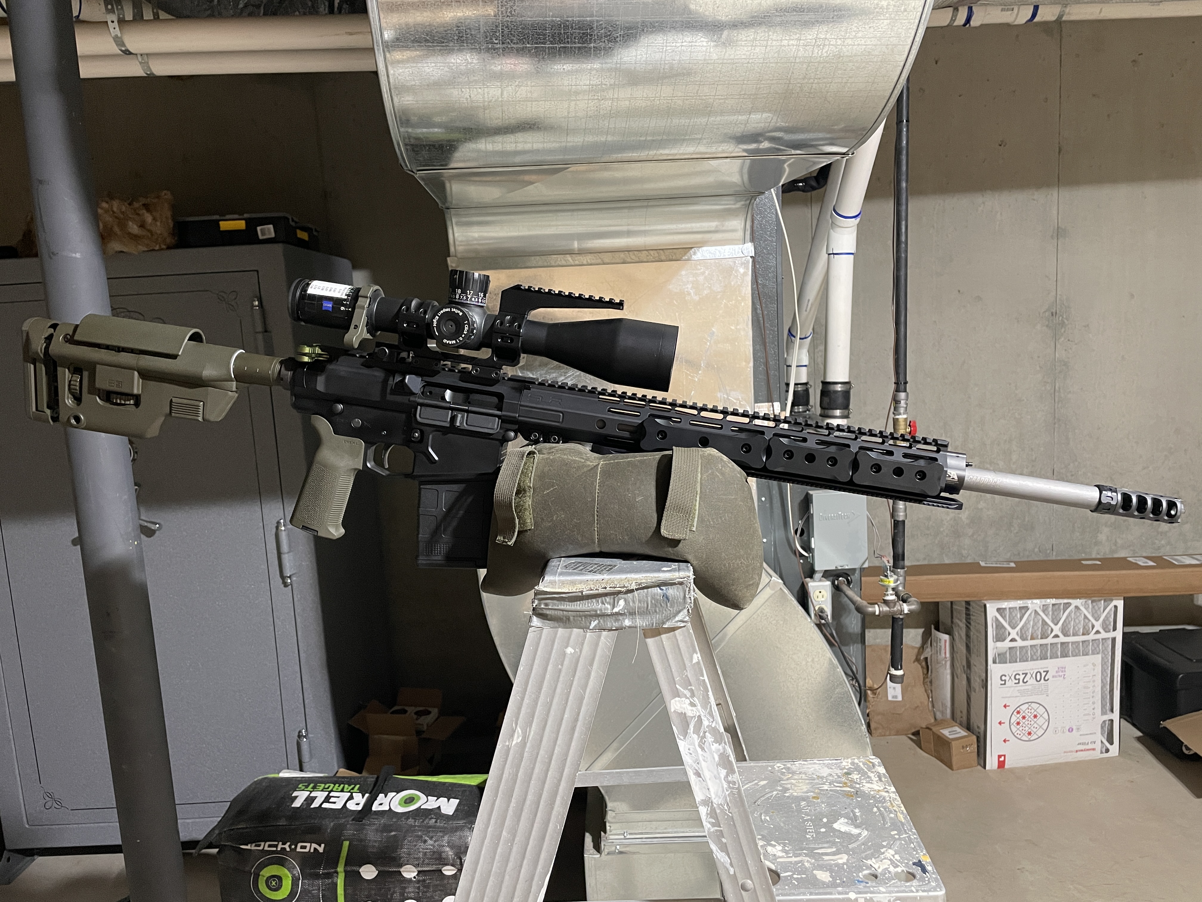

I decided to try the cantilever A419 mount. Already have Grey Ops and Spuhr and Badger and NF.
Anyone else running them on an AR?

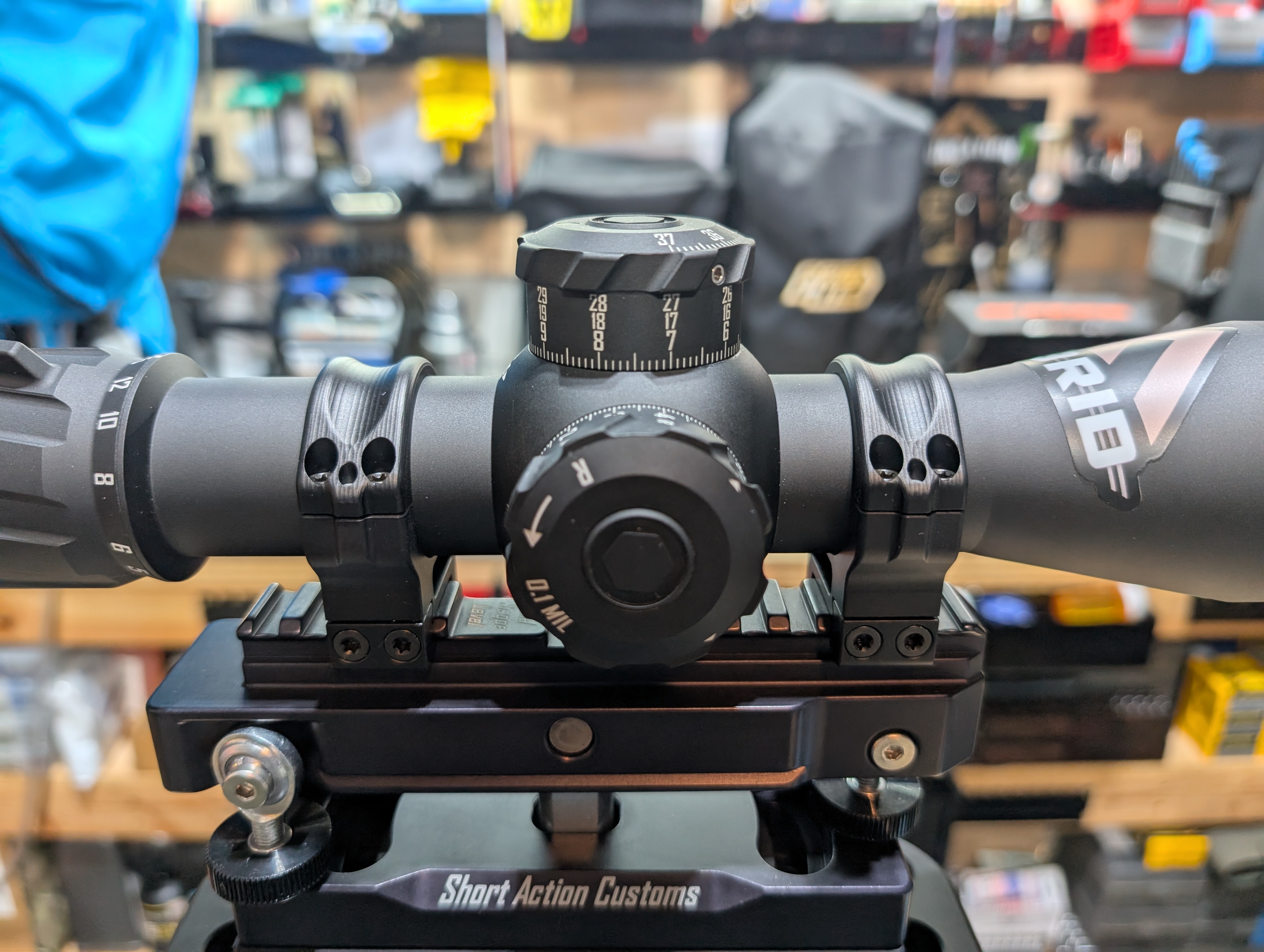

Rotating your scope in the Area419 mount is close to impossible due to the bare aluminum. Just keep that in mind when installing.

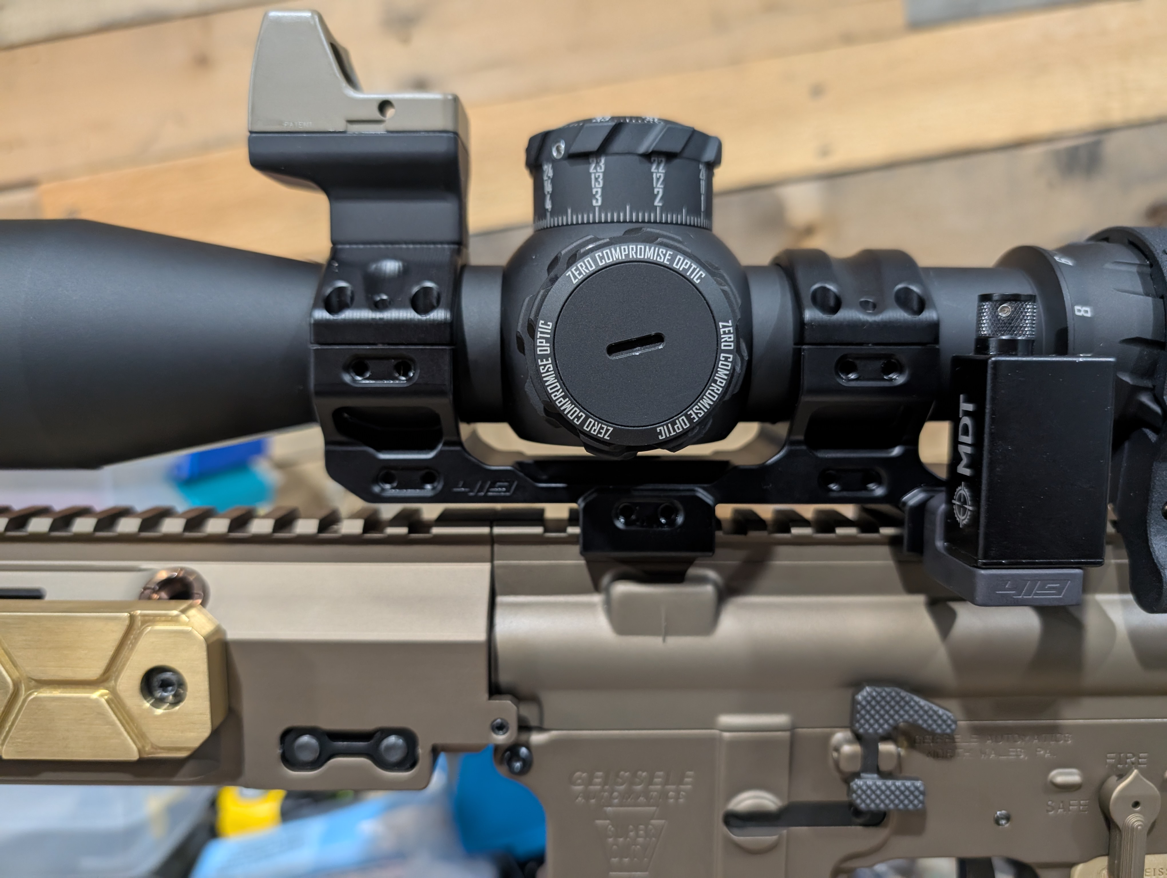

After getting to play with the A419 mount, I think its one of the better options out there right now. Especially at its price.
The mounting system for accessories is superior to Spuhr and grey ops. The fit and finish is better IMO as well. Grey ops had a run of non de-burred mounts that screwed up some guys I know scope finishes. Kinda shouldn't happen on a $400 mount. I used a duburring tool on all the fasteners holes before installing mine just in case.
The only knock is the accessories are a different anodizing/finish than the mount. The mount is like a smooth glossy finish anodizing. The accessories are a more greyish matte finish. Almost like they used Type 3 anno on the accessories and type 2 on the mount. Not a big deal but just stood out as weird they would be different. Maybe @flyer1a knows why?
All in all , its a VERY well designed and executed product and It will probably be the mounts I go with in the future. At the price point, its an easy choice for value and overall quality.

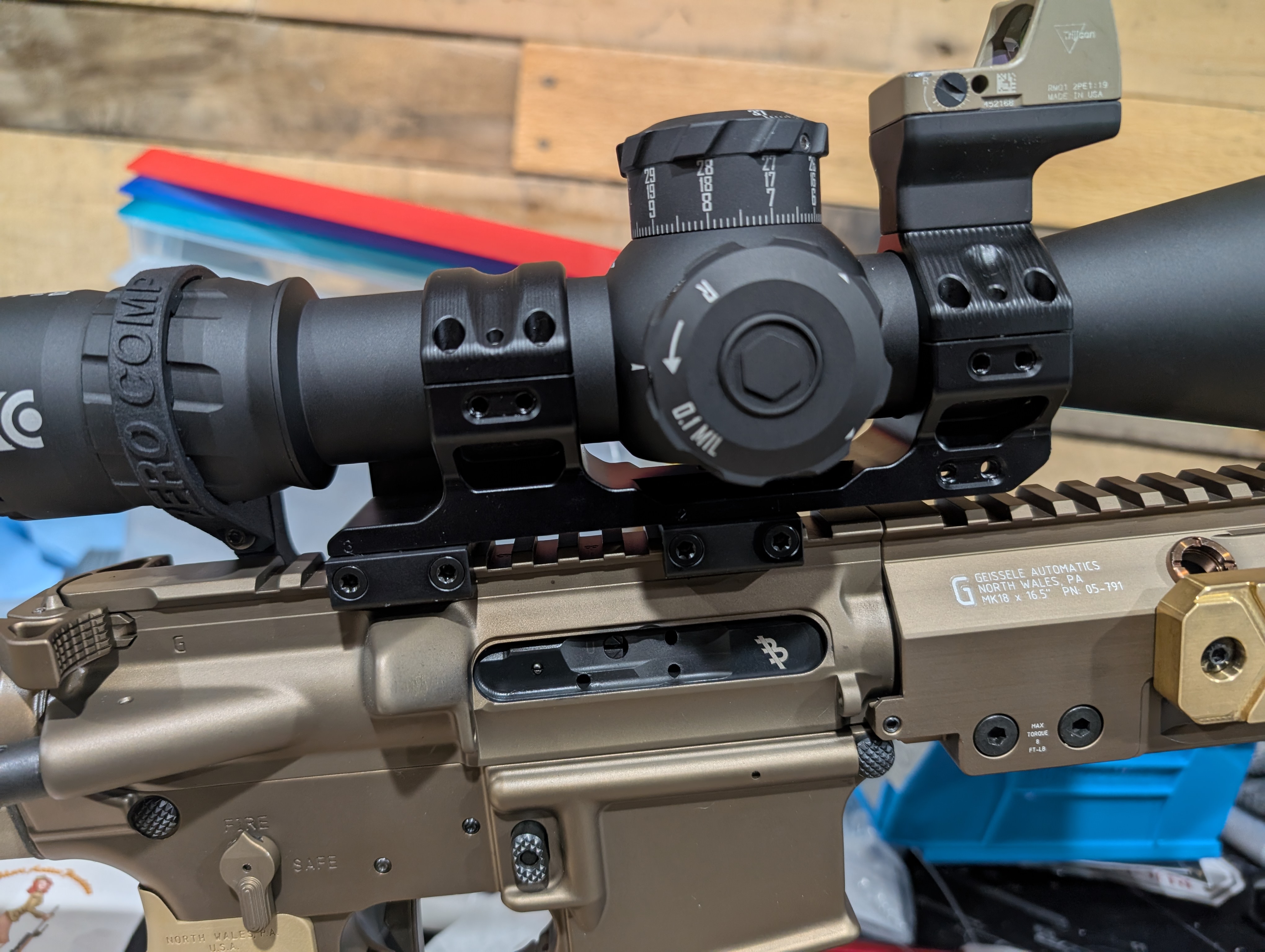

Interesting. My ACRO mount isn’t even at the ring at the rear, but I see your RMR plate is. Odd choice and I’ve had preferred the ACRO mount be even with the ring at the rear - the overhand caused me some fitting grief.
Send me a photo of what you're talking about. Seems like there may be something going on with the ACRO mount (if it's one of ours, and I've not missed some context).
Can throw in the chat here, or PM me, or email, maybe even a carrier pigeon? Your call.
