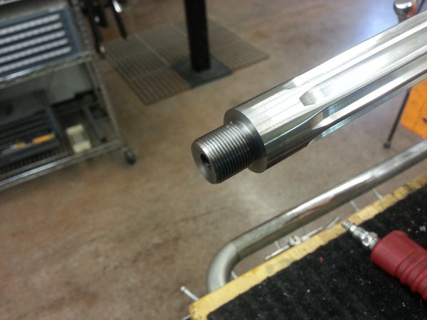

Muzzle threading Thompson Center break action single shot rifles the LRI way. :)

Will your 5-axis setup work for any barrel without having to break it down from the action? If so, how much do yall charge for this? I have about 8-10 bolt-action 700's that need threading 5/8x24. What's the turn-around time?
The desired thread dia/pitch and caliber drive this boat. For instance, a 416 caliber barrel and a half-inch thread would likely result in one hell of a party...
ok lets refine the question whats minimum wall thickness for threading and or maximum caliber for a 1/2-28 thread?
As a cardinal rule, I maintain at least a .100" wall thickness between the root of a given thread to the groove diameter of the barrel.
The root diameter of a 1/2-28 thread is .455". Subtract a .100" wall and were in the .255" range. So, basically, a .25 caliber cartridge is the biggest a guy should go.
There are some exceptions to this. If were talking a 300 Blackout I'll typically let it slide just because the pressure of the cartridge is lower than a 308 or whatever. I break the rule also based on barrel length. A 16" 7mm whatever magnum isn't going to play so well where's a 28" 7 Rem Mag will work just fine as the pressures are down quite a bit by the time it hits that part of the barrel.
The sole purpose behind this is to avoid a dreaded situation where the last 5/8" or so of the muzzle starts to bellmouth due to the thin cross-section of the steel between the groove and root dia of the two features. We went through hell with this 2 decades ago when I was at Dakota Arms/Nesika.
Yes and no. The limiting factor is the physical distance from the chip conveyor on the machine to the max height where I still have all the room for tools. A gross example would be say something absurd like a 50 caliber with a 40" barrel. While it will physically fit inside the machine, I don't have enough room to "get to it". Not without poking a hole through the bottom of the machine with a post-hole digger anyway. :)
On a typical LA were limited to around 24". A SA will do 26"

On this subject, in your opinion, would it be best to take a 26" sporter barreled 7mmRM and cut it back to 22" or so and thread 5/8x24, or is it safe to thread it 1/2x28 and keep it 26"? I don't want to direct-thread a can, but want to install a Dead Air KeyMount muzzle brake. Then use that to mount my suppressor. So there will be plenty of hardened steel around the muzzle threads. It's a Remington 700 "magnum" sporter profile.
Well, that's kind of opposite of what I have... All of my LA's are 26", and my SA .308 is 24"... So, the .308 Win could be threaded without being broken down. The reason I was asking was because it would be way cheaper to not have to break-down already custom-built rifles just to thread the barrels. Unless yall don't charge anymore to do this and reset the headspace where it was?
The expense is minimal and pulling a barrel from a receiver is so trivial for us anymore that it's not a big deal. LRI does not suffer from a "tooling shortage" when it comes to tearing stuff apart. If it's a "new" job to us, we just make the required stuff on the spot and move on.
Regardless of how we get there (lathe or mill) it's a very fundamental process for us.

There's a number of ways to skin this cat. The turning center I have (cnc) has a 2..25" dia spindle bore. The hydraulic drawbar running through it reduces it to around 1.75" ID as collets/chucks thread onto it. It whittles down to where I can only use a 1-5/8 dia collet. Just not big enough for the TC type barrels. This was my reasoning for pursuing this on the mill. It saves me the expense of putting another machine on the floor.
Pulling the barrel from the action doesn't take much time, and there isn't any change in headspace after re-assembly if the thing was screwed together properly to begin with (i.e. the last gunplumber who touched it didn't do something stupid like glue the barrel 20° shy of tight with threadlocker). In almost any case, it'd be less hassle than adapting an unconventional machining practice.
If you did want to leave the action in place during muzzle threading, a standard R700 receiver body will typically fit down the lathe spindle once the bolt, trigger, and rail are removed. I've done this in the past when not wanting to break loose an original barrel, because the factory torque spec for most manufacturers is approximately a bazillion lb-ft and so sometimes I just leave 'em alone.
Using Chad for your gunsmithing needs is a great idea; just let him pick the appropriate method.

My turning center lacks the spindle bore diameter to do these. Up until about a year ago we had to decline this type of work just because I lacked the resources.
5 axis mills solve this pretty easily... We've been vetting this process now for about a year with killer results. Kinda neat.

As a general rule, we try to avoid treading muzzles where the diameter leaves almost no shoulder. My reasoning is that if a brake is being installed, it's very easy for it to become over-tightened. This always results in a clocking error. On a brake like the Badger FTE, it's of no real consequence because of the clamp screw hanging off the bottom. A brake like the one we make however creates a situation where clocking problems can arise. In cases like that, we've "glued" the brake to the barrel using epoxy. We've never had one come back, but it's still something I try to avoid when possible.
In my mind, the most important thing is to try and retain as much wall thickness as possible between the bore and the root diameter of the threads.
