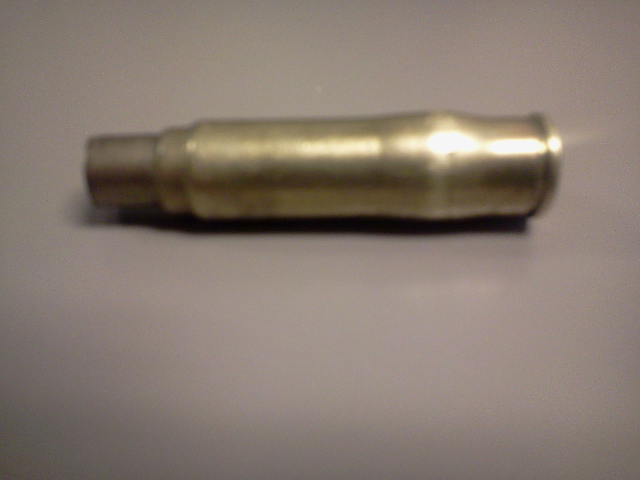

Think my new 6.5 double shouldered bulge-body primer popper will catch?
Someone with no reamer, no 6.5 Arisaka Ammo and a drill bit tried this one.
Wondering WHAT they were 'shooting' for?
Well.... yes 'WOW' is one way to put it. It's (as stated) a 6.5 Arisaka that was a bargain basement buy at 60$ in a decent Bishop walnut stock.
After doing a little measuring here and inspecting there, should be able to go right in and make a 6.5 CM out of it and get rid of all the trashy stuff. Magazine lips in the receiver and the follower might provide a little challenge, but all in all I think it will turn in to a rather nice little 'can we save it?' project that should take me back to my roots of quality military conversions and saving the bubbae'd surplus guns. It will make the owner seriously happy and the best part is, the bore is really quite nice after a good scrubbing.
