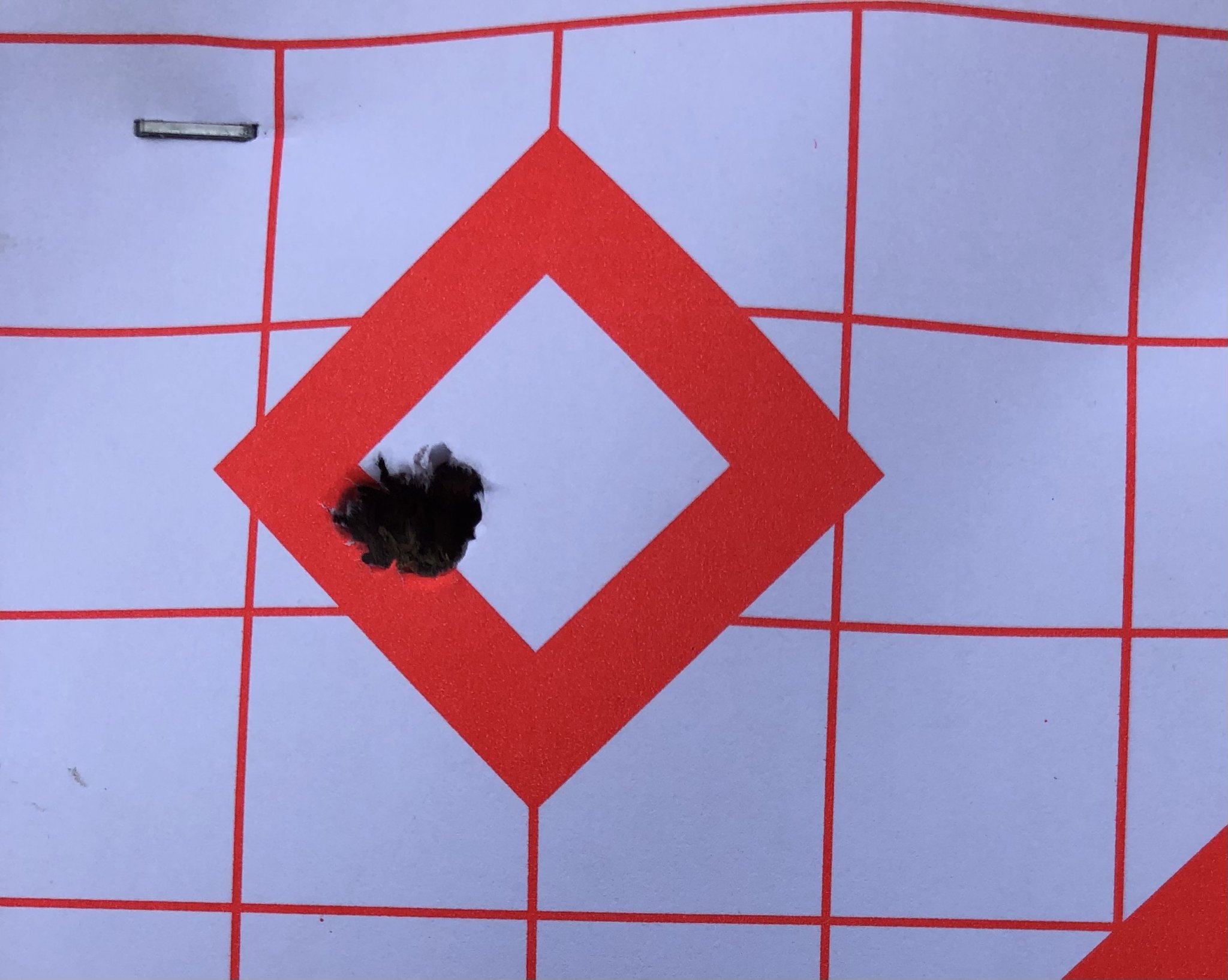

I truly dont know what you’ll are discussing about barrels. This is strictly a response to you asking if anyone has ever seen a .1 or .2 group with an impact prefit. The pics are of a “10 shot group“ on a bipod & Caldwell rear bag. I was shooting fairly fast as it was cold. It was just a mag dump for break-in. These are break-in loads with no load development + I would imagine most of you shoot better than me. I’m just an old man who enjoys shooting. Just posting so that you can see a pre-fit is very capable of what you said. No disrespect & send you best wishes. I think we are in a wonderful era with multiple good choices today. The best thing is I don’t have to send my rifle to a gunsmith for a new barrel.
Reactions: ormandj
That’s a pretty wild 10 shot rapid fire group with no load development. There are very few people I’ve seen that can produce ten shot groups like that even with meticulous load development at a reasonable pace, much less untuned loads doing a magdump. So kudos to you; you’re way underselling yourself as a shooter. I very rarely see anything under .4 5-shot groups on this site.
