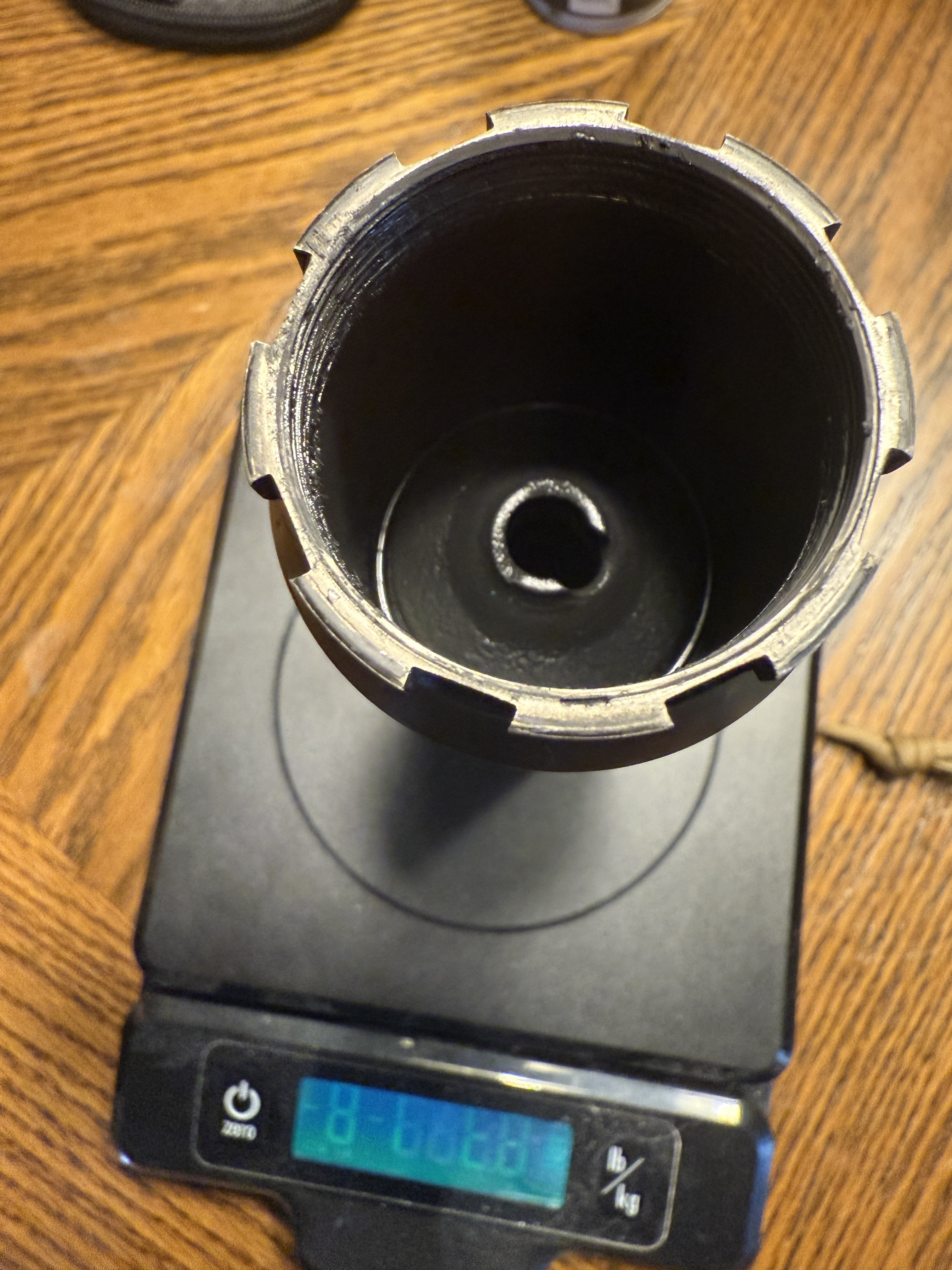

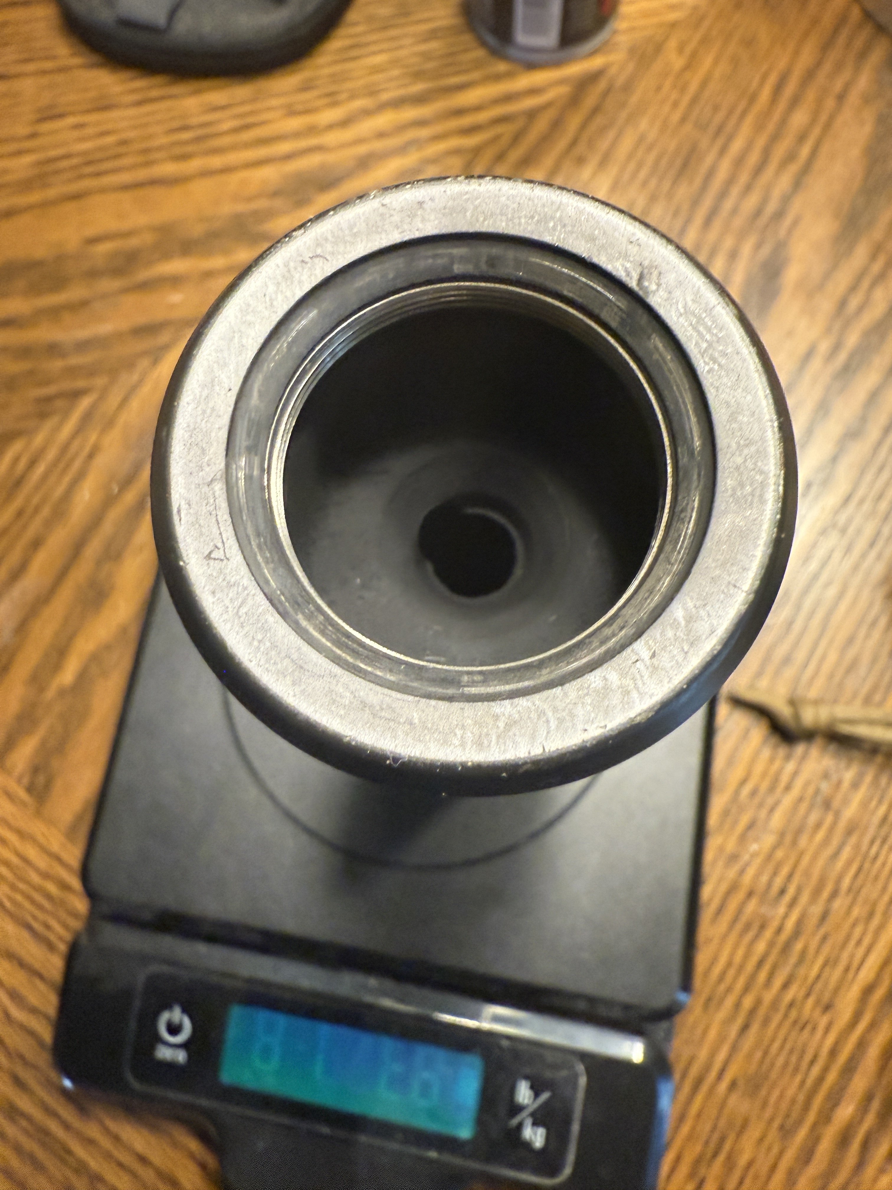

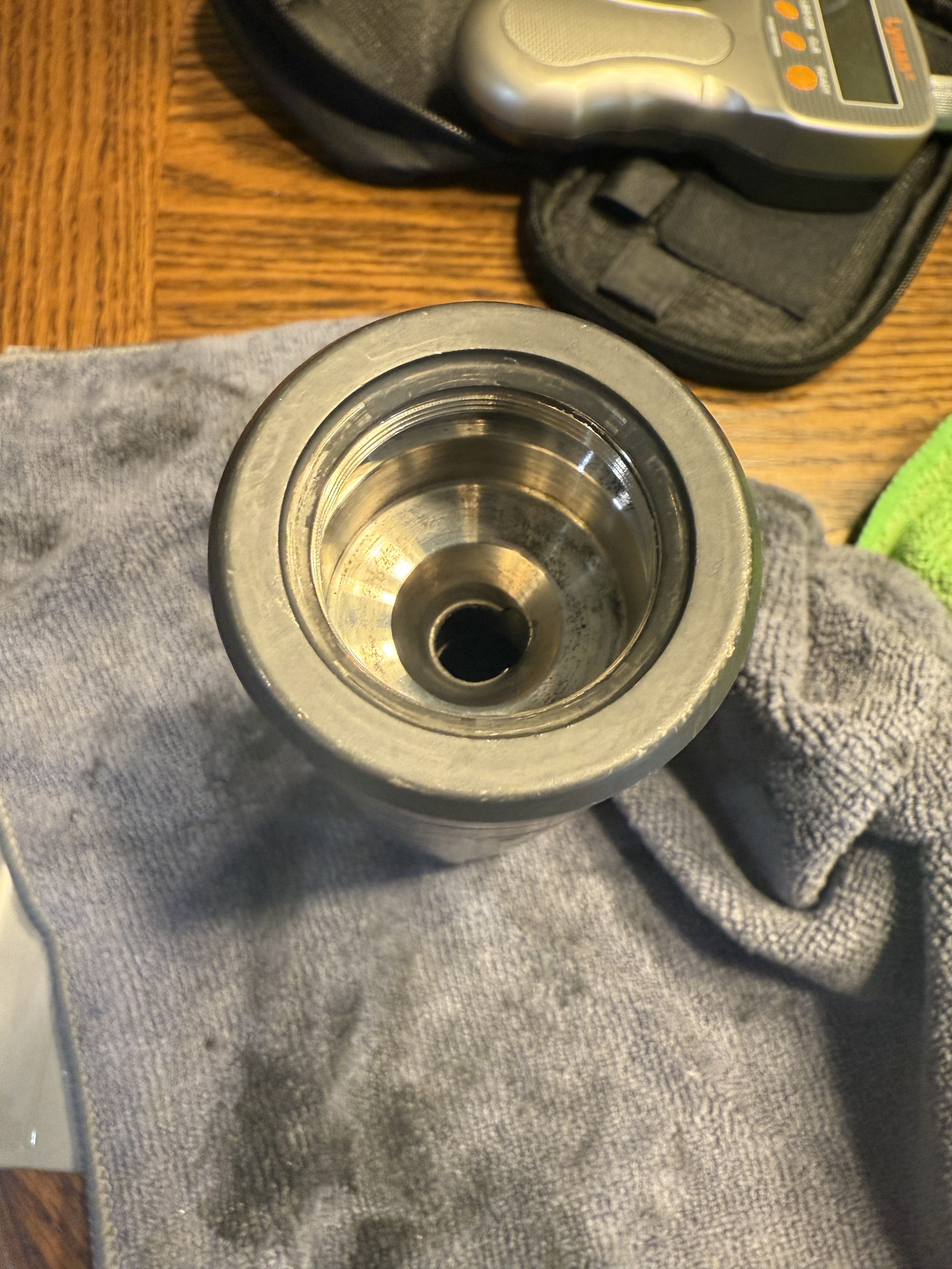

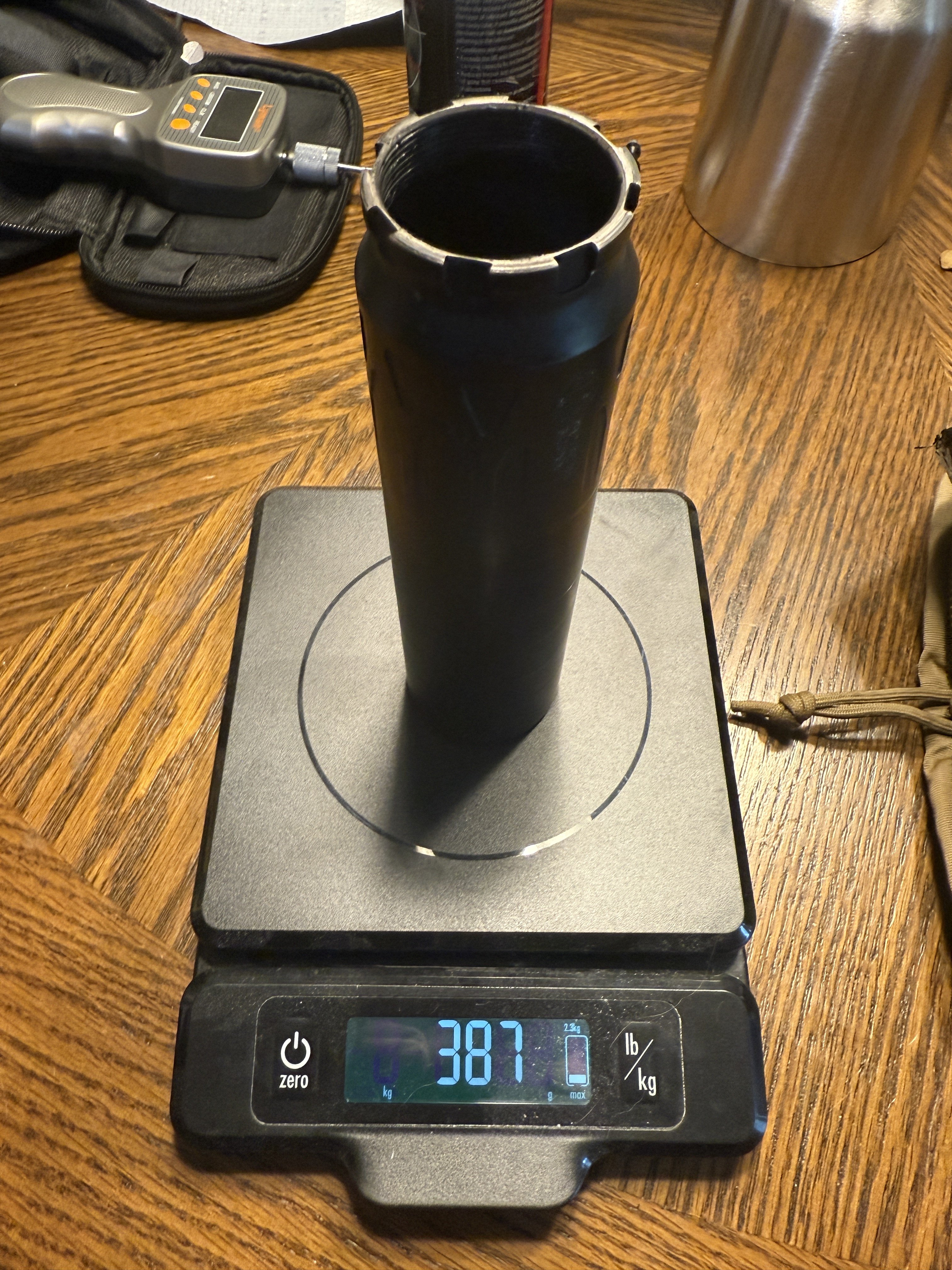

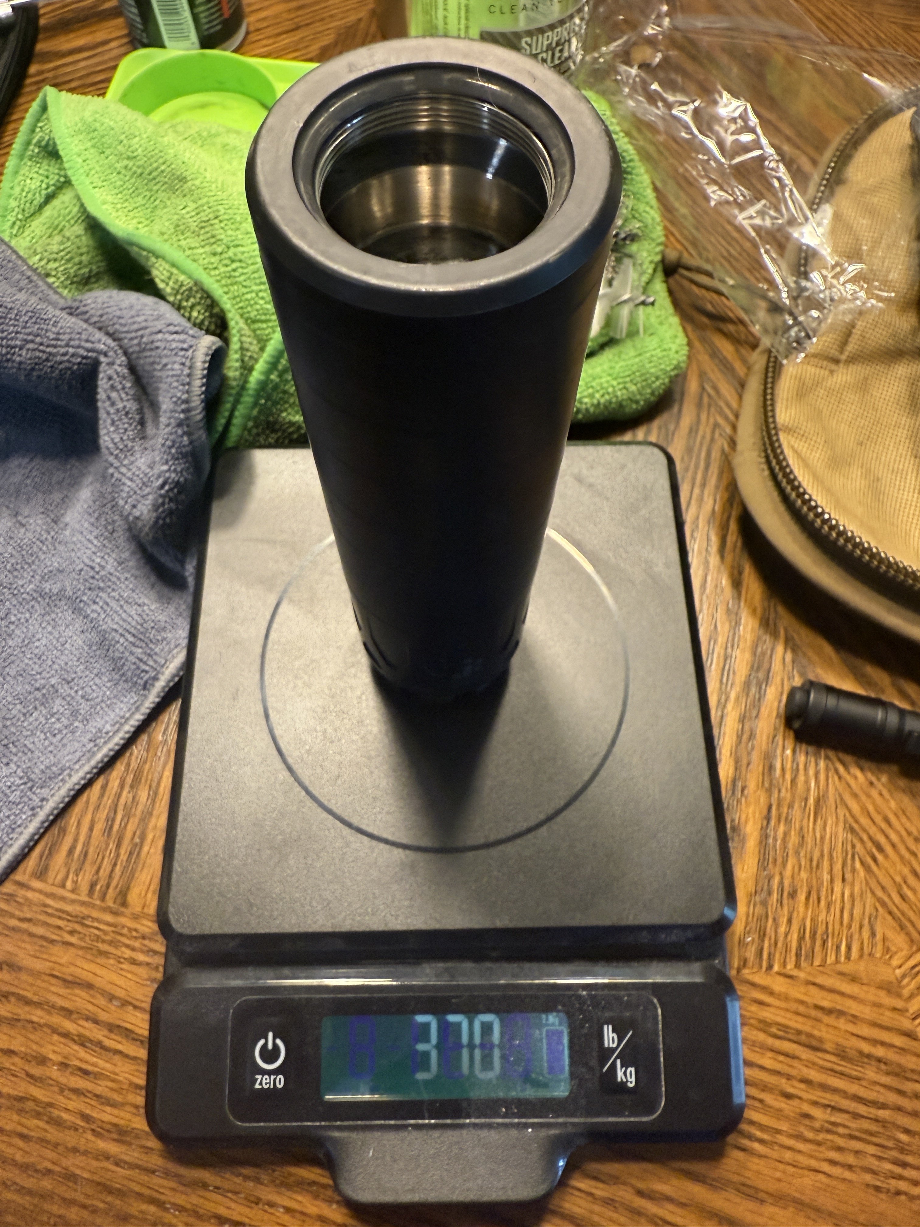

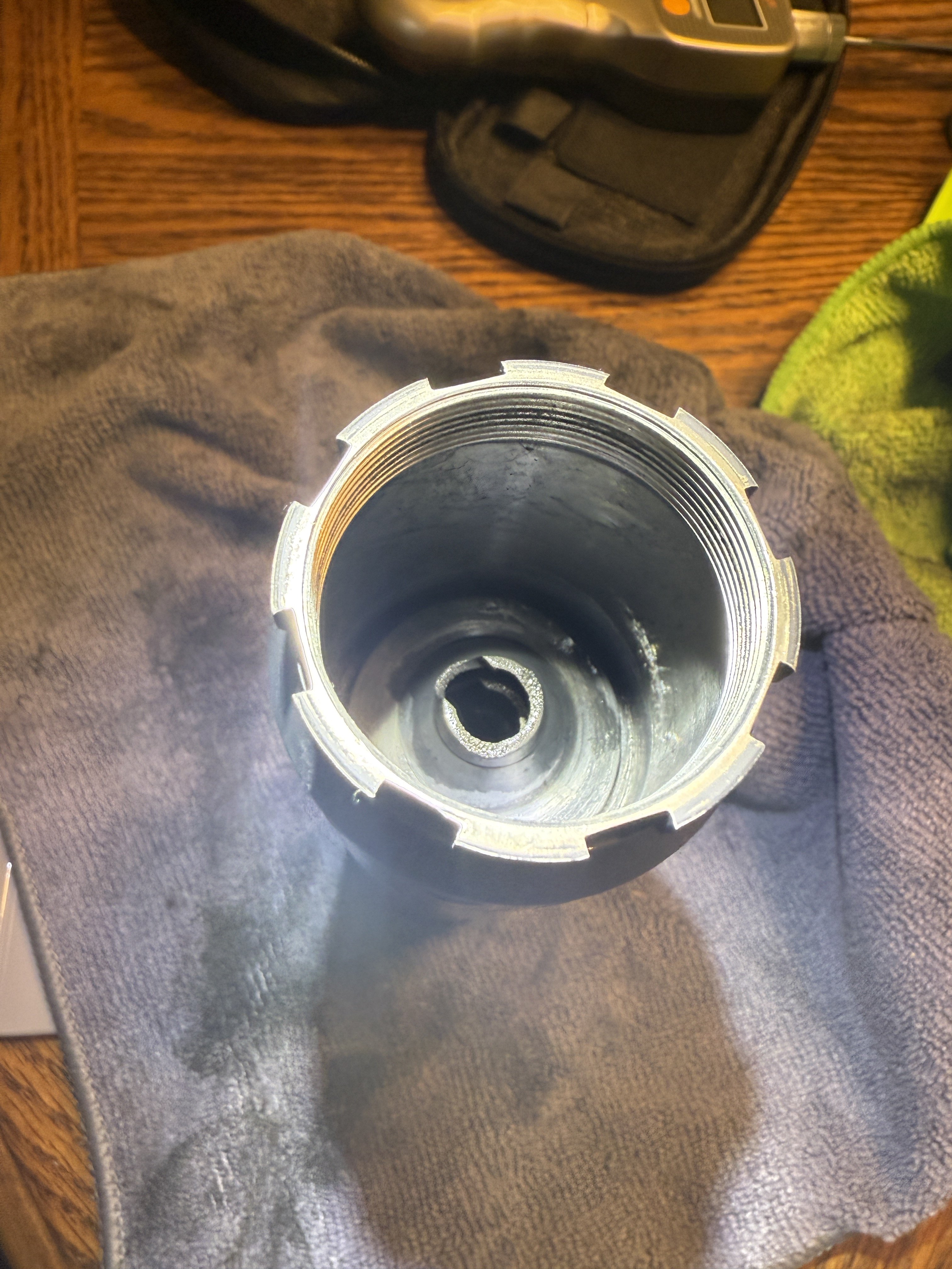

I tried the Breakthrough Suppressor cleaner kit on my Nomad-30. I'm pretty damn impressed. Soaked it for 24hrs and it got pretty clean, soaked it for another 20hrs and it got even cleaner. Required minimal cleaning with a brass brush. Weighed 17 grams less after cleaning.
Before...
After...
Didn't weigh my Sandman S or Sandman Ti before I did the same with Breakthrough a couple months ago. My Nomad Ti didn't gain all that much from when I got it. Mostly use that one on hunting rifles so I didn't bother cleaning it. But Breakthrough works quite well. I soaked the Sandman Ti twice, first time for 48 hours. After looking in the can with a borescope I soaked it a second time for two weeks. Would shake it around every day to agitate the fluid in the can. Literal chunks would come out when rinsing. I'll clean them again during the winter time when I am not shooting.

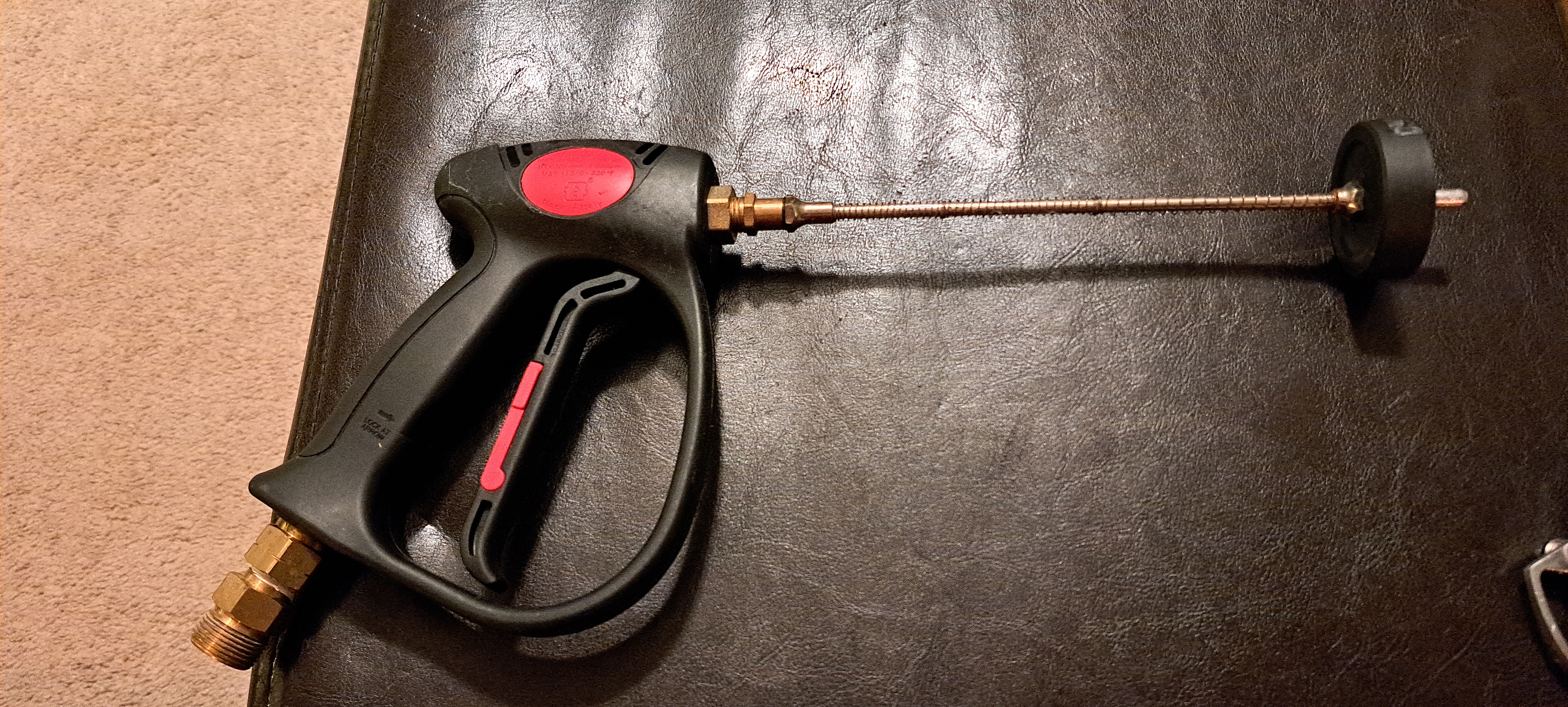

I also want to give Boretech a try, but mostly to get the pressure washer wand that is designed for cleaning cans. Flushing the can clean at the sink is not that great. Actually it sucks.

Just let it sit in the solution for 24hrs, used a brush and hot water and it got 90% of the way. Let it sit in the solution for another 20hrs, used a brush and hot water, blew it out with air and called it good.

Cleaned my OCL Hydrogen with Breakthrough’s suppressor cleaner. I plugged one end of the suppressor filled it with the cleaner and then plugged the other end. I just let it soak for 24 hours, rinsed and repeated a second time for 24 hours. Weighed 13.47 oz when new, 14.64 oz before cleaning and 13.86 oz after cleaning.
The inside of the suppressor was very clean, but there was still some carbon stuck where the baffles meet the walls. May be next time I may try using my ultrasonic cleaner to see it will break the carbon in those areas loose.
