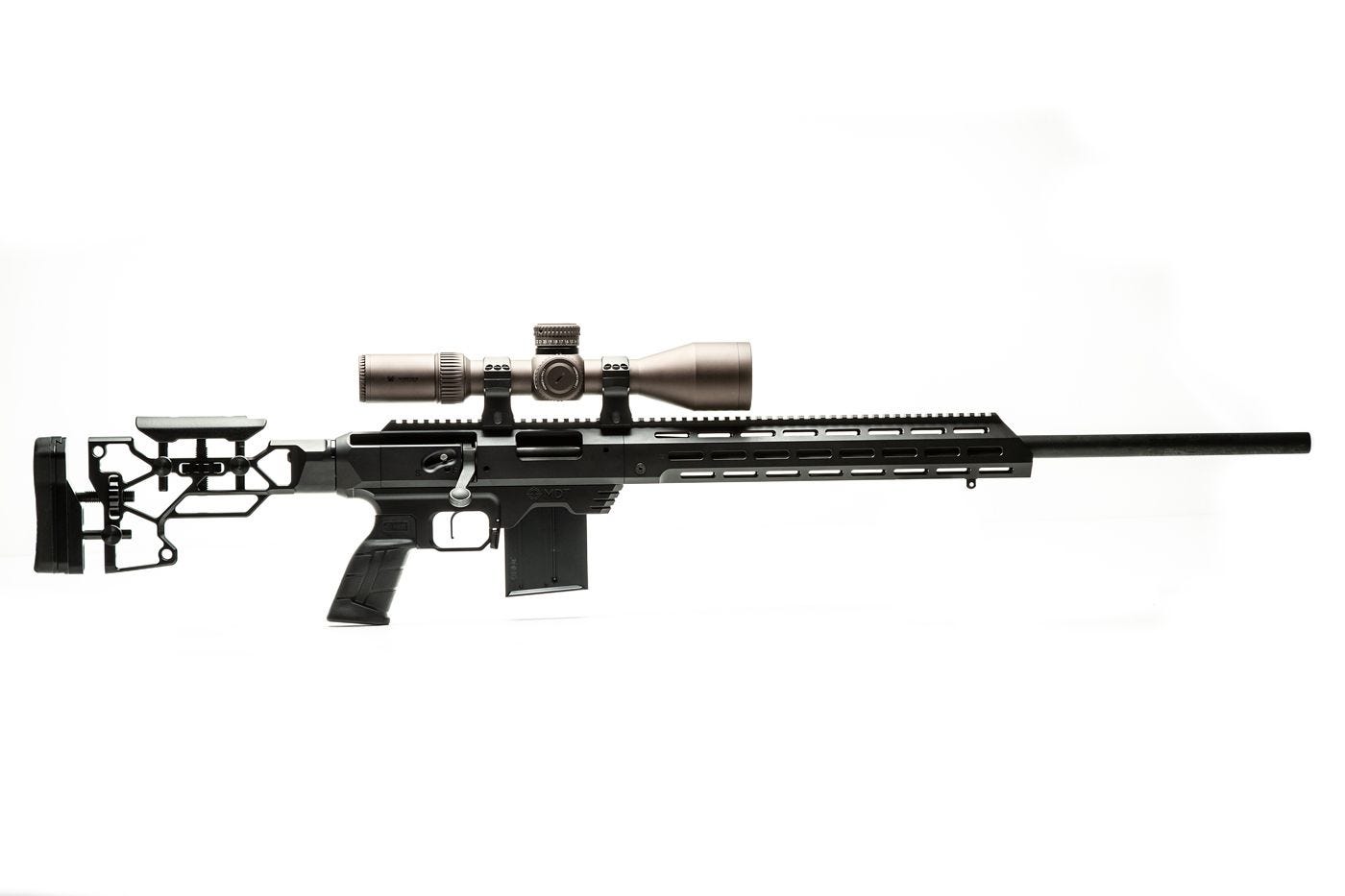

what do you mean by 'inline recoil style'? the relationship between action/barrel and buttstock is no different than other chassis/stocks...but the TAC21 is odd/weird and there's reason it was cheap...it's the same reason i've never seen one in person over the last 4-8 years of shooting precision rifle matches or even at the range
the TAC21 will work with a normal rem700 which imho isnt worth the investment compared to an Origin/Nucleus (which may or may not even fit in the TAC21)
No, it isn't. The TAC21's bore centerline is well below the top of the comb at its lowest. It's like a Tube Gun chassis in that regard. Most chassis on the market have the bore centerline above the top of the comb at its lowest. These two pics make it obvious.
Not saying I want one, but there are some significant design differences between the TAC21 and almost everything else.
It has a significantly lower recoil axis than any other chassis system I know of, which is also why it does not accept actions with an integral pic rail.
