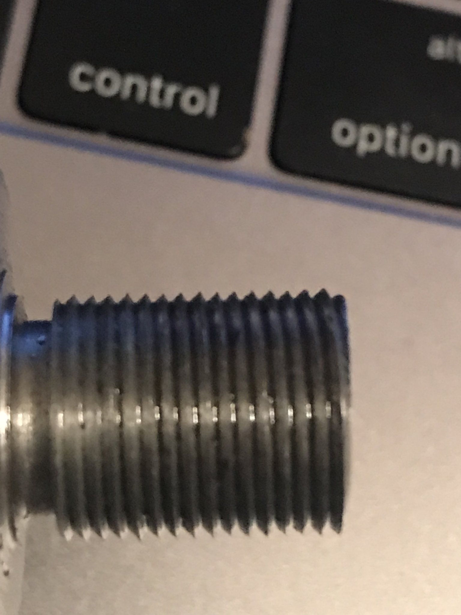

I’ve been working on threading some muzzles, however my threads come out with a forward angle towards the muzzle, rather than straight up and down. Any machinists know what I can try differently?
29.5 degrees on the compound, tool squared to the work piece via fish gauge.
Threading 1/2-28

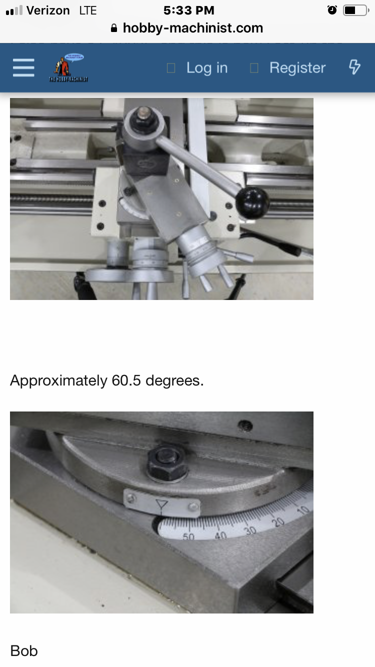

I'm guessing your compound is set at 60 degrees instead of 30. Some lathe compounds reference the angle with 0 degrees being with the compound feeding straight into the work. Other lathes are referenced 90 degrees from that where 0 on the compound feeds straight along the bed.
Is your compound pointed more at the Chuck or more across the bed? It should be pointed more across the bed.

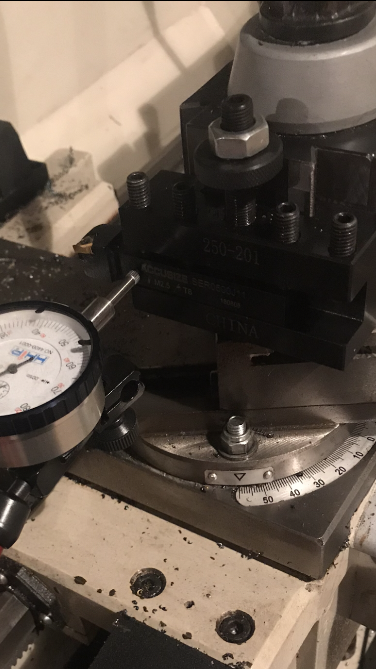

It’s one of those compounds where 0 degrees is feeding straight into the work. I have it set just a hair past 60 degrees on the compound. Yes, I’m feeding in on the compound.
I stick a magnetic base on the back foot of the carriage and run a test indicator on the tool itself(not the holder it’s clamped in). When you run the cross feed back and forth, the tool should be perfectly perpendicular. More accurate than a fish gauge. If that’s correct, your insert holder may be bad.

Compound was at 60.5, I just loosened the bolts temporarily*

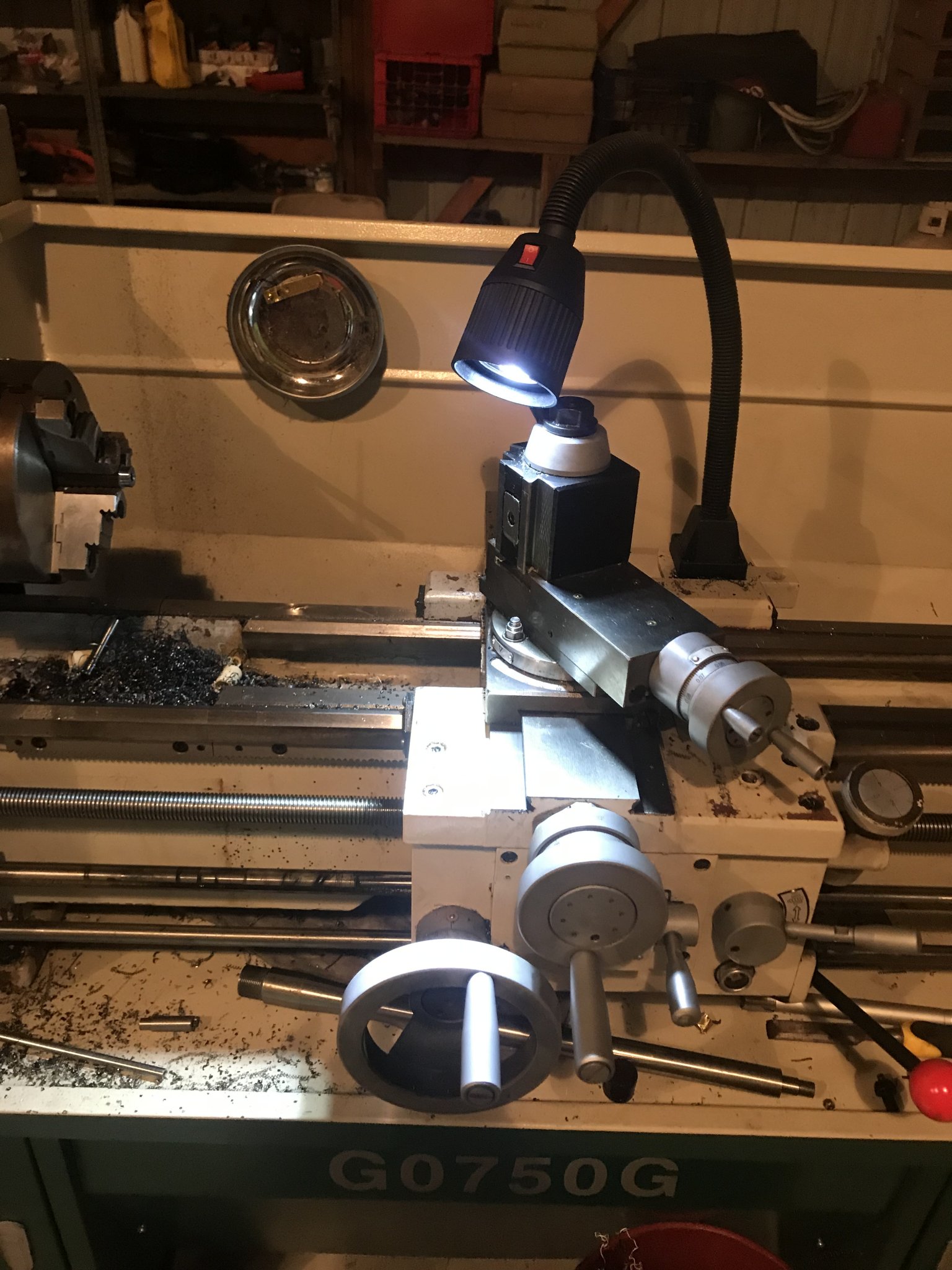

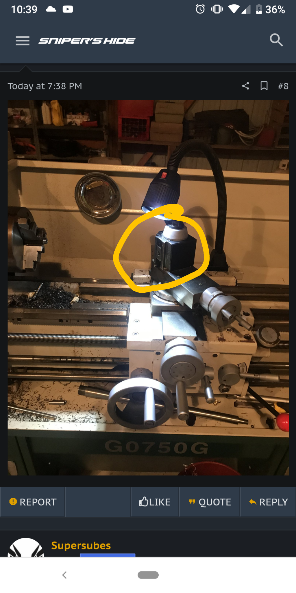

Your tool holder looks like it is sitting directly on top of the compound slide. Did you center the insert to your spindle bore? If not, a quick check is to insert a live/dead center on your tailstock and slide it over to your cutter and compare height. The point of the center and the top of your insert should be the same height.
If the cutter is too low, it may affect the thread form because the thread is a helix shape.
Also, using a three jaw chuck to practice is fine. Just make sure to use a four jaw chuck and indicate the barrel by the bore when you are actually threading a barrel.
It’s not bottomed out on the tool post. There’s a good gap, it’s centered. I use a 4 jaw chuck for threading muzzles, 3 jaw for practice because it’s fast.

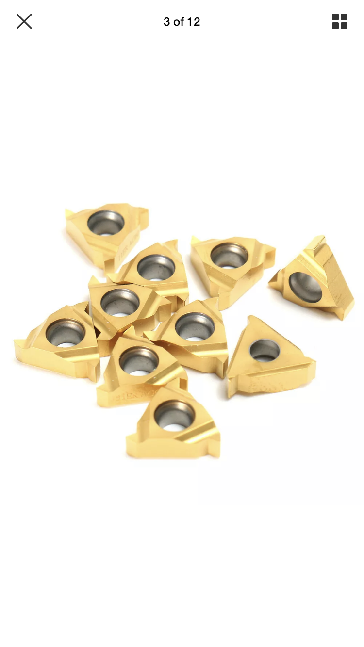

Is there any chance you accidentally got carbide inserts for a 55 degree whitworth thread or some other thread besides a 60 degree profile?
When feeding in on the compound each pass should primarily produce a chip only on the left cutting face of the insert. Is this what you are observing?
Couple more questions:
The inserts say they’re for 60 degree threads. I’d have to check on chip load this afternoon if I make it to the shop
