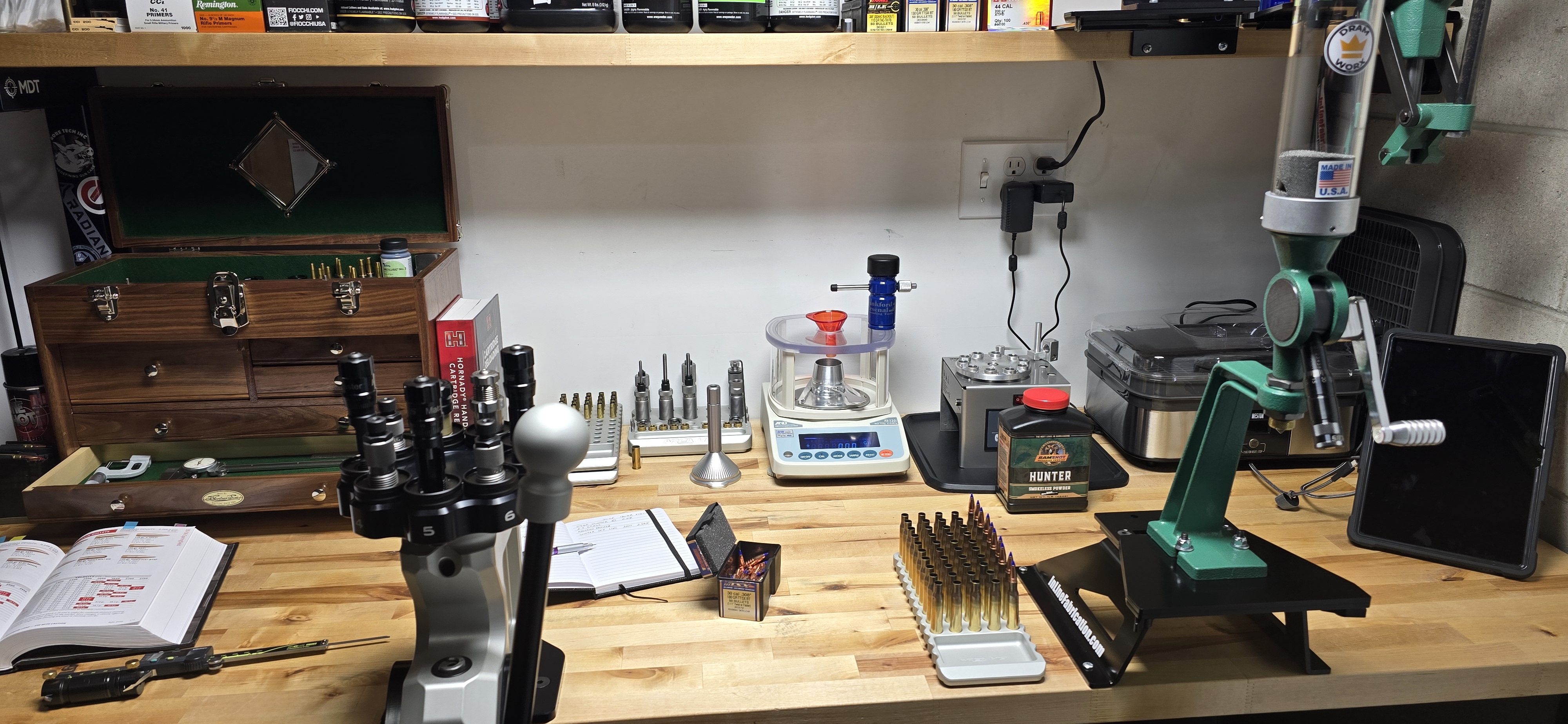

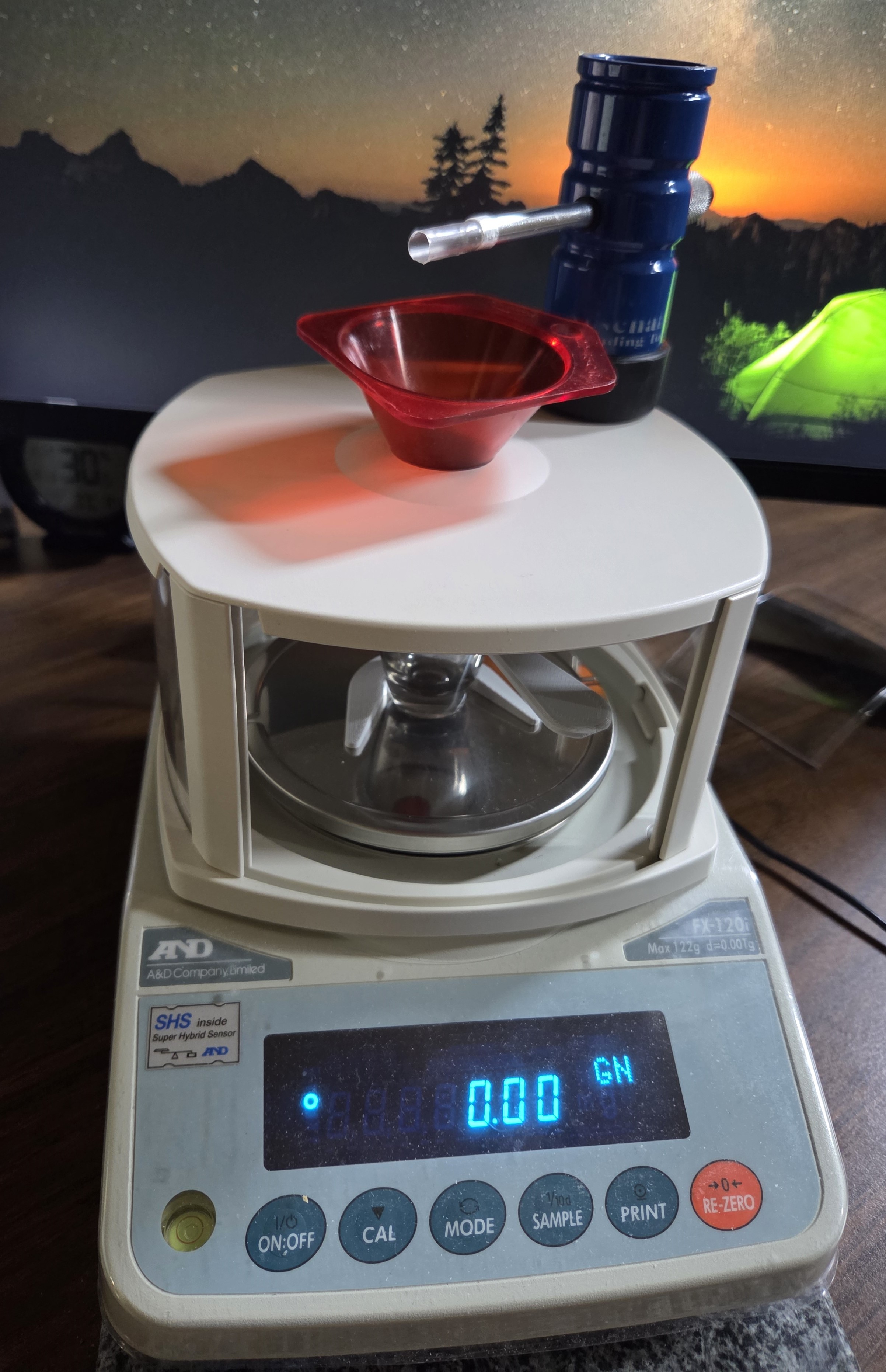

    Have an FX120i that will randomly start drifting. Can charge five plus cases, then I'm .04gr over an empty cup all of a sudden. If I leave the cup on it, it will continue to rise another .02gr every thirty seconds or so. On and on it rises till I zero it out. If I zero the scale after placing the cup on the scale, I can leave it there for days and it will stay at 0. Have to keep an eye on the scale as I charge and I always place the cup empty back on the scale before the next charge to make sure. Although I know what the scale says when there is no cup, and generally I can tell when things are not right. I simply do not trust it. I have only loaded 40 rounds with it.
    I have tried a grounding wire, drier sheets, how I place the cup, how I look at it, how I touch the bench. I charge and trickle manually. I can slam the gate on the dispenser pretty solidly and it doesn't effect the scale. I can lean on it as heavy as I want with no effect. Bench is heavy, on industrial rubber anti vibration feet. The light above is LED. My last ditch effort is a UPS that filters the power. The outlet at the bench is on it's own breaker.
    For those that have fixed drifting with a sinewave UPS, what did you get? Trying to keep this below $100.
    Picture of the bench, not that I think it's going to help with the situation. Who knows.

    What type of lighting are you using (LED, Fluorescents)?
    How long to you leave the scale on before you start using it?
    I find having my scale on a somewhat heavy piece of granite works well at keeping it stable and resisting vibrations as I load.
    When I power up my 120i typically have to wait 1/2 hr. or so for it to "warm up" and stabilize. If I just turn it on and start weighing, I'll get the kind of issue you've described. When I happen to leave it on for a long time, it's then very stable with no drifting of any kind.

    LED
    Never shut it off.
    Unless I pound the table, it doesn't react. I may go to a counter top place see what they can do for me. Have a couple places around me.
    I have tried a bounce drier sheet again just now wiping everything down, then draped it off the back stuck between the lid and the shield. Still no luck. Only thing I have done is made everything smell and feel like a drier sheet. Starting to wonder if I just have a bad scale. But I want to try a sinewave UPS first.

    And I assume you have no heating or air-conditioning going on and moving air around while doing this.
    I've left my scale on for weeks, using it intermittently and had no drifting problems. The outlet my scale is plugged into also has a few other electronics plugged in (e.g. computer, monitors and printer and there's no apparent interference. However, if the outlet happens to also be on the same circuit as things like kitchen appliances. . . that can be an issue. As mentioned above, isolating the circuit can really help (assuming of course, there's really nothing wrong with your particular scale).
    It'd be nice if you had a buddy that also had the same scale where you could run a test to see you have the same issue???
    And yeah, It's just possible you have a unit that has something not working right. :rolleyes:
    BTW: I charge my cases the same way you do. . . a quick throw, with my Lee Powder Measure, and then trickle up on the scale with a Frankford Arsenal.
