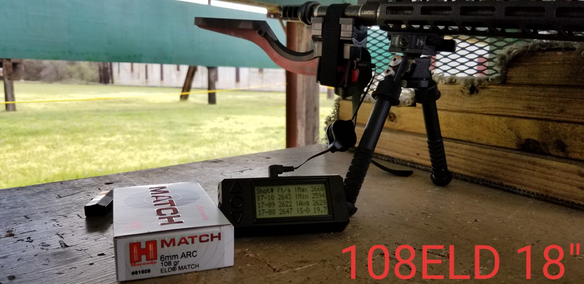

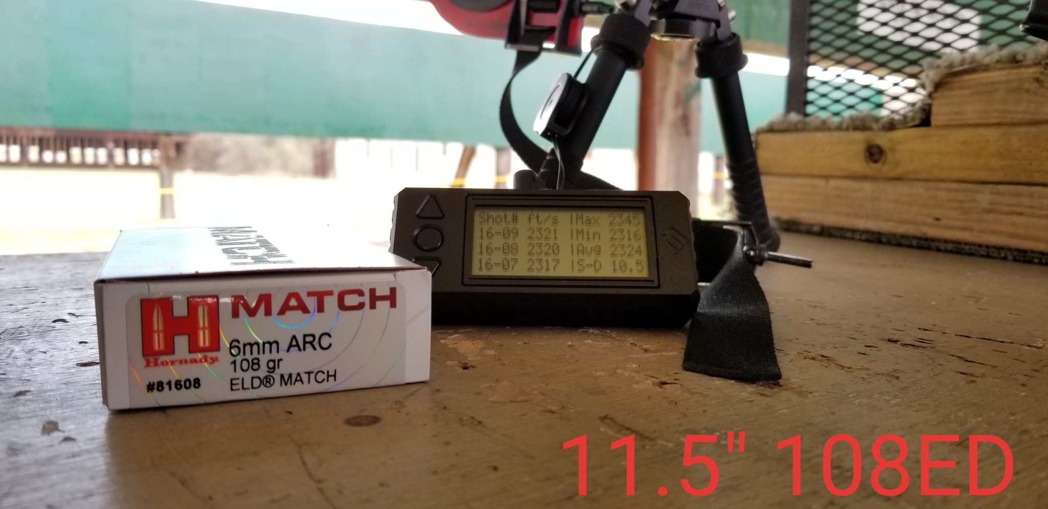

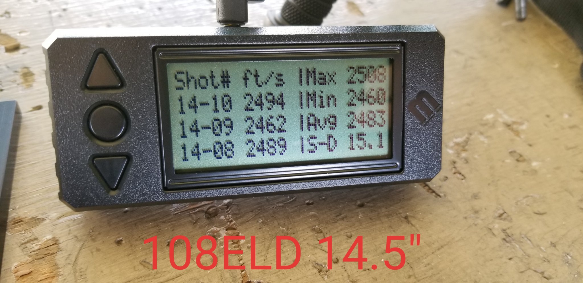

Not outside the realm of possibility, but on the top end for sure. In the "by the inch" test I saw 18" was around 2600fps. I have a Cz527 that is in 6 ARC with an 18" barrel that is also right around 2600fps with 108's.
Some barrels are faster than others. Like I said, 100fps isn't outright bogus but I wouldn't expect it to happen every time.

I've only had the rifle together for a couple weeks now and have been shooting a small supply of factory ammo. I believe Varget is one of the go-to's. Varget is slow.

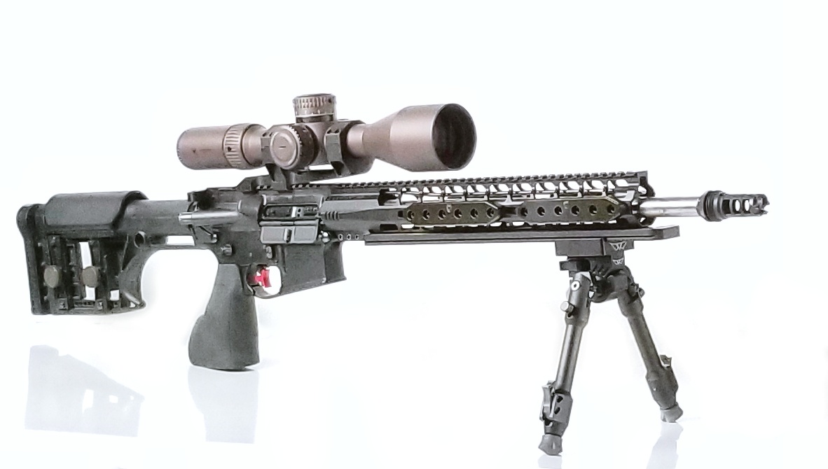

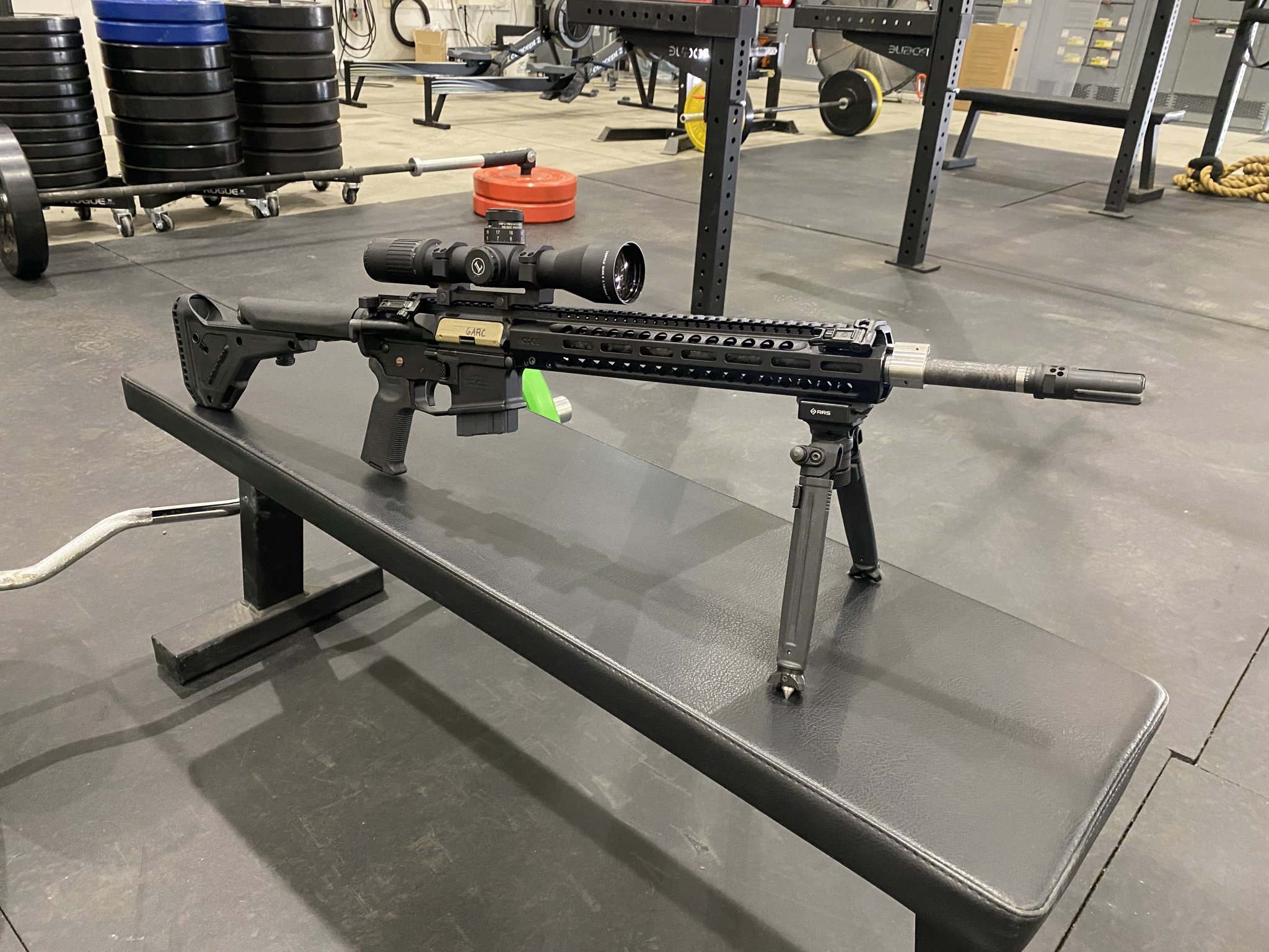

Got this one assembled today. I had been waiting on a BCG since February, finally got it done just in time. Going to zero and chrono it tomorrow, then start blasting prairie dogs and coyotes.

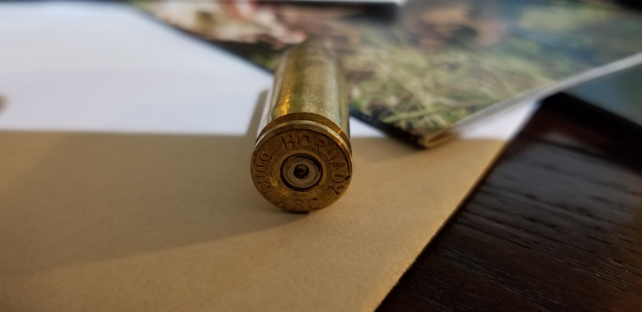

Bolt face is grendel 2

Can you form from grendel brass, yes. This opens options such as federal, norma, lapua, starline etc.

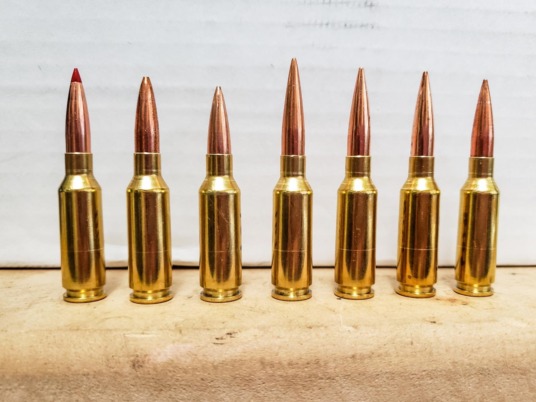

6 ARC
COAL to lands
Hornady 108 eld - 2.311
Hornady 105 bthp - 2.230
Sierra 107 - 2.147
Sierra 110 - 2.442
Berger 105 hybrid - 2.368
Berger 109 hybrid - 2.361
Nosler 105 rdf - 2.304
BTO
Hornady 108 eld - 1.758
Hornady 105 bthp - 1.748
Sierra 107 - 1.602
Sierra 110 - 1.759
Berger 105 hybrid - 1.760
Berger 109 hybrid - 1.761
Nosler 105 rdf - 1.738
