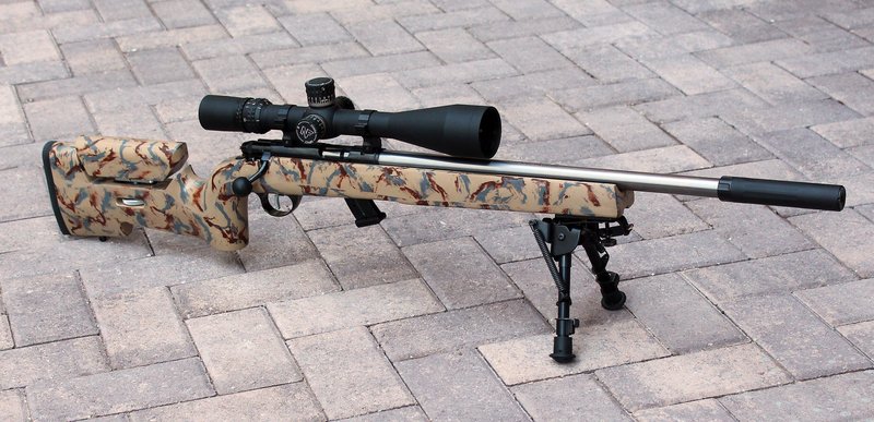

    And if you're more of a Manners T6 guy...
    [IMG2=JSON]{"data-align":"none","data-size":"full","src":"https:\/\/www.anschutznorthamerica.com\/uploads\/1\/9\/9\/7\/19975381\/published\/sw-1_1.jpg?1497389228"}[/IMG2]
    Already got one and it's a great rifle, but the 54 action would be the draw to this rifle for most I'd think, at least that's why I'd consider it. The above rifle, at least the one I have, is very accurate but not quite at the level of my Vudoo or what I'd imagine the 54 actioned rifle with custom (or at least hand selected) barrel above would be. Although, let's be honest. We're sort of splitting hairs at this level of 22 rifle. None will disappoint in the accuracy department, it's just a matter of the feature set that's important to you and what your wallet will bear.

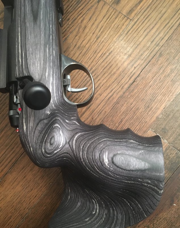

    I like the look of that one a lot. I've thought about the GRS version as well, but it looks like the GRS stock would be fairly slick without any checkering?

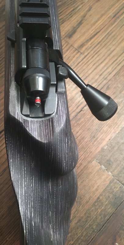

    The way it’s designed there is no slip at all. I’m 6ft tall and I’m hand fits the grip like a glove. Here are some pics of the stock.

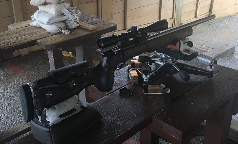

    There was a review of this rifle along side the Vodo on facebook couple weeks ago. They both performed flawless, other than the Vodo getting dirty and not working from suppressor use. I may try to find and copy paste here. Was good stuff.
    Looking forward to more reviews. I just don't see how a factory rifle can compare with a full blown practically BR rig like the Vodo is, but if the tolerances are too tight on the Vodo, maybe one of these would suffice...ugh.
