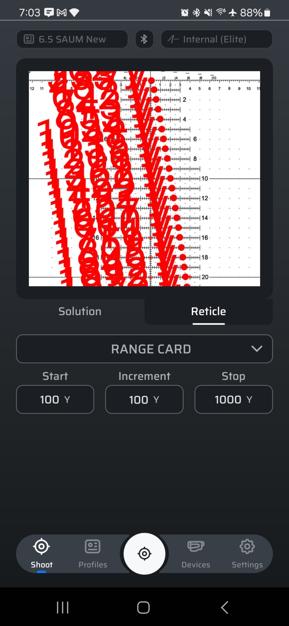

Hey @docUSany way to clean this up? Give you the option of increments on a reticle like the range card? This is a bit hard to read, cant zoom in enough to even read it. I prefer hold overs, this is messy
Reactions: 6.5SH

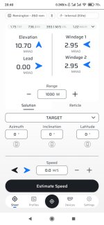

2) Target movement angle is already in the app, under the Target Controller.

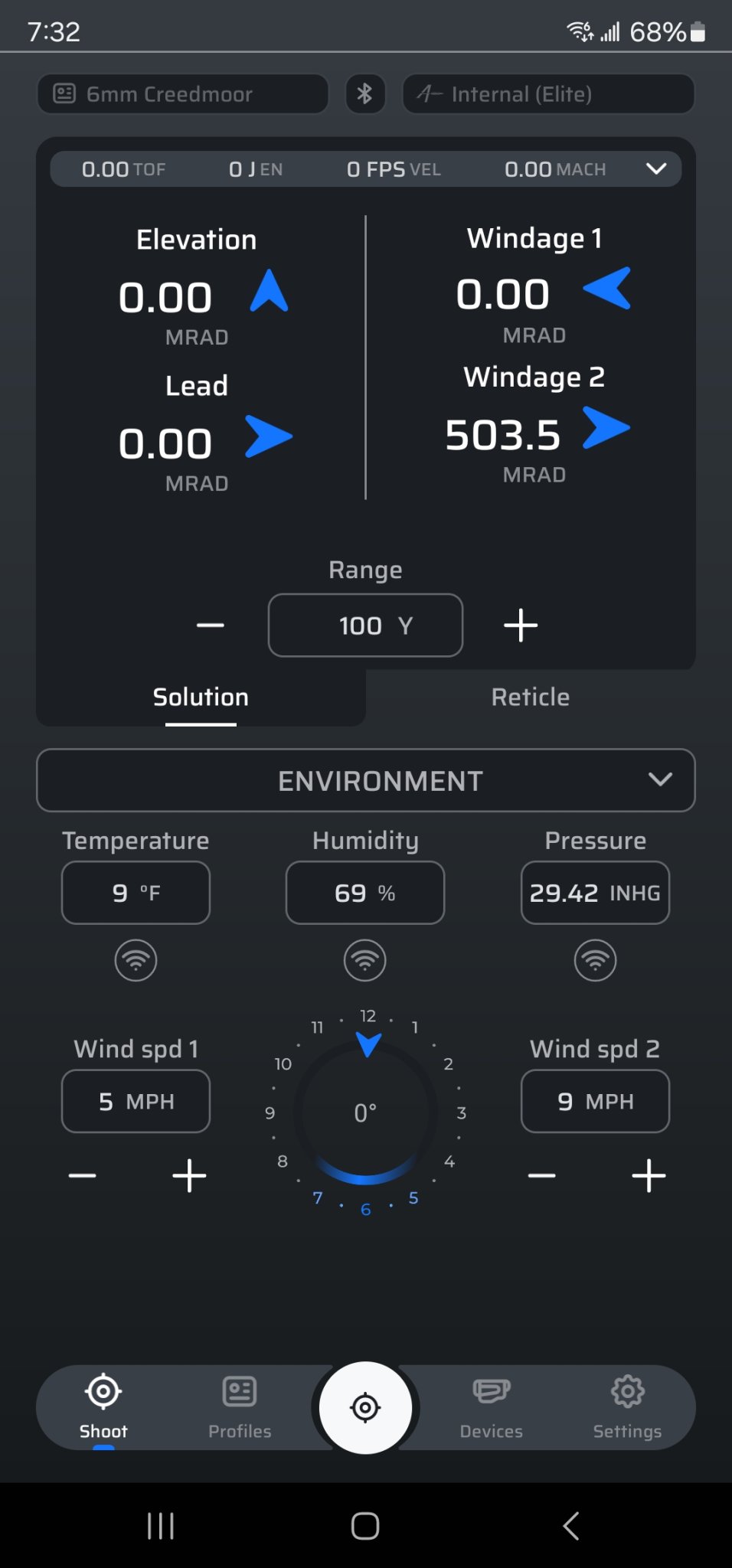

Do the target and range cards only show up if you have reticles? I have no reticles set up on my profiles and I never see more than one target. I also never see 'target' or 'range", only app and reticle tabs. I never see the hamburger either just the target in the center lower menu. I assume I'm missing something obvious but I don't see what in the video or manual. I really want to use the target card.
Is the inabilty to read pressure from phone sensors supposed to have been addressed? I've been updating whenever a new version drops and doing the uninstall/reinstall and it still won't pull pressure from my phone.

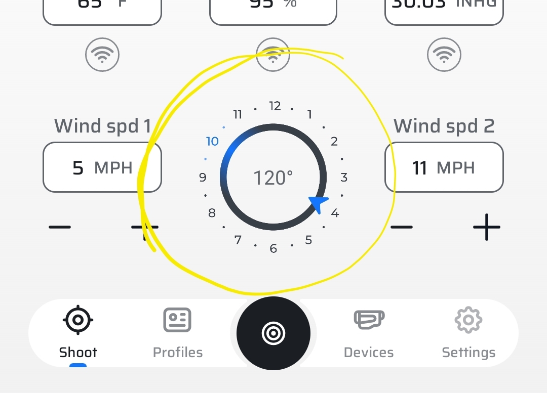

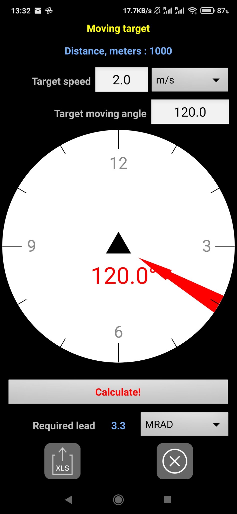

I can't find where to set the angle.
Blue arrows left and right.
Make sure your app is up to date. At least version 3.0.9 or newer. Soon will be 3.1.0+ which introduces some new features.
If that doesn't work, it is possible your app corrupted during the update process and needs to be deleted/reinstalled. Always do a phone restart after deleting an app before a reinstall. The update was big, and these things do happen.
this is only the direction right or left in relation to the shooter. I am talking about the movement of the target, for example, from 4 o'clock in the direction of 10 see attached screenshot

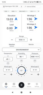

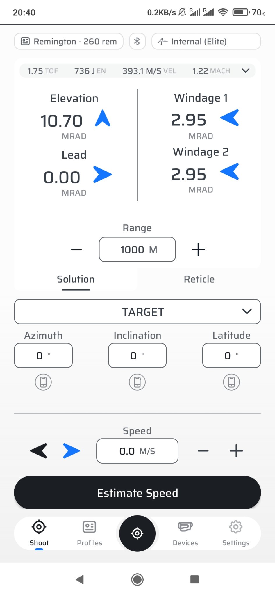

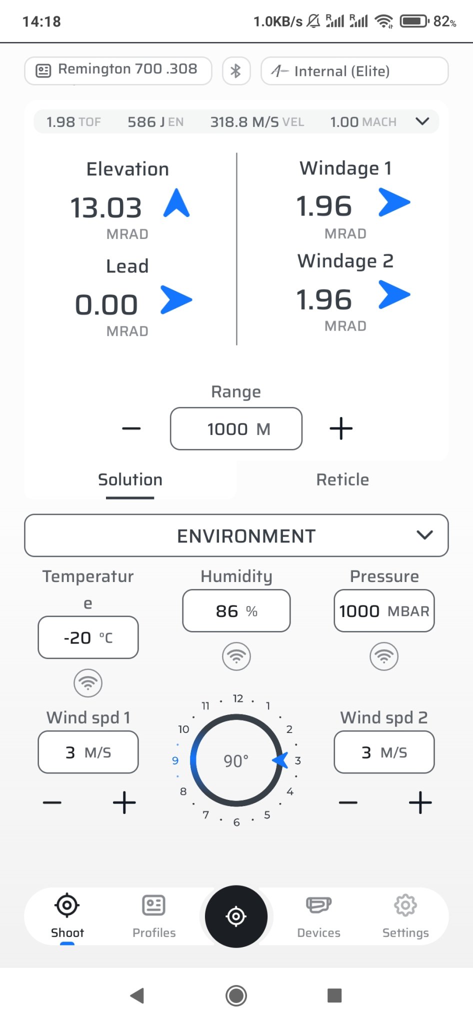

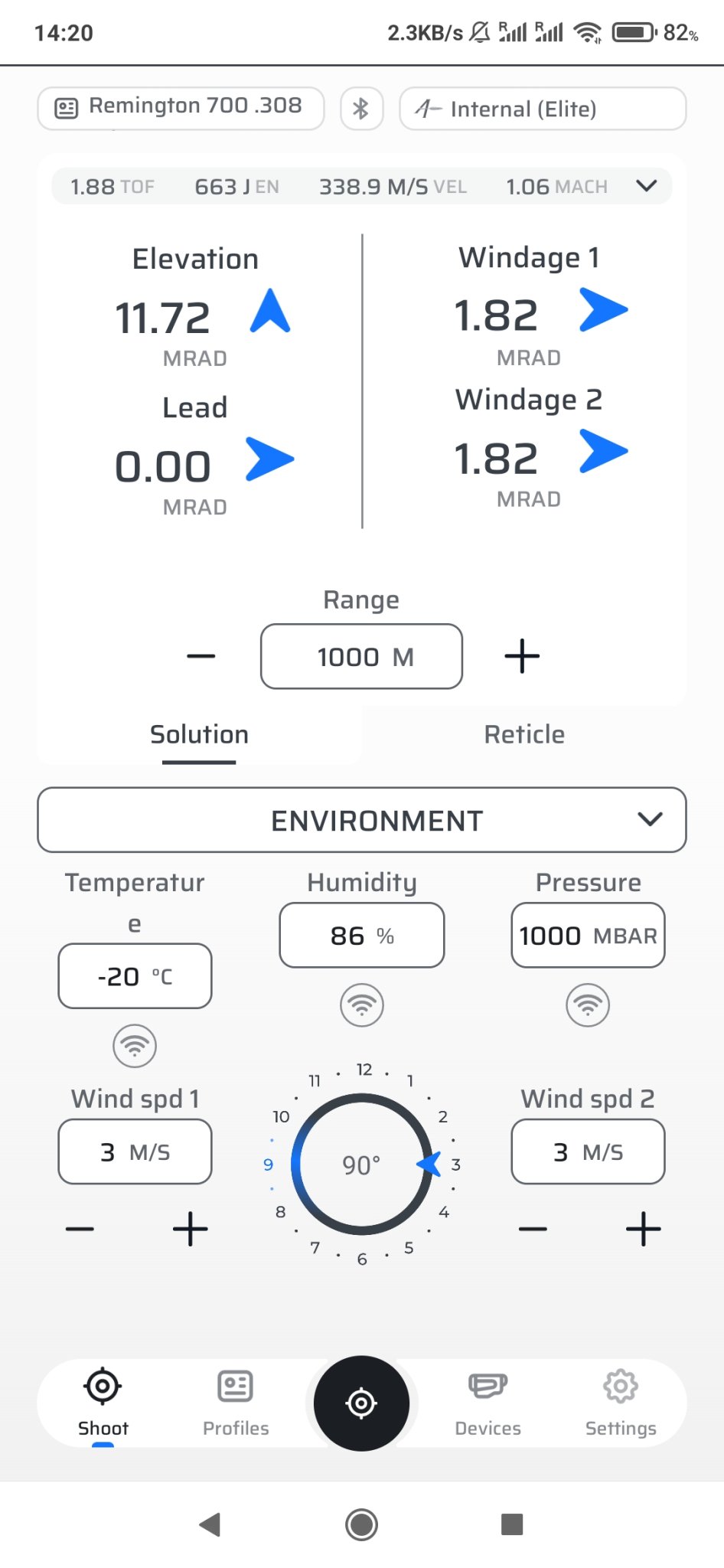

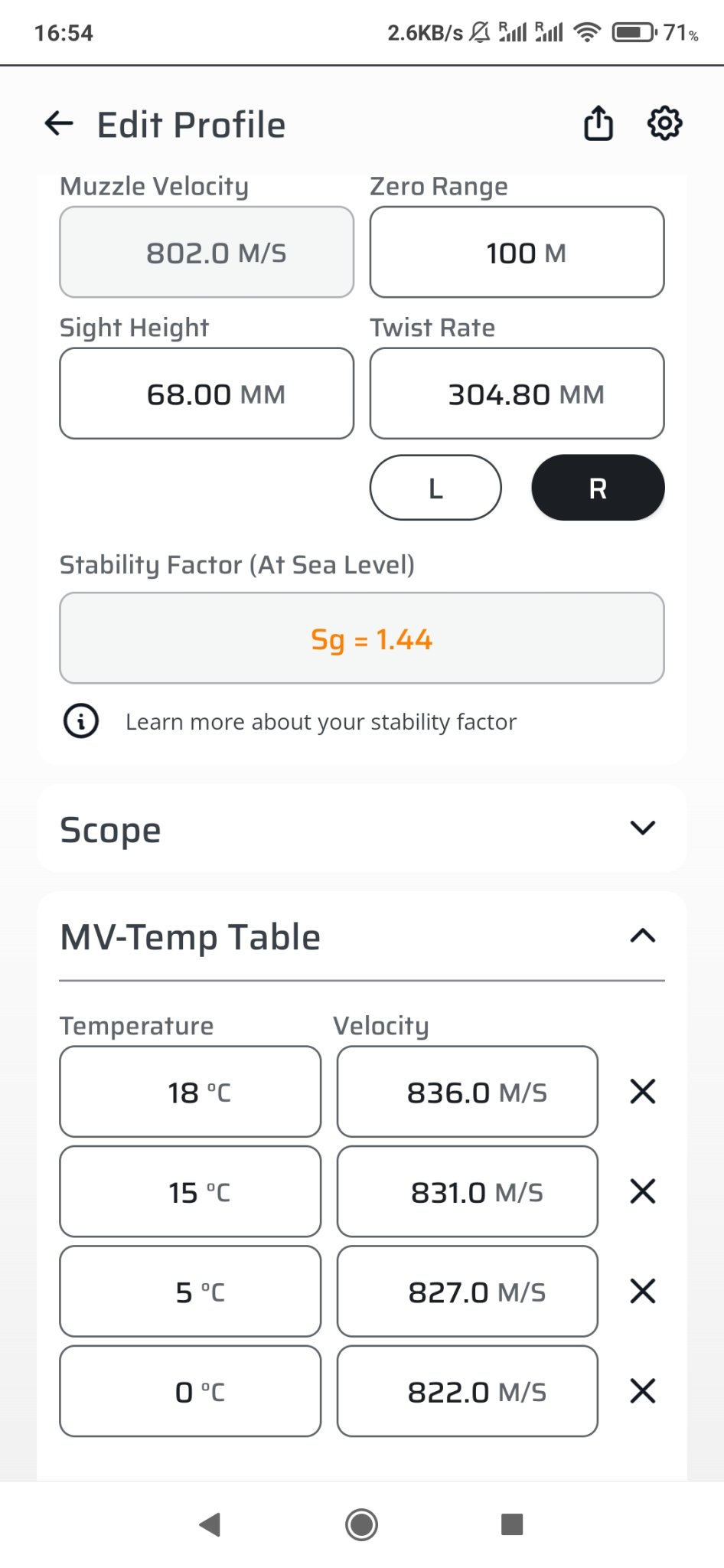

I saw your answer. But unfortunately, you can't understand what I mean. I'll try to explain again.
For example. I'm driving in the winter. It's -20 С outside and +20 Сin the car. I see a coyote at 1000 m. I get out of the car, put the rifle on the hood of my pickup and fire. This is a very common situation in North Dakota, Montana.
For example, for a .308 Win at the range 1000 meters, with a powder temp of +20°C, the difference between air temp of +20°C and -20°C is 1.3 MRAD, due to the difference in density between warm and cold air. This is over 1.3 meter difference! Ypu missed the target.
The 1st screenshot shows the solution when the ammo temp is +20 (in the car ) and the air is -20. These are real conditions from my example above.
The 2nd screenshot shows when AB shows the solution when the air and ammo temp are the same.
Therefore, it is crucial to have the ability quickly to set the powder temp separately from the air temperature!
  • Screenshot_2024-12-14-14-20-33-414_com.appliedballisticsllc.appliedballistics.jpg
  • Screenshot_2024-12-14-14-18-41-651_com.appliedballisticsllc.appliedballistics.jpg
Reactions: kingston

This will likely stay the same. Powder Temp is assumed to be ambient air temp because well... we are not feeding the necessary sensors drilled and placed into the barrel for average shooters to accurately track this. You would need a second temp input that constantly monitor and change shot to shot to be truly accurate as the barrel chamber temp changes constantly depending on what you are doing. The powder will heat up if it sits in the barrel between strings or shots. Or maybe it doesn't because you just loaded fresh from your box. Also not accounting for how quickly the powder is increasing in temp or decreasing as it sits in that chamber. Which of course would be different for different powders, how much you filled the case, how the powder settled as you moved around, cartridge size... and more... Creating a complicated system.
The old app was assuming the MV you recorded was at the Powder Temp you input. The new app can do this as well with the MV Temp Table but instead you get 6 inputs (you should have at least 3 inputs 25deg F apart to use the table properly). So it allows for more of the realistic bell curve (most powder has a sweet spot, and condition where it starts to ramp up or down in potential energy) for more accurate tracking of MV.
It will likely remain the way it is for now. On the MV Temp Table you would input the temp at the time you chronographed (or MV Calcd) and the muzzle velocity that goes with it.

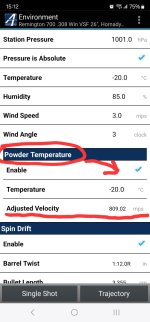

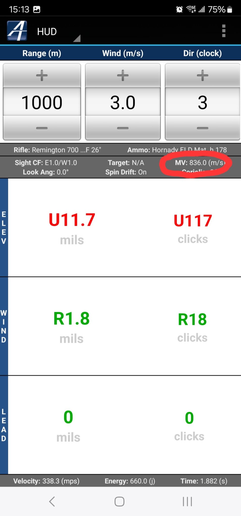

Can you add the ability to turn on/off as it was in the old version of AB?
That ability is already in the app. Their is a little on/off switch in the profile.
could you please show where this switch is ? I couldn't find it.

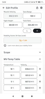

Adjusted MV at -20 C is 802 m/s. This works when the ammo and air temps are the same, but doesn't work if they are different.
You have to either create another profile or completely delete the MV temp table.
