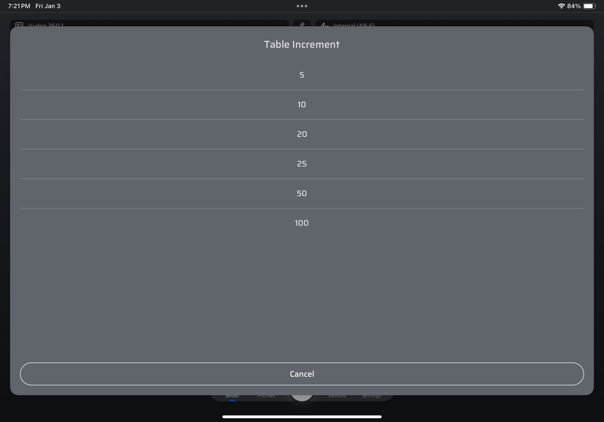

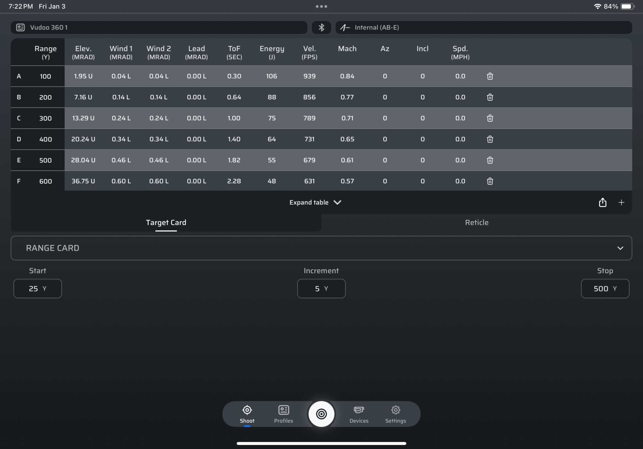

The new app is a step in the right direction.
I have few issues though
Right now the app is behaving differently between my iPad and my iPhone
When i click the (export) icon on my iPad for my range card nothing happens , it works correctly on my iPhone
Another issue ,
The range card is only allowing increments of 5Y , why not allow 1Y increment like the previous version
Another issue ,

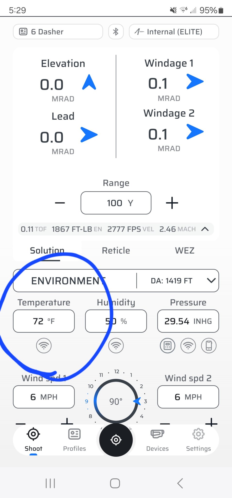

If I am making a range card in advance can I manually change the temperature? It it will update from my phone some how but I would like to be able to enter what I want.

Why do the range card values in the AB Quantum app and my Tactix 7 Pro with AB not agree. Yes they are connected and I have the the Elite version.
I've noticed that if I had a kestrel connected to the watch, that the watch AB remembers those environmental values, especially the wind. Regardless of what the phone app says. I zeroed out the wind value in both the app and the watch and then my range card values matched.
The phone app doesn't transmit weather data to the watch. We are working on a way to possibly do this with the Tactix 8 (since it has bi-directional abilities) depending on how the upcoming firmware updates to the watch perform. But at this time, the app does not send env data to the watch.
