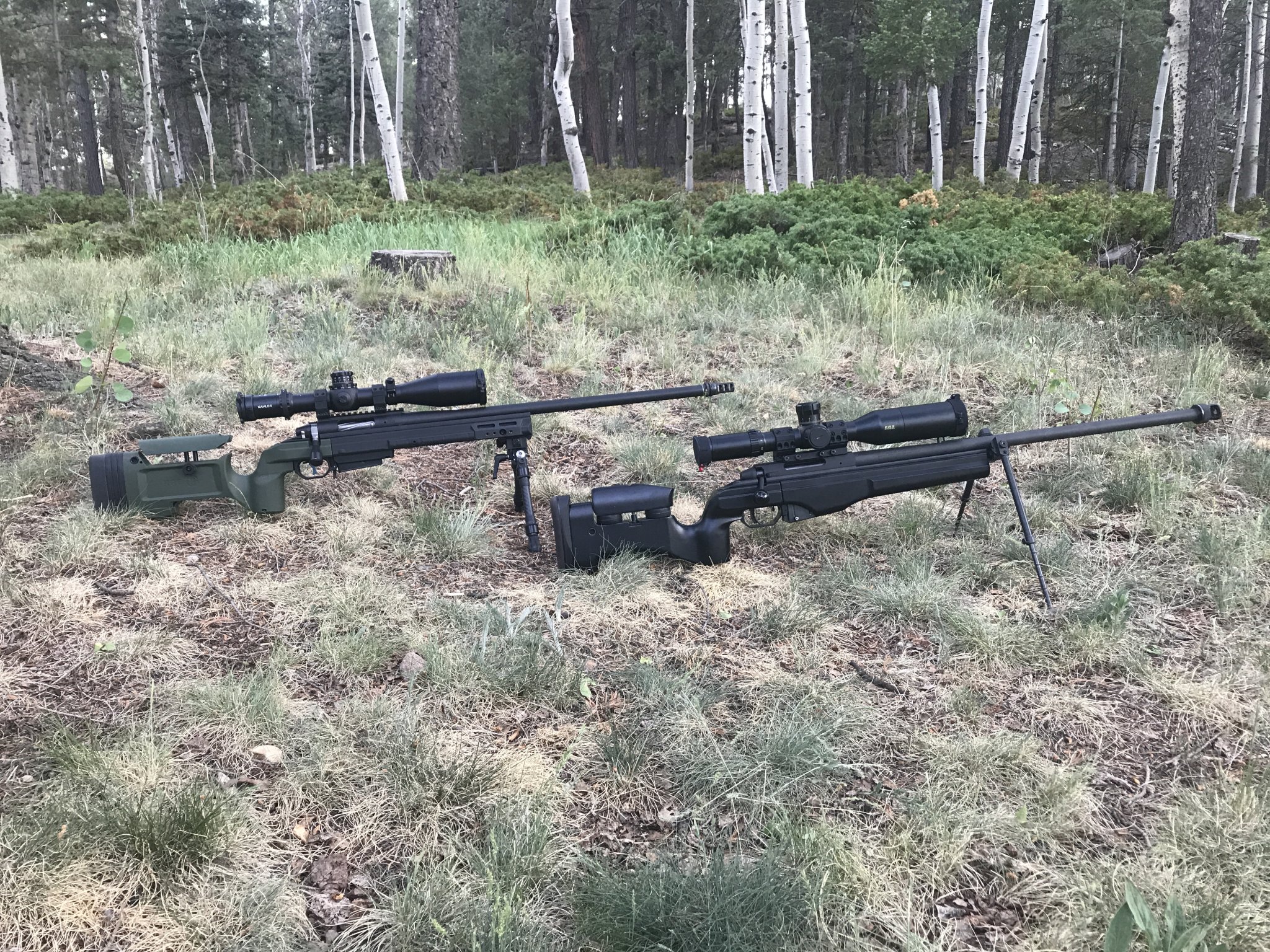

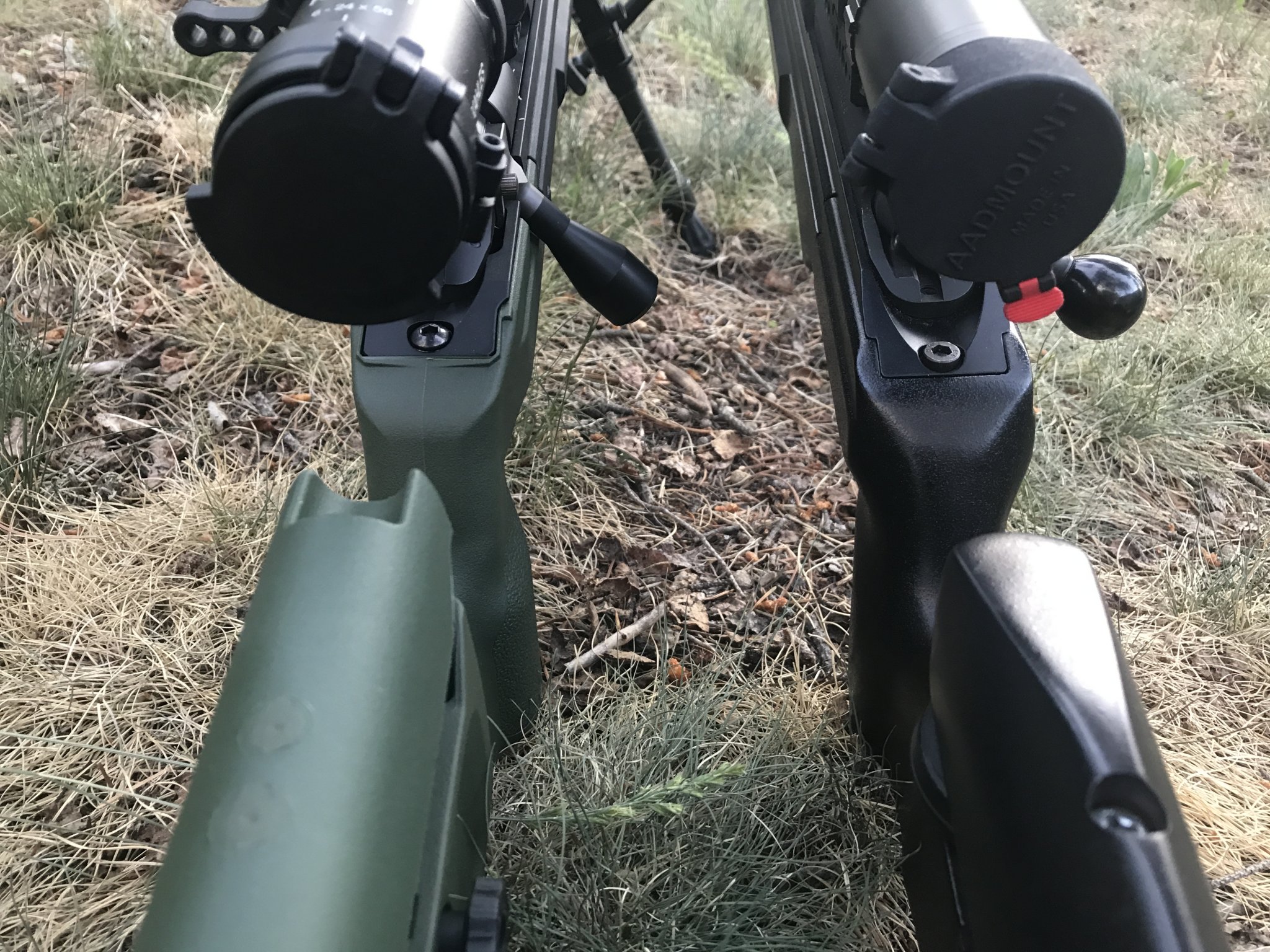

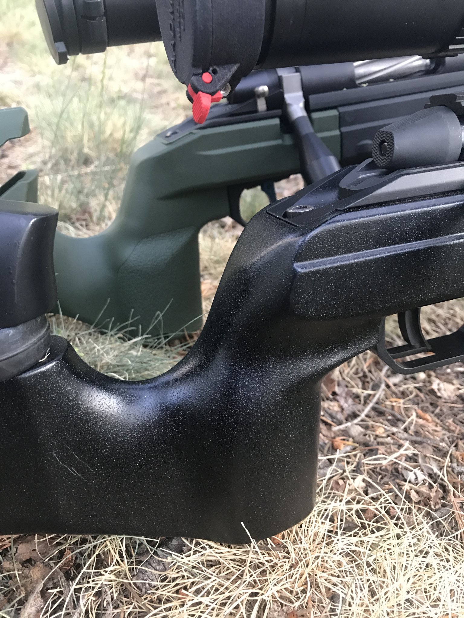

How well does this chassis mimic the Sako trg? It looks almost identical but can anyone compare directly to a trg? My trg is my most comfortable rifle and I have been looking for a replica for my tikka and bighorn rifles.
Reactions: skinnj1
Pretty darned close. The texture is finer on the TRG. I just wish it took TRG magazines because AICS mags are way too long.
Reactions: Crang and viking78
Perfect! That's what I needed to know, probably going to put the j Allen up for sale.

Regarding the ergonomics, we tried to make it as comfortable as a TRG as that is really the gold standard. I personally like the Bravo a tad more because there's a bit more clearance for the meaty part of my thumb.

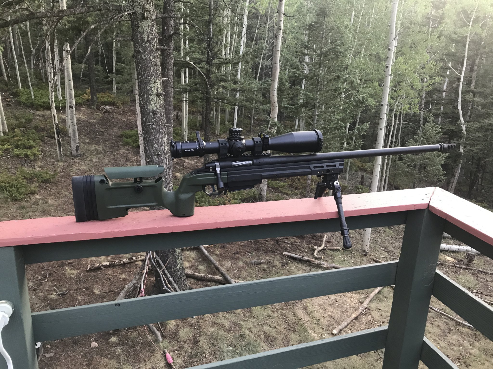

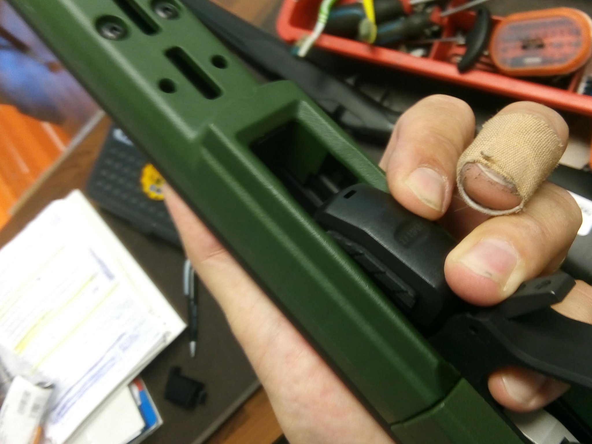

Well my bravo just showed up. It is definitely going to replace my j Allen. The ergos are very close to my trg, I absolutely love it. Now I need to order another one for my tikka.

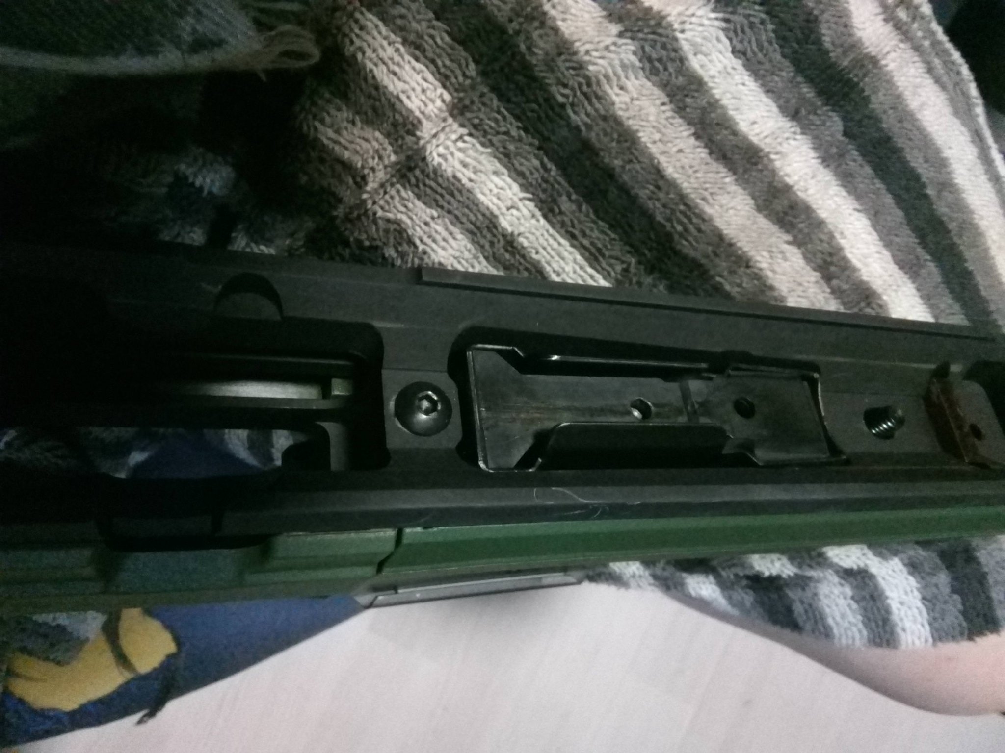

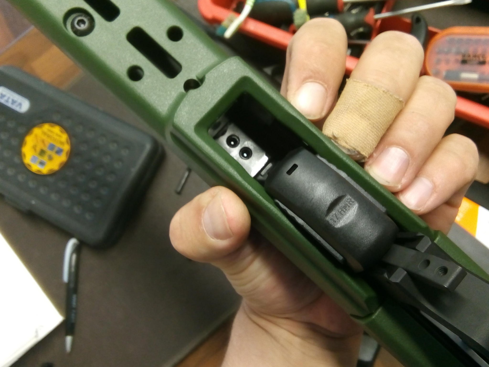

Couple questions, are all the cheek pads loose and wobbly? The pins are tight and not moving but the plastic pad is wobbling on the pins?
Second I'm having issues getting AI mags to seat. I have to slide them in just right. It looks like it's hitting the 2 tabs right below the action that must hold the top of the mag. Anyone else having this issue? I was thinking about beveling the lower squared edges to help funnel the magazine in.

This is from the KRG manual.
You need to adjust the magazine feed before you insert the action to the chassis.
Insert a magazine to test for fit, the forend can be moved forward or backward a small amount to adjust the magazine
fit.Additionally, the trigger guard can be moved a small amount as well if necessary, this will require removal of the
barreled action. Due to the magazine design of the AICS magazine and the magwell of the Bravo, it may be possible to put
pressure on the mag and push it up against the bolt. For this reason we do not recommend resting the gun on the magazine
when firing.
https://kineticresearchgroup.com/product/bravo-chassis/
Did you use the manual torq on the bolts?
And did you remember to tighten that third bolt what connect the buttstock to the chassis, that is tighten after you have done the 2-action screws.
Where are you from?
Reactions: bunsen27
When in doubt read the instructions! What an idiot, sorry guys. New toy, as soon as the chassis arrived I threw it together and never read the instructions. I need to order the longer hex bit so I can torque. For now it's just snug so I could see how it feels.

Anyways, you have not done any damage, so you are good to go, just check out those 2-things.

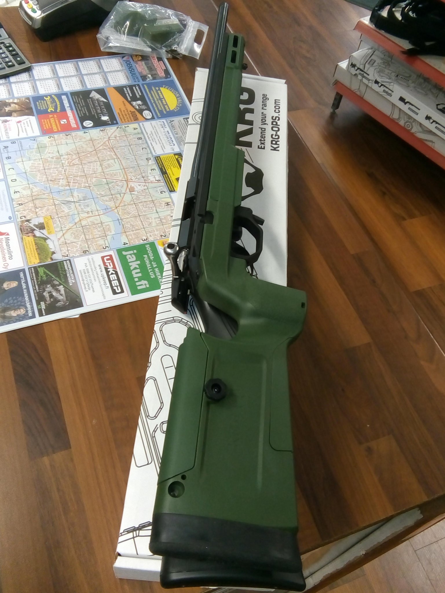

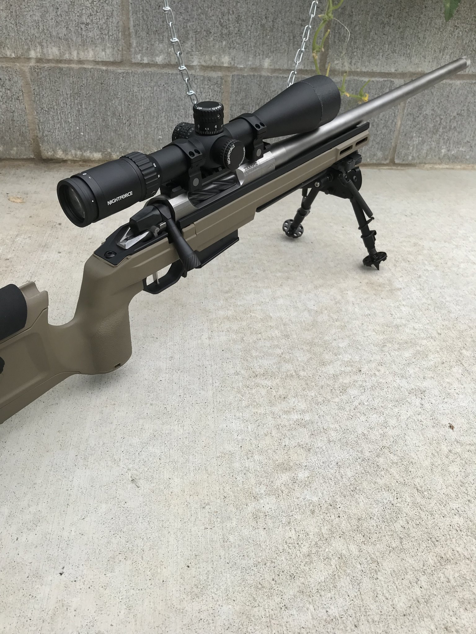

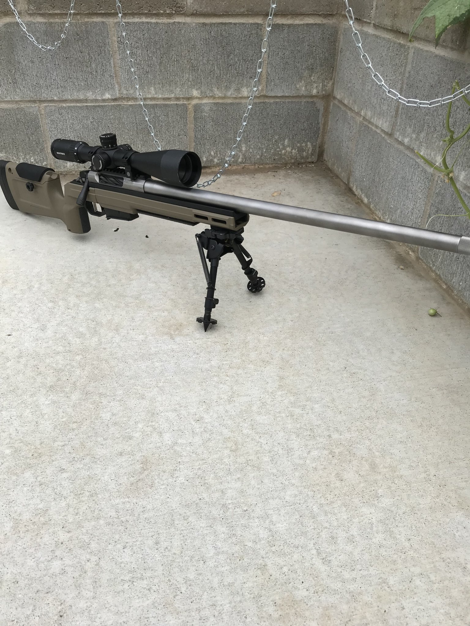

Would you guys want to see, what would Bravo chassis look, if there is a Tikka T1X on it?
Little teaser:cool:.
14591940-jpg.6921201
According to Tikka, the T3x and T1x have identical footprints so a T1x should drop into a Bravo Tikka chassis. But what about the magazine?
Action fits to KRG Bravo chassis like any other T3/X Tikka would fit.
But the magazine adapter, or AICS Tikka T1X magazine is what it needs.
I bet that there will be companies, that makes these.
This might be the big next thing.

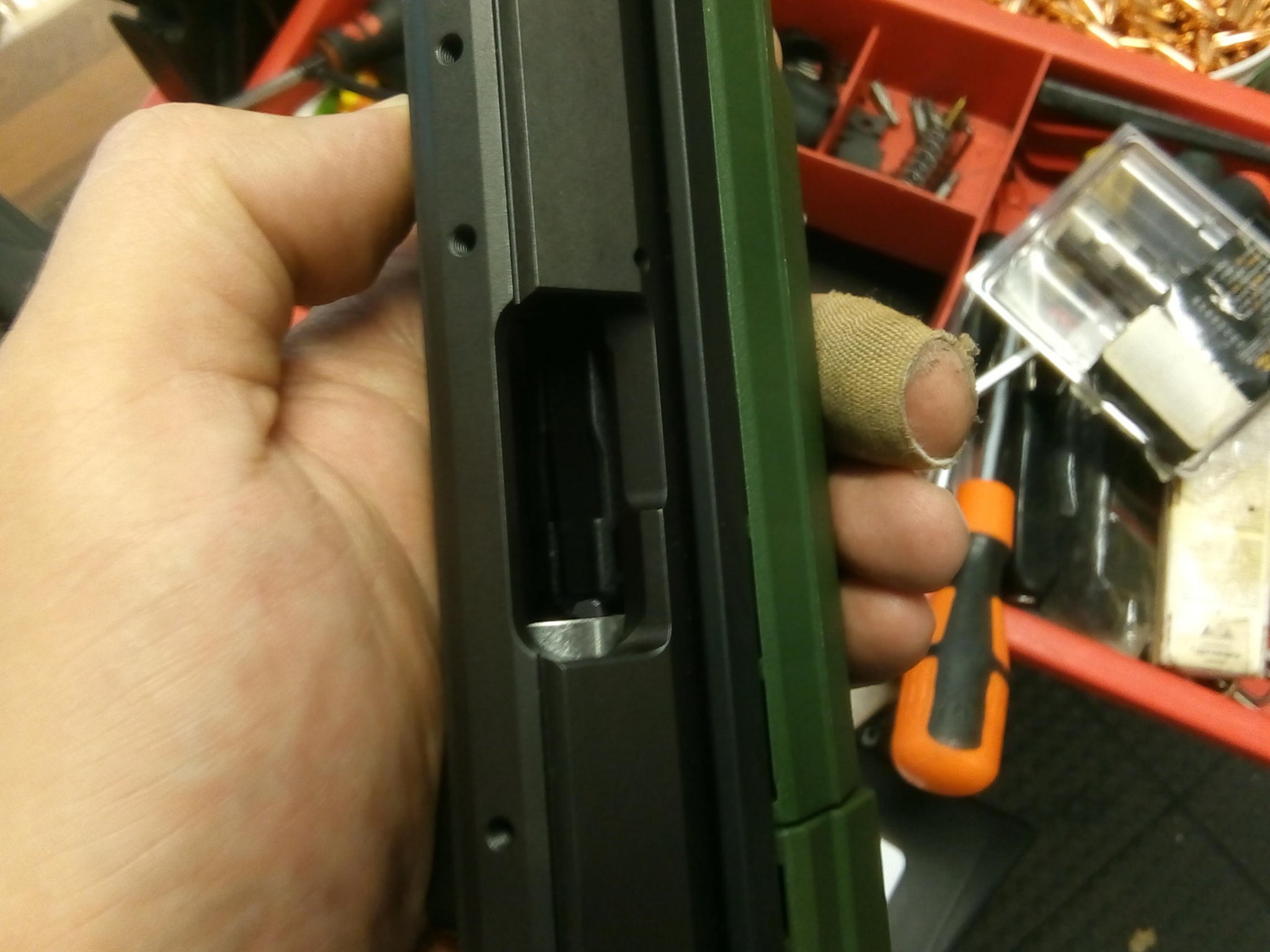

I installed a TT special. the safety lever down by the main trigger housing, it was making contact with the aluminum chassis when it was back in the "safety" position. I had to Dremel/file down that area so I could pull back the lever into it's full safe position. when I received my Havak and it came with the magpul, seekins had already rounded the edge off the recoil lug slot. I had read where I needed to do that to the bravo bc of the radius of the integral lug. I looked at the action and when I made contact with the bravo, it didn't appear I was making direct contact. I'm not a gunsmith by anymeans so I had no way of checking other than tightening down the action screws. I went ahead and rounded a radius anyhow. so far, fits well and was shooting well.
on a side note, that captured action screw is a PIA. I know you didn't intentionally produce the ol bait and hook routine with having us buy the extended action hex you guys make now, but it would be nice if it was included with the bravo purchase or just not make it captured. I understand, it's a money thing by supplying the hex wrench too. over all, I'm very impressed with the Bravo, especially for the $$$. I was building a dual purpose rifle on a budget, and this hit it out of the park.
