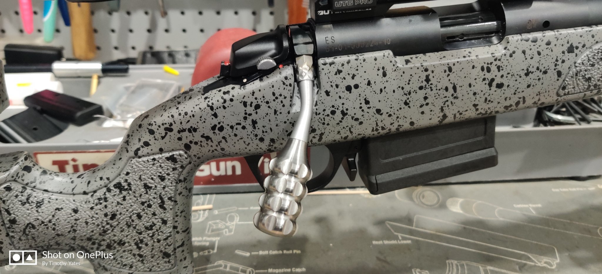

    Finally got the swept bolt handles in from Anarchy Outdoors. I wanted black but it was going to be another two weeks and I didn't want to wait. I can send it back later on for a black one if I want to. Overall they are pretty nice. The way they are made allows you to adjust the elevation of the knob. It is also threaded for the standard 5/16-24 threads. Only real negative thing is the finish on the handle is not what I would have expected. Machine marks are visible, having said that I'm 99% sure I'll return both for the black version. I will post photos and give commentary where needed.

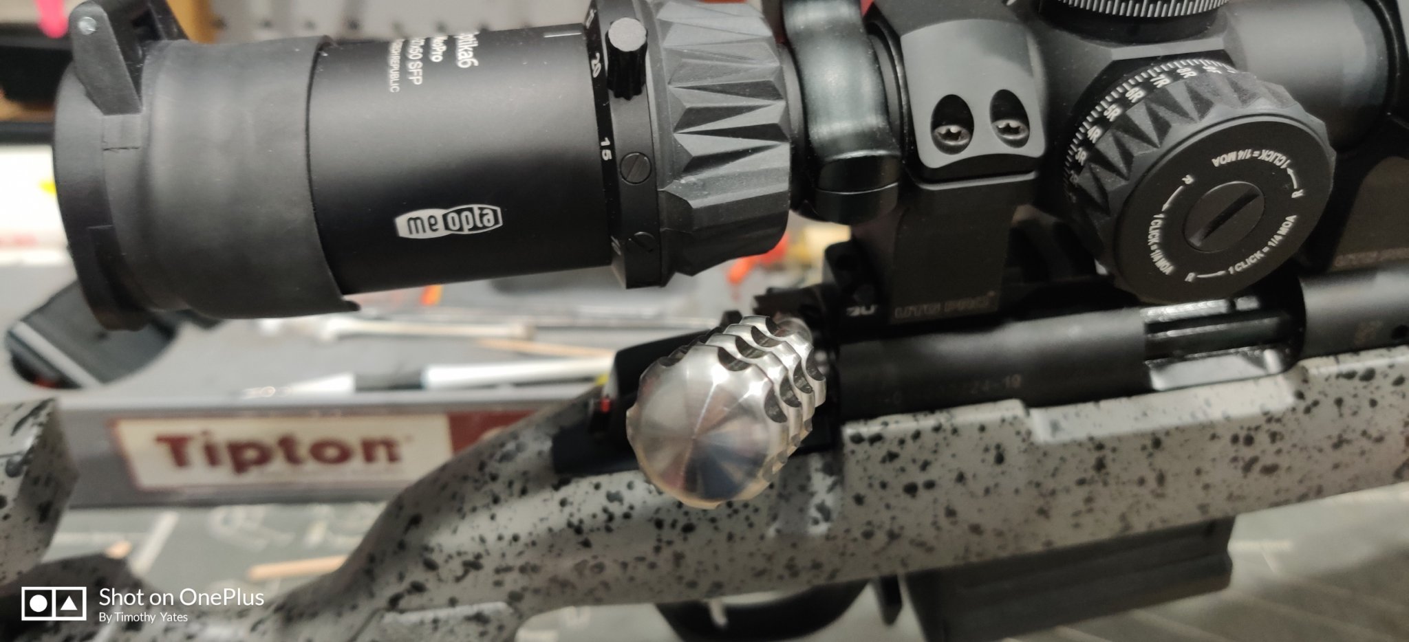

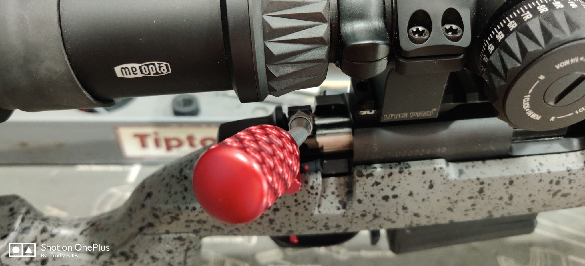

    Bergara B-14R up first. I will not be keeping the Grenade style knob on this. It is too long and also rough on the skin. I will be sending this back for a different style and shorter. I may just go with the round red knob and swap out the Bix trigger for my Elftmann with Red trigger and safety lever. The second photo is showing knob clearance with the mag ring on the scope.

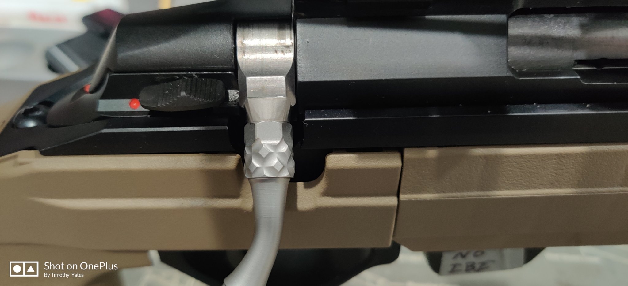

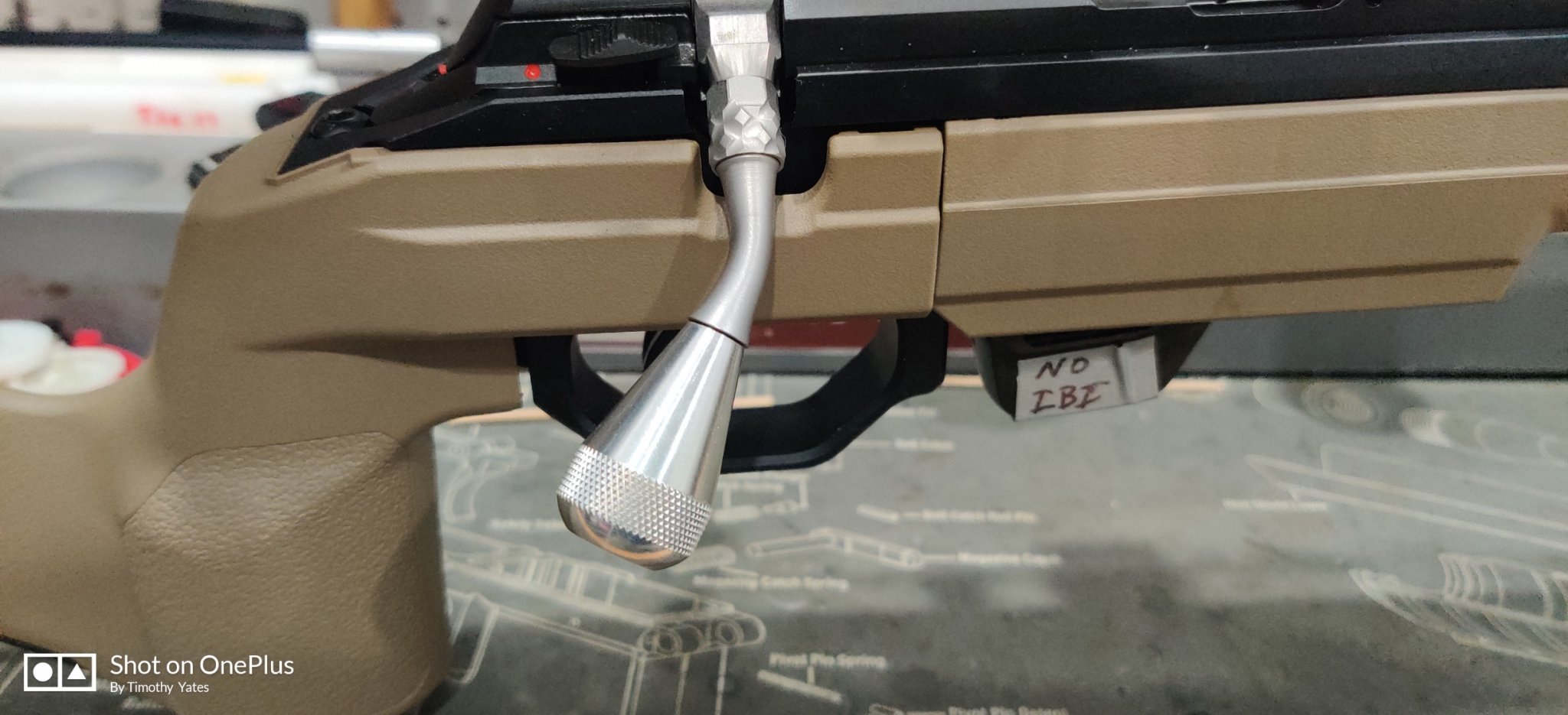

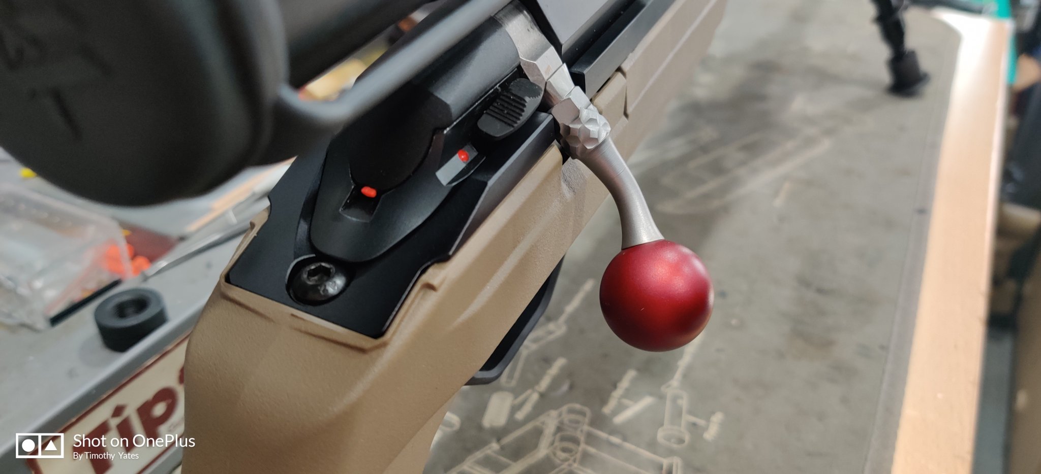

    Tikka T1x. First off, as much as I like Anarchy Outdoors...this is no Sterk. If you still want the best, it is my humble opinion that Sterk is still #1. Again, someone may ask, "why didn't I buy another Sterk"? Well, because I like to try different things. As with the B-14R handle, this one is also threaded for the 5/16-24 knobs. This one option may tip people over to this handle than the Sterk. But, if like me and you put a ball on the end you are gaining nothing because Sterk comes with a smooth round ball. This is also coming from a guy who, in the beginning, didn't really like the Sterk. Talk about eating crow on that one.
    I may keep this bolt knob even though it doesn't mate up nice to the handle. It is smooth, in a good location so why buy another?
    There are three pieces here, the handle, the locking collar and the "adapter" to blend the flats together. The B-14R doesn't need an adapter.

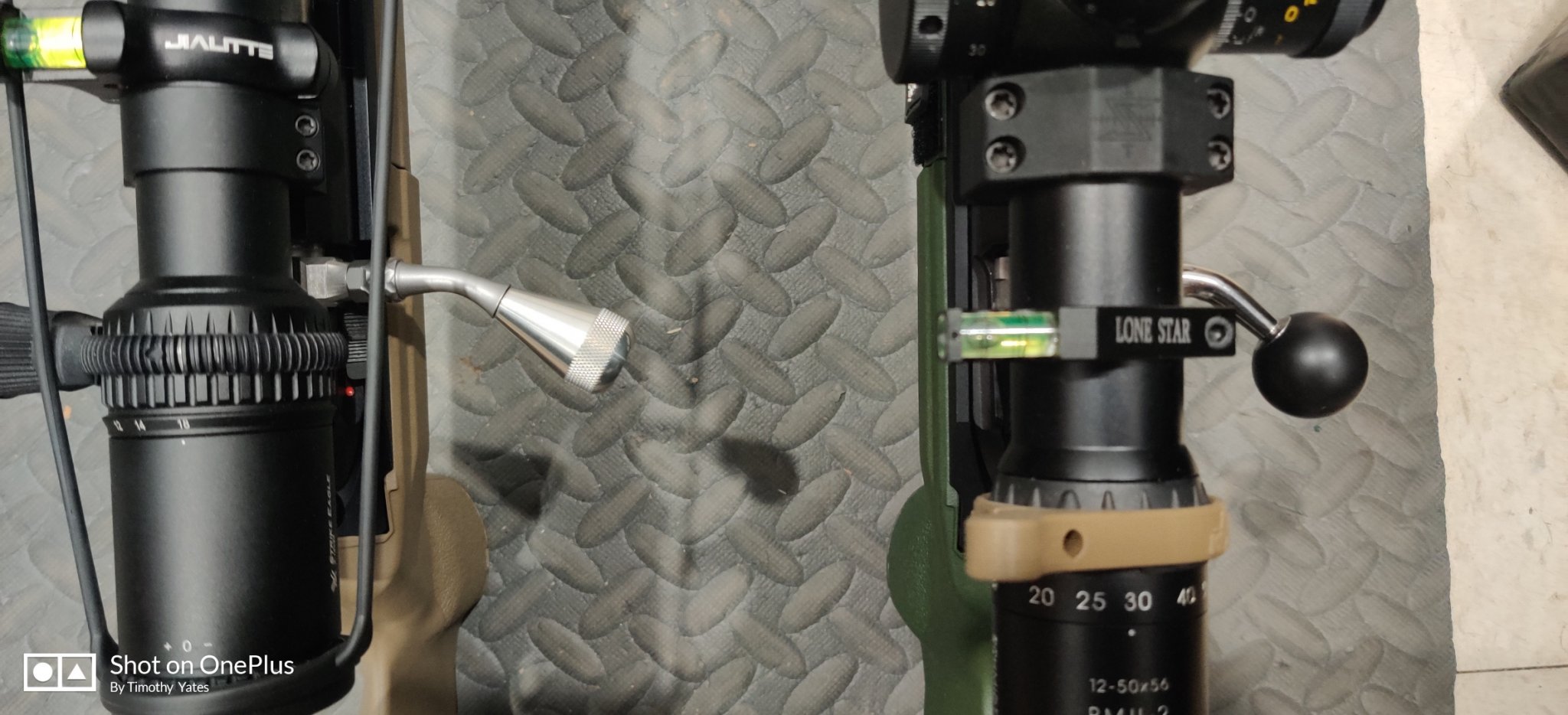

    The Sterk, on the right is a little more swept back and not as long. The Sterk finish when compared to the silver Anarchy version is nicer.
    There you have it, The two newest bolt handles on the market.

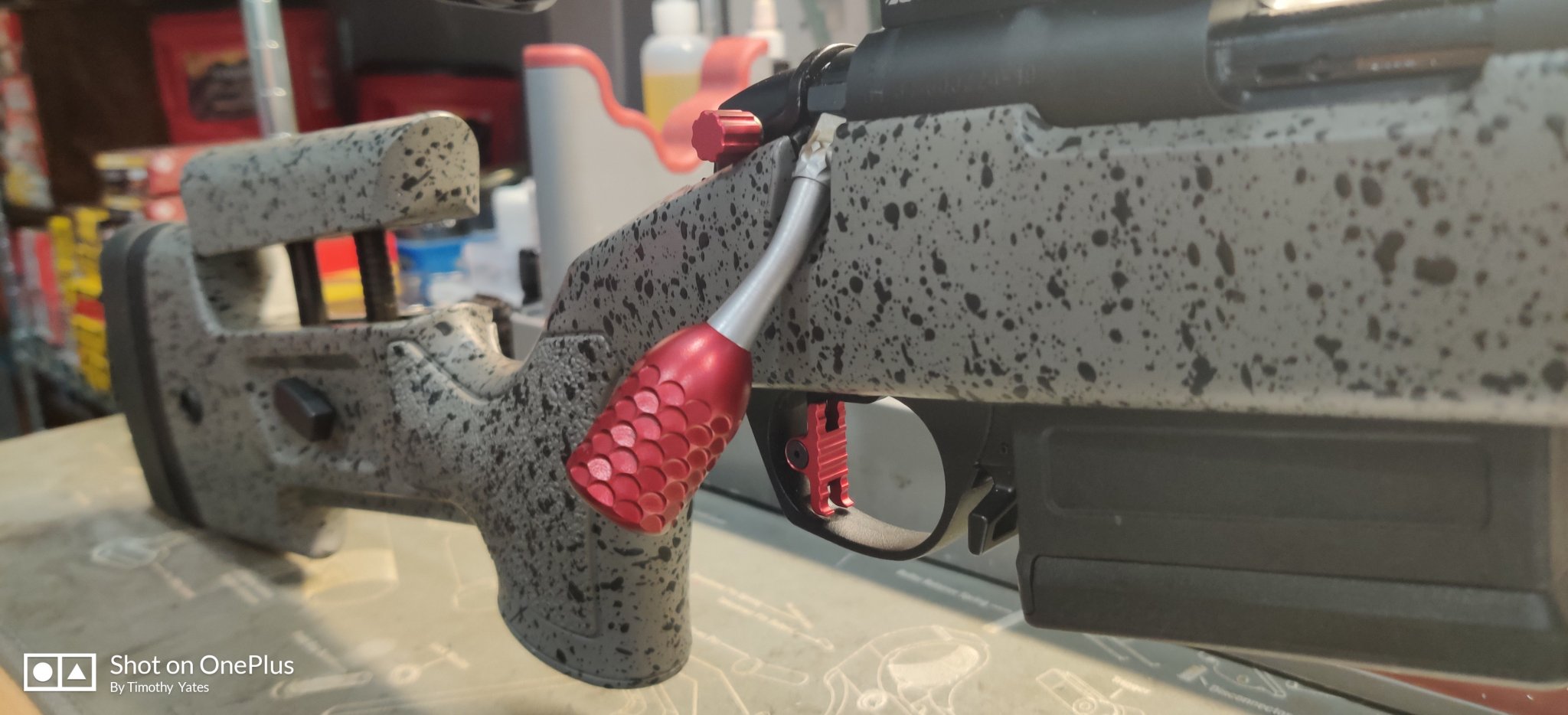

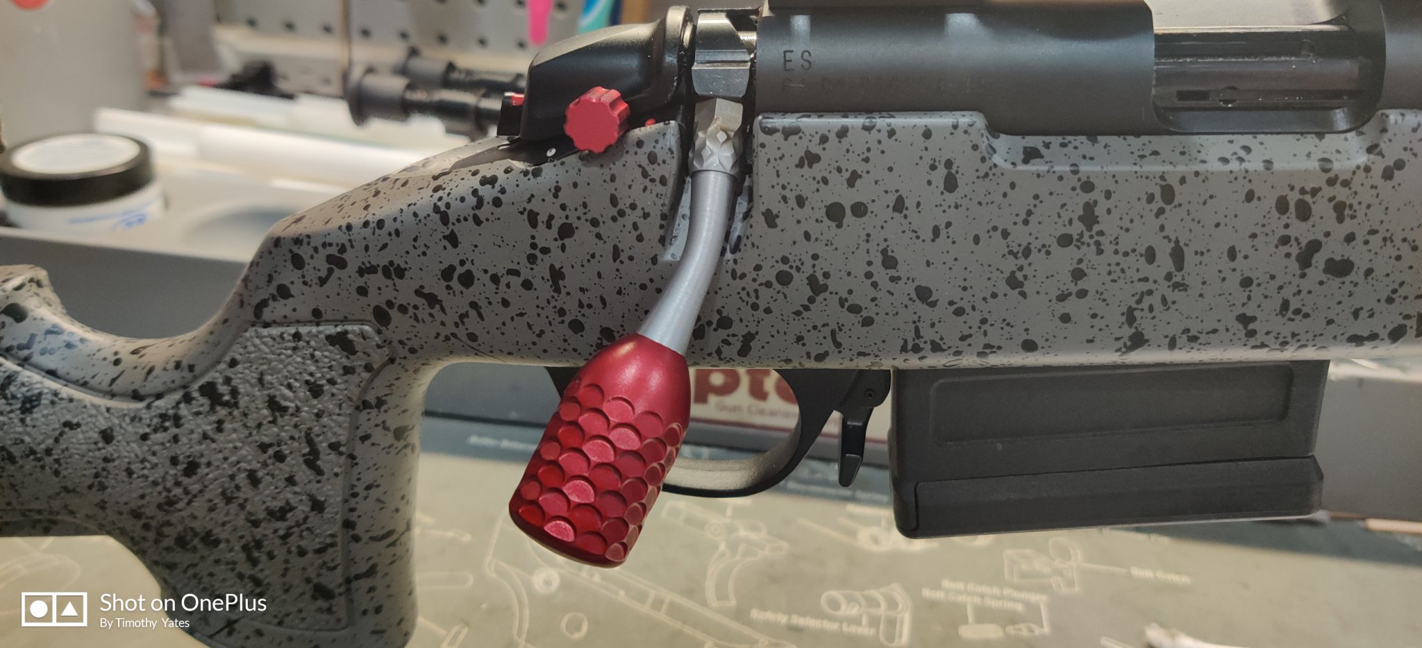

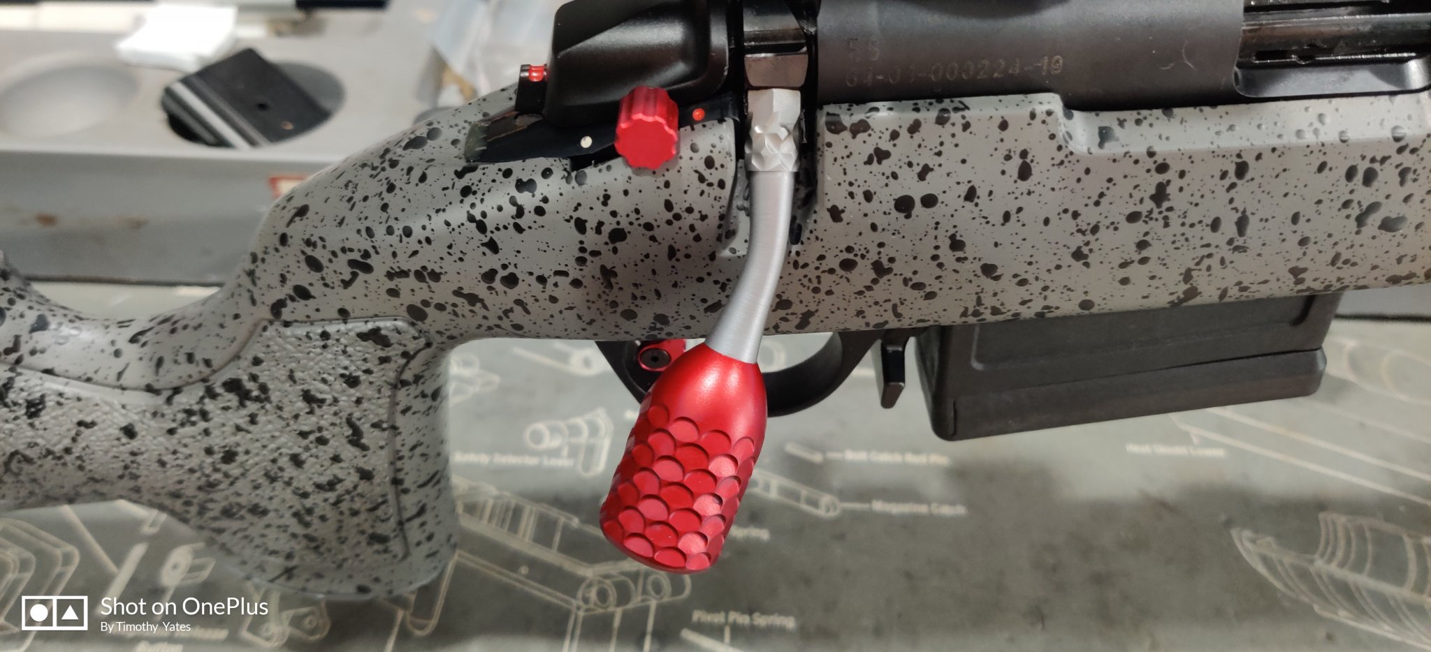

    I finally settled on what I will be using. As shown below, I bought the Dragon Scale and red round bolt knobs from Anarchy Outdoors. The Dragon Scale style is the short one, they make a long one also but it's as long as the Grenade style as shown below. The short style is 1.5" and is as long as I would recommend to be able to easily access the trigger. I had actually planned on using the red ball knob but after looking at it I noticed about 1/4 of the knob has some discoloration on . As luck would have it the dull part showed up on top when mounted to the B-14R handle. So, I put the Dragon style on and never took it off except to add loctite. I had planned on sending the round knob back, but since I had it I decided to try it out on other rifles. I put it on the T1x and the discolored section was on the bottom and out of sight. The length was perfect so instead of going through the hassle and cost to send it back I just kept it on the T1x.
    The angle of these two photos are off to much to give an exact comparison but I'm trying to show the length difference between the short and long knob AO sells.
    I went with red because I wanted to use the Elftmann trigger with this rifle and use the Bix Tacsport PRO on another TBD rifle later on this year. Besides, I think the red scheme stands out without being too blingy.

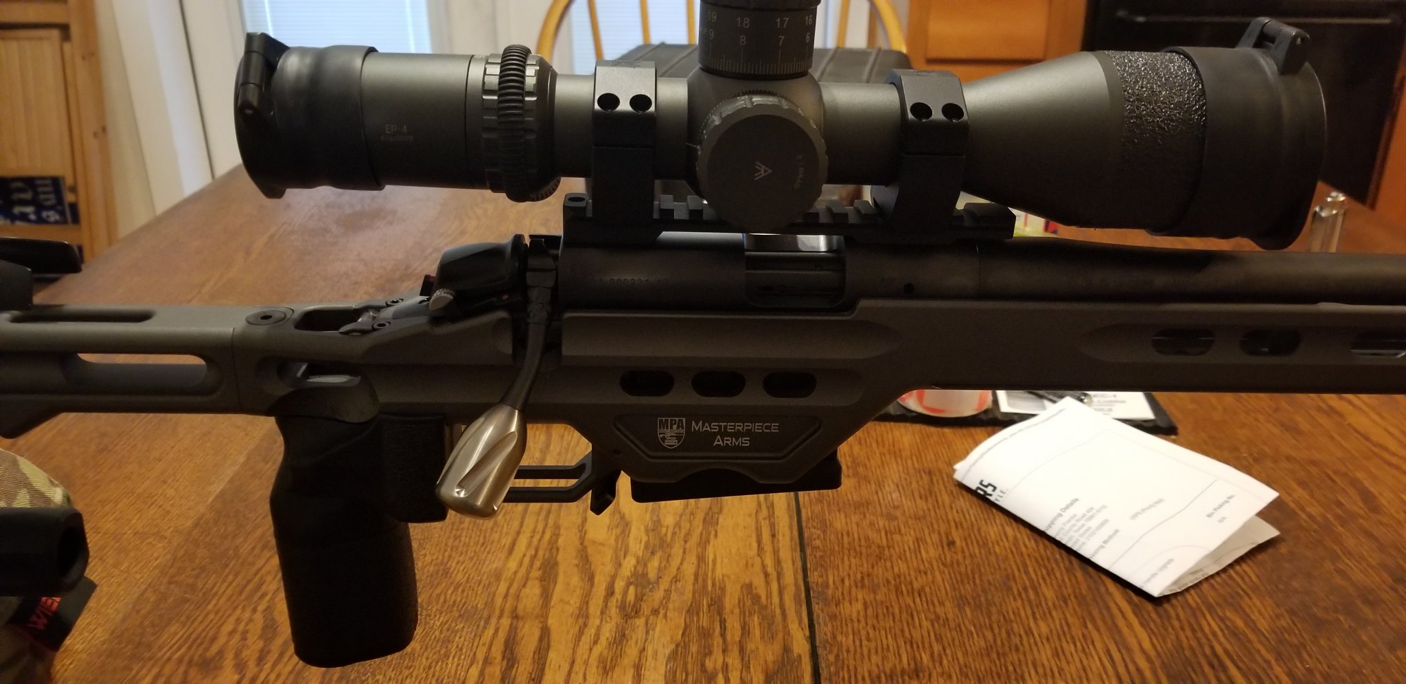

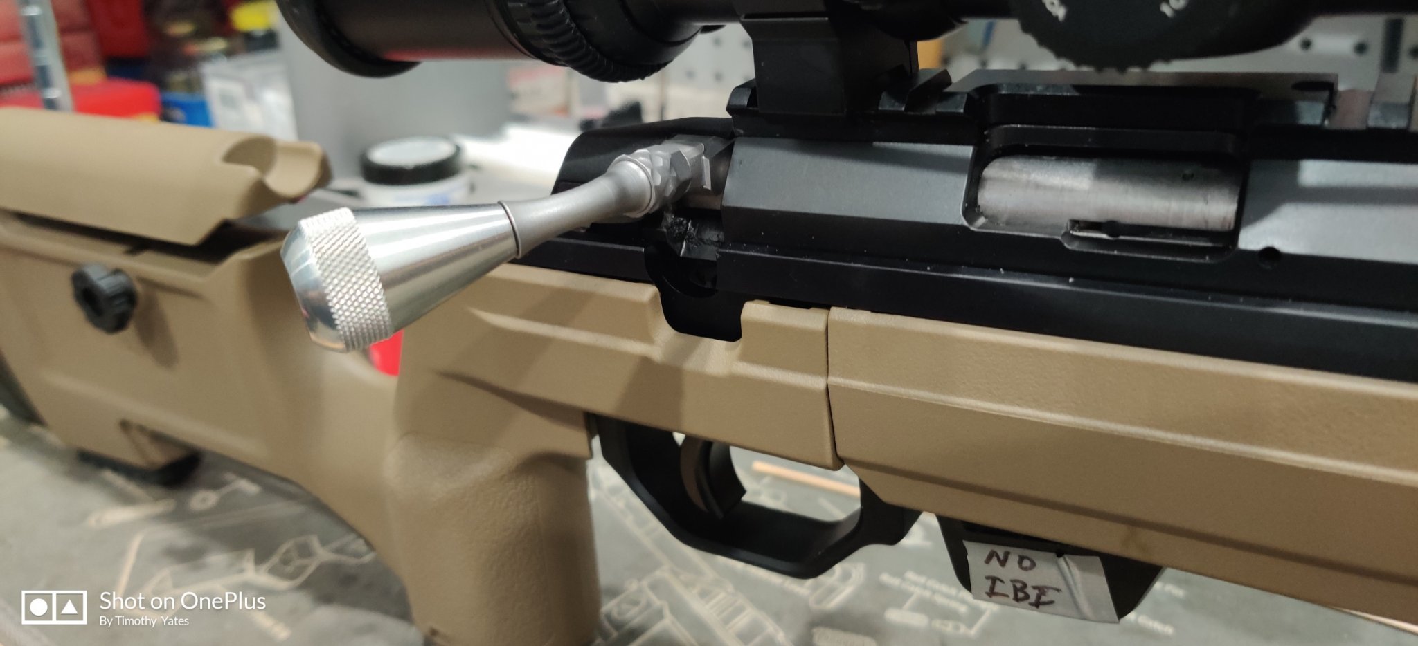

    Here is the red ball knob on the T1x.
