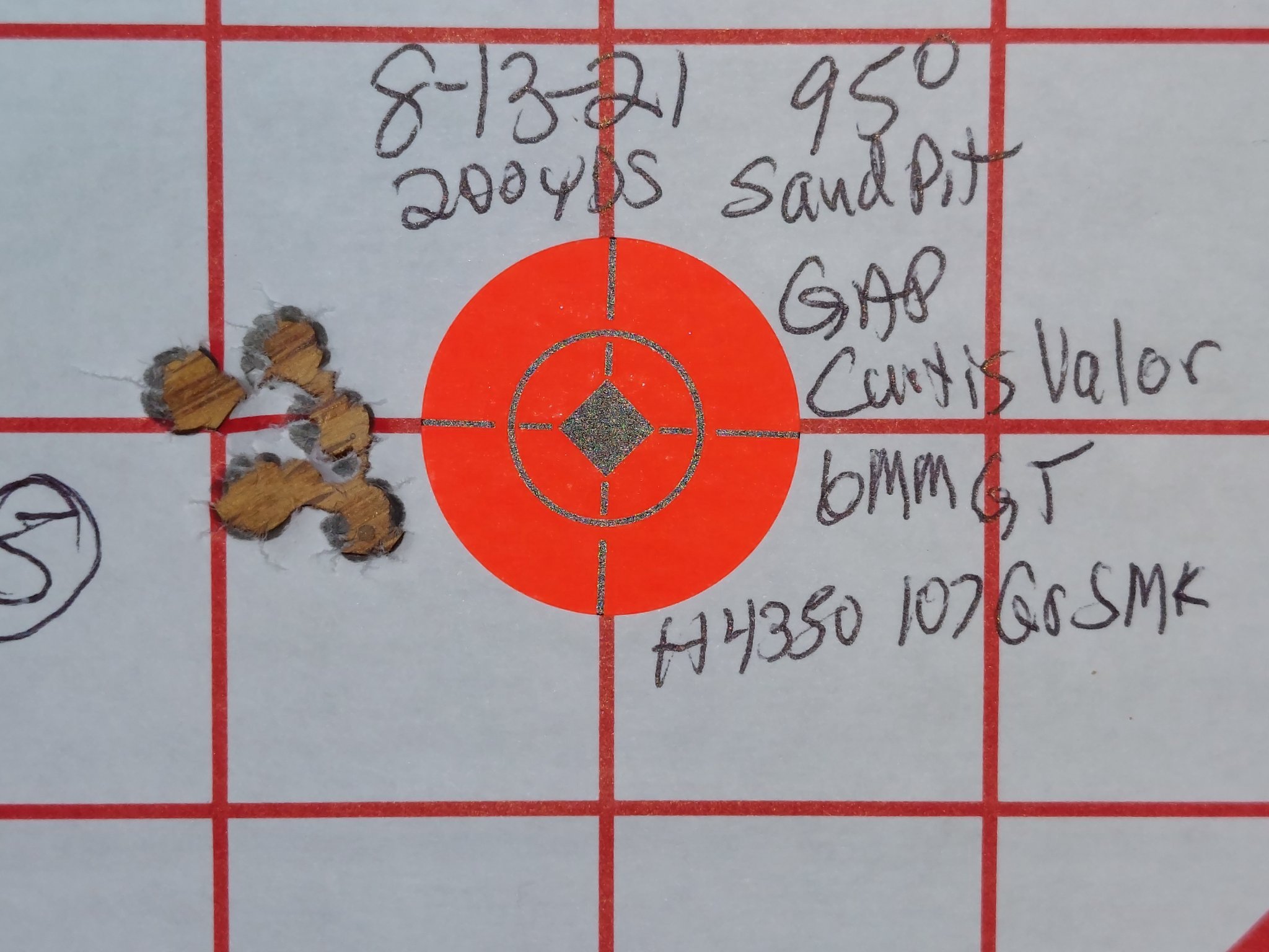

Only a basic loading with h4350 34.5 grains and 107 SMK, nothing worked up. Tried with these 2 new Gay Tigers I got and right out of the gate, shooting off crappy bench and bipods, results are superb @ 200 yards. First groups out of these new rifles.
Go with the Gay 🏳️‍🌈 Tiger!
Just started with my GT a few hundred rounds ago, doesn't seem to love StaBall, but it does feed flawlessly from an MDT.
