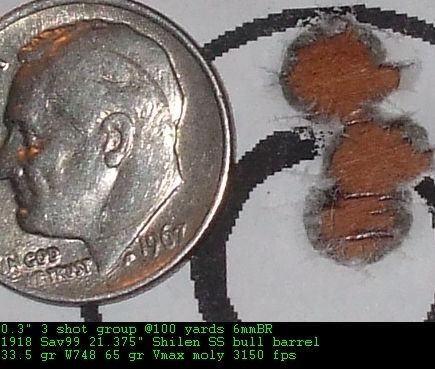

I have built rifles in 6mmBR
I have built rifles in 243 win
I have built rifles in 6mmRem
For the best groups I would got 14" twist in 6mmBR with 65 gr Vmax
For big game hunting I would go 8" twist in 6mmBR with 95 gr Nos bal tip
