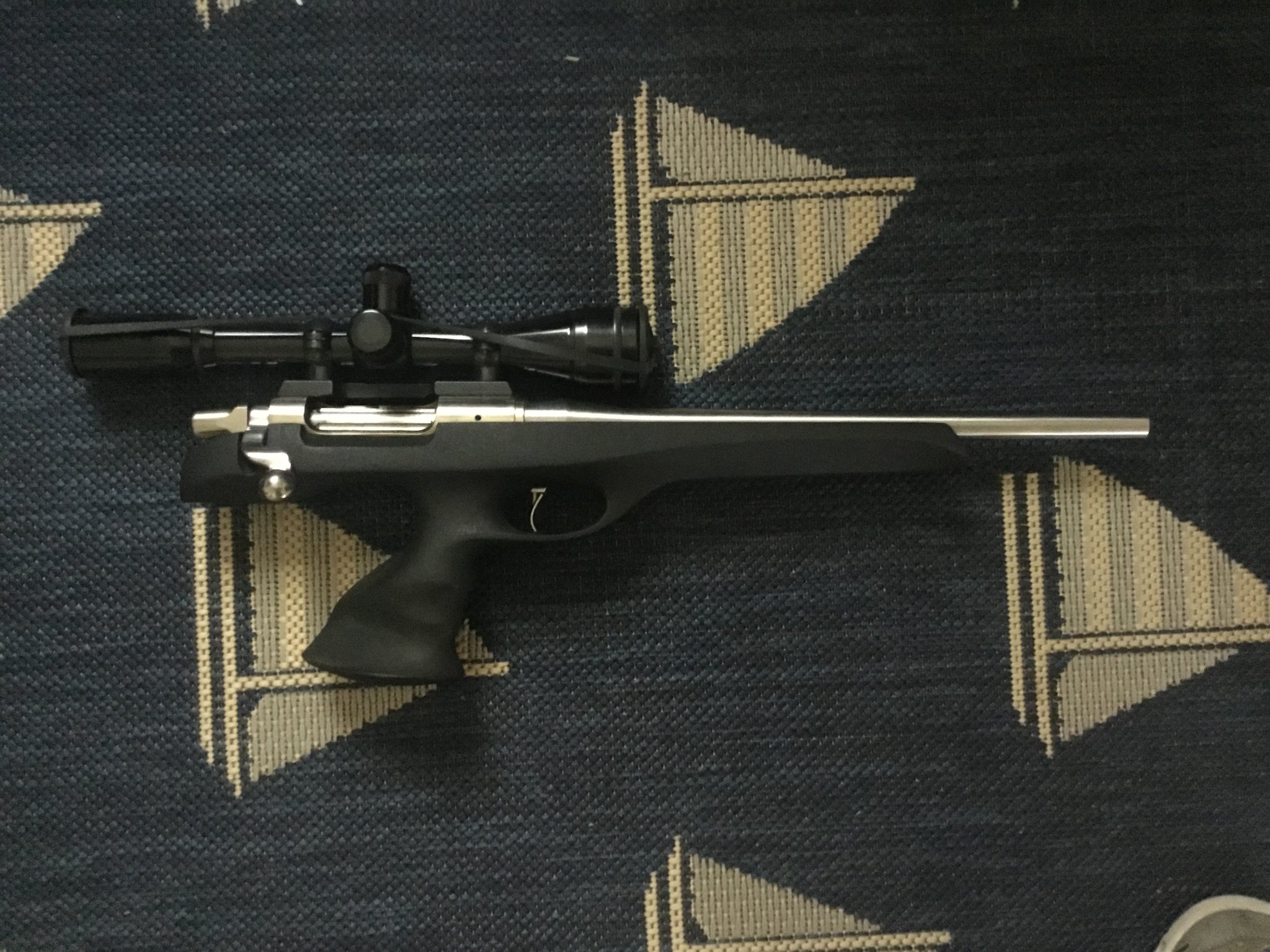

I thought this was a complaint and then a joke. But it’s for real and I have one rifle with the special and it really lags behind the Diamond, so, I would consider this as well. (Especially since I run my Diamonds at eleven ounces.).
Not that I’m not used to lighter pulls. The Del Taylor triggers in our XP’s run right at 2.5 ounces and they don’t have a safety. Funny part, with 39 steel silhouettes down, and one to go for a clean round and a perfect score, that 2.5 ounces feels like 2.5 short tons.
