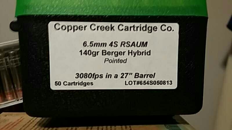

Anyone shoot any of the copper creek loaded ammo? Or know what it's loaded with?

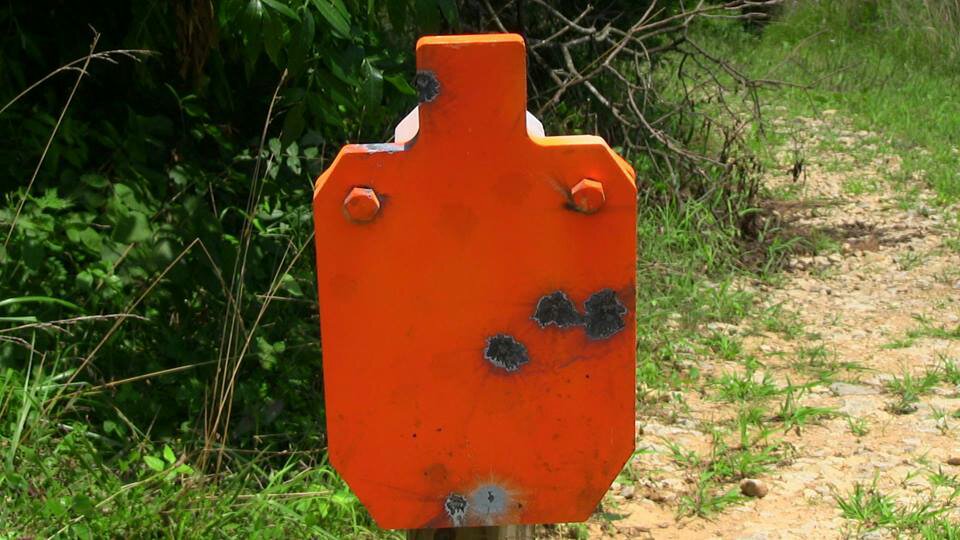

The Copper Creek ammo shoots extremely well. View attachment 47950 This go up was shot at 1100 yards with a GAP rifle.
nice shooting, mine doesn't seem to like it at all. just got the gun and ran 35 rounds down it and nothing better than 1 inch at 100 and most were more like 1.5 inch. guess i will shoot up the other 15 and start trying some loads.
