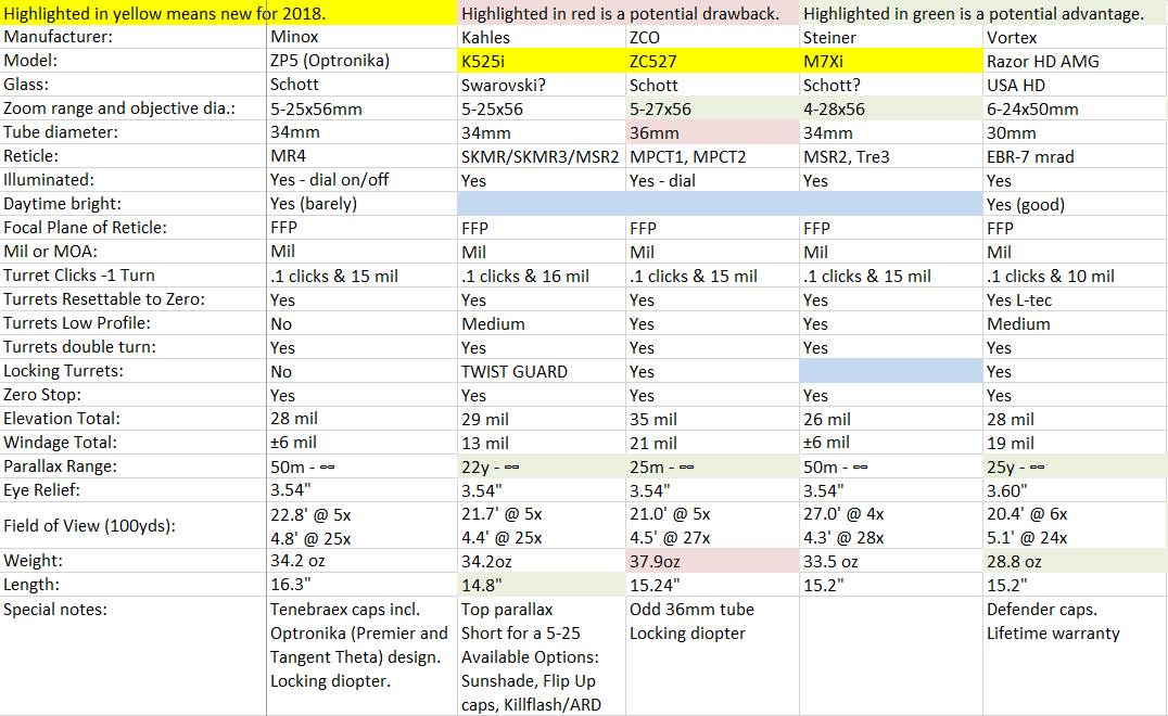

Honest question: shat are the advantages of a Kahles over the Minox ZP5, other than turret location (if you consider that an advantage)?
Like mij already mentioned, the K525i hasn't even hit the shelves yet; however, here is a spec comparison with a few others thrown in:
The new Kahles K525i is 1.5" shorter than the Minox, it does have Twist Guard which helps against accidental adjustment of the windage whereas the Minox doesn't have any locking mechanism, it's parallax can go down to 22y vs 50m, the Minox does have a wee bit of an advantage in FOV but everything else is pretty comparable.
Edit: fixed elevation to windage for Twist Guard
The new Kahles K525i is 1.5" shorter than the Minox, it does have Twist Guard which helps against accidental adjustment of the elevation whereas the Minox doesn't have any locking mechanism, it's parallax can go down to 22y vs 50m, the Minox does have a wee bit of an advantage in FOV but everything else is pretty comparable.
Cool comparison, thanks. Is the Twist Guard on the elevation turret as well as windage? I thought it was just windage.
I've never had either elevation or windage knobs on any of the several Kahles K624i scopes I've owned/still own move accidentally. Have pulled them out of several different drag bags & other soft cases, and neither the Gen II's smooth knobs nor Gen III's scalloped knobs have ever caught on anything & turned. It's my opinion that Kahles hit the perfect combination of click detents on their scopes - it's always been simple, easy, & consistent to get one click when one click was all I wanted on these scopes, and that's more than I can say for any of several other top-end scopes I've handled.
