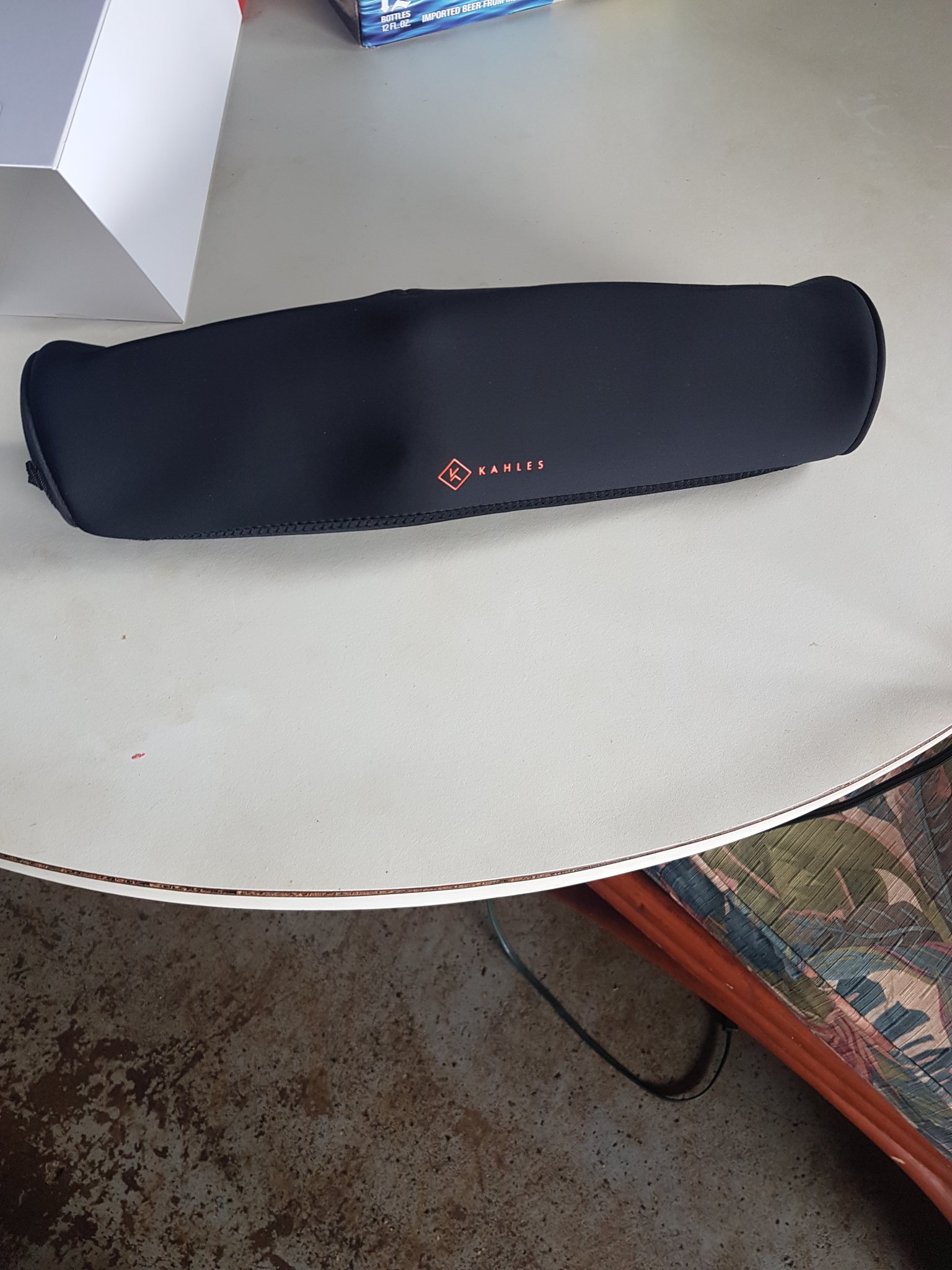

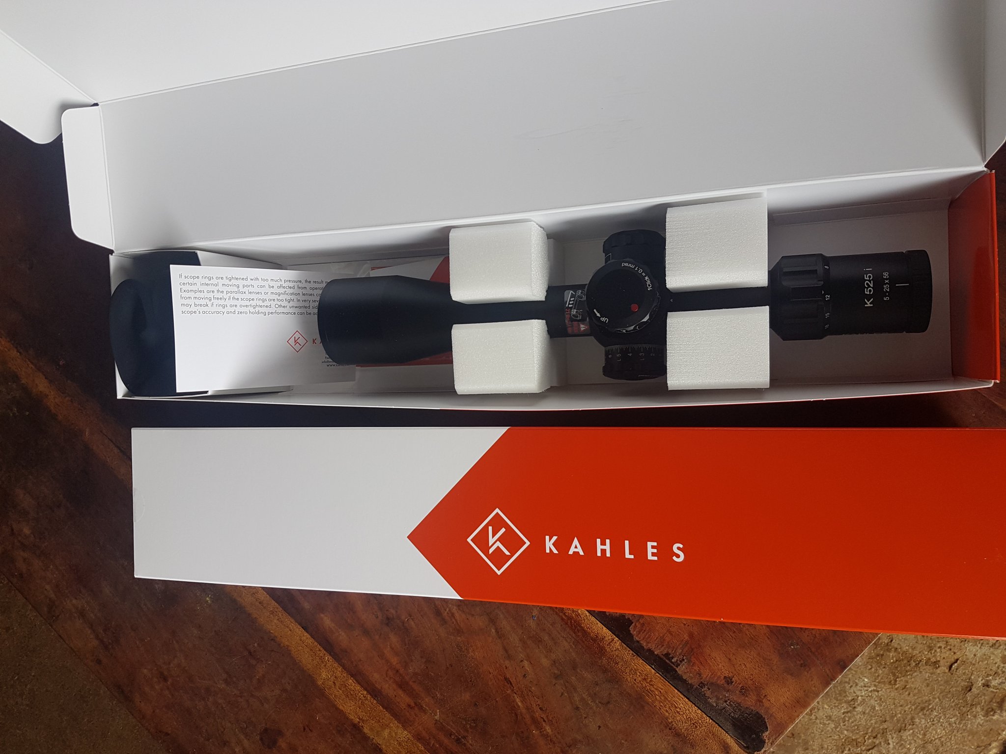

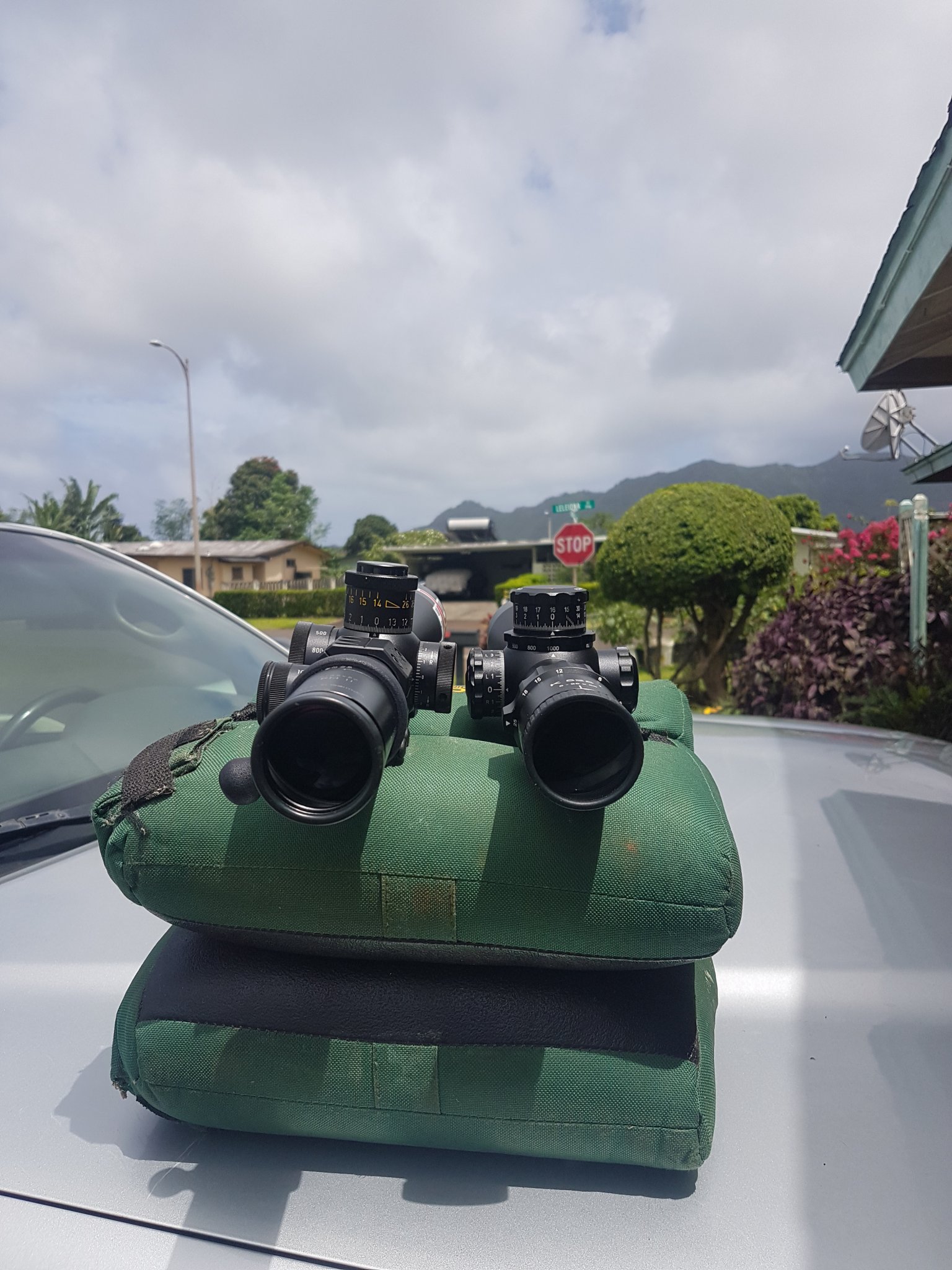

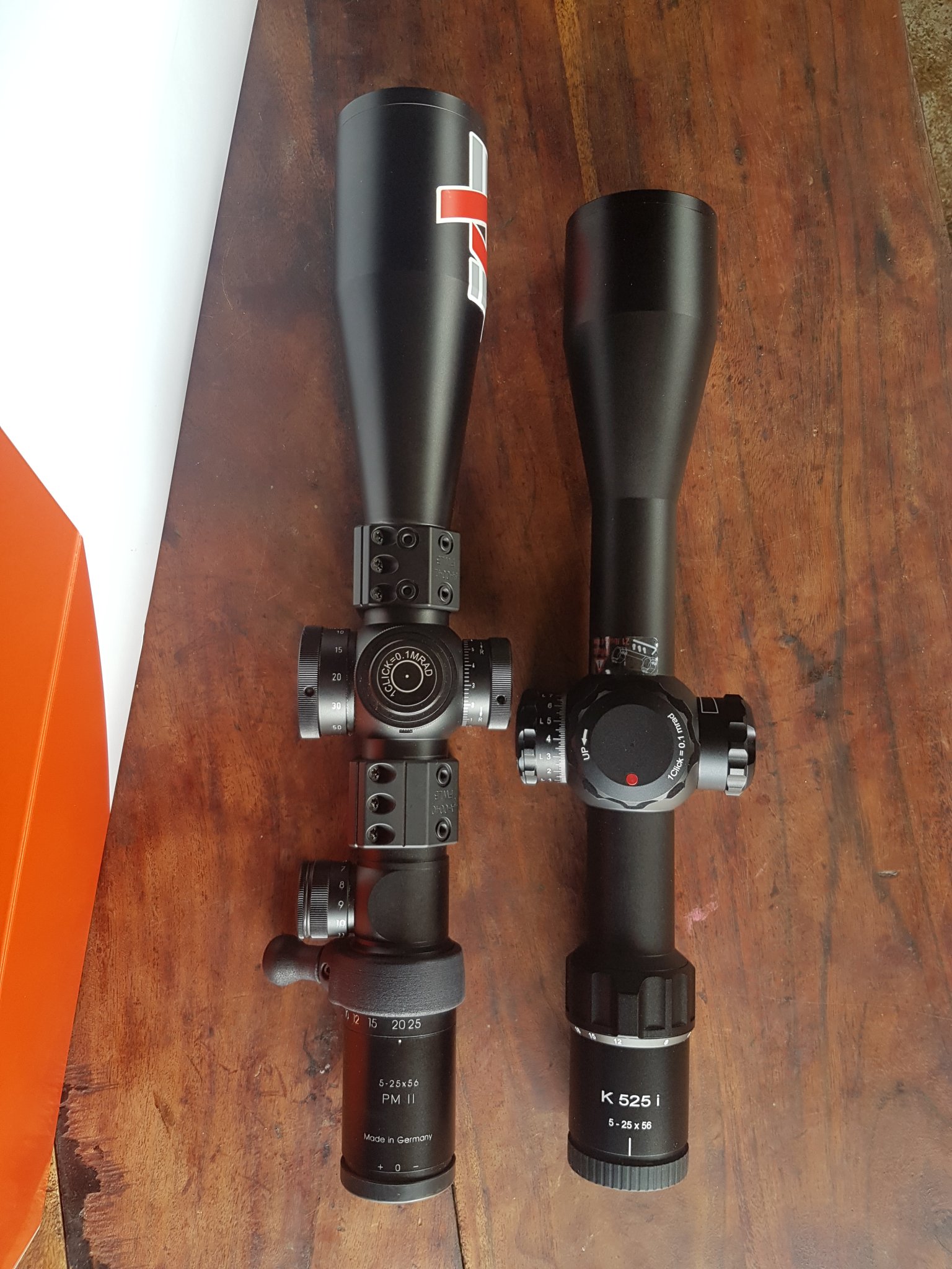

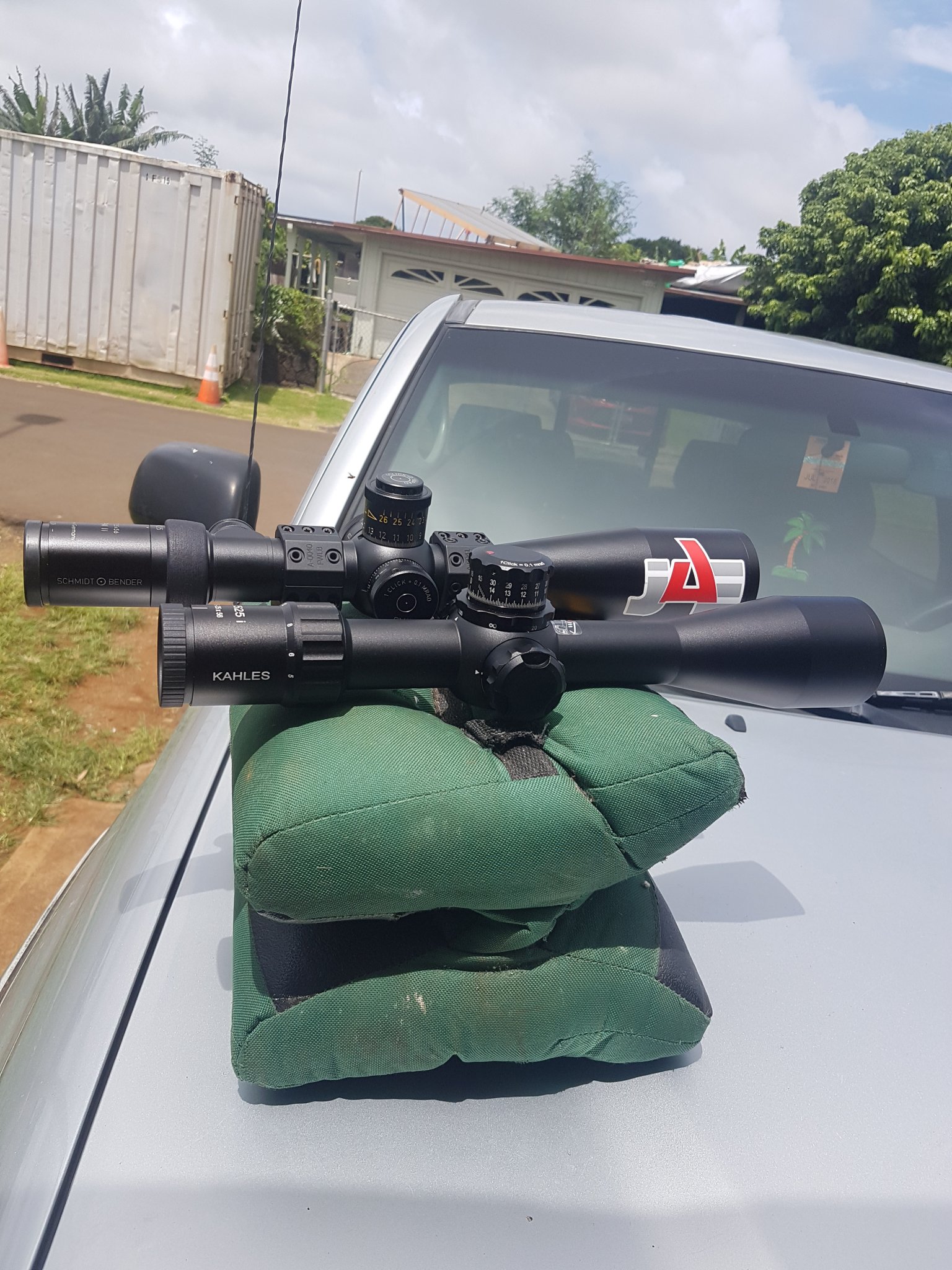

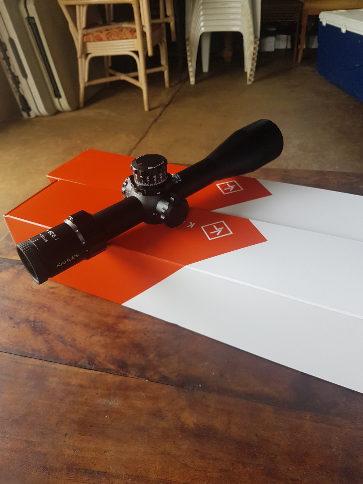

It did come in :) and play around it a little side by side with my pm2 5-25 gen2xr.
First thing i normally do is aim both scope at that 2mile maybe 2.5 miles mountain.and see the detail on contrast, brightness,sharpness,FOV etc.
well the abvious is definitely shorter than pm2.turrets as expected from all kahles.very nice and positive...i wont go on detail from comparing..
One thing made me sad right away...no cap! No bikini!!
I dont use raincoat guard cover i hate it(not my preference)
I tried old 624i kahles bikini and it will only fit the objective abviously the k25 has larger ocular...ill get back for more need to mount this dam thing!
View attachment 6926467View attachment 6926468View attachment 6926469View attachment 6926470View attachment 6926471
Are you sure that there wasn't a cover in the box? Mine came with a very nice padded bikini cover in the box!

It's a beaut Clark! (From Christmas Vacation)
Larger ocular = more forgiving eyebox? At least I tend to find that scopes with larger ocular's typically provide a better eyebox.

Crazy how much shorter the Kahles is beside that PM II... Can’t wait to hear some reviews from guys on here once they have some time behind it.

Same observation here vs pm2..im trying to be bias towards k25 becoz im liking it being more compact..turrets on kahles is definitely my preferred over pm2 but like you said at max power the pm2 slightly better glass..(in my own eyes)
The difference is like when i conpared my pm2 vs. my TT 5-25 not much but you can see
