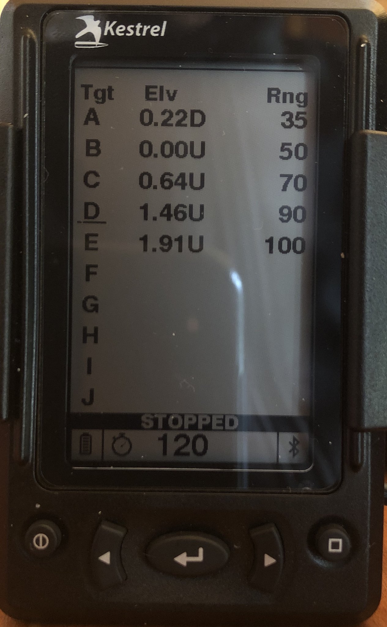

I am now acquainted with my HUD and I can’t imagine PRS 22 rimfire life past 35 yards without it. I play in the wind most of the time at distances out to 450y where I’m regularly holdIng off 0 to 3 mils for wind. I’m most impressed by getting hits while watching the HUD in real time and reacting to wind holds.
I come across no turret multiple target stages quite often. The HUD makes my life easy in Target Card mode. I make the first target (A) distance a ghost at my zero range (35y in this case) then add the actual targets (B thru E) at their respective distances (50, 70, 90, & 100)
The card looks like this:
Then I change the Gun zero to the first target distance (ZR 50). Now Target A is my initial dial value so my first real target (B) hold is the reticle center and the respective holds for the remaining real targets is shown thereafter.
This method works well for short range targets. All bets are off for ELR.

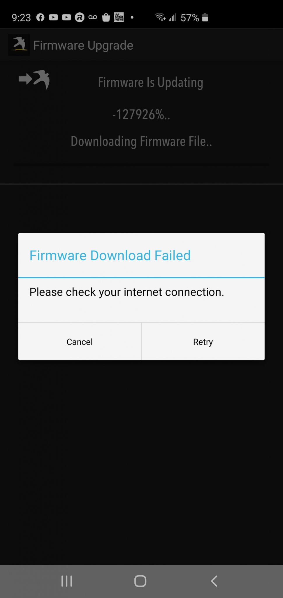

Has anyone had issues with updaying their Kestrel Hub via the ballistic app? My HUD is on FW .24 (I Think) and when i try to update the FW, it says "Check internet Connection". Ive unistalled the app multiple times as well as tried on multiple devices and still getting the same message. Ive contacted Kestrel but havent recieved a response. Any help is much appreciated.
Mike - Firmware 0.24 means it was an Alpha test unit and is not firmware upgradable in the field. It should have been returned. Please email us at [email protected] and we can see how we can resolve this for you.

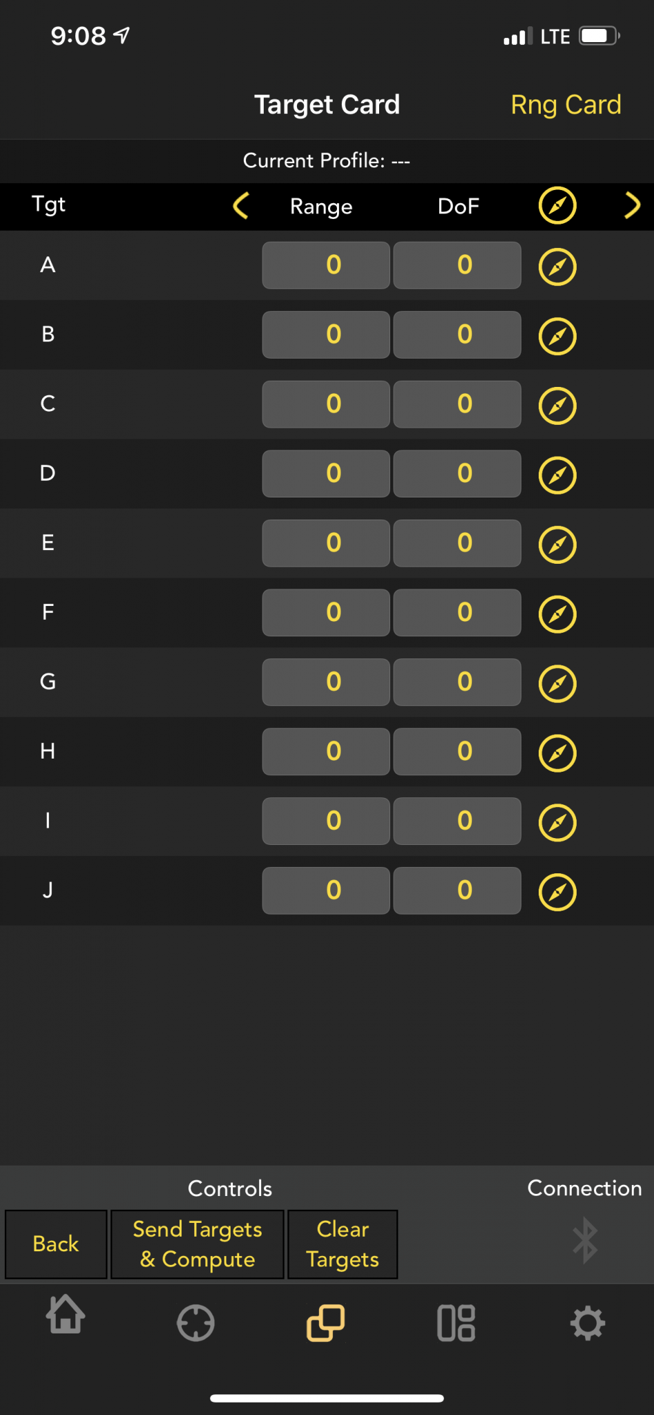

Looking to possibly get one of these but wanted to know a few things first. Like mentioned above will the level and shot counter be added soon or is it already added? And in the future or can it now be able to connect to my phone and the HUD at the same time? I would like to be able to use the kestrel app to input targets to the kestrel 5700 and in turn show up on the HUD. Please advise if any of these are currently working or will be available in the near future.
Why are you using your phone to input target data instead of doing it directly on the Kestrel? Makes no sense to me.

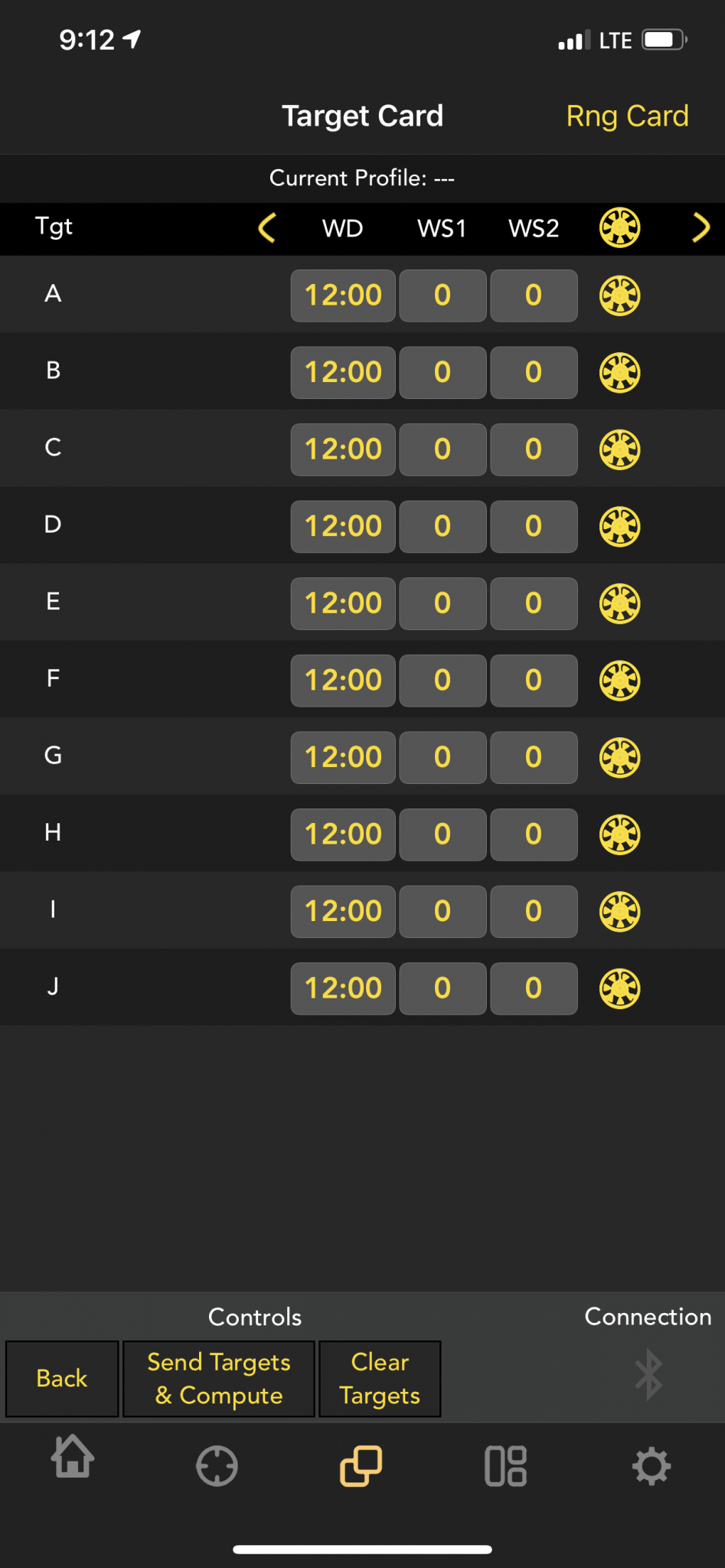

I can type it in and capture all the data while the kestrel is in a vane mount. Seems like it would be way faster to type on this screen rather than doing a bunch of scrolling and capturing on the kestrel. You can point your phone at the target and click the compass to get target direction (the first pic I attached) and then capture current wind direction and speed on the next page using the little impeller symbol (second picture) then send it to the kestrel and then it would display it on the HUD. Target card done 🤷🏼‍♂️
I'd imagine that they'd have to make some major changes to the firmware to do what you want, if not outright hardware changes, since the Kestrel has to be in different connection modes to talk to your phone vs the HUD.
I'll add that you might want to play around with the multi-target screen in the Kestrel a little more. It might not be quite as fast as typing, but I've not had any issues with being able to put in target distances quickly for multiple targets from that screen, and they all feed over to the HUD nicely.
I haven’t messed with the multi-target screen very much, I’ll definitely have to make up a course of fire and go through it all on the kestrel to see how long it actually takes, might not take as long as I think it does. I would primarily be using this for matches so time always seems precious lol. Has it worked well in matches for you?
