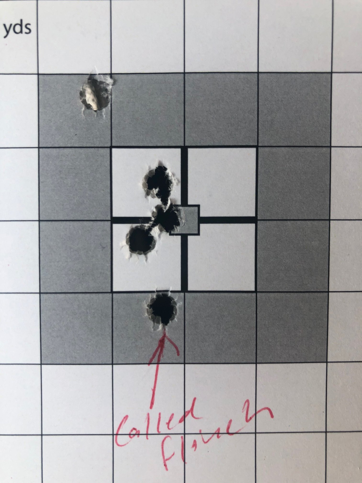

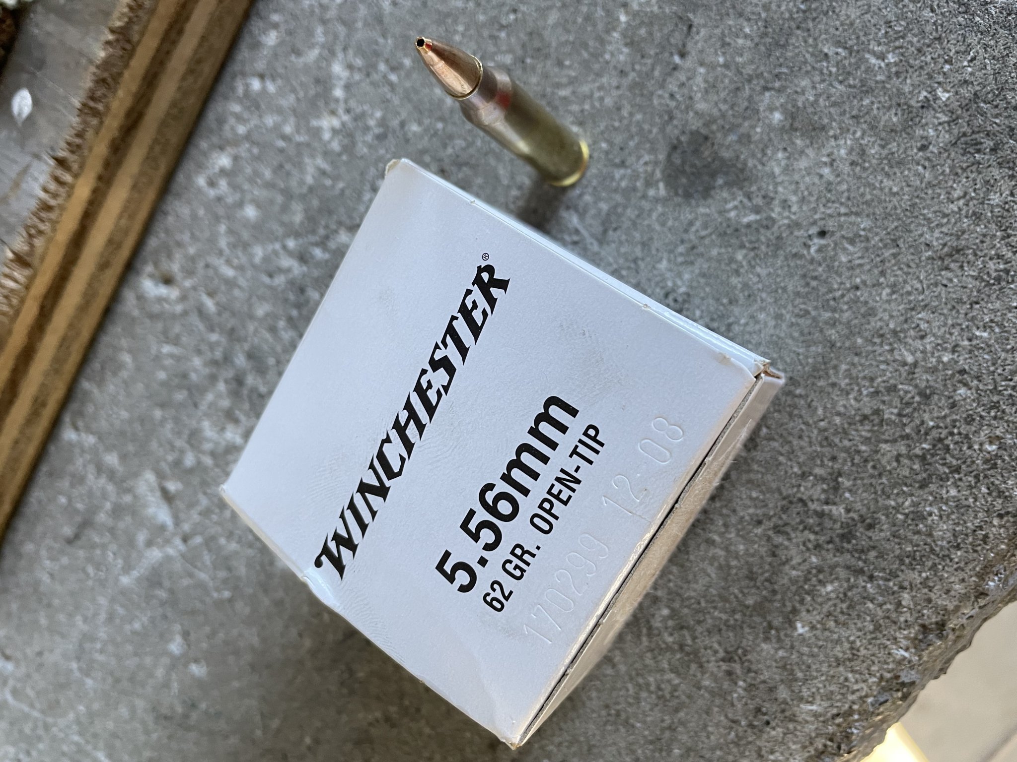

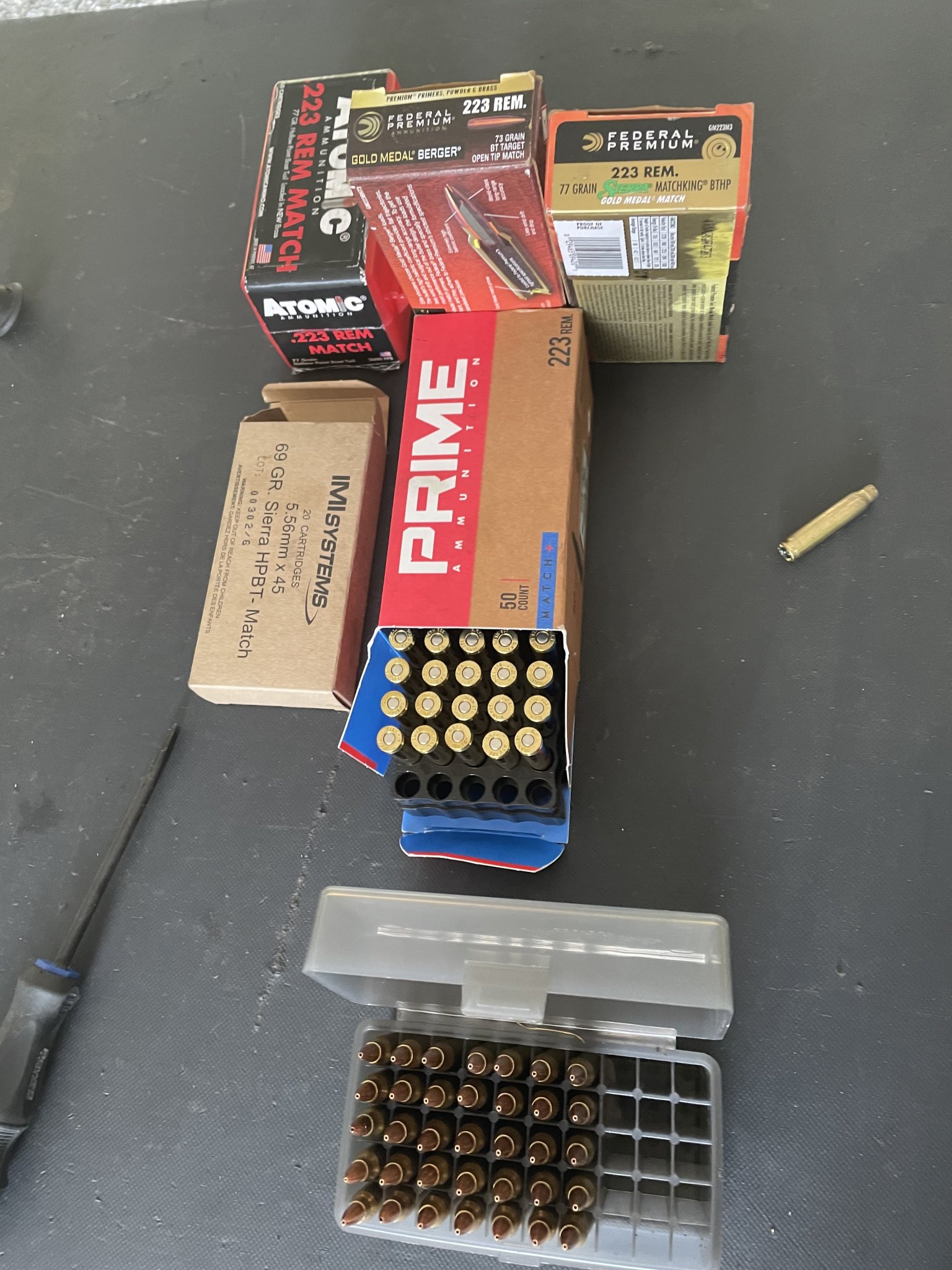

Just shot today with some get to know you rounds… got one good group with a flyer and others that show plenty of promise. Upper was well assembled and was a tight fit to my LaRue lower. So far I’m very happy with the upper.
Is the ammo you used, some of the Swedish made Winchester ? I can't tell from the pic.
And thanks for posting !

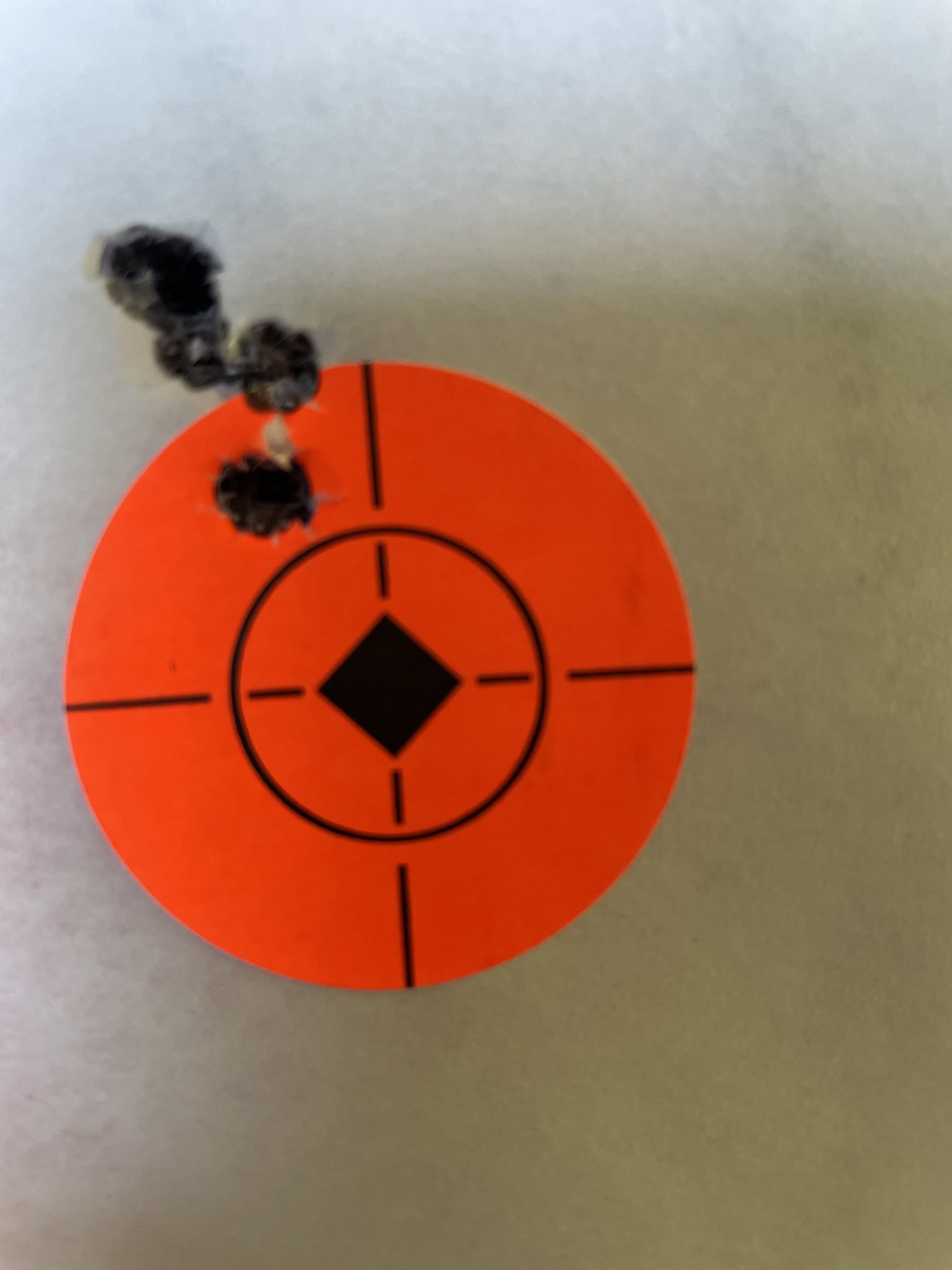

Just finished shooting more today. Shot different “match grade” ammo with 1.25”-1.5” results. Nothing spectacular until I started with my 77 grain HPBT hand loads over 23.4 grains of 8208 XBR. Getting close to 150 rounds total shot down the upper with zero malfunctions. Think I’ll keep it!

Did you shoot more than 1 group with the handloads? Nice group, but I’m curious how it does at reproducibility for 3+ groups.
that is pretty sad given less than 10% of shooting community reloads so most are stuck with commercial match loads. 1.25 to 1.5 is not good with 'match' ammo.
I admit I’m not the best marks man… just showing potential…..you results may vary!
Yeah, that’s why I was curious if you fired any other groups of handloads. A single group doesn’t really tell too much, especially if you aren’t very confident in your ability as a marksman. If you shot other groups, I’d be interested in seeing those.

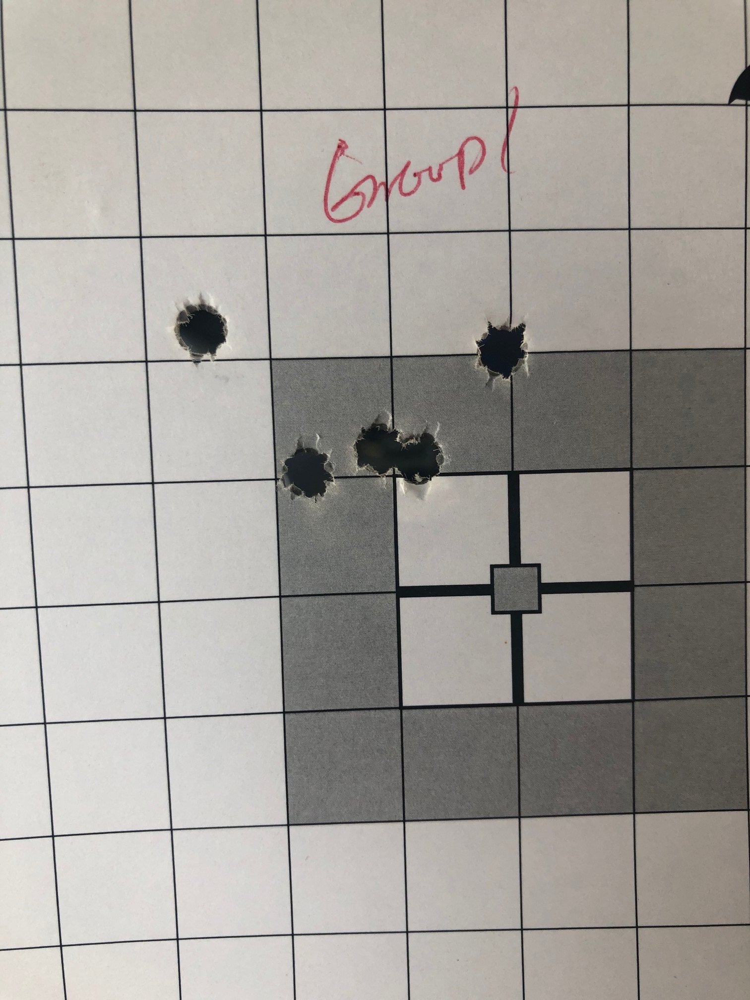

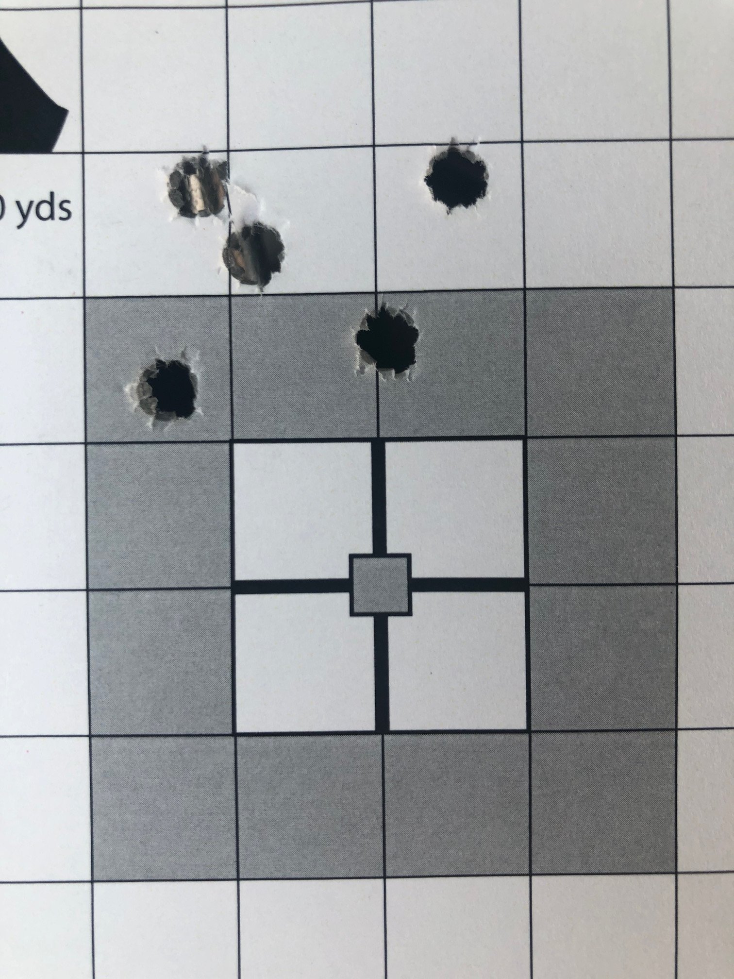

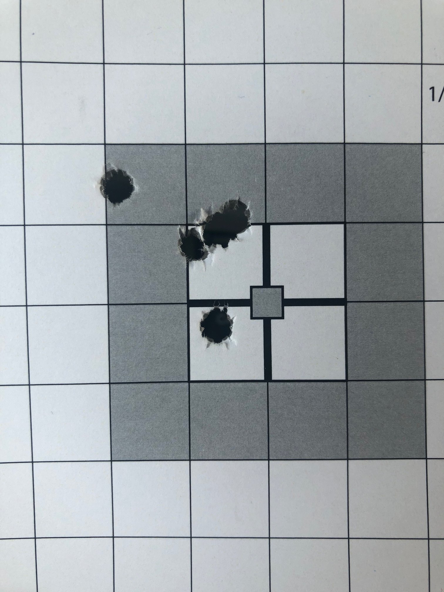

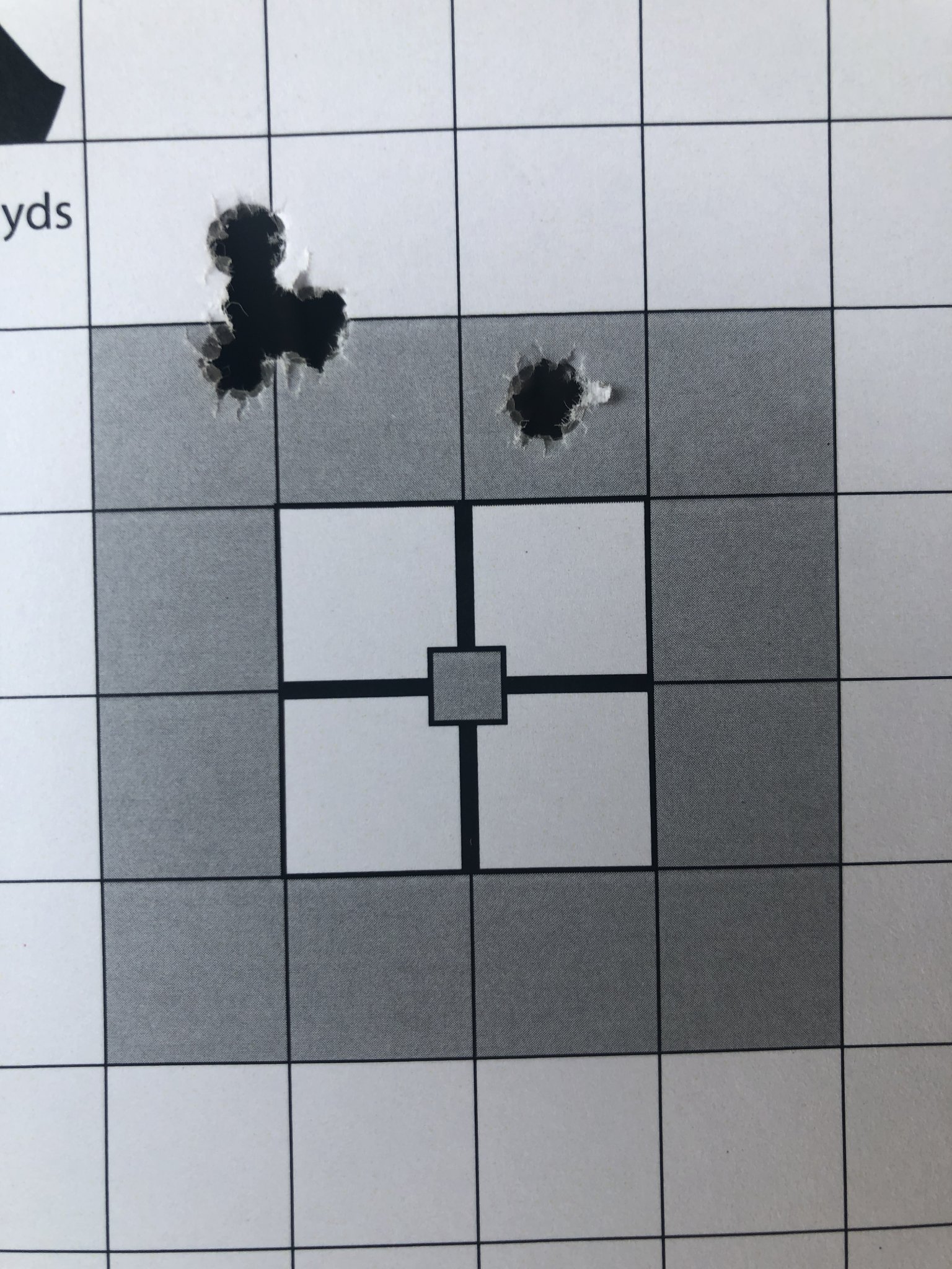

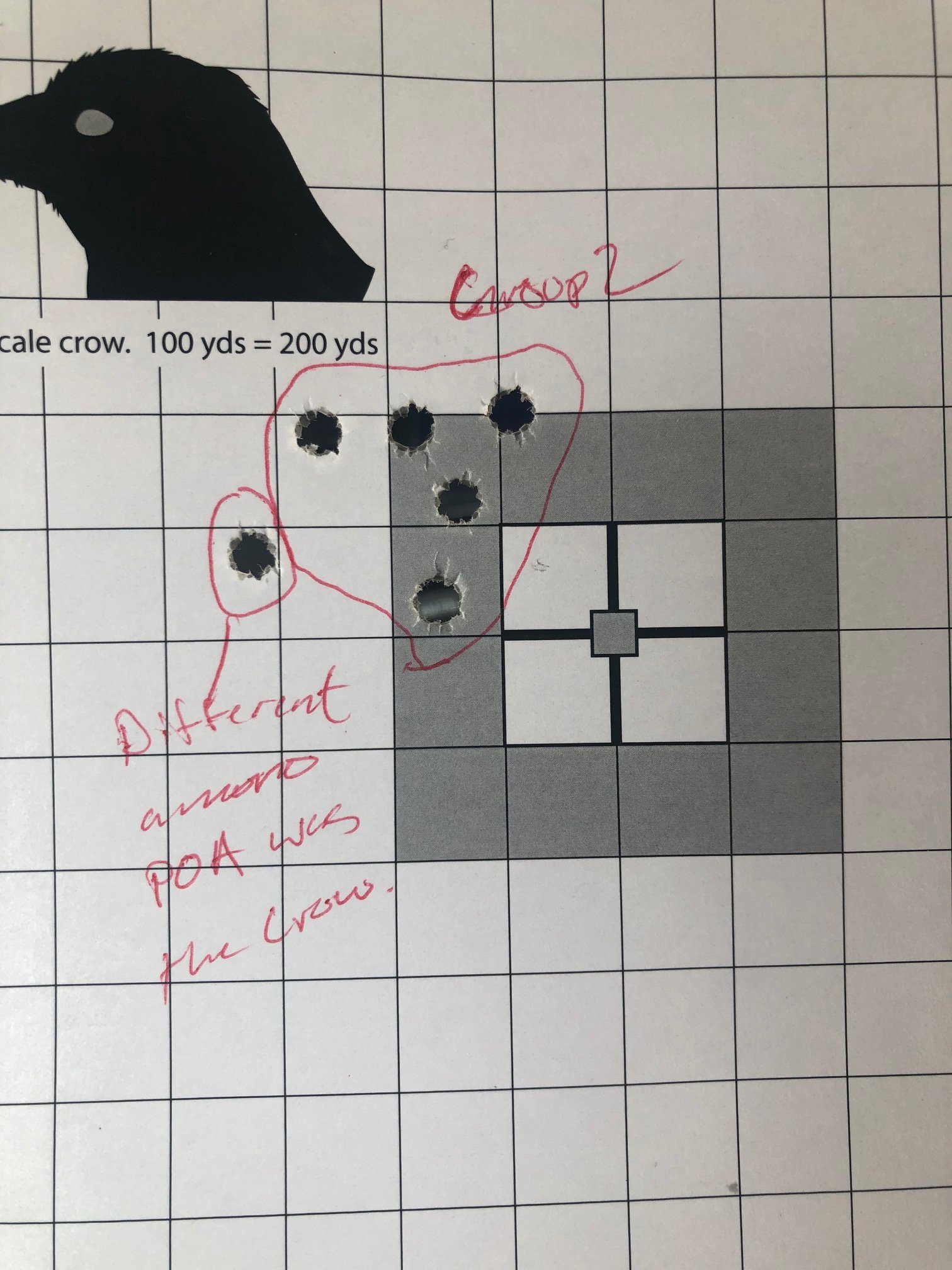

Hey all,
Went to the range on Saturday with this new upper. Lower is a LaRue billet with MBT, and a Magpul UBR stock. Standard buffer/spring. I said I’d post results good or bad.
The results: mixed, not happy yet.
I’m hoping some of you more experienced gents can help me interpret some of this stuff.
I fired about 70 rounds (two types of ammo) and had one failure. Live around went ‘click’ in the chamber and was stuck. Removed it with a significant multi try pull with both hands on the charging handle, stock wedged in my shoulder. The 20 round Pmag I was using would no longer seat in the magwell after that. My other pmags had no issues, that was the only malfunction of the day.
I was shooting off a bipod with small rear bag using Nosler match grade 77 gr .223 HPBT. I was moving the dials on my Bushnell LRTSi 3-12 between 5 shot groups. I had a recent move and can’t find my calipers but these are LaRue grid targets. You can see that most groups are 1 - 1.5 moa or so. Anyone who wants to use fancy software to correct that estimate is welcome.
Brass is ejecting at 2 O’clock. I’m going to put in an H2 buffer to see if that helps.
I’m hoping to see the groups tighten with a few more rounds through the barrel. Match ammo is still scarce so I don’t have the luxury of finding something it ‘likes’ yet.

that is pretty bad, sorry as that is not what you want from a new purchase

This is a 10-group of hand-loads fired from one of my precision AR-15s . . .
This is a 10-shot group of the factory loaded Nosler 77 grain OTM fired from one of my precision AR-15s . . .
These are your 5-shot groups with the Nosler 77 grain OTM . . .
Monstershot - your groups look pretty similar to what I was getting from my 12.5" LaRue upper and 77gr. IMI Razorcore. Averaging about 1.25 MOA, which is not horrible - but also not great.
Also shot an older LaRue upper a couple of weeks ago and that was averaging about .75 MOA with same ammo. What I notice about both your groups and mine is that dispersion looks fairly even, rather than 4 shots in a cloverleaf and the fifth wide. This leads me to believe that at least some of it is the gun/barrel, rather than the shooter. Whereas when I get 4 shots together and one wide, my inclination is to blame myself, rather than the gun, particularly if I'm able to get a couple of very good groups. Of course, I could be completely wrong on this.

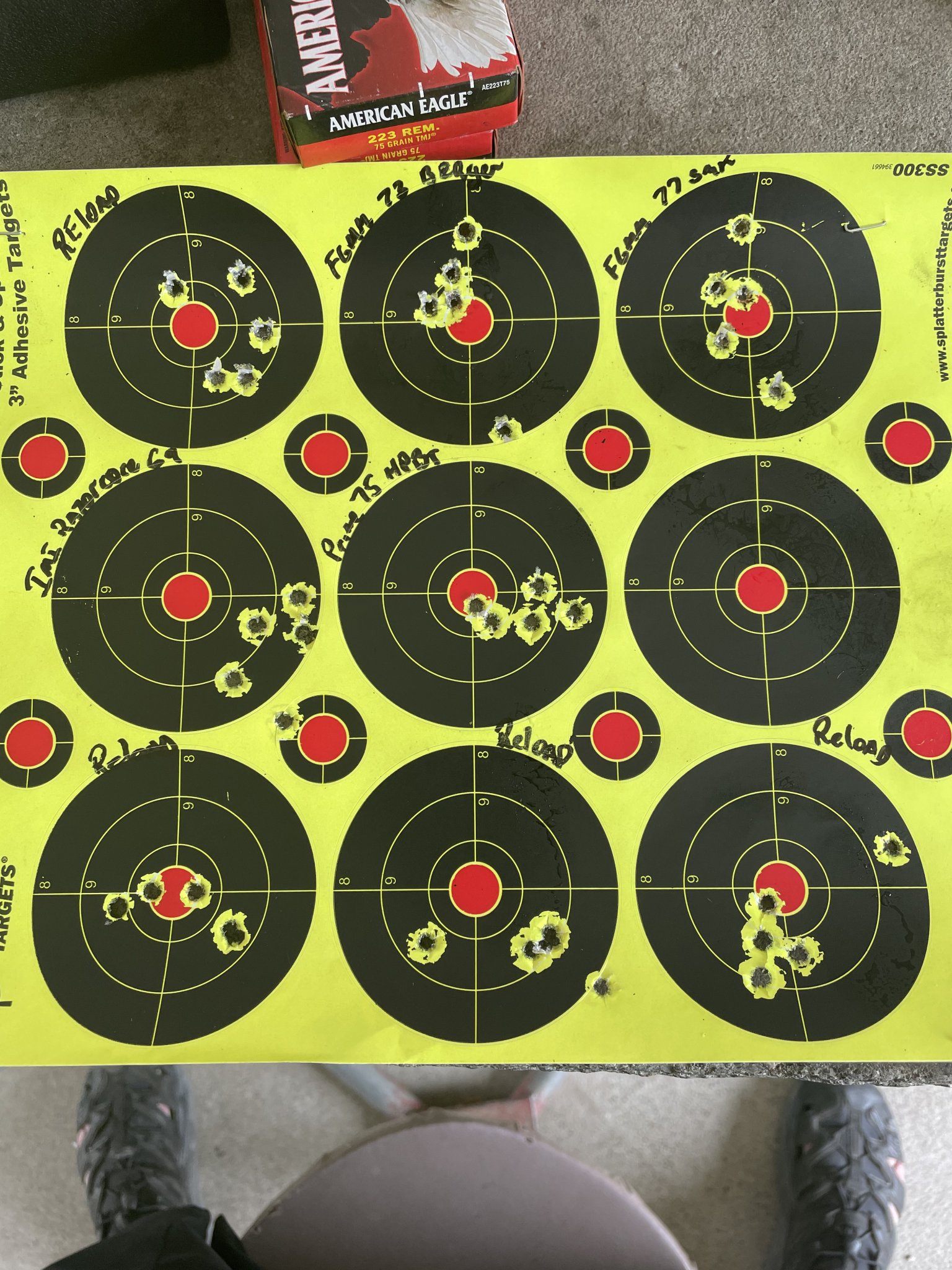

The good, bad, and ugly. I fired 8 5 round groups with 4 being my reloads and the rest being commercially available match ammo. FGMM 73 grain Berger, FGMM 77 grain SMK, IWI 69 grain razorcore, and Prime 75 grain HPBT. Might be able to get better when I increase the round count of the rifle.

If its a known good scope/mount and you shoot lots of AR15s then I'd send it back to larue with those targets.
I would like to get the round count above 300 before/if going that route. Worst case, re-barrel with a Noveske/Bartlein/Douglass 16” with CLE chamber and enjoy my “$600” upper….lol.
I wouldn't waste any more ammo you are just sending dollar bills downrange. Either back to larue or yank the barrel off and sell it on arfcom for like 200 bucks.

JimmyT - maybe wait and see if things settle down a little after a couple of hundred rounds.
But yeah, with match ammo those groups are nothing to write home about. I'd expect even a cheap PSA/no name upper to produce similar results using match ammo.
Reactions: bfoosh006
Totally agree. I’ll power through some “buyers remorse” and get down to business.
