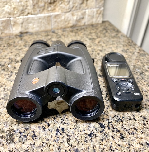

I really liked the Zeiss Victory RF. Ranges everything I ever wanted and gave dope near immediately. I wanted a smaller bino and 8’s otherwise I’d have kept the Zeiss.
I wanted to answer a couple questions in the thread. First, I can confirm the Pros connect to both the Tactix Delta, Tactix 7 and Kestrel. Second, they have onboard AB Lite which it will use if not connected to another device. You can upgrade to full AB Elite for $150 through the app.

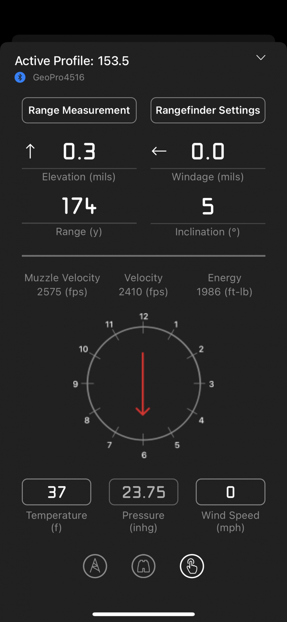

You mean this?
We’re looking for the whole enchilada. As stated, I looked through the manual already.
I’d like info on whether all the data previously mentioned is displayed in one place while ranging. Thanks

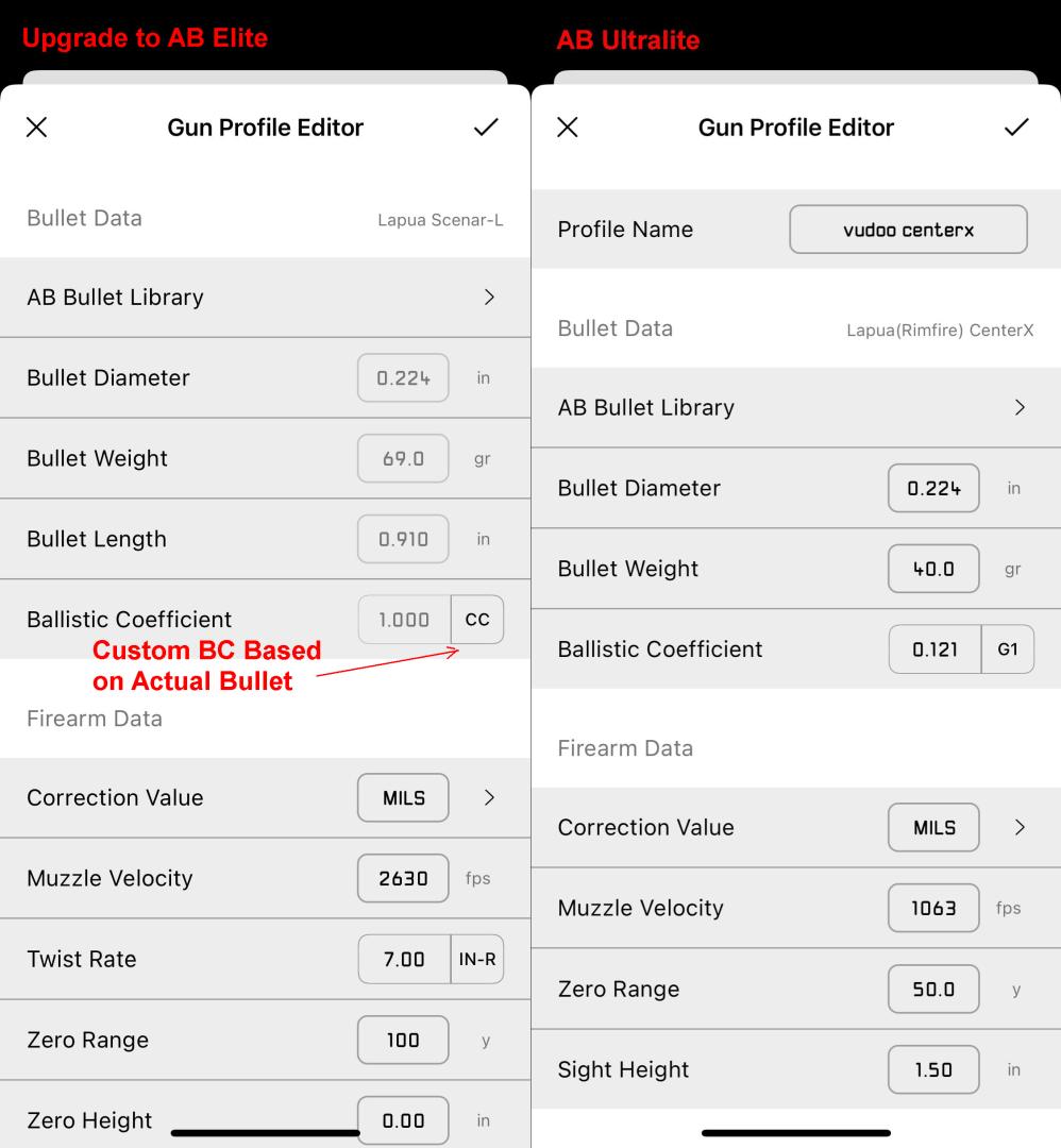

1. On the Leica app, there is no input for barrel twist rate like there is on the kestrel. Otherwise, it's all the same. I am no expert on ballistics, so I don't know if this will affect things or not? EDIT: Nevermind, I later went back to the app and for some reason, now there are a lot more data fields to fill in that weren't there when I first opened the app. Now it has all data fields needed including barrel twist. Perhaps this happened after I paid for the Applied Ballistics upgrade?

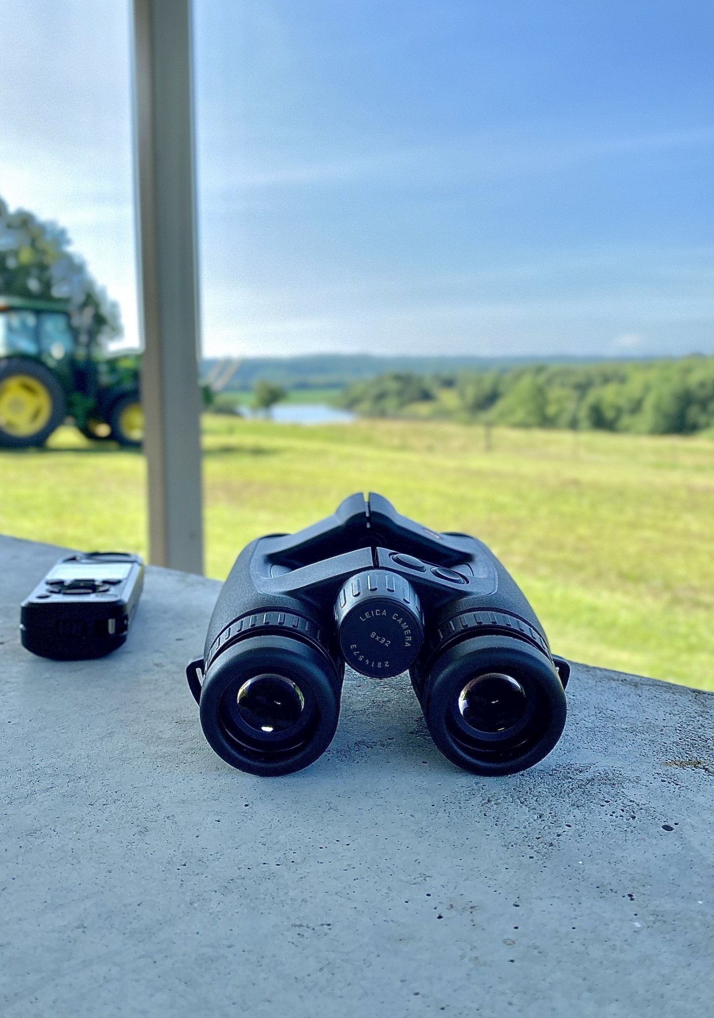

I am back from testing out to 1,400yds and all I can say is, wow.
I am super happy with these and will not be sending them back. They are lining up along side my kestrel's calculations.
What really blew me away is I ranged the 1,400yd 100% ipsc on the first try while free handing, leaning against an upright.
2. When ranging, I would like for the elevation calculation to populate first in the HUD instead of the yardage. Maybe there is a fix for this... Otherwise, the range calculation is super fast.
You had mentioned twist rate on the app screen. You are correct that this shows up in the Elite but not Ultralight variant. Here are images of the differences in the first part of each versions profile builder screen. Obviously there are significantly more options as you scroll down in the Elite version.

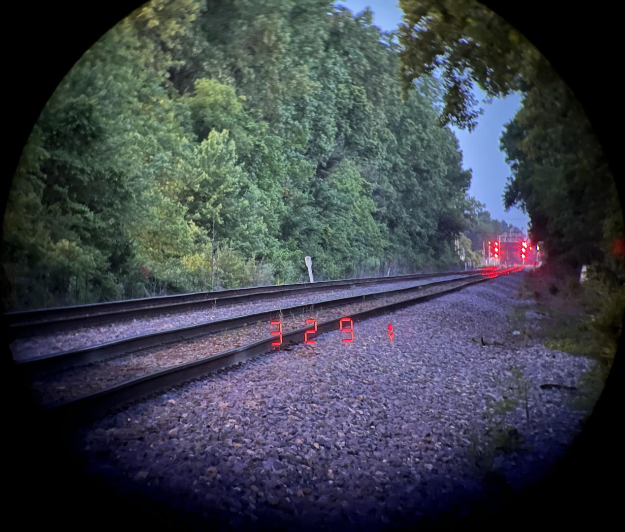

The HUD info is what I’m interested in too.
Even the video reviews I’ve watched don’t include this. This should be front & centre.
The reason for this is that it is near impossible to photograph because of sync issues between the display on the binoculars and the CMOS sensor in the camera. Basically, though the display looks constant to your eye, in fact each part of each digit is actually being individually displayed one after the other very rapidly. On video it just looks like ocasional flashes of part of a digit and on still you typically get a photo of just part of one or two digits. Accidentally I got a photo in nightvision (1 second exposure) mode that shows most of the first return screen (the range). The current display sequence is 2 seconds range, 2 seconds drop, 2 seconds wind, then a second cycle of this sequence. Leica has added, since launch, the ability to interupt this display sequence mid go now by hitting the range key to re-range immediately. They are considering giving more options for display duration and order of which solution displays first.
I think it is important to note on Leicas limited single line display, that they have really optimized for optical performance in these Binos. This comes with some display limitations. You can only make the display so bright without it costing you some transmission ability and you can only make the text smaller and have more of it if you make the display brighter and the binos therefore dimmer and perhaps strangely tinted.
