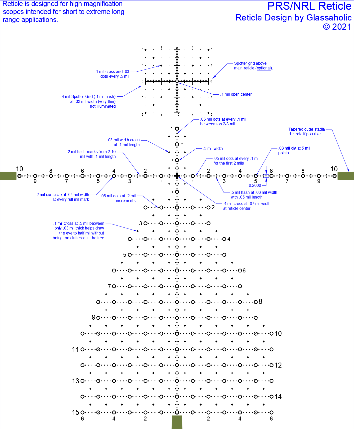

Okay, so here's a version with all dots in the main stadia lines
  • Wow
Reactions: Hegre and lte82
Would have to see it IRL, but I like it. Prefer without the additional spotting reticle.
I hear what you're saying, the size has to work in the Goldilocks zone of real world scenarios, if I said clearly usable from 10-18x would that be a fair assessment? Good to know about the spotter grid.
I would skip the #1, pretty obvious where 1 is
Is it? Is it obvious :LOL:
Reactions: Hegre
Have a custom March made with this and take it to 5-10 of the top 50 prs shooters for final feedback and you have a winner.
I like your advice (not sure if March would ever make my reticle though). I have a couple buddies in PRS but none in the top 50 unfortunately... and that is part of the problem with getting new reticles to market - how do you "prove" the reticle will be well received?
Reactions: Hegre
Very interesting thread.
My use is near and far group shooting, plinking and military competition.
At the moment I use Athlon Cronus BTR which seems to have been a spot-on choice for me.
I am very close to buying the 4.5-28x52 but hoping they would change:
1) to bright reticle illumination with more than just the center illuminated to work on dark backgrounds.
2) windage turret to non-capped, lockable or not. I have never had my turrets move by themselves, even rushing stairs and whatnot.
Now I shall add my opinions / needs on reticles.

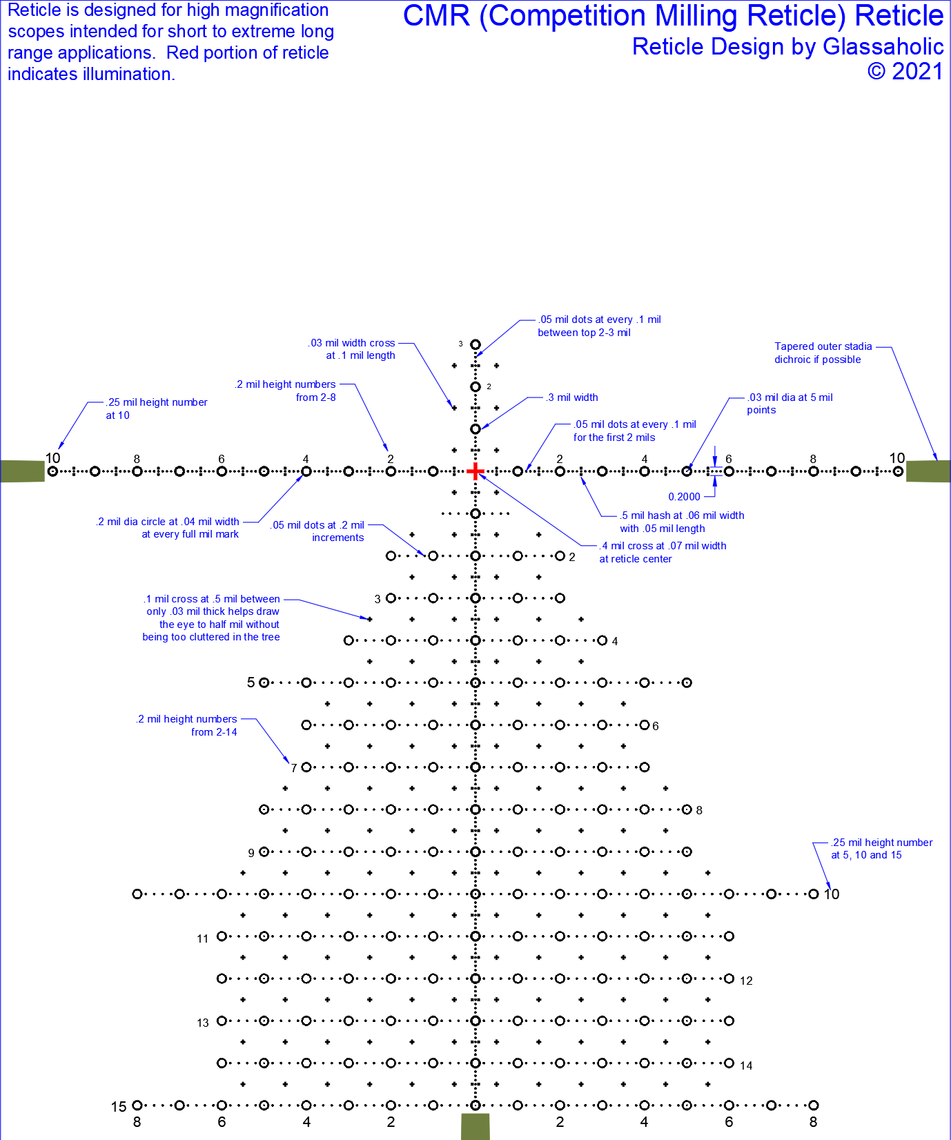

My grief with tree reticles has been lack of .1mil lines for milling targets. In my experience dots do not give strong enough visual accuracy for the job. Milling with precision feels sometimes more like art of guessing than measuring but I would be ready to place bets that a .2 or .3 long line that is spaced .1mil away is the best way to do it.
My basic strategy to milling is to make the target as big as possible by zooming but still be able to see the start and end mil lines at the same time to verify the result. For milling to be succesful I line the other end of the target against a long line at full mil, and then count the lines. Usual problem is to count which .2 line it is while simultaneously checking the target is held against the full mil line. So making unique tenths would help this process.
You could maybe replace or add one more row above the 3rd row up with only .1 lines, going 2mils left and right? Usually milled objects are under 2mil, and the larger they are the closer they are and more margin for error they have.
Your spotting grid also looked good but it is quite easily replaced if the reticle center is supported with enough dots for rough estimation if the hit is observed above the main stadia. Just even very small dots, few and far between, could help with this.
Actually, I noticed your reticle has the 5th and 10th circles with a dot inside. This dotted circle could be placed on a target and use the surrounding reticle for spotting too. Particularly the 10th dot would be good for this, since it is intuitive as I would just read 11th as 1st and so on. There could be made an improvement to make the 10th row slightly thicker or something else to make it stand out just a little more for this purpose.
Let me see what I can do
