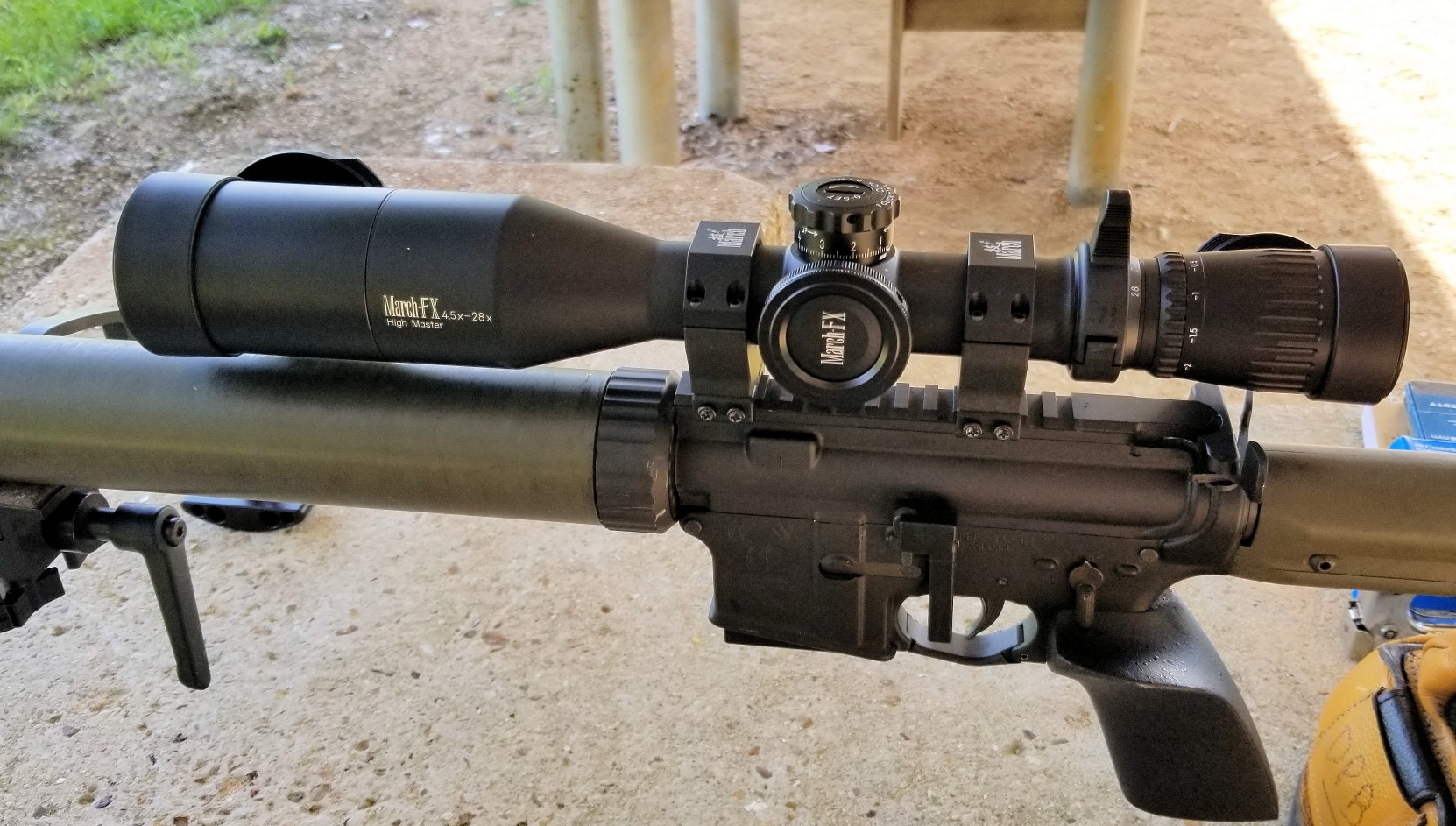

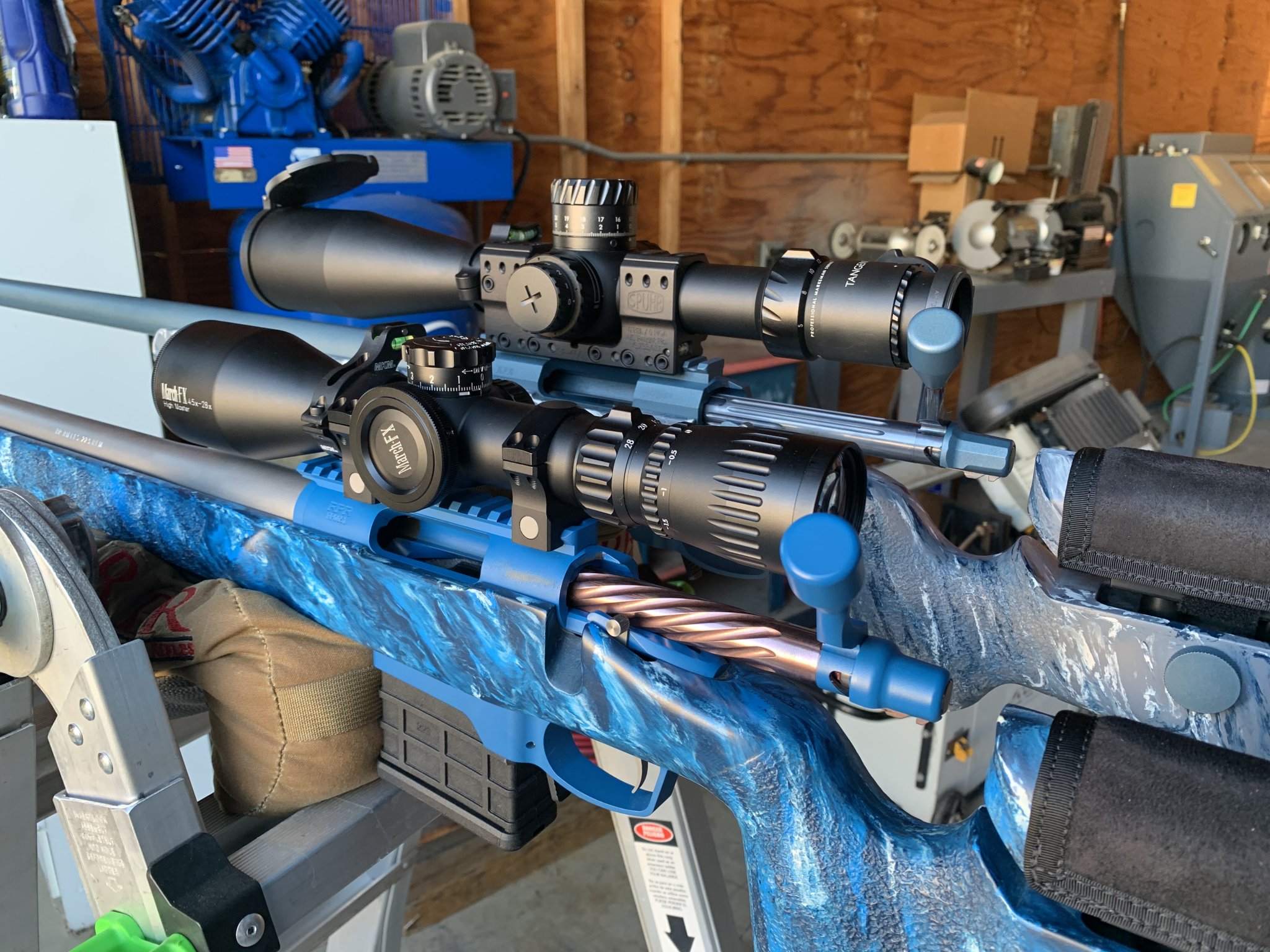

    Here is a picture of the new March-FX 4.5-28X52 HM WA scope that was discussed here a while back. I mounted it on FTR Match AR-15 and took it shooting. This copy has the FML-PDK tree-type reticle.
    As is my wont, I have sunshade, the fast lever, the middle focus wheel and the March flip caps and rings.
    I really like the wide angle eyepiece.

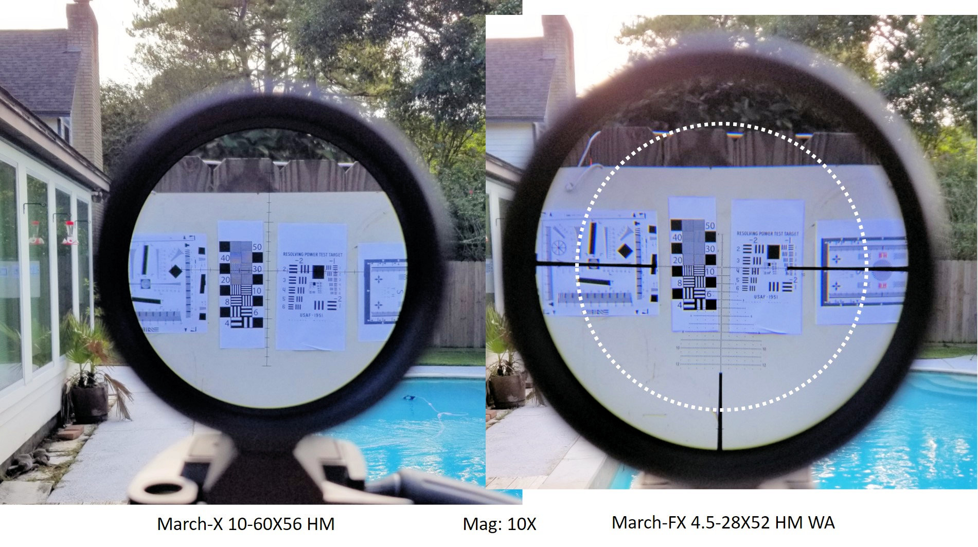

    You might want to look here for the FOV comparison.

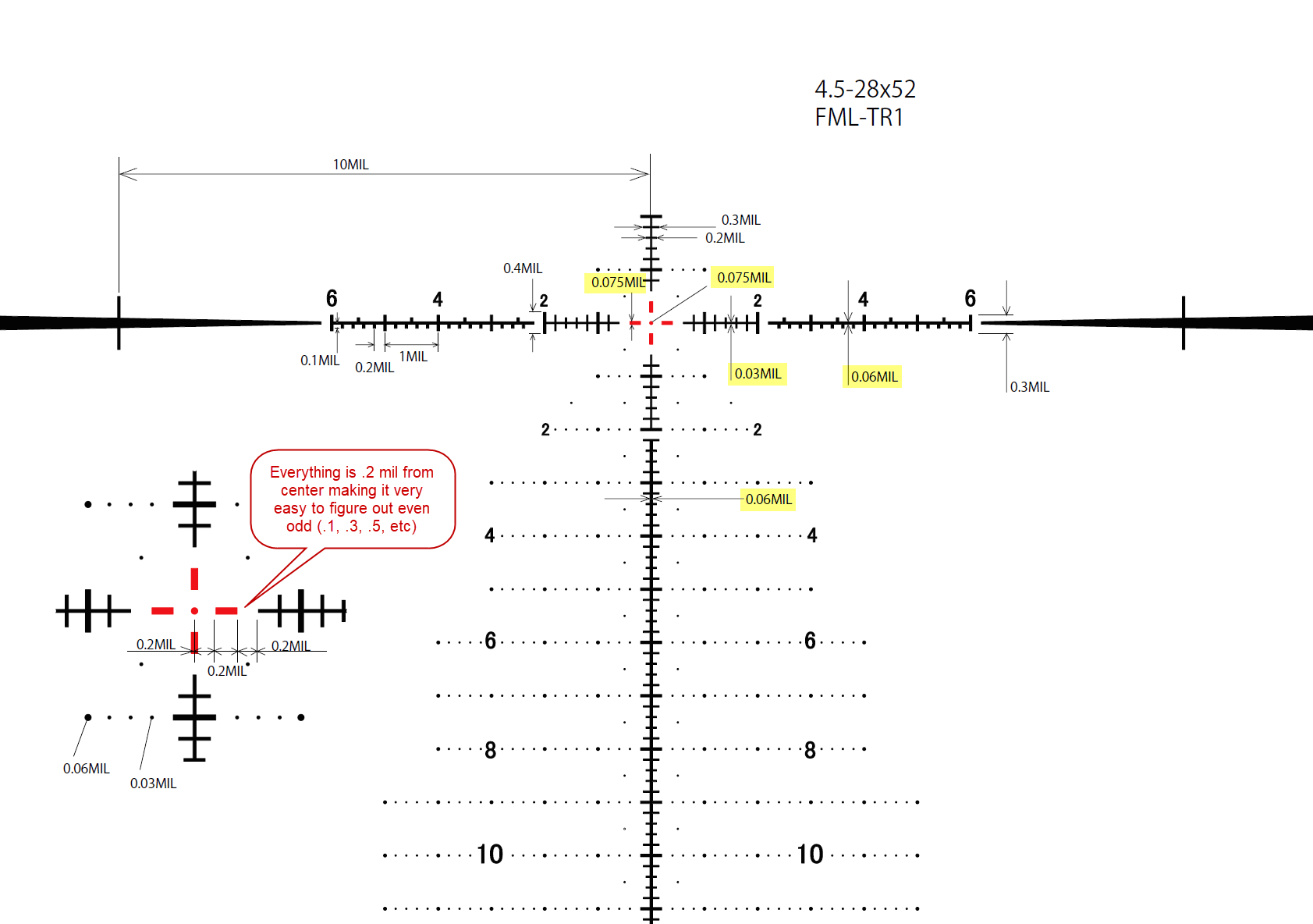

    A couple questions. Do you have an image of the FML-PDK reticle you are using? The one in my scope is the FML-TR1 and I really like that design as it is a well thought out .2 mil hash tree reticle where the tree virtually disappears in the background if you don't need it (a feature I prefer). Also, can you tell me more about the large parallax wheel you have on there.
    1- You can view the layout of the FML-PDK reticle here. Scroll down a bit.
    And you can download the details here: https://marchscopes.com/wp-content/uploads/2020/08/2020-Sept-4.5-28x52-P2.pdf
    In my picture about FOV comparison, the scope on the right is the one with the FML-PDK reticle. I'm posting the picture here so you don't have to chase it down.

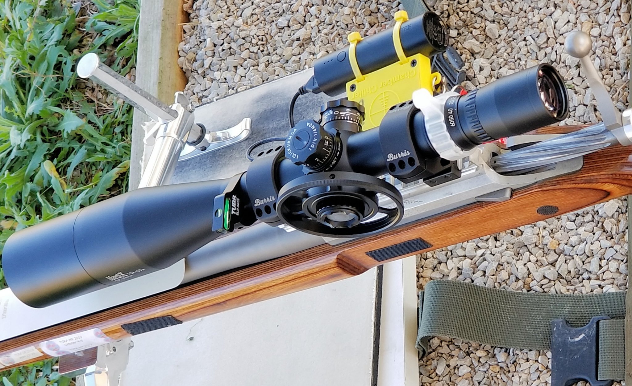

    As for the large focus wheel, it's an accessory from March. It's called the middle focus wheel. It comes in 3 flavors depending on which focus knob you have. You can then elect to install one of the two large focus wheel on top of the middle wheel for ultra precise focus adjustment. I have just the middle wheel on my 4.5-28X52 and 1.5-15X42 as that is quite sufficient for my needs and I don't want to overload the riflescopes. However, on my March-X 10-60X56 HM, which I use in F-class competition, I have installed the large 3.5 in wheel as you can see here.
    You can find these accessories here. Look for the middle focus wheel and the large wheel.

    The 10-60 looks optically better in those pictures.
    You should not judge too much from a pair of quick handheld Smartphone pictures. That said, the March-X 10-60X56 HM sets a very high bar for resolution and IQ being the very best high magnification riflescope on the planet.

    If that was meant for me, I've only shot it at 600 yards in an F-class competition atop my AR-15 and had a great time with it. I love the wide angle view; the turrets were great and I adjusted quickly and easily and it stayed put, as you would expect from a March. I have not had occasion to take it elsewhere recently as I had a state F-class match and I have been overwhelmed at work.

    The March website has the final detailed specs on the riflescope with the PDK reticle
    And for the TR-1 reticle:

    I like this reticle, especially the center. 0.2 vertical hashes on a solid horizontal are too cluttered. I find a broken 0.2 horizontal allows for much better observation of impacts and subsequent corrections.
    This reticle (the center portion) reminds me a bit of S&B’s LRR-Mil Reticle.

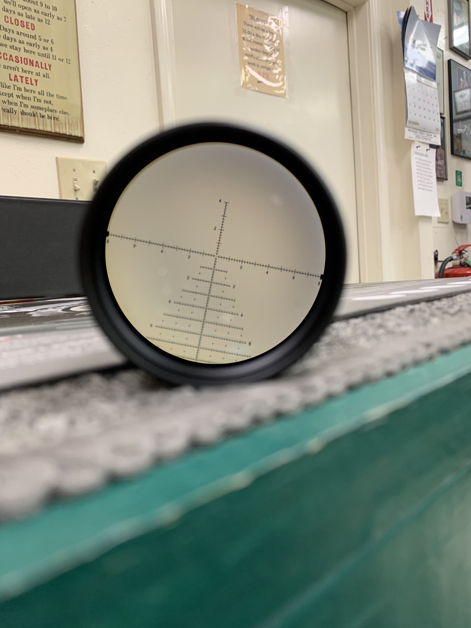

    March FX 4.5-28 FML-PDK reticle that some of you are curious about. Please forgive the crappy picture of the reticle. But you get the idea. This scope thus far has exceeded my expectations in every way. The optical performance is as good as anything else I have used. I will try to get a better reticle photo tomorrow if someone wants it. Honestly, what they did with the eyepiece is impressive.

    I do not find it to be overly thin at all. One of my main complaints is that this scope is not illuminated. At this price point and against similar scopes, it is crazy to not be illuminated. It needs illumination to be serious in the hunting market for sure. Everything else is pretty dog gone good. I have shot it in practice so far and it has worked very well. I will be using some more coming up in the PRS Finale.
    Thank you, if the PDK reticle is the one I'm remembering, it was too thin to be illuminated, that was part of the design intent of the FML-TR1 specifically so it could be illuminated. looking forward to hearing your experience during a PRS competition. March is also looking at a turret housing that is blank, similar to the Burris Race Dial they are offering for their XTR III scopes, I think that would be an interesting addition as well. Looks like the final production copies of the 4.5-28x52 will be making their way to the states by February just in time to get prepared for hopefully an opened up season of competition in 2021 - I think most of us are ready to put this lame year (2020) behind us!

    and wanted to point out that only the FML-PDK is not illuminated, but that March is offering illumination with the other reticles they offer. The FML-TR1 is my favorite reticle right now, the fact it is illuminated is an added bonus for many (myself included).
    Honestly, when Vortex can put illumination in a $1000 optic that has the same reticle features, I’m not buying that.
    Illumination is not that simple, there are relationships to the focal length, erector, objective diameter and reticle thickness. Because March scopes tend to be so short (focal length) their limitations are different from others.

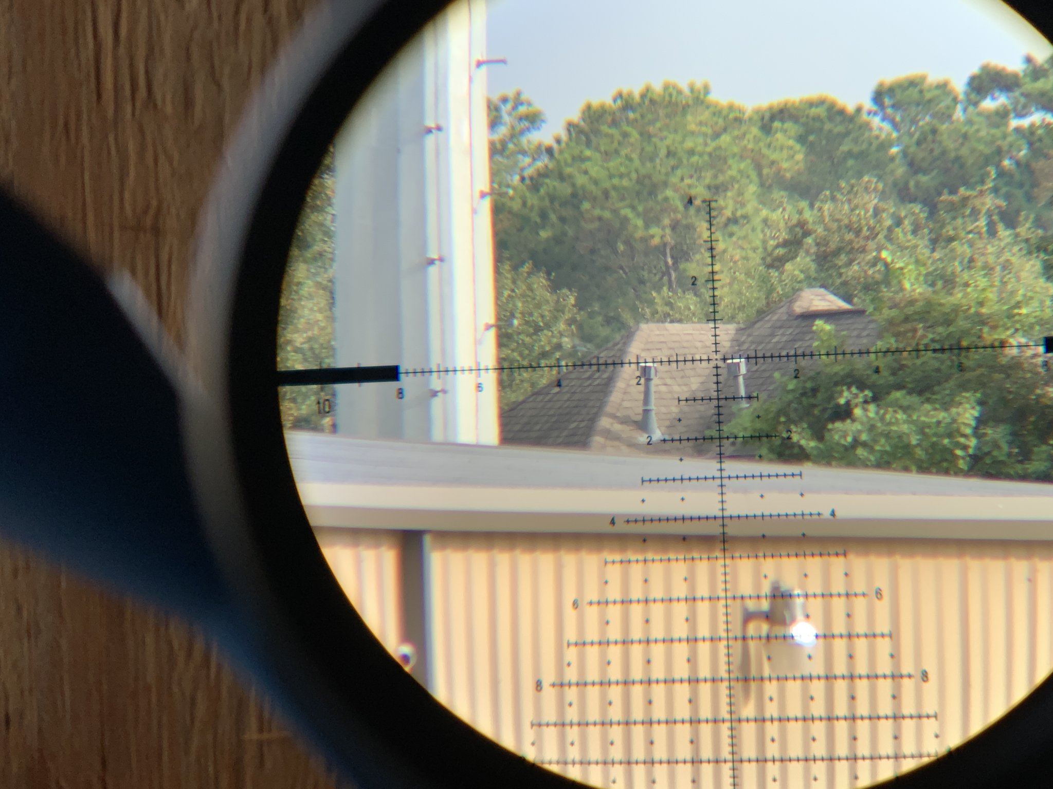

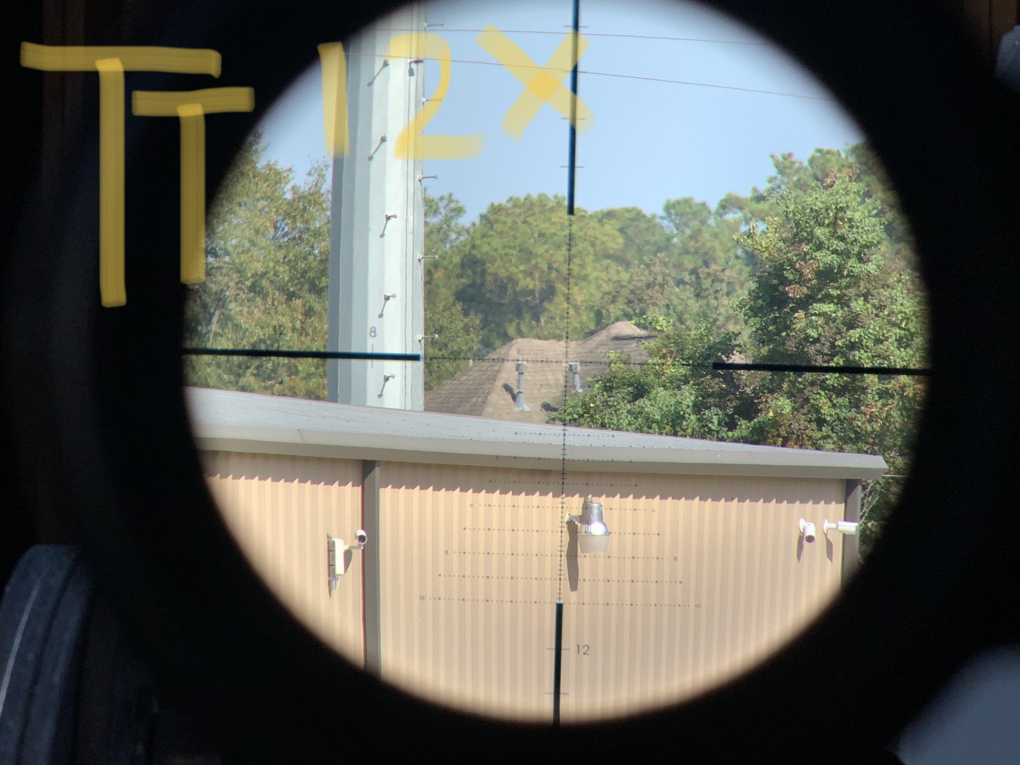

    Wow, TT is a lot clearer - is it that big of a difference in real life? I was almost set on the March 5-42 until that pic.
    Chickentoast, it’s through an IPhone. The pic was only taken to show relative size of the reticle at 12X compared to something else. Do you take an eye test through a piece of dirty glass? To answer your question, the two scopes are different. The pure resolution edge probably goes to the TT, but they are pretty close. The March seems to have a much larger image transferred to the eye. Don’t read too much into the pictures where clarity or resolution is concerned.
