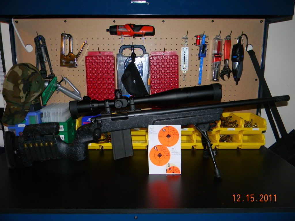

Hello all, longtime/first time hailing from South Florida. Not sure if this is the correct section, but while searching its the best fit I found. I am a private investigator and avid shooter. I am currently entering the world of F-T/R and was able to shoot a match at Port Malabar's 600yard line with decent results. My local range limits most of my shooting to 100 yards. Any and all input/suggestions is welcome.
Rifle:
Rem 700 AAC-SD - 20" - 1:10 ROT (factory barrel)
B&C Medalist Stock. (fitted and bedded)
Wyatts DBM.
Jewell trigger. - (1 lb)
Krg Bolt lift.
Harris Bipod. (6-9")
Custom Muzzle brake.
Leupold mark 4 base and steel rings.
Konus M30 - 8.5-32x52mm scope.
Load:
Bullet: 175gr SMK
Powder: RL-15 - (44.3gr)
Brass: Win (2.000)
Primer: WLR
Length: 2.310 OGIVE
Avg M/V: 2500

Thanks Ryan, the Wyatts mags hold up pretty well with the exception of them being a little short (my comp loads wont fit in). The bottom metal is well built, the finish is standard (not the best, not the worst), as for fit, it did require a small shim on the rear action screw to feed without problem. all in all for the price it does its job.

Thanks! If you have questions or need help with load development let me know!
