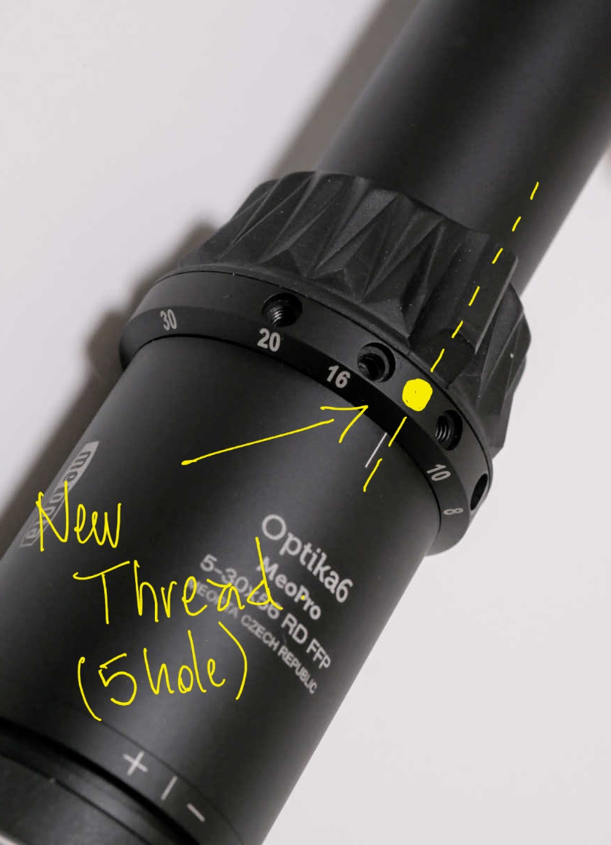

PARALLAX ERROR.
Playing with my new Optika6 last night (while waiting for my rifle to arrive), I was practicing eliminating the parallax error on a target at 755 yards (690m), set the dial slightly above the 500 mark, but the error did not disappear, it increased to infinity and the error persisted, then I started to decrease and the error disappeared under the 500 mark.
Someone with the same experience? Could it be a printing error in the position of the marks on the dial?
With parallax error.................................................................Without parallax error

This is not unusual and in fact may be more common than the situation wherein parallax numbers on the dial exactly match the distance that you are shooting. This is across all scopes and brands, in general and is a combination of things. One important factor that affects parallax settings is where you have the diopter set for your eyes and vision.
It does vary somewhat between brands and models of scope, but it is not something that should matter much, in my opinion. I do not look at where the numbers are on my focus dial. I pay attention to the sight picture while on the scope.
Reactions: bman940
Hi
I appreciate your answer clarifies some doubts.
In my case the diopter setting is at zero (I have no vision problems).
I use the dial marks as a first reference, but I never believed that the correct setting was so wrong from those references.
Regards.
It’s not necessary wrong. You have a graduation line at 500 then the next is infinity. You also don’t have it mounted on a rifle so your eye relative to the scope isn’t consistent.
Some manufacturers don’t even put numbers on the dial, rather a graphic indicating from close to far.
Fear not, put it on the rifle when it shows up and tune parallax for target clarity. Ignore the numbers.
Now don’t go running off with buyers remorse.
Respectfully, your kinda not wanting to see what we’re telling you. Just wait until it’s all together.
I’ll give you this. You claim to have perfect eyesight, that’s nice I do not. If you set the parallax at a given range to look perfect for you, and I then got on that rifle looking at the same target, I may have to change parallax to suit me.
My head position, the eye relief, etc will be different. We’re not all built the same.
Many lower power scopes have no parallax adjustment at all. They’re “fixed” at a predetermined point.
I’m not defending your optic, I do not have a Meopta scope. Again, respectfully you not far enough into this to make a true determination, and frankly it’s irrelevant.
Those numbers are a guide, not an absolute. They cannot be an absolute because of the other variables that exist.

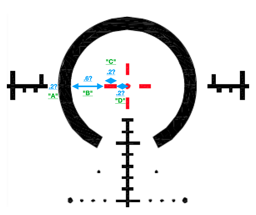

My Optika6 3-18x50 with MRAD1 reticle arrives today.
The reticle diagram (see attachment) does not answer four questions I have, or, if it does, I cannot find the answers due to the diagram's complicated nature.
To anyone who owns one, and also @koshkin, I have four questions (see other attachment).
1. Space between the end of horizontal MRAD stadia and the beginning of horse shoe -- "A" -- is? (I think .2 MRAD)
2. Space between the beginning of the inside of the horse shoe and the beginning of the crosshair dash -- "B" -- is? (I think .6 MRAD)
3. Width of the crosshair dash -- "C" -- is? (I think .2 MRAD)
4. Space between the end of the crosshair dash and the center of the center dot -- "D" -- is? (I think .2 MRAD)
Any assistance would be appreciated.
Thank you.
-Stan

Stanley, I think your numbers are correct, or at least correct to my old eyes. Yes, there are a lot of measurements but I am sure that is one of the reasons that you chose that particular reticle. You can also find that scope and reticle combo in Strelok Pro in case you want to enter your ballistic data for drops. I find that app invaluable and Igor the owner is incredibly helpful.
Thank you @bman940!
I got my numbers from printing the reticle as large as I could on a piece of paper, measuring my areas of interest with calipers, and then comparing the sizes to other parts of the reticle that were clearly described on the Meopta diagram. Not bad for kitchen table math even if I do say so myself. :)

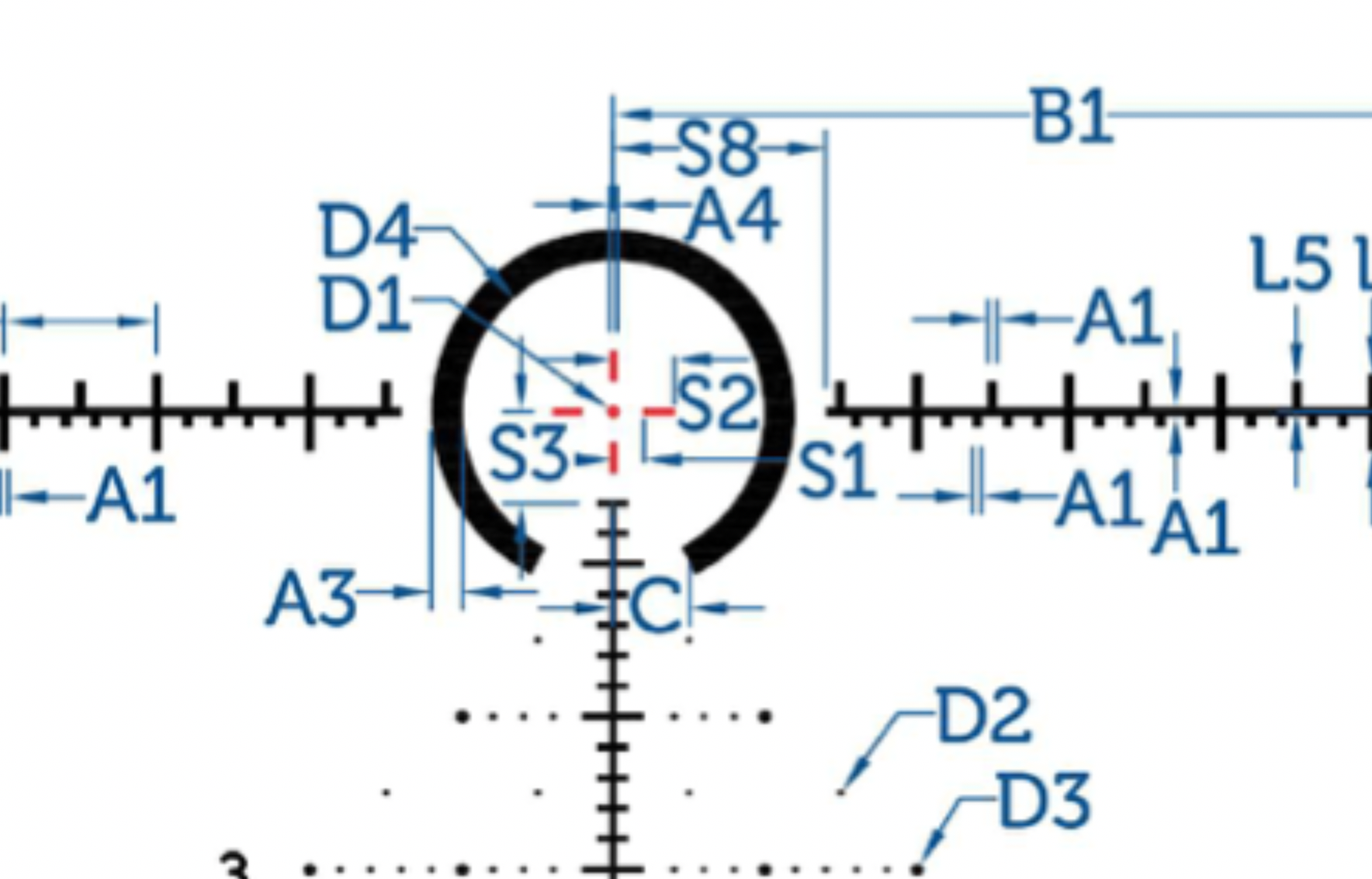

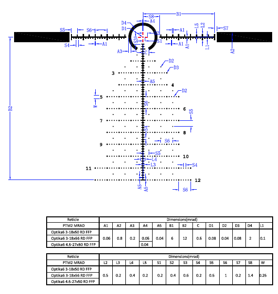

I have reached out to Meopta to see if we can get a blown-up pic such as the ones we made and add the measurements you asked for. Great job, by the way, I KNOW it was a pain but you got what you needed. I hope we'll hear more about how your rig performs.
Reactions: stanley_white
Thank you again @bman940!
I emailed Meopta this morning in addition to posting but wanted to see what the brain trust here thought.
The recurring criticism of the design is the lack of wind holdover points at the zero range and / or if you prefer to dial for elevation.
I suspect if Meopta can develop a graphic that illustrates what can be done with the reticle as-is, as you have asked them to do, it would help many.
While some dots could have been put in outside of the crosshair dashes but before the horse shoe began, I think that would have cluttered things, and my older eyes like more white space these days.
