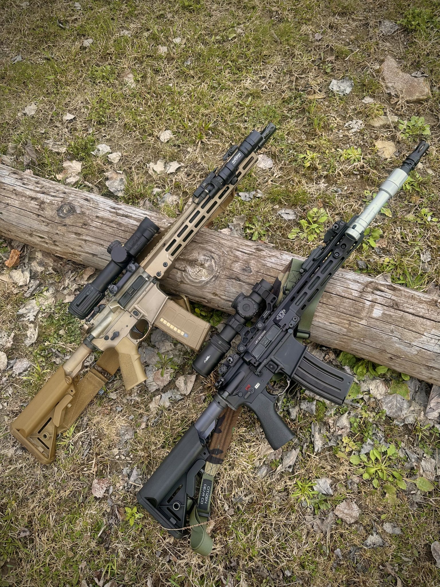

I just picked up another one for a RD/PSA rifle that RD is working on right now. I have been using the Geissele mount with a Delta Point red dot on top for my KAC 14.5" rifle. I plan on doing the same with the RD/PSA rifle. Funny thing is I am pulling off my Vortex Razors and replacing them with the PLXc. The weight savings is huge.

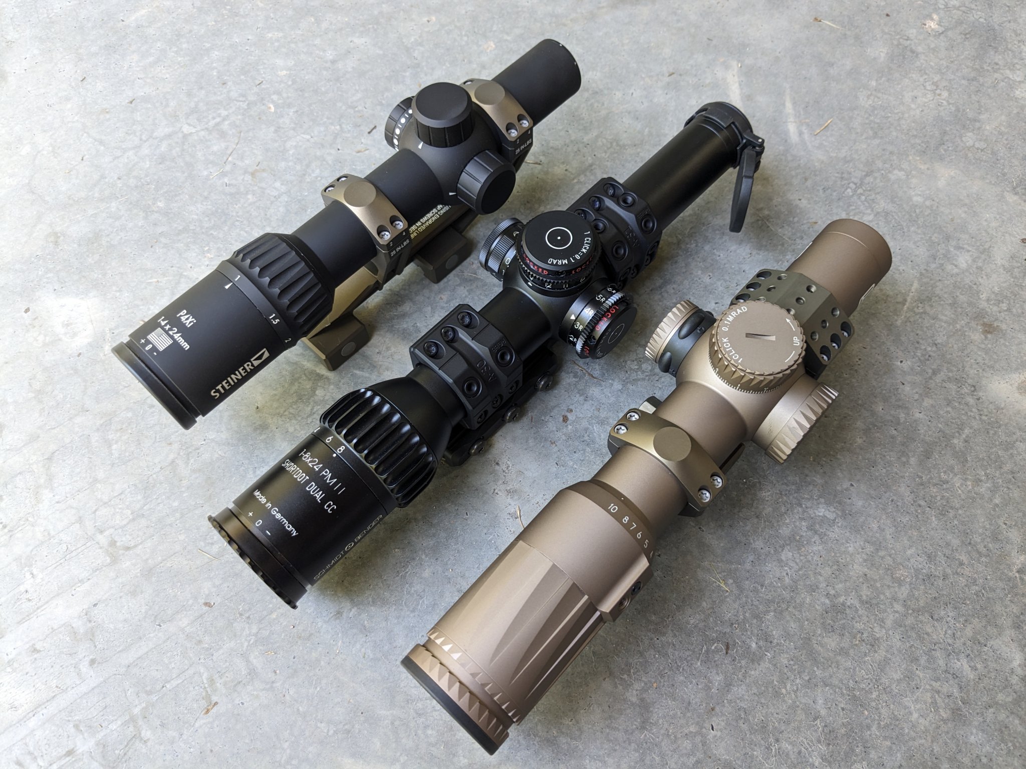

I own the S&B, if 1x is important to you, that's not the one. It shines above 5x.
Can't comment on the k18i-2, but I have the K18i and it's wonderful on 1x.
I also have a P4Xi, which is fantastic on 1x if you can deal with only 4x on the high end.

The eyebox at 8x is particular, but not unusable. 1x is excellent, 6x is forgiving. Form factor and weight are awesome. Glass is excellent. Illumination is not daylight bright on really sunny days if that's important to you. The reticle is excellent for a FFP without illumination though on 1x, which was more important for me then a FFP reticle that required nuclear bright illumination to be useable. The information in the reticle is invaluable imo. Overall, I do not regret buying it at all and their isn't anything on the market that I would trade it for currently.

If you are good with 4x, don't look any further to be honest. It's a poor man's K16i.

The disappearing bezel effect is like a razors. The eyebox and eye relief is similar to the razor 1-10, I greatly prefer the reticle in the PLxC 1-8 to the razor on 1x. But that's personal preference. I don't think you would be disappointed in the 1x.
