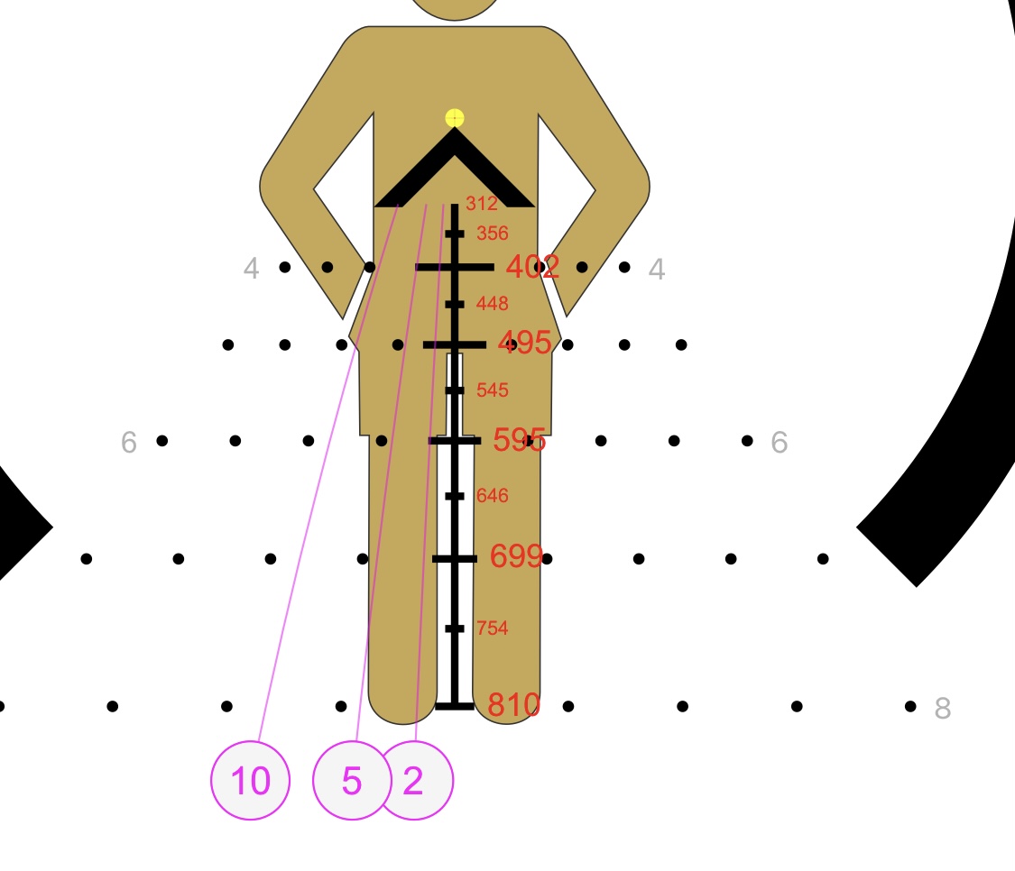

Is the horseshoe on the m8 meter version bigger than the m8 yard version? If so will it make the reticle on the m8 meter version faster to pick up at 1× power?
Yes. 5 mils on yards 10 on Meter version. I will call reticle patent holder today and tell him I am getting beat bloody for not sharing more numbers on the BDC

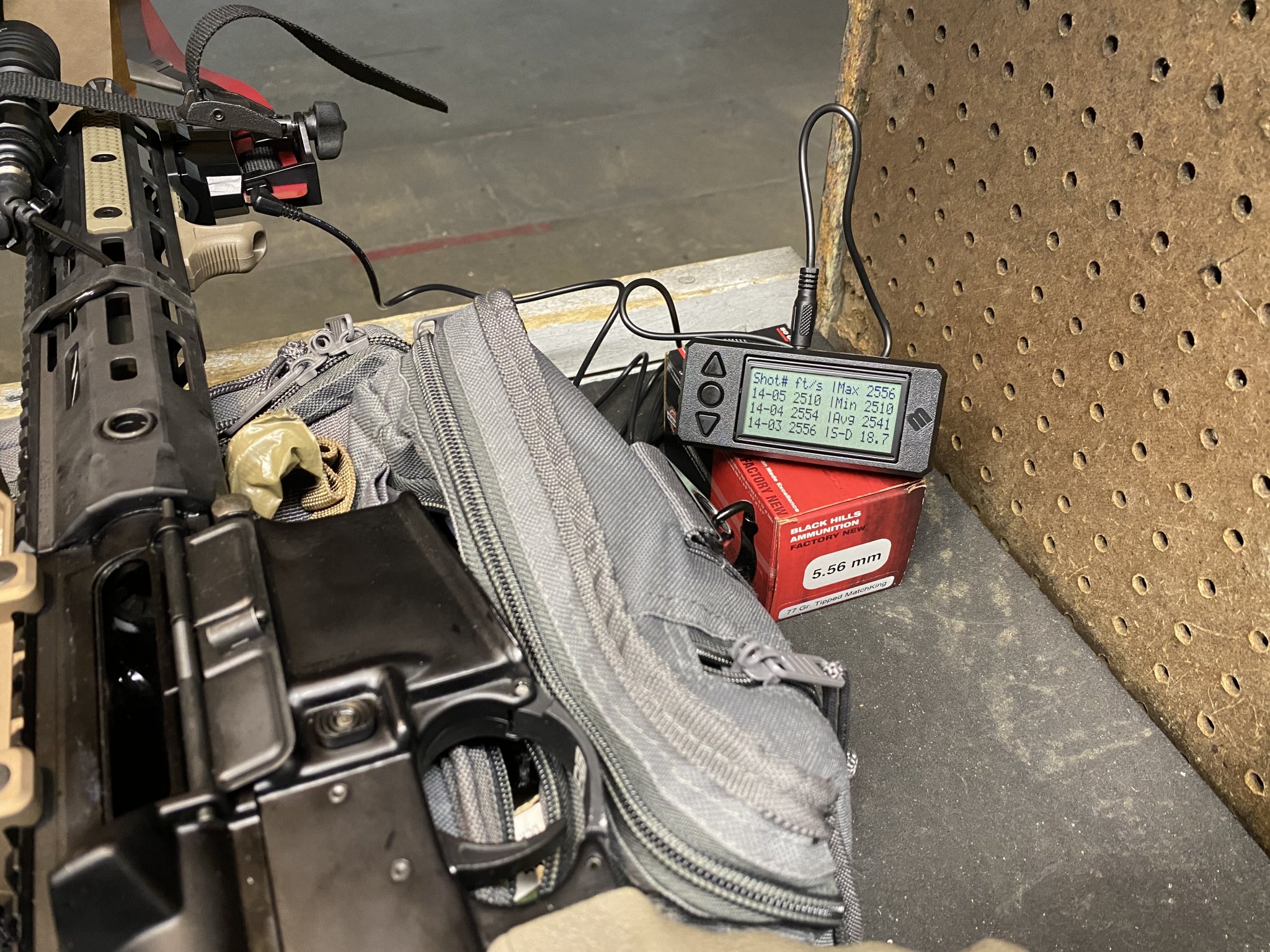

The meters version, but using it in yards, is looking pretty good for my 12.5” Criterion barrel shooting Black Hills 77gr TMK.
1.7” mount, zeroed at 50 yards, 0.1 mil low
6mph wind dots
Meters reticle, but these drops are in yards. Only issue is the range estimate is still meters, but the sizes of people change so much the range estimate should still be okay for quick needs.
View attachment 7933767Reticles are on Strelok now.
The meters version is looking pretty good for my 12.5” Criterion barrel shooting Black Hills 77gr TMK.
6mph wind dots
Whats your MV?

Do you see either reticle as having an advantage for use at 1x? It looks like the donut is a different size.
