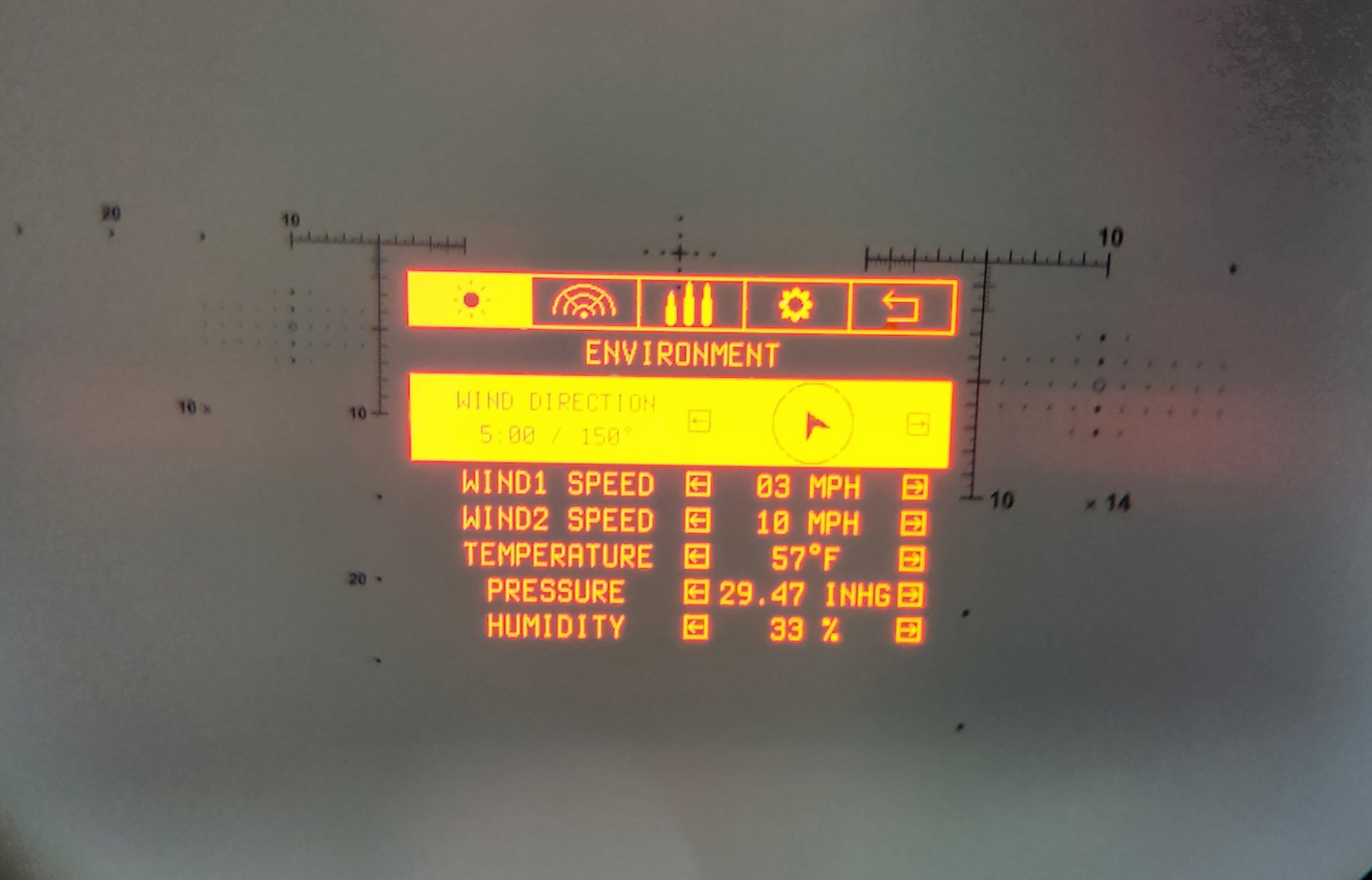

Hold menu button for 2 seconds, you get to a very user friendly wind screen, really bad phone pic:

Having to go into the menu as shown above on the Vectronix wouldn't be useful for me in a match situation, though.
It looks almost like exactly like the gen2 10ks, but instead of a wind button you hold the menu button, then you’re immediately on the wind input. Looks like it will be easier to make a mistake though, e.g accidentally hit up or down on the D pad & move off the wind input. I could be wrong though, so I’m still holding off
