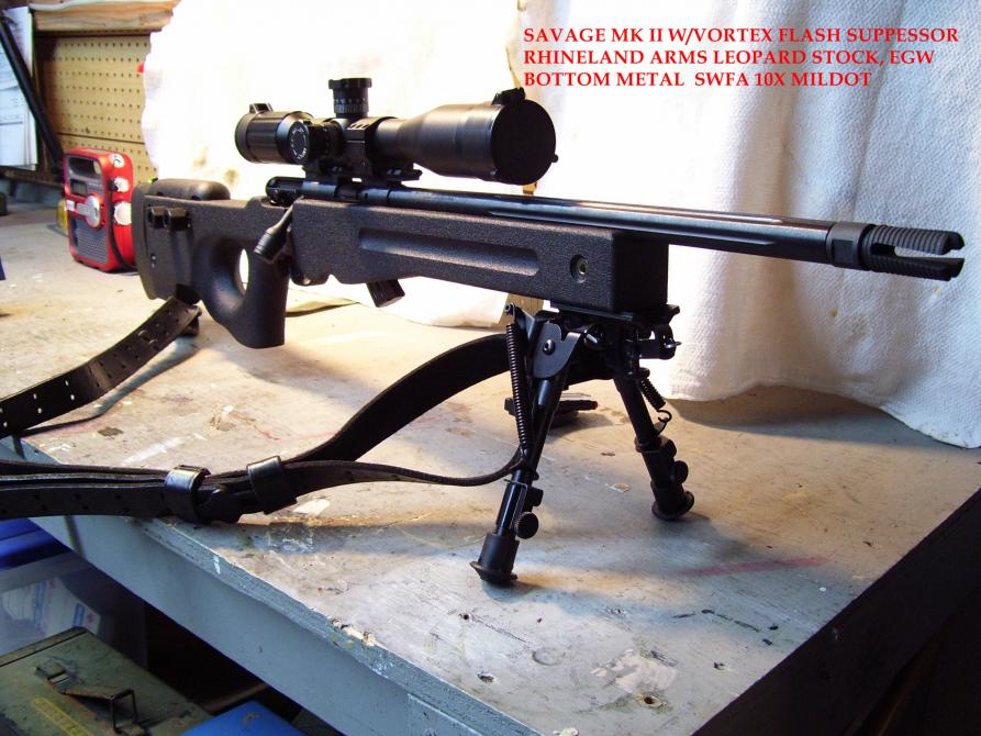

Just put the new Rhineland Arms Leopard stock under my Savage MK II. The ergonomics are fantastic. This will go a long way to train up for my AICS stocked 700 in 6.5 Creedmoor....

Congratulations. Nice to see that you were able to pick one up...I want one for my Izmash toggle action, he just wants too much to make a custom stock for it else I'd have one.

It seems like any stock for a Savage MK II action, you will have problems with damming the front pillar due to the lack of material in the stock, adjacent to the front of the mag well. I had a Boyds Tacticool under it, and the problem is the same way with that stock. I am going to try, maybe even skim coat bed it. That is better than nothing right now. This gun shoot great, but I have not had a chance to shoot it with the new stock....
I got one of these in also. The front action hole was off center by a slight, but noticeable amount. Im not too upset about it because I will put some pillars in it. Did you use any bottom metal on the stock? I had to mod it a bit to fit dip metal. I was asking because I cant find a front screw longer than an inch to use it. apparently #12-32 screws are rare as hell.
