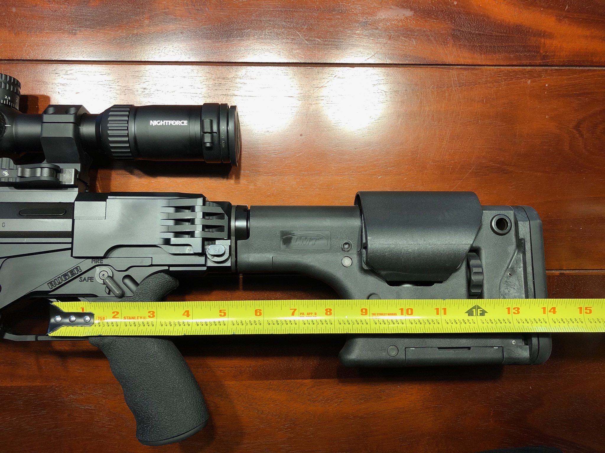

Does the same triggers for the short action RPR's work for the long action RPR's?
Also would a Magpul PRS gen 3 work on the long action RPR?
Is there really any parts/accessories that won't work on the long action version that do work on the short actions (other than the more obvious things like the handguards)?
Magpul PRS 3 can be installed but the length of pull will be 16.5" to start. You may have better results with the LMT DMR 556 stock, the LOP is 14.5" fully collapsed.
The Magpul PRS3 will allow folding and locking in the folded position (the stock can be locked folded by rotating the push button). The LMT DMR 556 will allow limited folding but not locked in the folded position due to the wider SOPMOD cheeck rest will not allow the stock to fold parallel with the receiver. Both models will slip right on to a mil spec carbine length buffer tube which is what the RPR Magnum (at least mine) has. Another caveat I discovered about the LMT is the cheek rest is cutoff at the front (to allow charging handle to clear in AR platform) this required me to reposition the optic farthest to the rear for proper eye relief and still get a decent cheek weld.

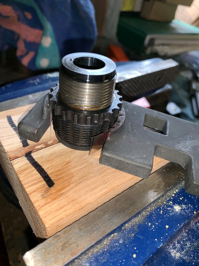

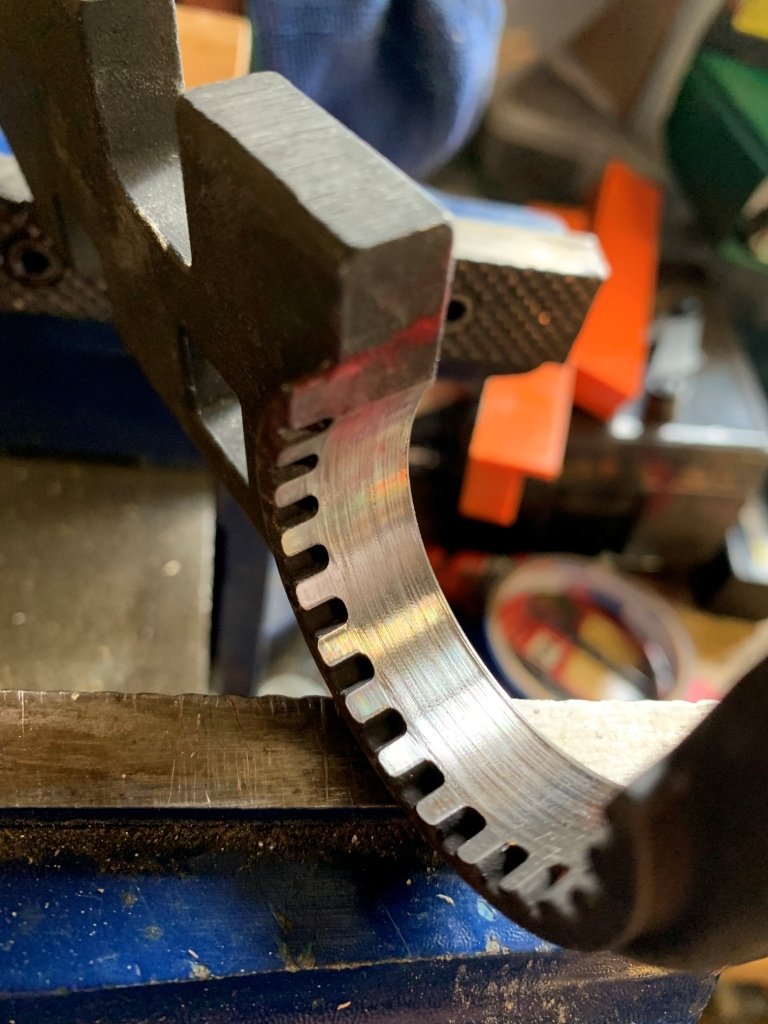

The RPR Magnum barrel nut uses the same AR15 spline setup, but that LRI wrench won't work because the handguard nut threads ahead of the splnes are too large.
I bored a Brownells AR15 wrench to get mine off.

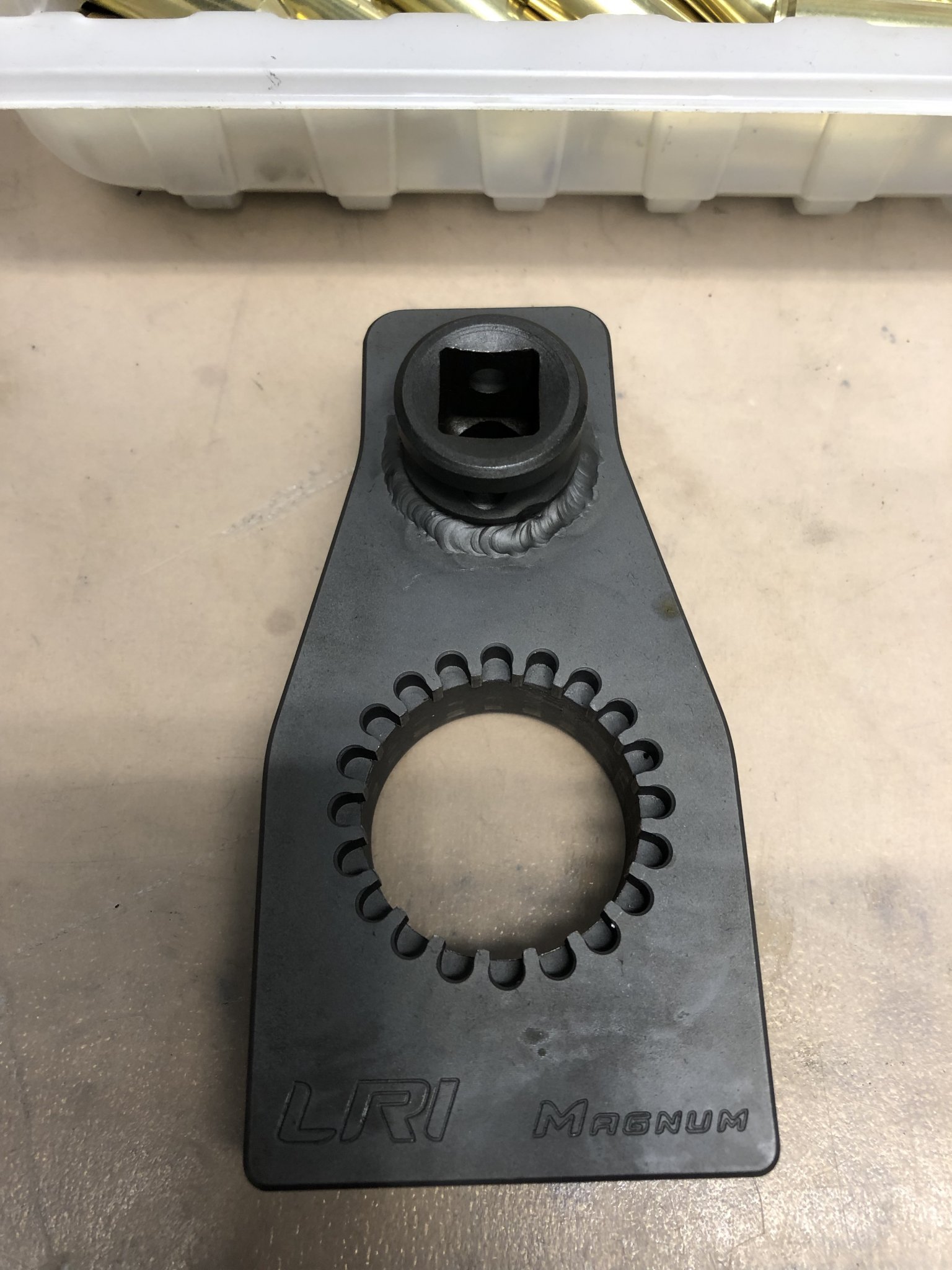

The Magnum RPR has been out awhile now, so you might call LRI to see if they have a wrench that will work. I have one of theirs for the short action RPR and it will not work on the Magnum.

Correct. A standard AR15 barrel nut wrench won't work on the magnum RPR.
LRI now has a wrench soecifically for the RPR magnum. It's the best tool I've found since it has 360 degree tooth engagement. It's $110 but I ordered one since I brought a Krieger prefit barrel for my .300 and I wanted the right tool. I also got a mechforce barrel vice. I hope it goes smoothly as Ruger torques their barrel nut to 150 ft/lbs so having the right tools will be key.

Good to hear stuff is becoming available for the RPR Magnum.
The trick to getting the barrels loose is a big hammer on the wrench rather than just pulling on it. The wrench needs to be stout to be treated like that.
The RPR Magnum barrel shank is 1.200", so I bored a set of oak blocks for it. I have a barrel vise, but didn't bother with it on this one.
I bored the handguard nut to clear a standard 1.25" barrel blank. It'll still work with the factory barrel and is unseen under the handguard.

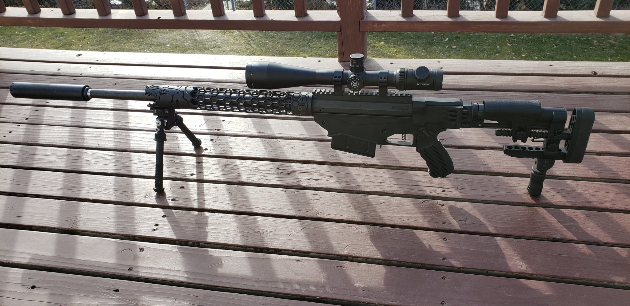

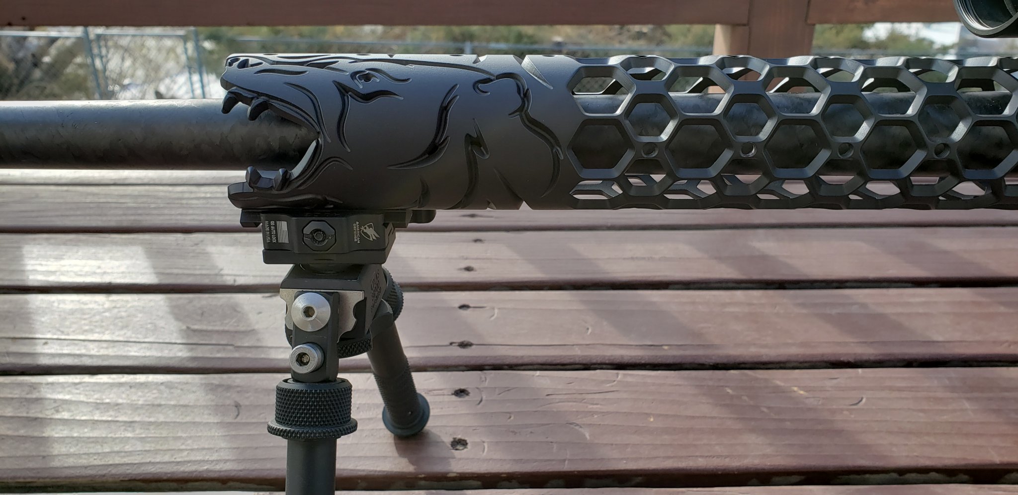

Hey all,
I recived my RPR 300 PRC back from the the custom handguard maker! If you want to customize your RPR magnum handguard contact Unique ARs (
https://unique-ars.com ) you can use one of the handguards that they have in stock or you can go full custom like I did. I went for a bears head on the muzzle end. I also have thier rifle grip installed. You can adjust it to completely conform to your hand!
Final weight to my rifle as pictured is 14.7 lbs! If I take the monopod and bipod off I'm right about 13.8 lbs!
