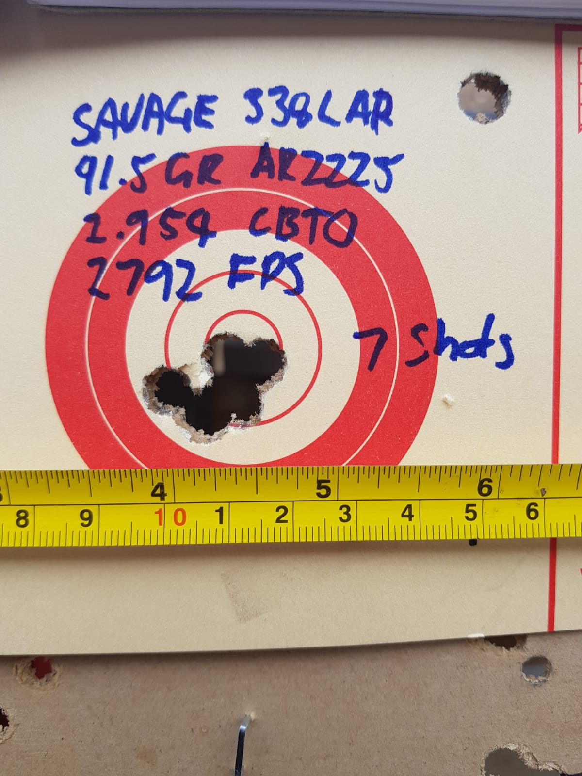

I have the same rifle and have been shooting the 285 eldm with retumbo. I started to get heavy bolt lift around 93gr at around 2870fps. These loads were 20 thou off the lands. I have since settled on 91.5gr AR2225 (Retumbo) in Lapua brass neck then body sized, fed 215M primers seated 20thou from the lands in my rifle. Refer to the picture for exact measurements. This group was shot semi-rapid with a hot barrel @ 100m
I'll be testing my 3 round loads this weekend, my largest load is 92g of Retumbo. Maybe that will let me know if the gun is on track with yours in speeds and maybe see a node between 91g and 92g. Just wading into all this slowly trying to find what the gun likes while I'm breaking it in. I'm not new to reloading just the 338 Lapua. Thanks HB
