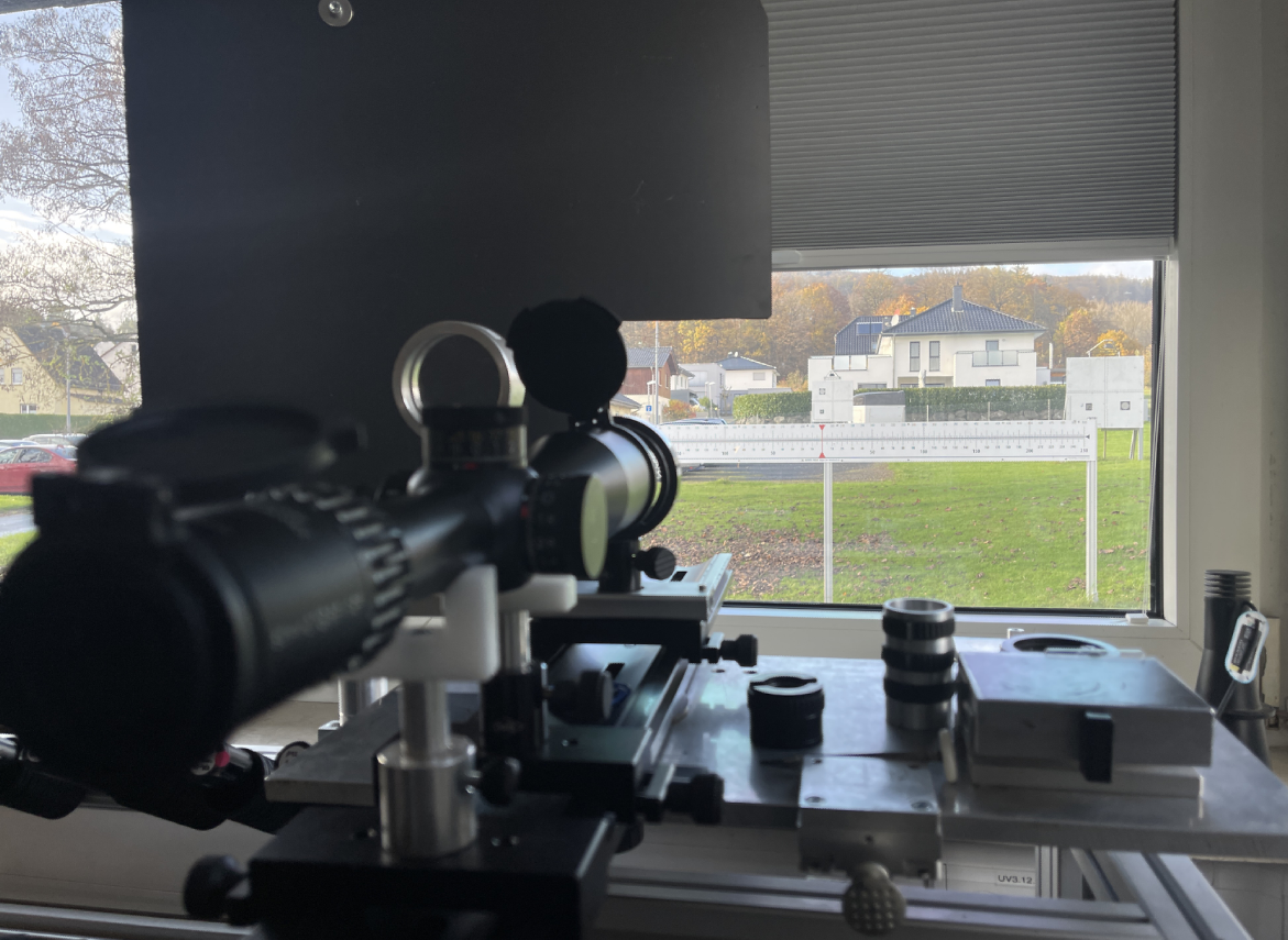

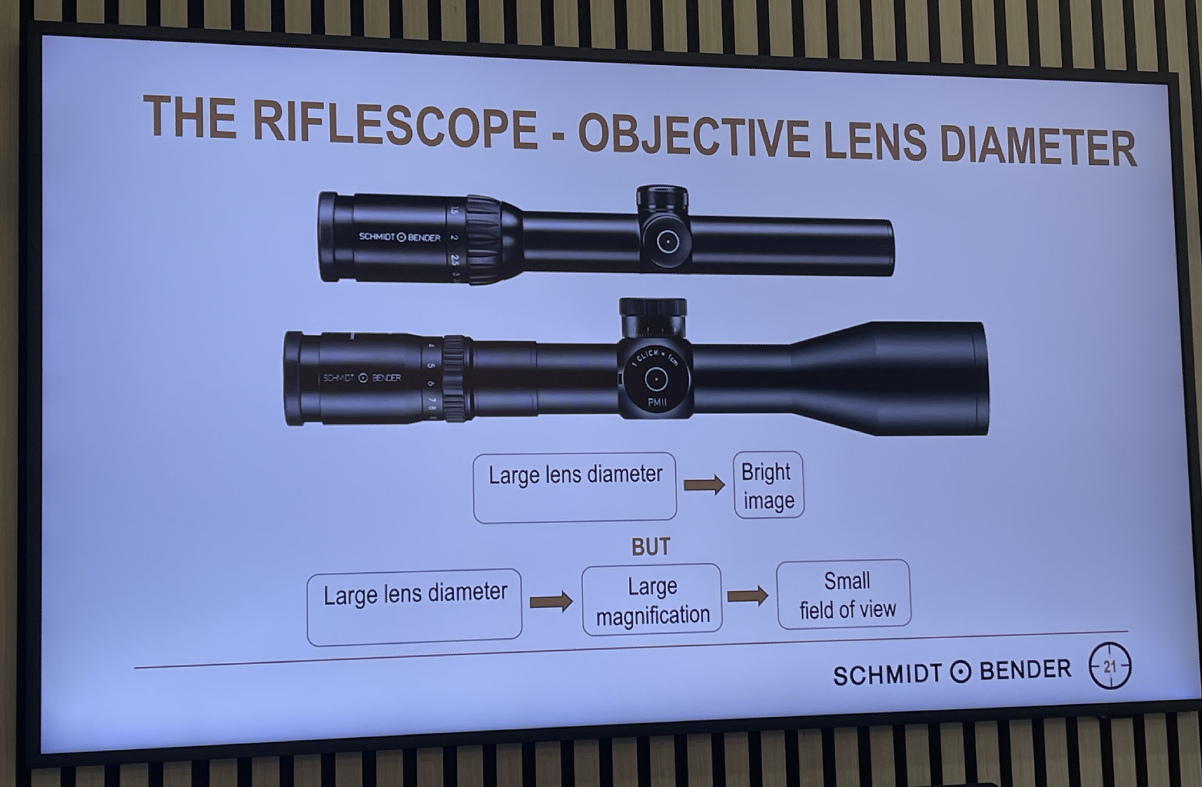

I still have a lot of love for the good old 5-25x. Here's one getting the final touch, before being sent out to a customer who's probably very eager to get it zeroed and tried out.
Note the new boxes, which are very nice and quite an upgrade from the previous ones.
One thing I learnt during my visit, the Schmidt & Benders are really hand-built to the customer's specification, for a niche market and a specific need. The turret you like, turning CW or CCW. The reticle you preferred. There's no "mass production".

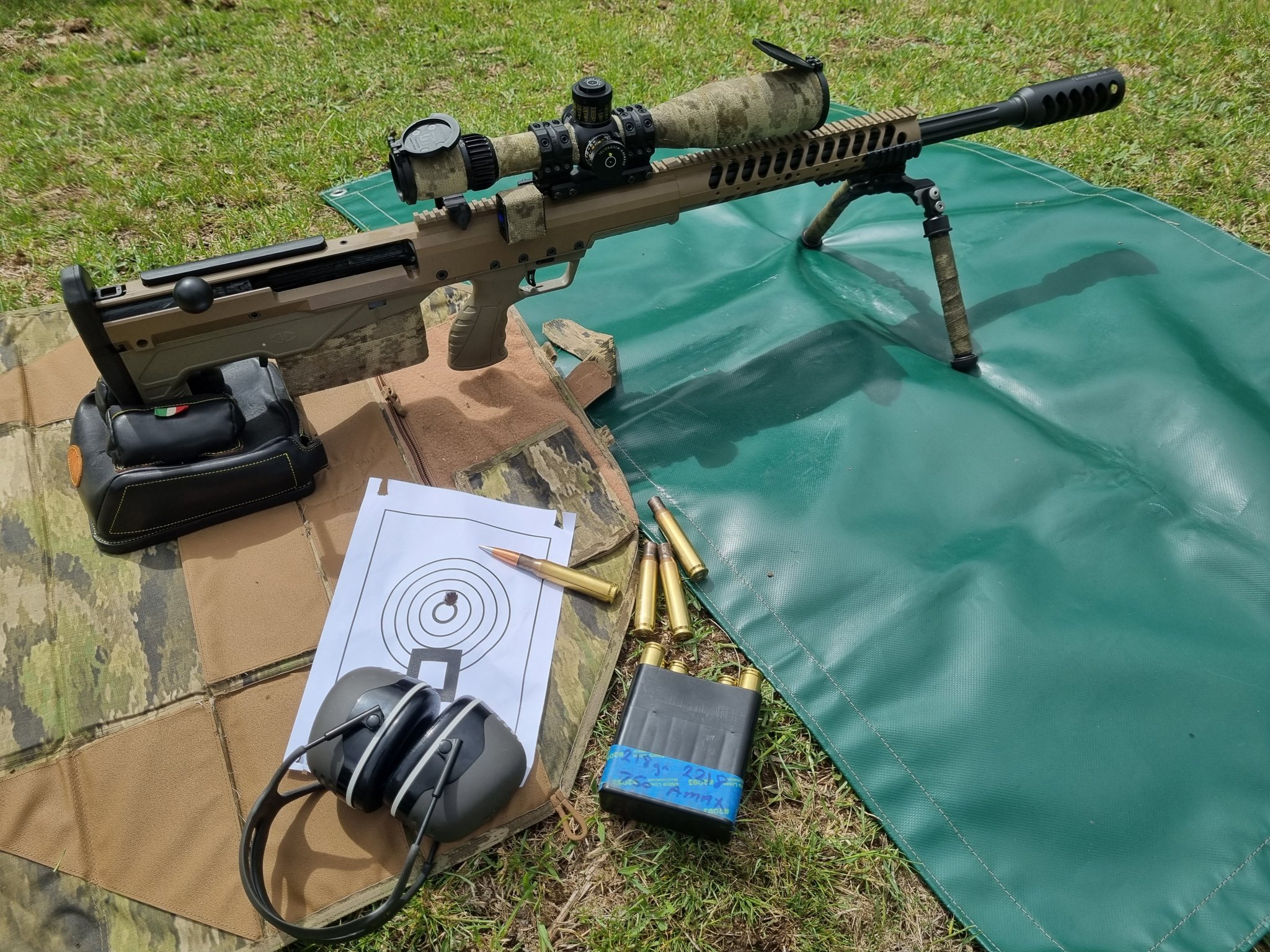

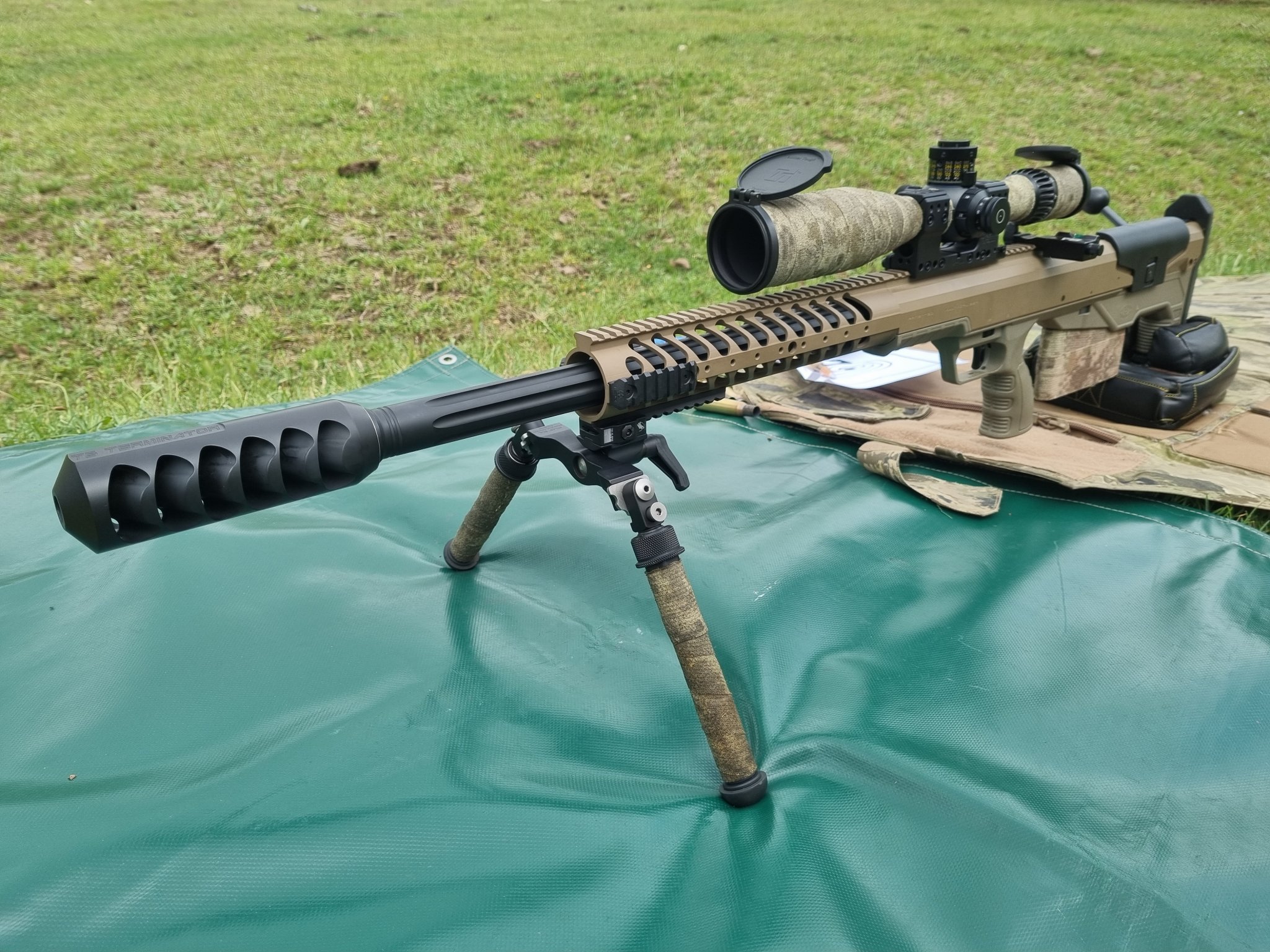

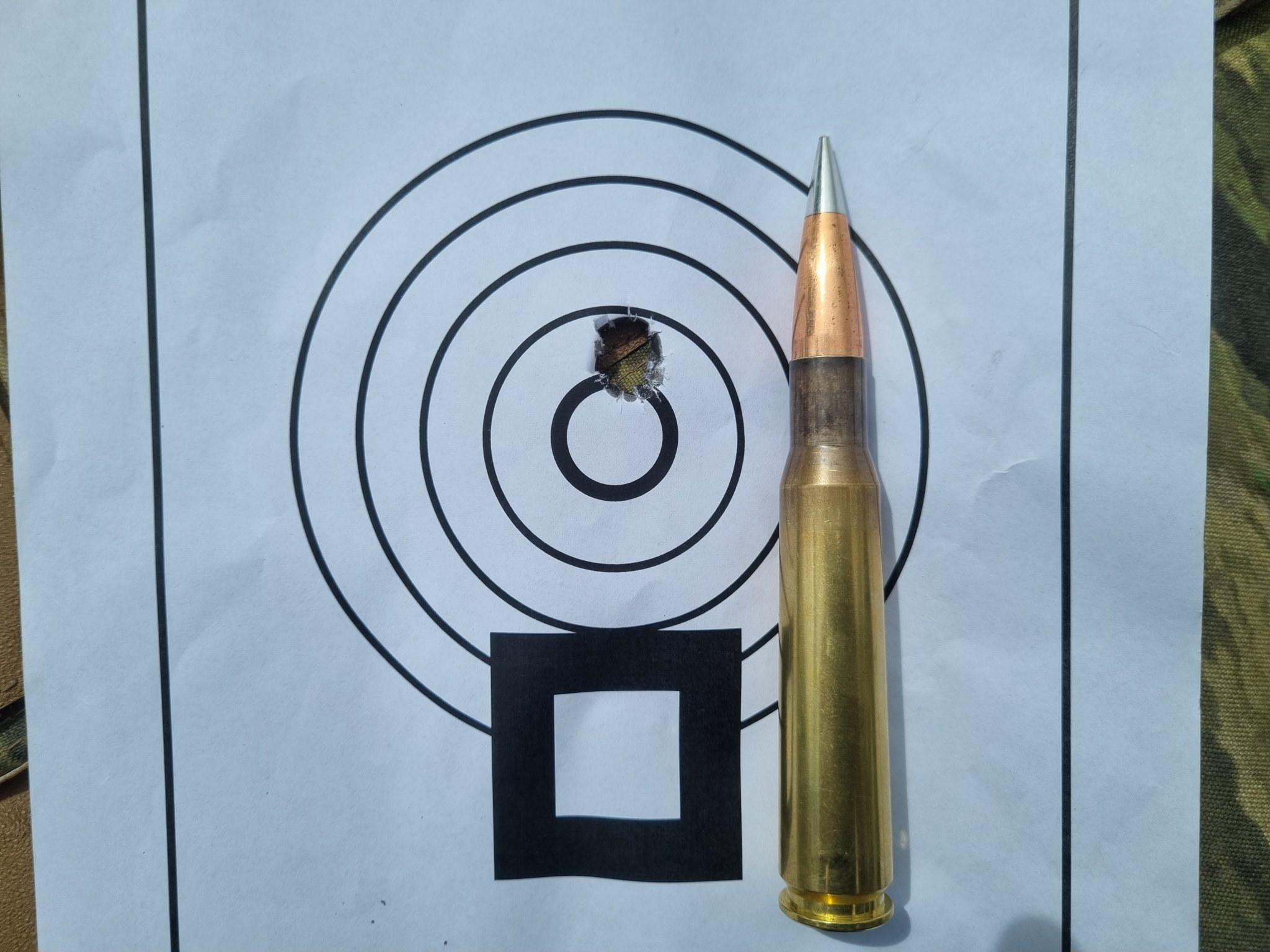

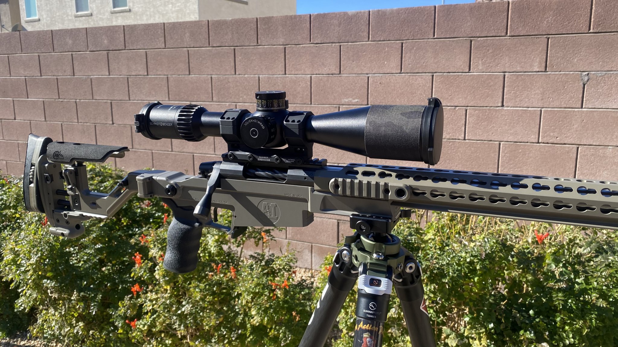

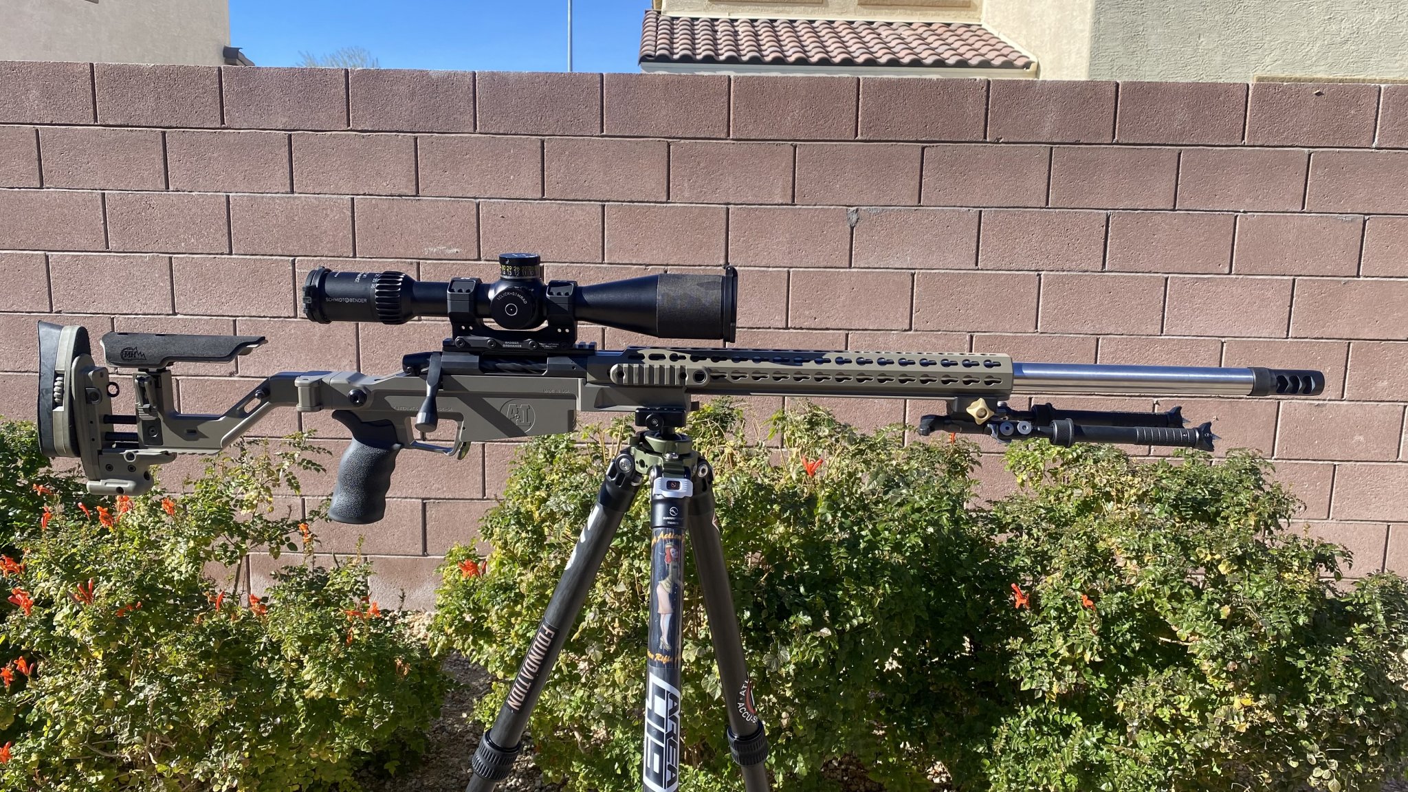

S&B 6-36 on 50BMG
Sight in after barrel change from 375CT..
3 shots 120yds.. :)

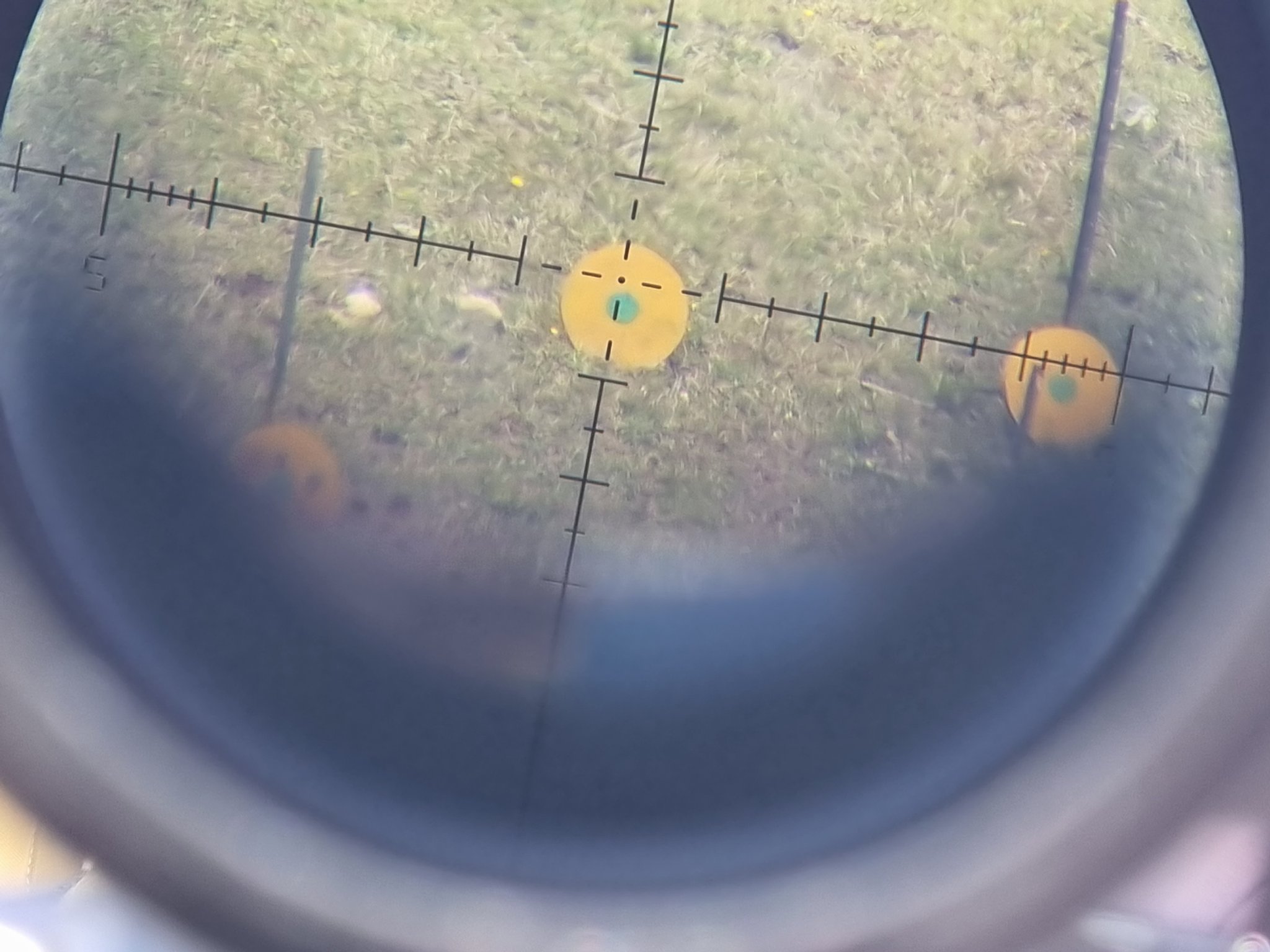

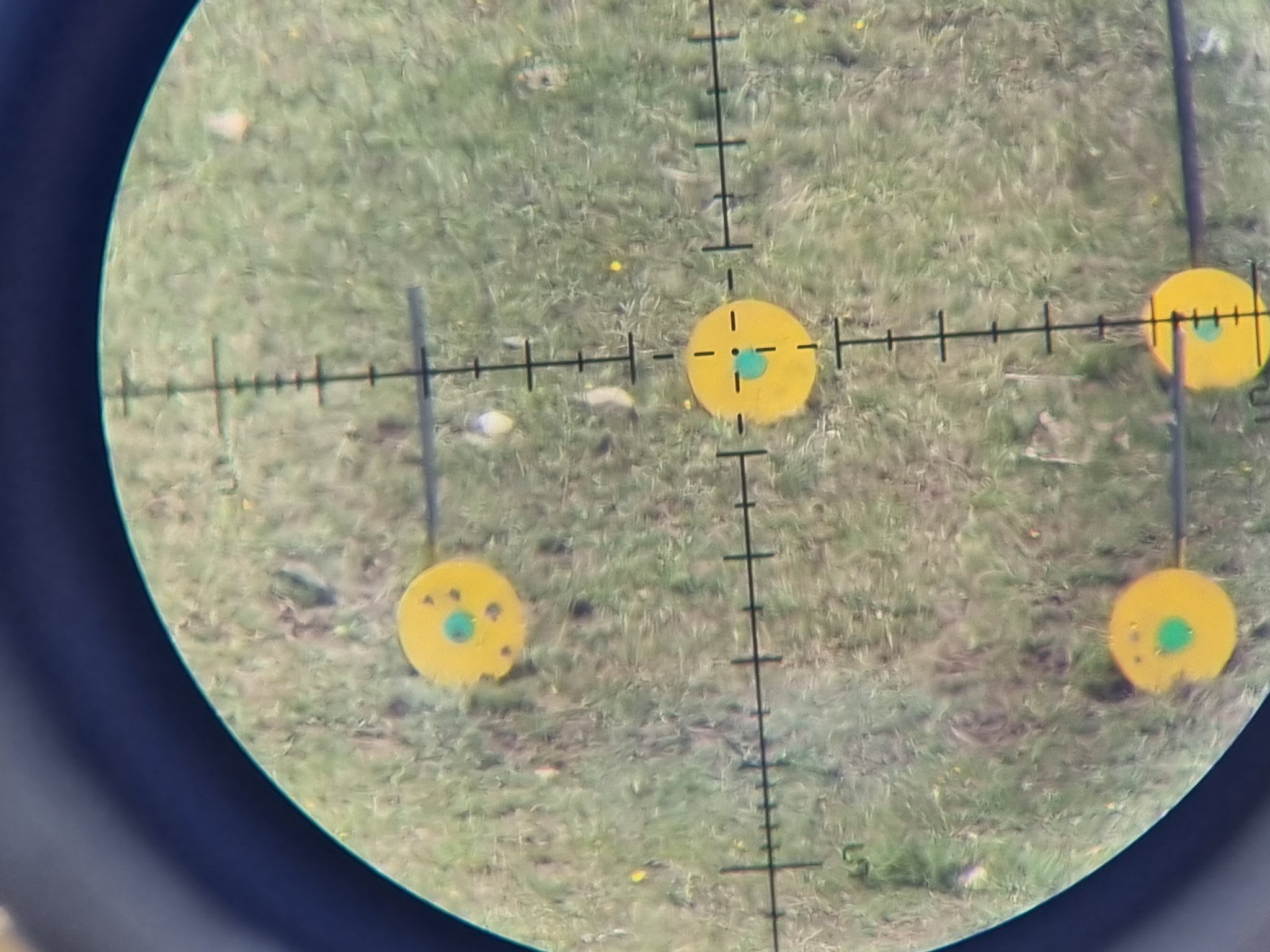

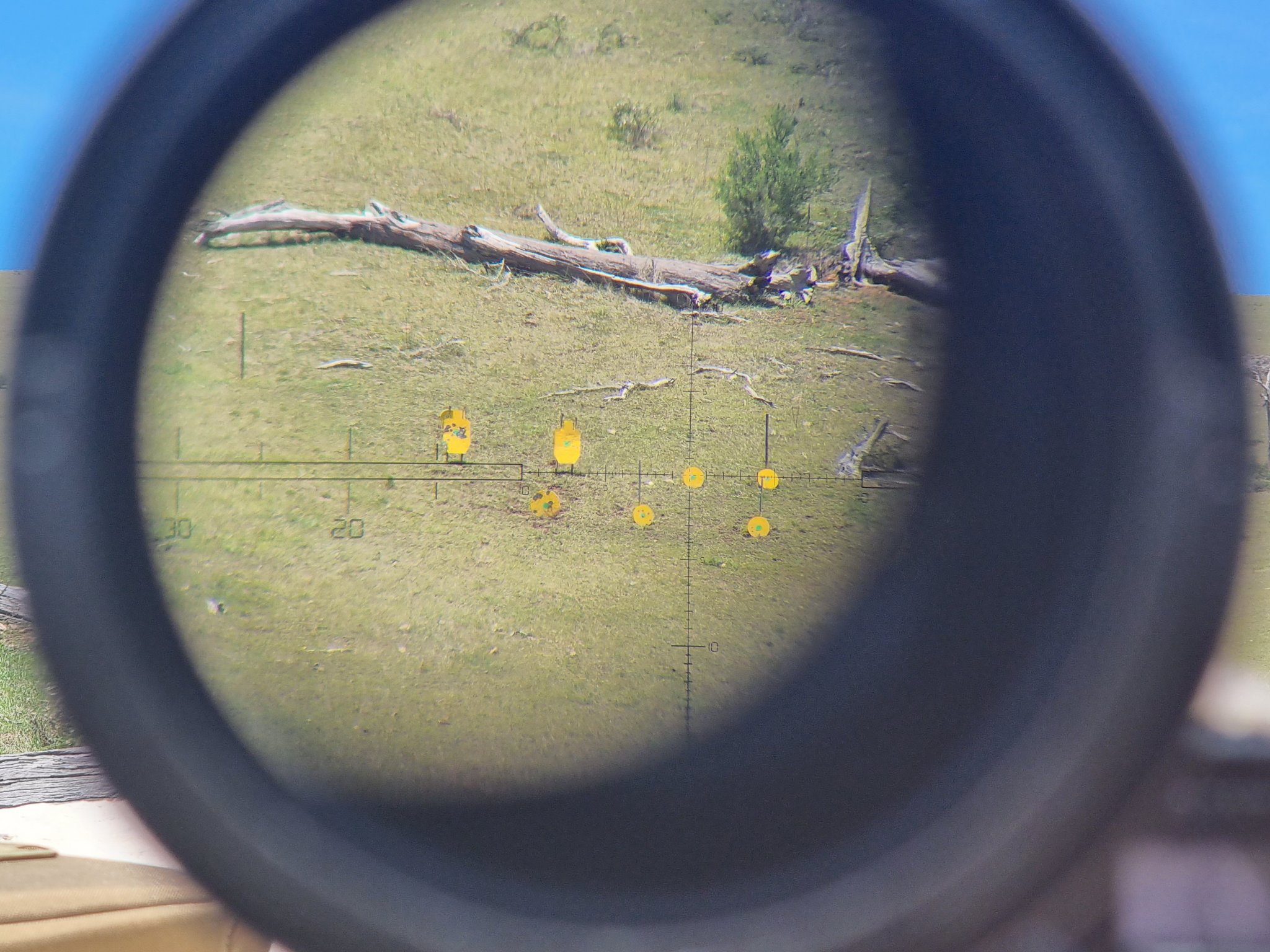

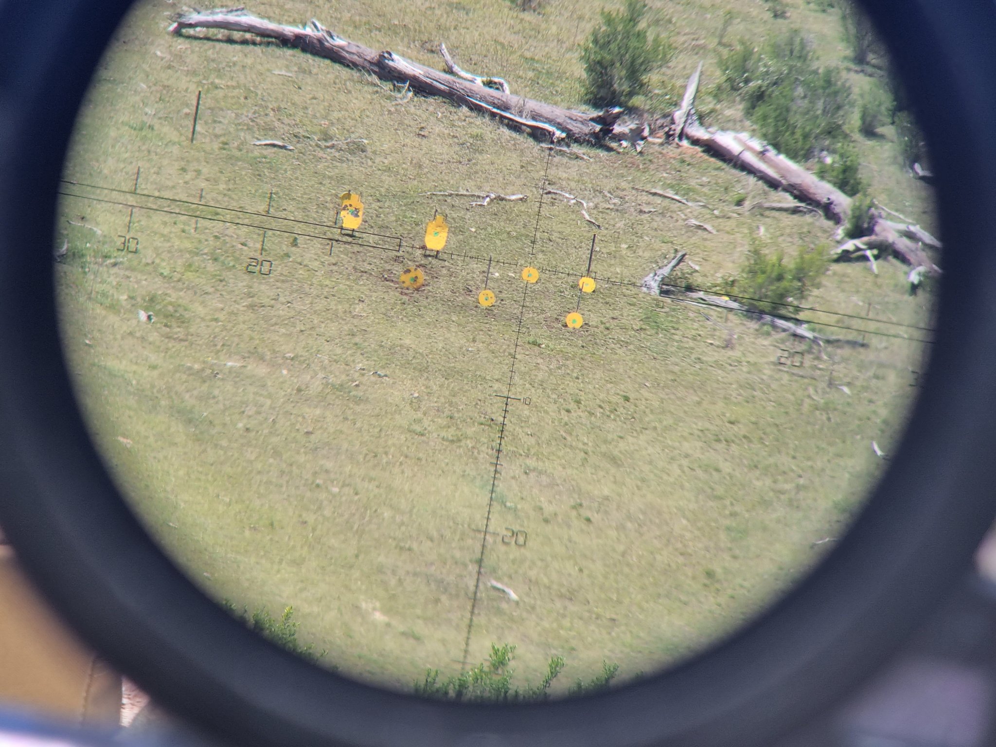

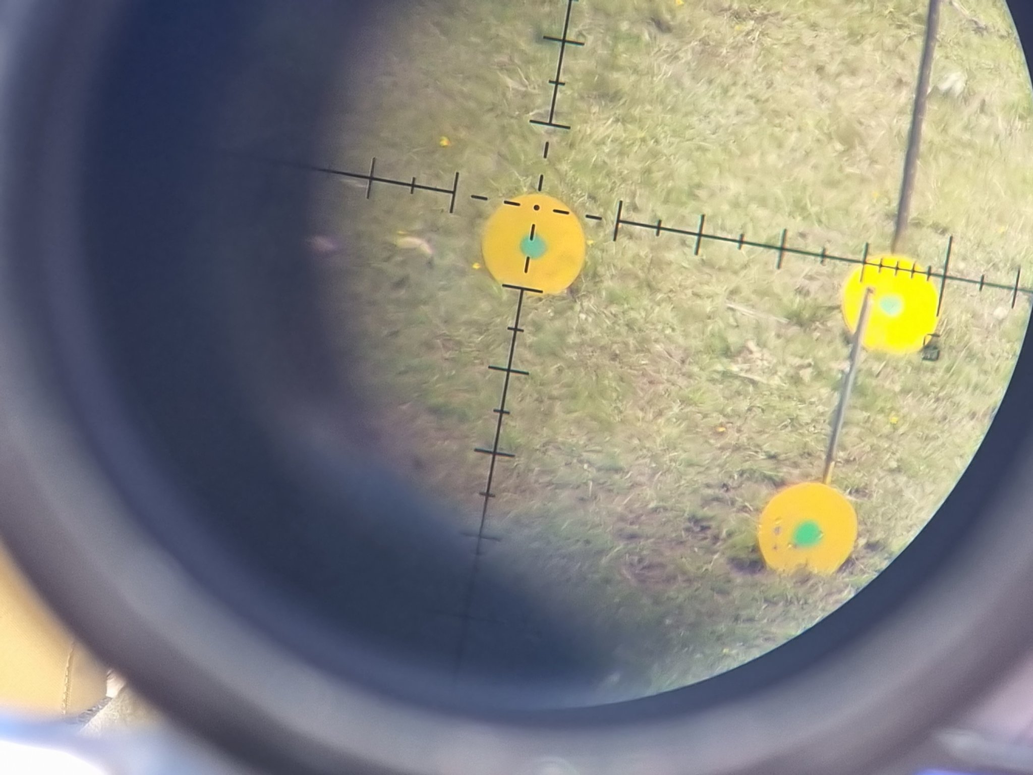

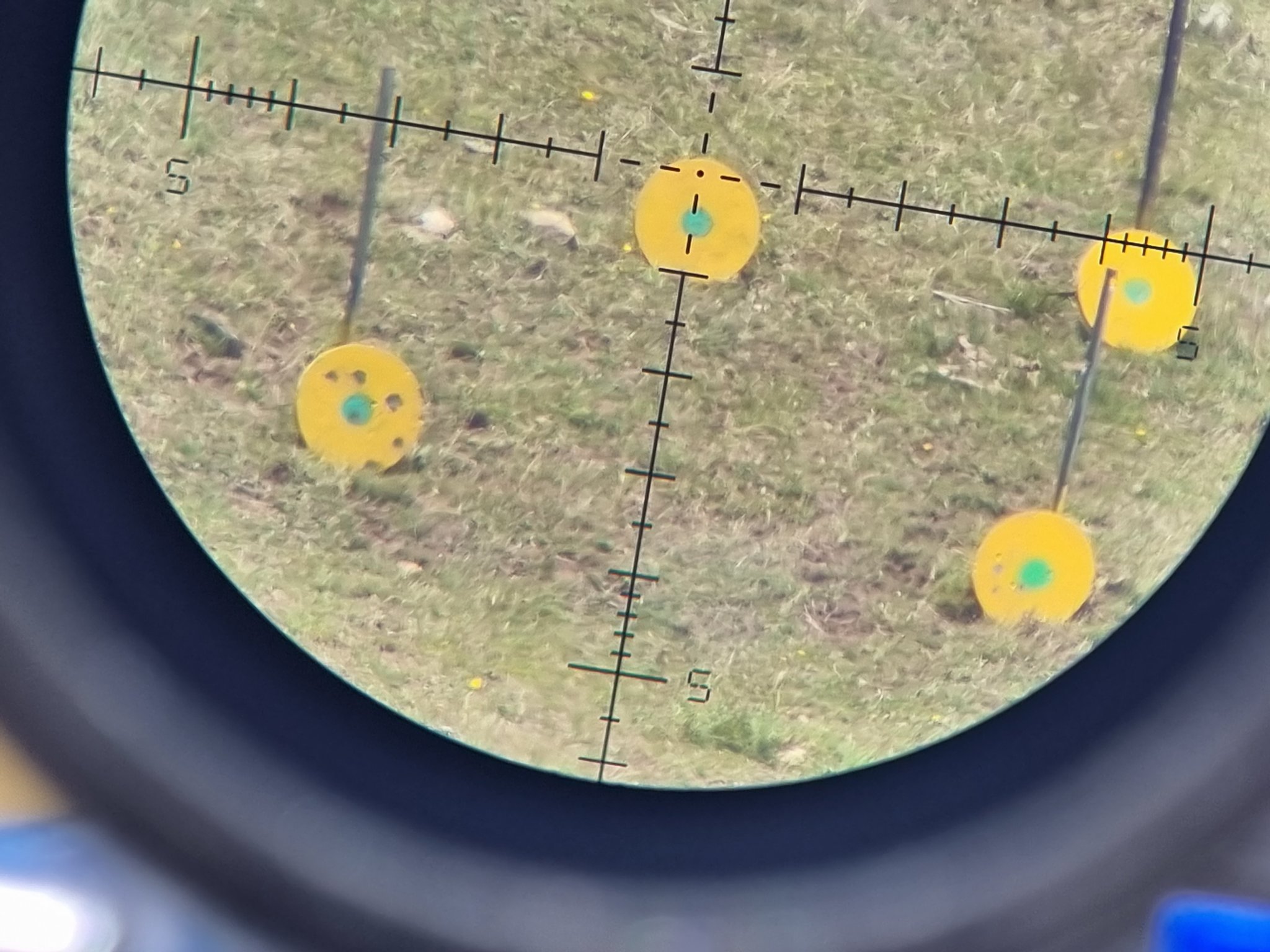

Had a request for some pics of P5FL reticle at 6x and 36x....at 300mtrs
Just put them here also for anyone else interested..
Thank you. It is much appreciated.

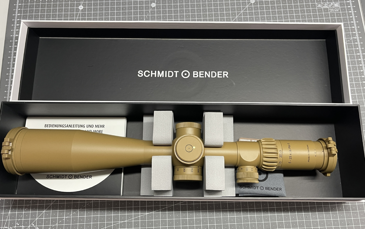

Got this guy yesterday as promised. First impressions are overwhelmingly positive this is my first S&B scope and I gotta say the quality and finish is impressive. I have owned NF, TT, ZCO and this just feels different, I love the simple not overly “tactical” design. They have come a long way in their packaging too I felt like I was opening a pair of Tom Ford’s or a fancy scotch.
First impressions of the P5FL are good it kind reminds me of the Delta LRD-1P with out the crosses and lil less information. Am not gonna lie I would have liked a .5 mark but overall am getting what I was looking for which was a cleaner and simple reticle. Will have to see how I like it in practice.
Turrets are amazing and have topped my list as the best I have ever felt. DTII+ design is great and the clicks are perfect, numbers easy to see and the lever is genius. On a “negative” note I would say that the .1 marks are a tad too close for a 15mil rev and my windage turret is significantly more muted and soft than the elevation. The MTC is nice but I wouldn’t call it a more tactile click it’s more like a more tactile stop.
Overall super excited to get this over to the range and start shootings. I can’t really discuss optical quality until I start shooting and finish up the set up process on my gun but the lil bit I saw it seems on par with anything I have used before.

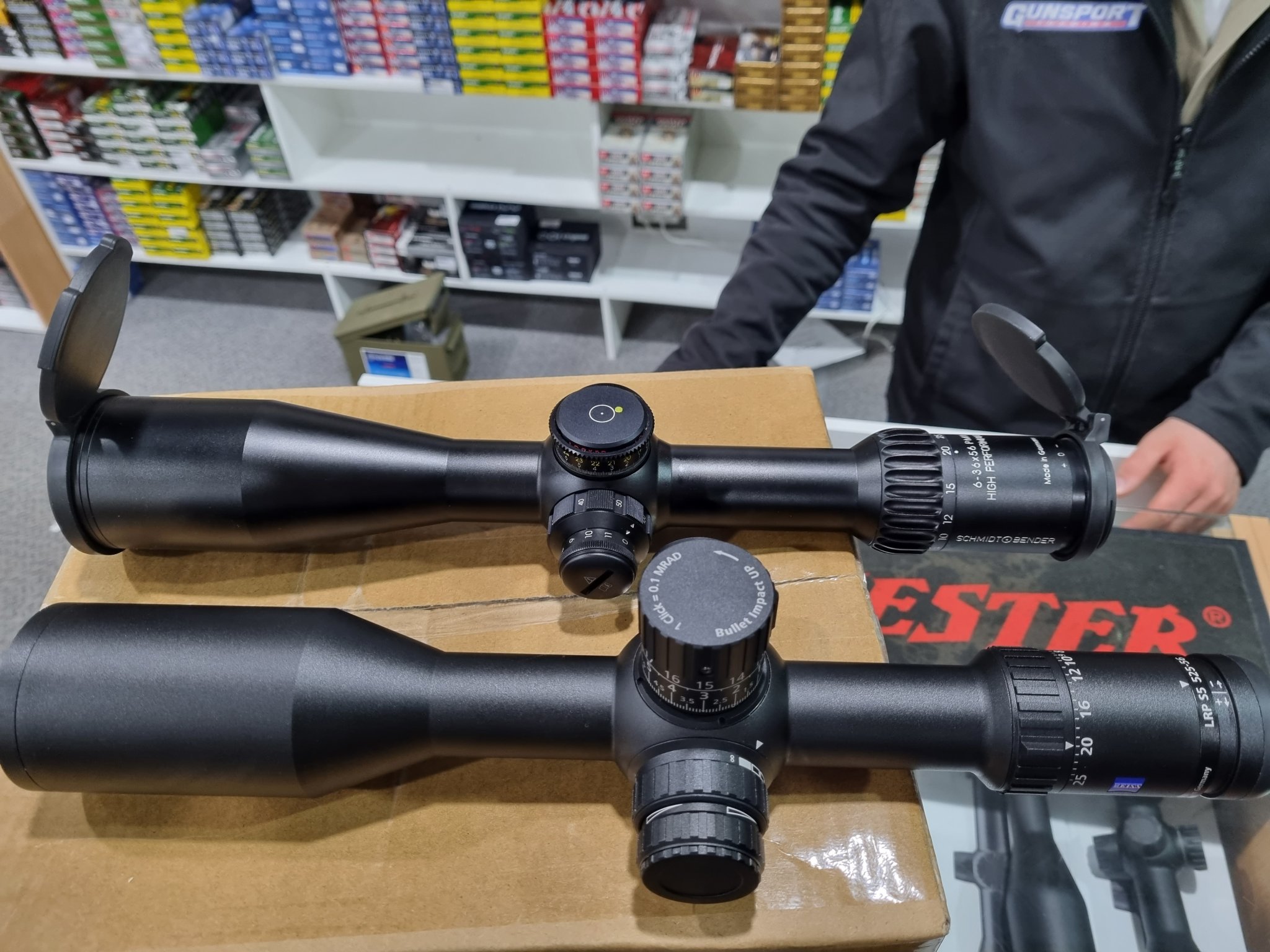

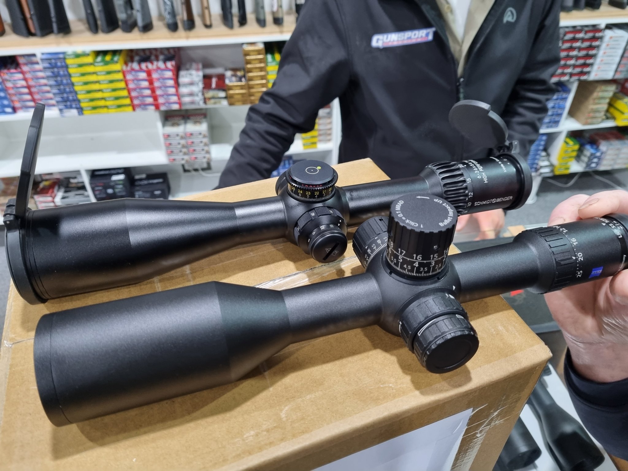

Just recently I took a 6-36 down to our local gun store for a few people to compare to the optics they had in stock.
All who compared were shocked how good the S&B is.
One individual was dead set on the Zeiss LRP S5.....until he looked through the S&B!!!
The Zeiss looked VERY ordinary in comparison!!!

When we compared the S&B 6-36 to the Zeiss S5 ...the S&B was like looking through a wide angle lens...........the Zeiss.... like looking through the cardboard tube in a Dunny roll!! :eek:
Probably the same look through both in the USA due to Swaro #FOVgate! 😢
Ok, maybe not but still 😢

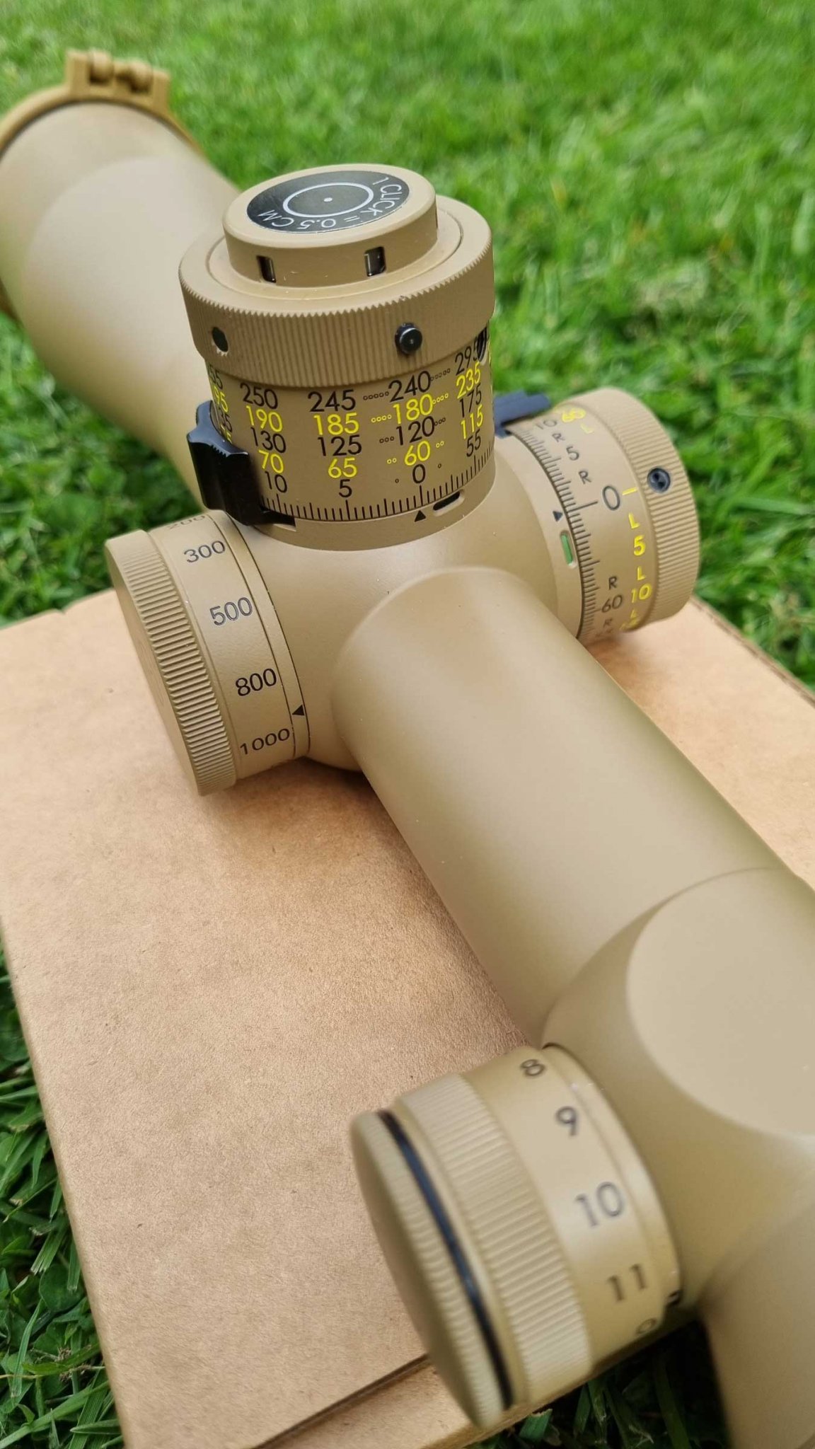

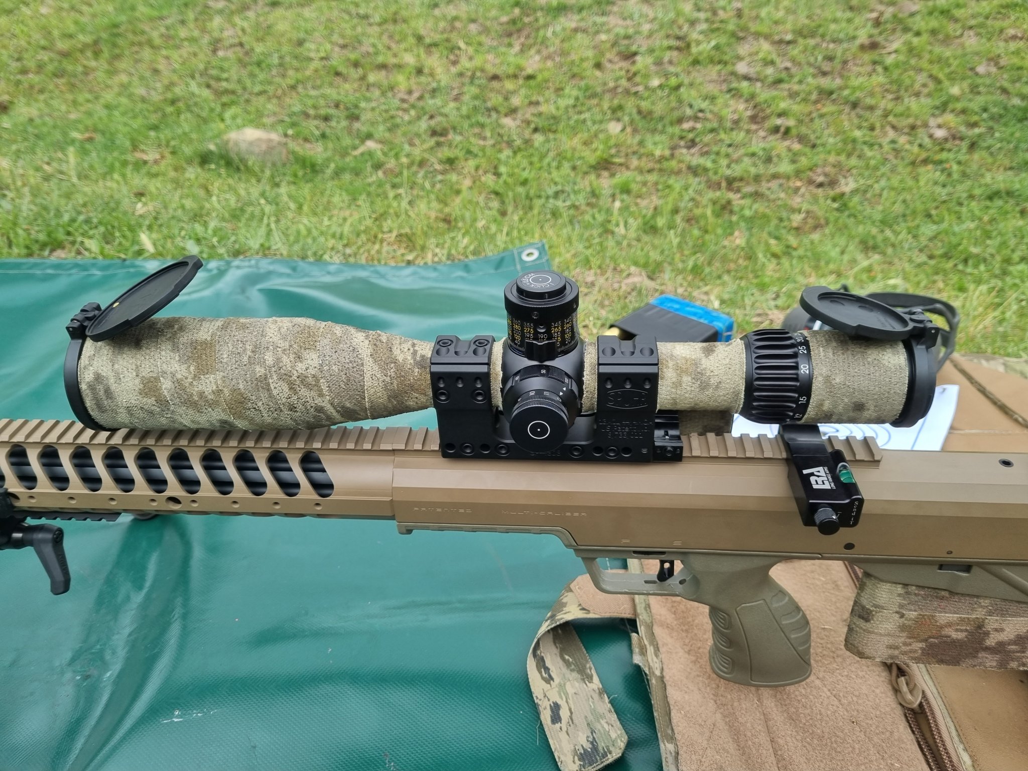

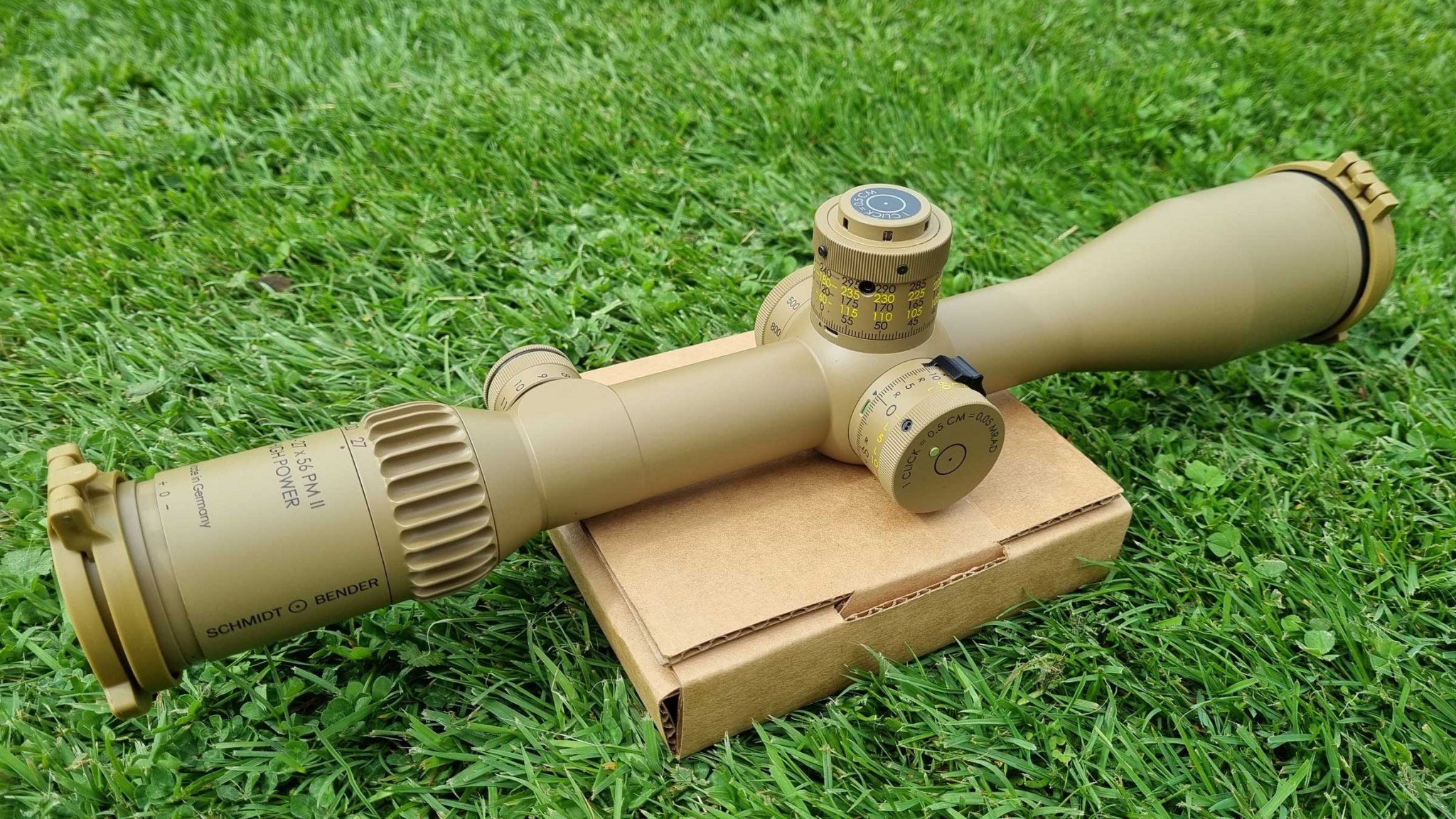

Not a 6-36....but .... i have a 3-27 in "Pantone" colour ... very sexy!! :LOL:
