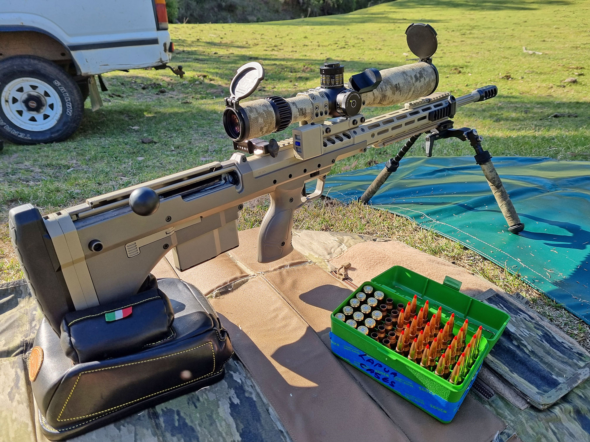

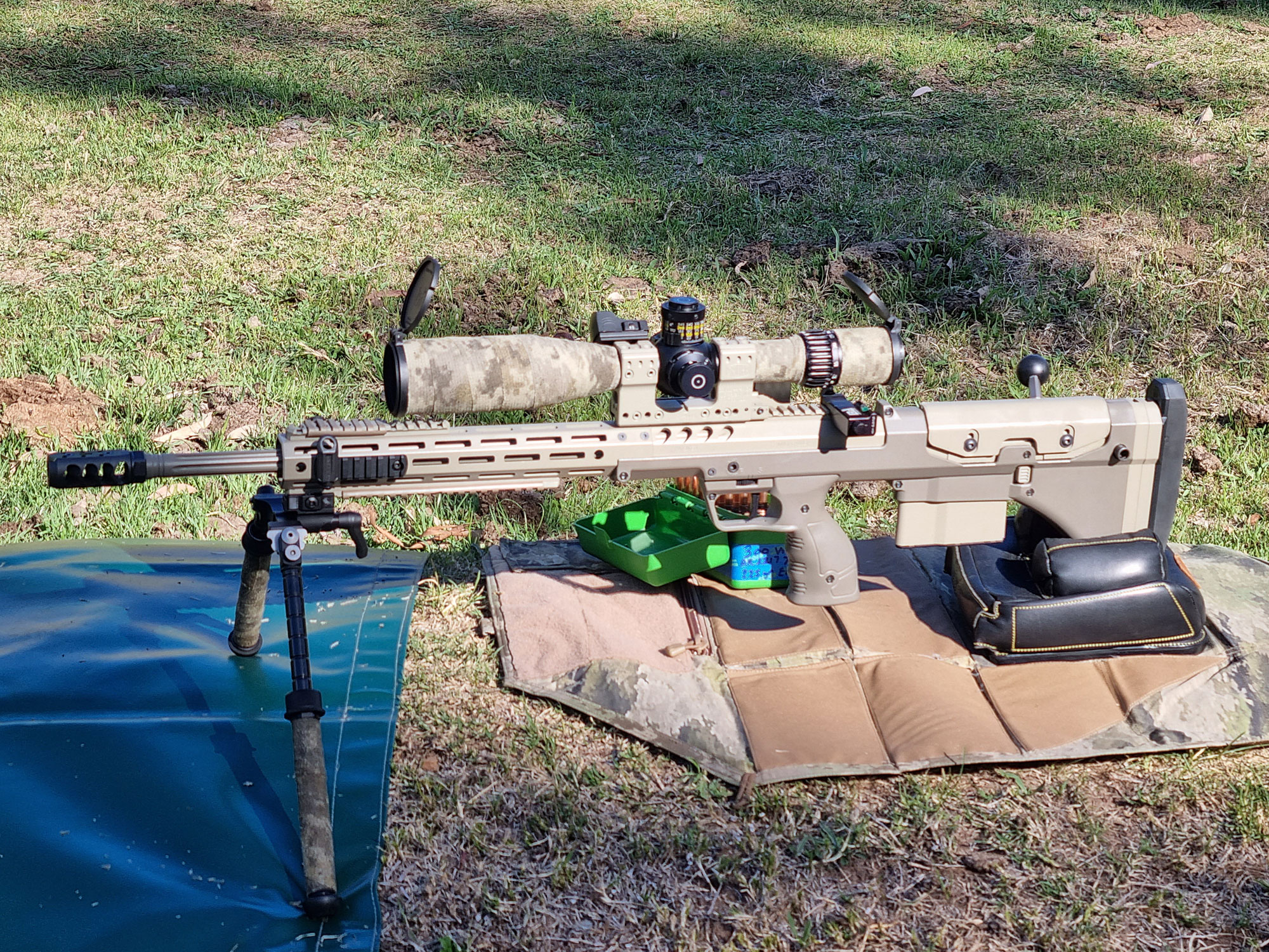

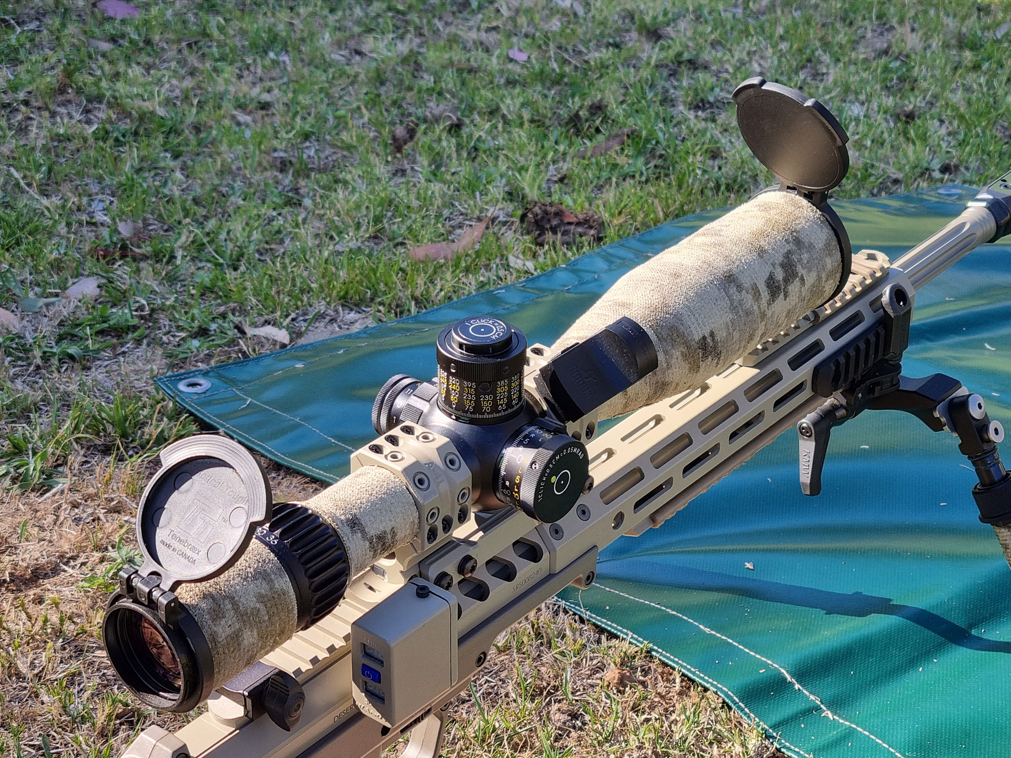

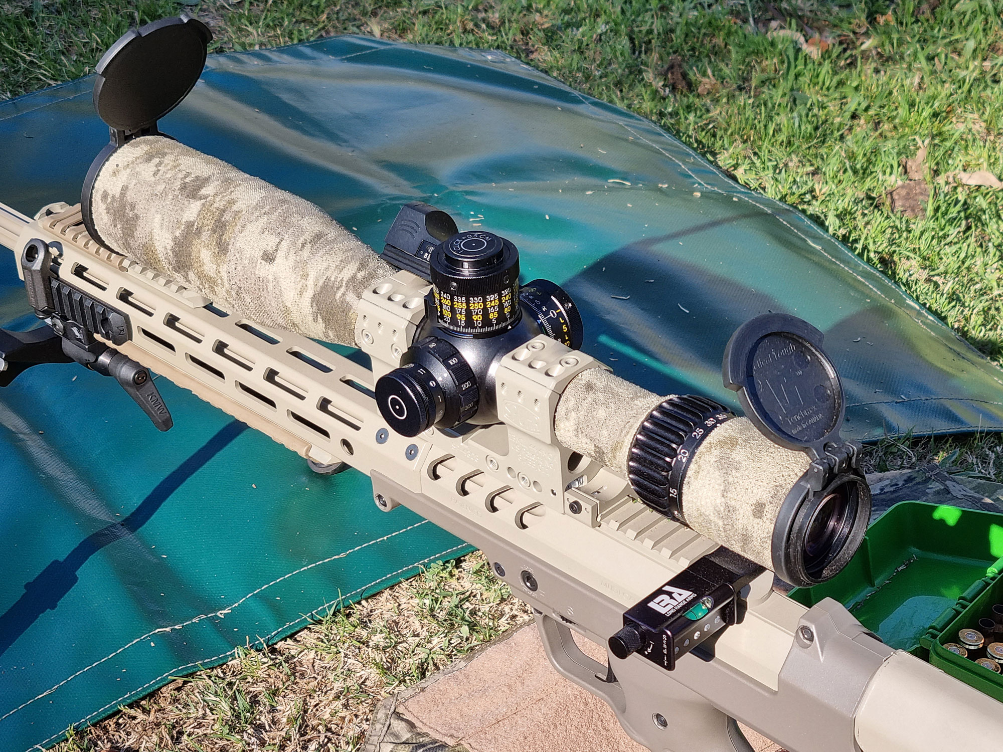

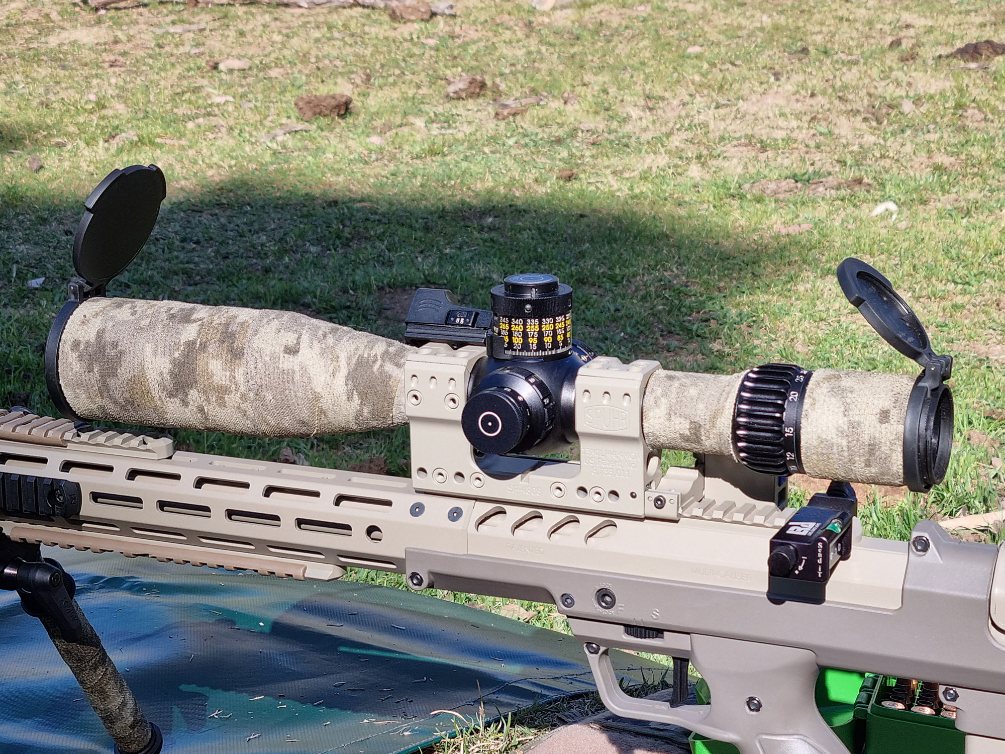

Some more S&B 6-36 Porn.. :)
New mount and Re Zeroing at 200yds....

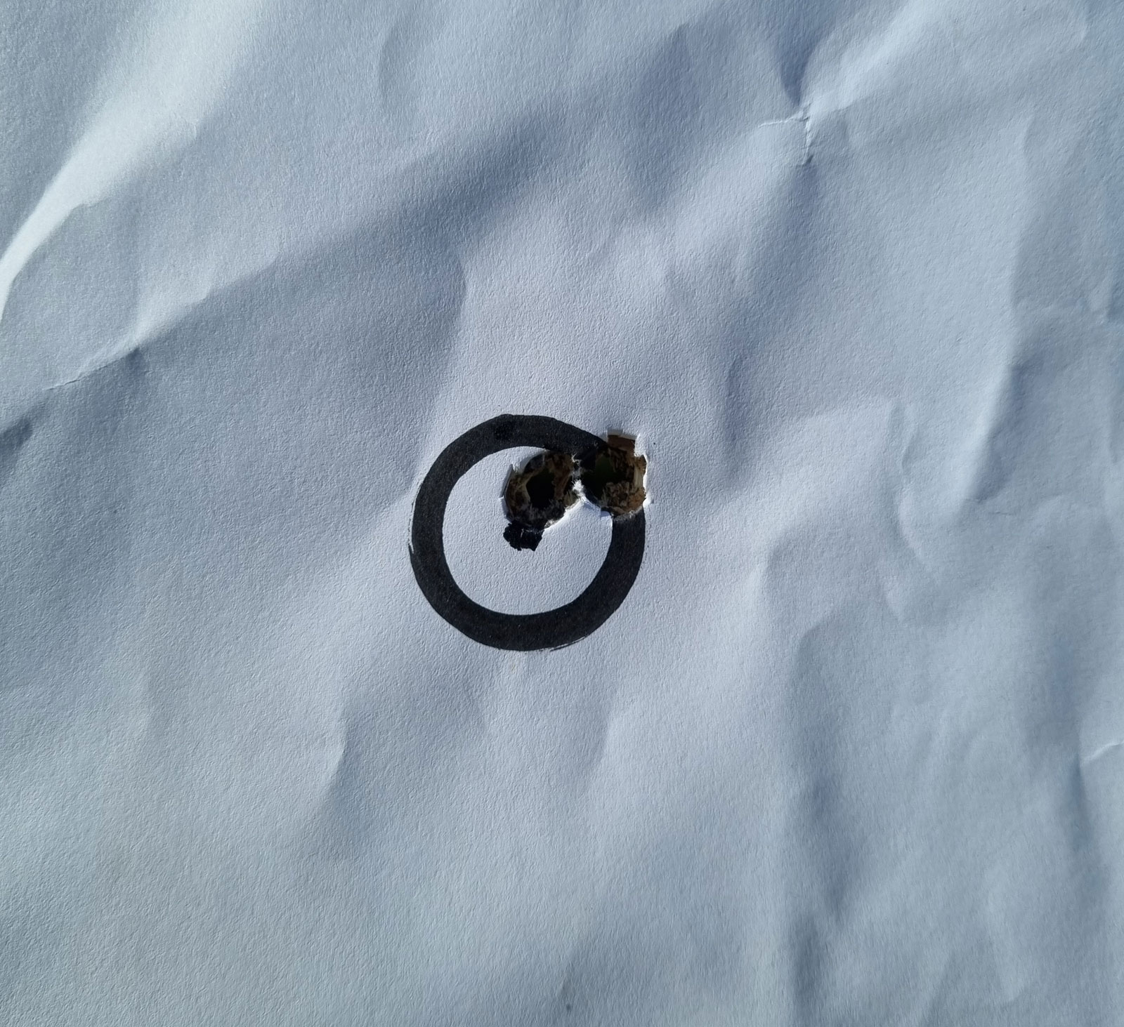

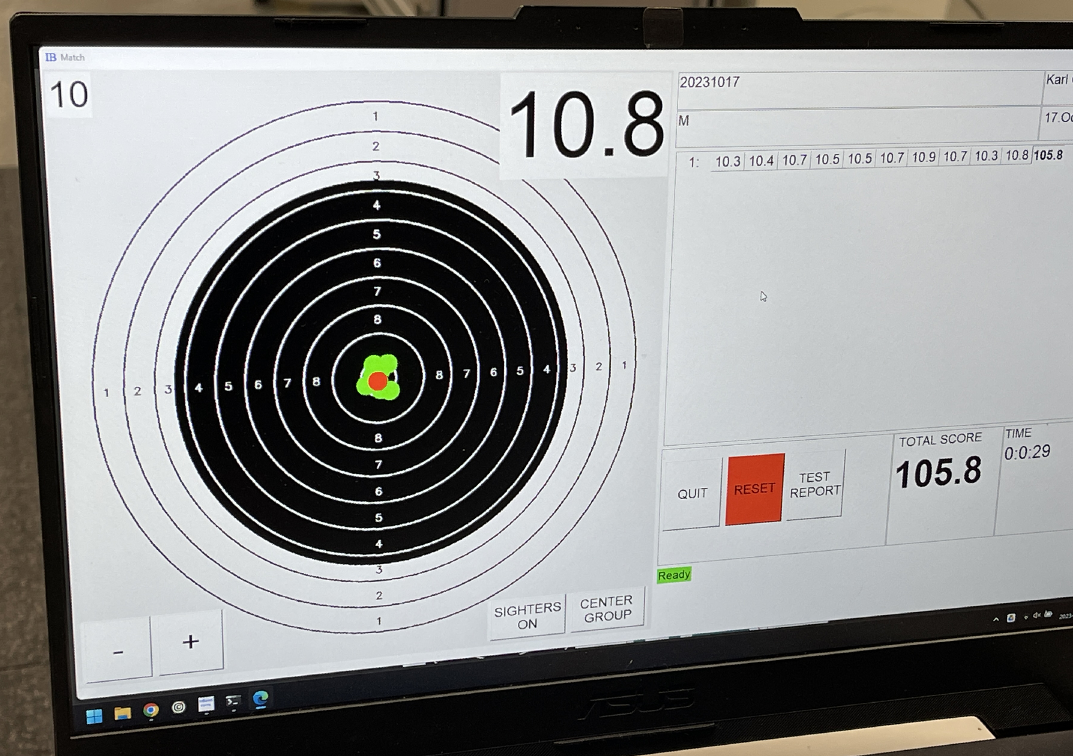

We did some 22LR Lapua ammunition evaluation today at 50 meters, to chose type and batch.
14.57 mm (edge to edge, not center to center) 10 shots, at 50 meters, and not shooting from a bench so allowing for some shooter error.
