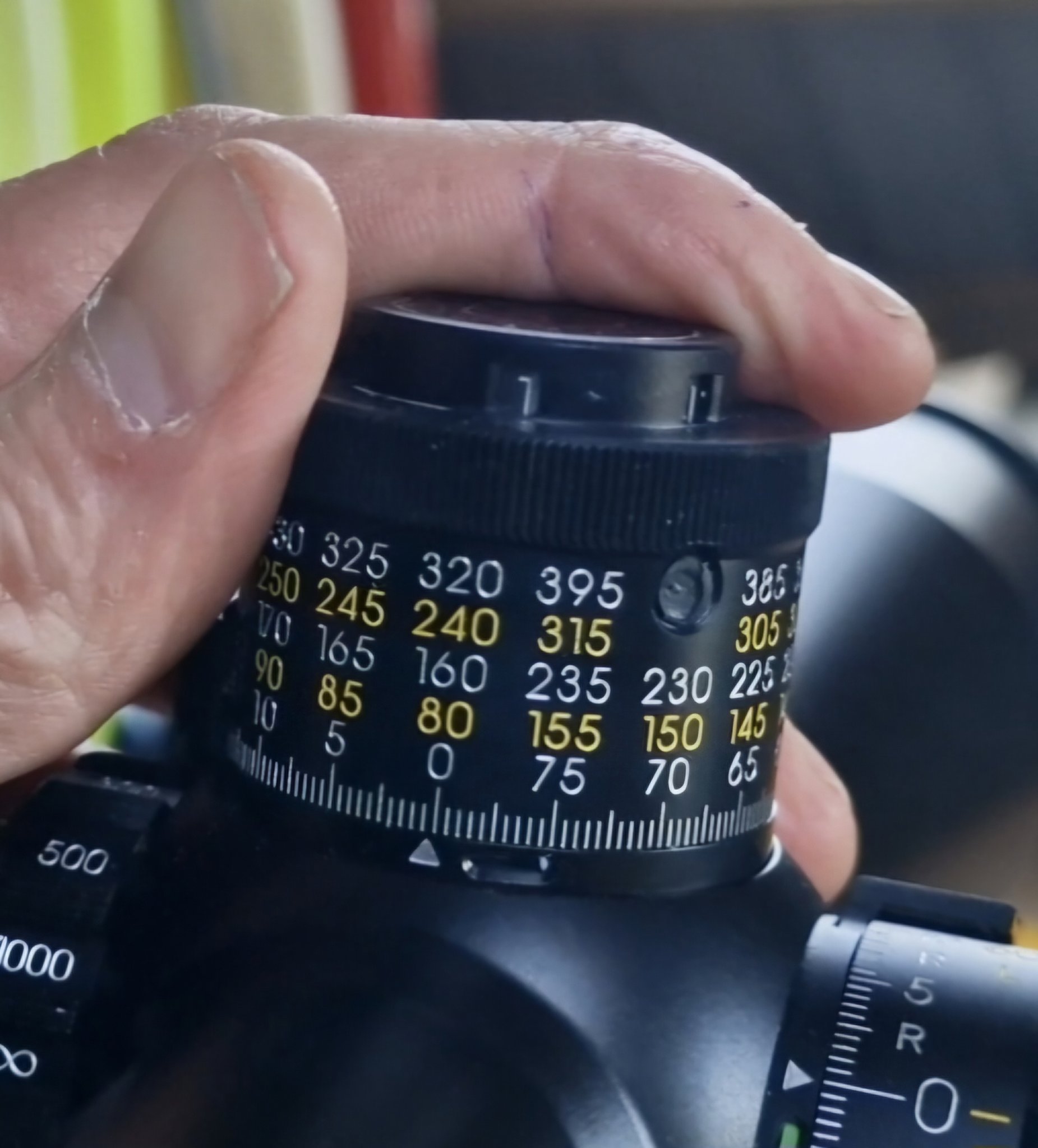

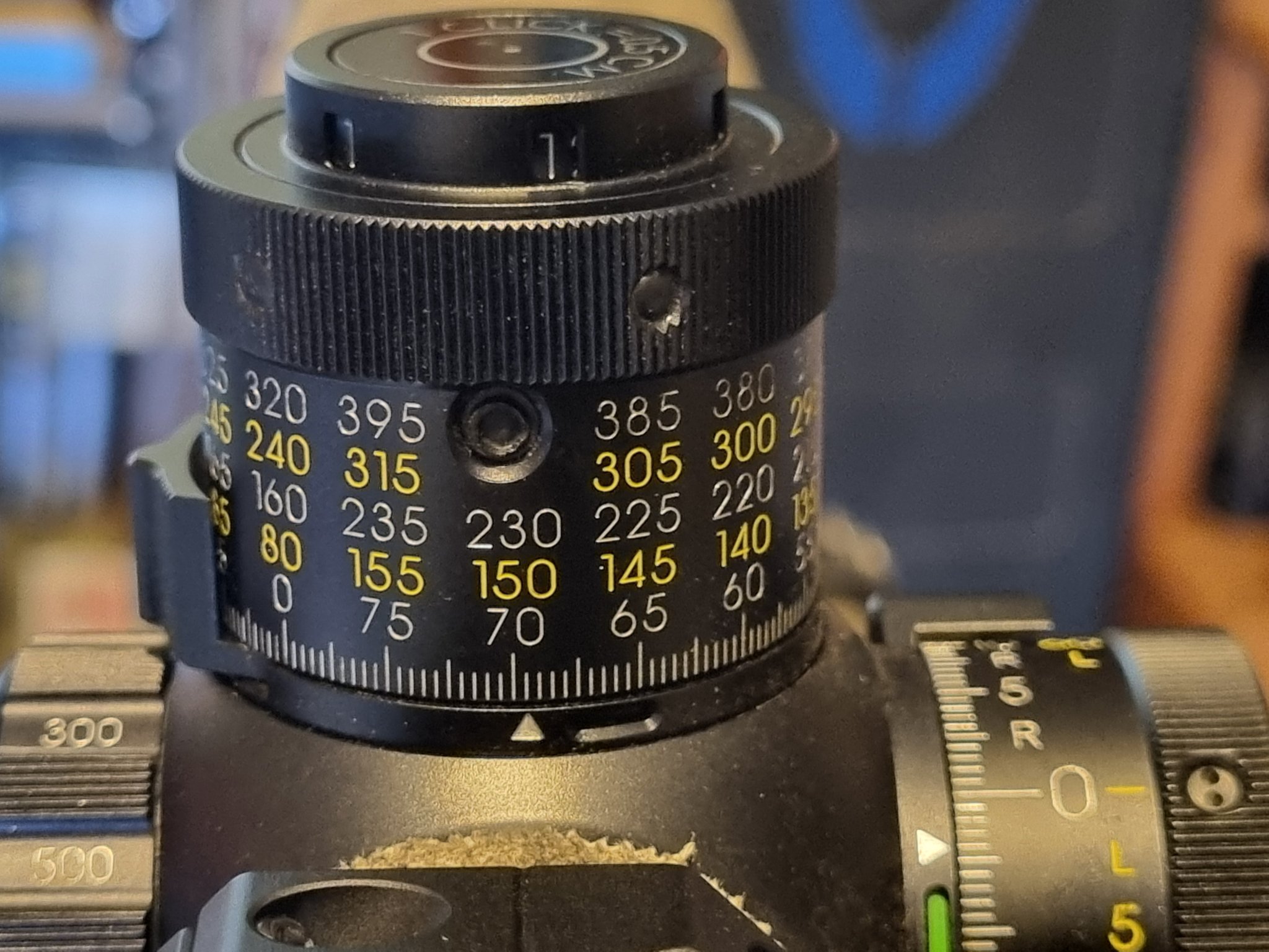

Excellent point I hadn’t thought of. I was just talking about the nomenclature in the model numbers without regard to turret markings, and I haven’t looked at one in person, but I can see where that would necessary.
Indeed it is clutered with numbers and yes the numbering can be confusing ( 10th of mil, rather than the classic mil - 1 mil become 10 10th of mil).
But personally I view them as 8 mil turret VS my previous 10 mil turret ZCO. And I like it.
the turret has the right dimensions for rotating it. The clicks are amazing in my opinion.

It is a busy turret for certain but I can see why it was done this way. I would have to physically see one before I would go that way.
You say the clicks are amazing. Can you elaborate? Would you say that they are as crisp and precise as the clicks on the ZCO or TT?

Imo the dtii+ and mtt turrets are money. Zco feels softer but definitely a solid detent but I hate the turret lock and how they zero.
The tt is closer in feel imo to the dtii/mtt. The SB is more slightly more audible and very distinct. You can feel and hear each click... Very crisp. The ability to quickly lock and turn mtc on off is so nice
Tt are slightly more spaced apart not quite as tactile maybe is how I would describe it but seriously splitting hairs for sure. Tt turrets are pretty awesome.
Maybe I can take a video comparing them but @Long Range 338 can also comment.

I still take TT over SB, but if you want a locking the DT II+ are probably the best on the market. ZCO is better than say NF, but they’re not as consistent or good as TT or SB DT II+.

Never seen a TT in my like, even less touched one. So I can't compare.
But compares to my ZCO, it is sharper, very crispy with less turret friction. Not much effort required to turn it.
Saying this, of find my ZCO turret very good . But this one is even better.

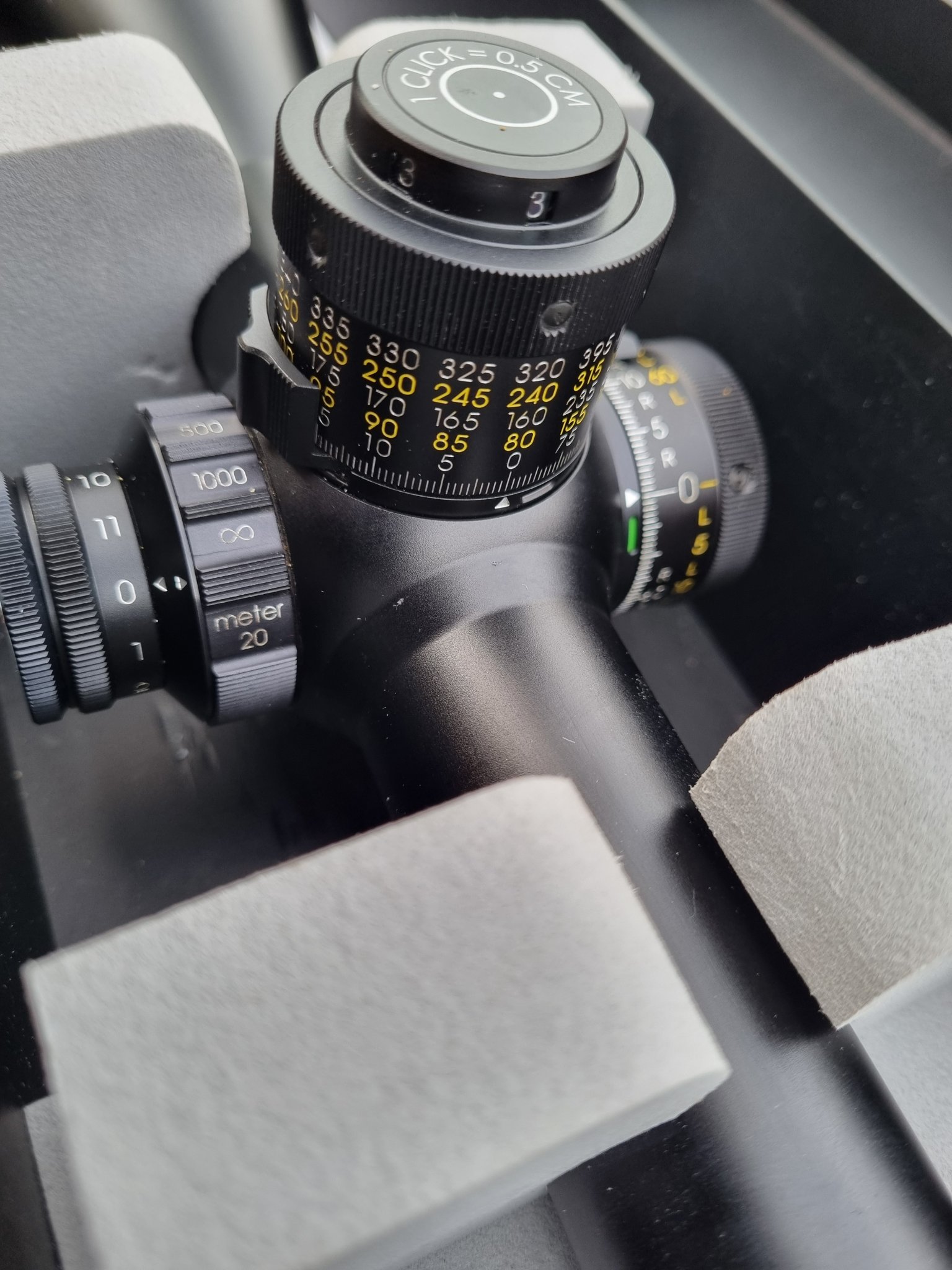

I am a HUGE fan of the MT .5cm turrets... it is my preference on all of my S&B scopes. The feel of the clicks is superb , besting everything i have including TT..
I have just ordered the S&B 5-45 PM2 High Power with the MT .5cm option, i imaging it will be the same as the others...which is top notch!!

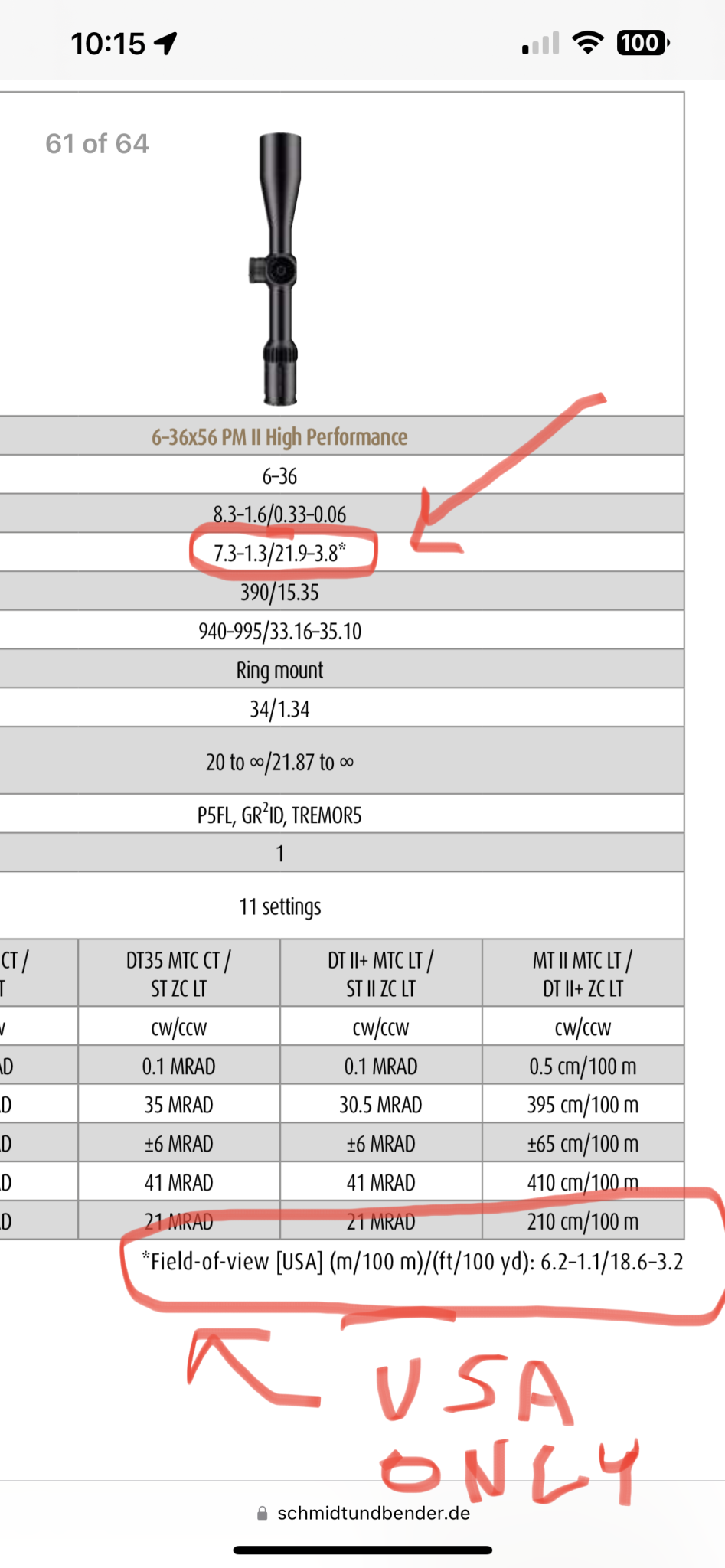

So is there a consensus on whether or not this scope is worth a look over the NF 7-35? I will be in the market soon for something on this level and price range.
Also, what is the difference in FOV between the European scopes and US versions? Website just lists one FOV.
Ah, so the US version still has a slight advantage except at the very top. Now just need to figure out which one is easier to get behind.
Depending on price it is worth taking a look, I am wrapping up my review that includes these two scopes, the NF 7-35 having come out circa 2018 is still a very impressive design. Choose based on reticle and be confident both will deliver where it counts.

All scopes in the United States have the same limitation because a competing patent exists in United States.
Schmidt is not the only company that is affected by this, so are all other scopes sold in the United States
