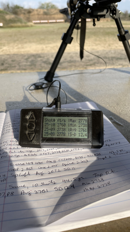

I am getting 2840fps in virgin Lapua brass, 26”, Varget with a suppressor on. Could go hotter I suppose but what’s the point. Probably easily get there with a 30” barrel if you wanted to.
I can’t really go over 2800 for PRS tac class anyway. Plus the recoil is plenty as it is.

If you shoot tac class, this is going to be the bullet to beat. I was hoping for a trued G7 of .270+ but it came in at a respectable .265. Accuracy is outstanding as well. Load was just 42 gr 8208, virgin Peterson brass, jumping .030. Zero load development, I just did this to get a BC. All charges thrown on a Lee powder measure.
First group on a cold barrel was just a tiny bit off center, but super small. Maybe a .2? Adjusted zero, shot one centered up and went to it. It shot great everywhere, but I only snapped a couple pics of the better ones which happened to be at 500 & 800. Sub moa without trying. 9.6 mil @ 1000, 2735 FPS, zero pressure.

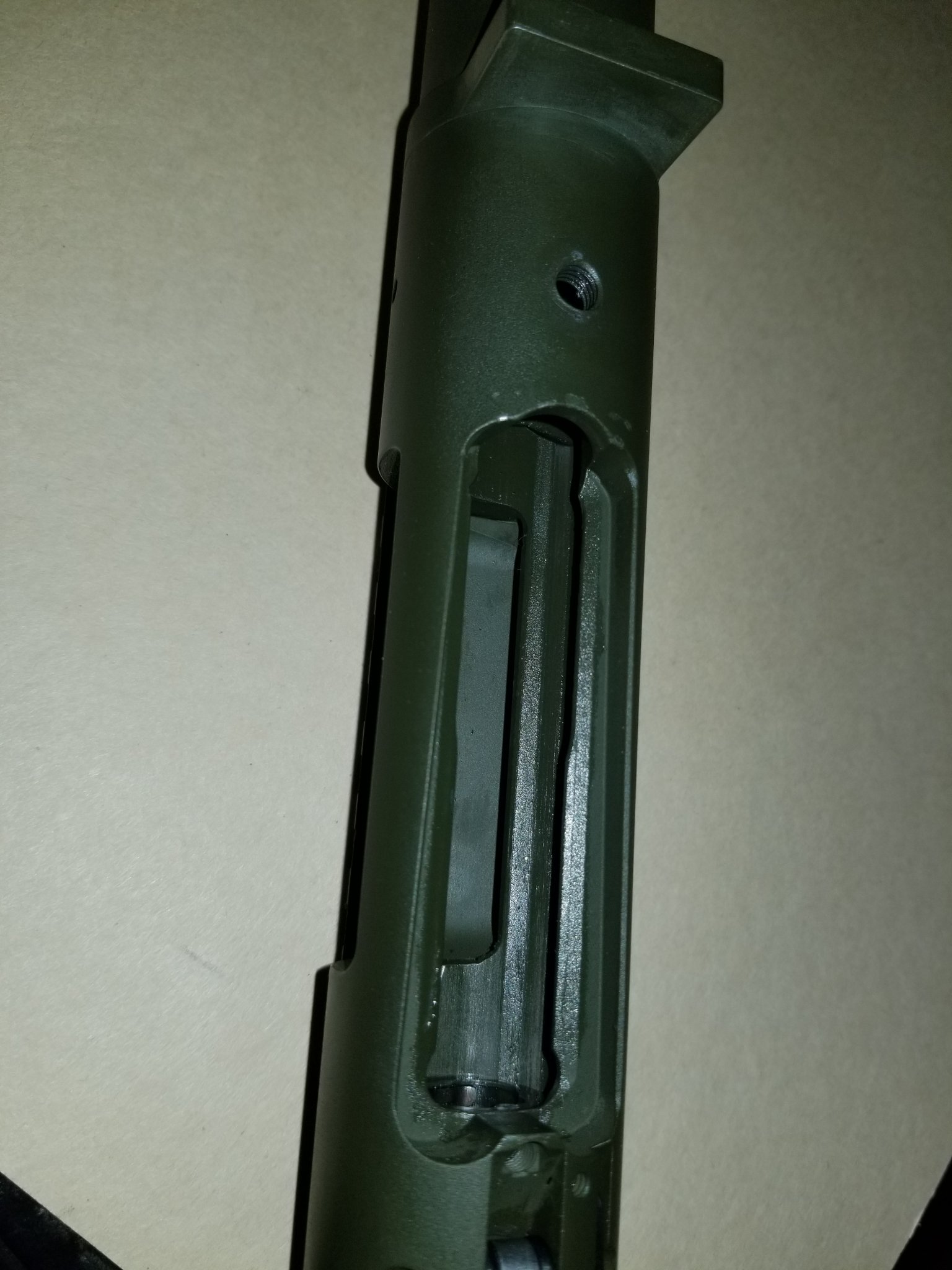

Tried them in my TacOps Lima51, but I cannot load an OAL longer than 2.830" in that rifle as the nose hits the feed ramp under the chamber. I could mill a notch in the area like I did on my R700 in 260, but on the Lima, it's sacrilege.

42.2 to 42.4gr. of Benchmark. Fed. GMM twice fired brass and Winchester primers. Base to ogive of 2.2530. 2600 FPS at 4500’ and 68 degrees and 15% humidity at time of testing. Of course the first match I shot with this load the temp was 32 so velocity dropped to about 2536.

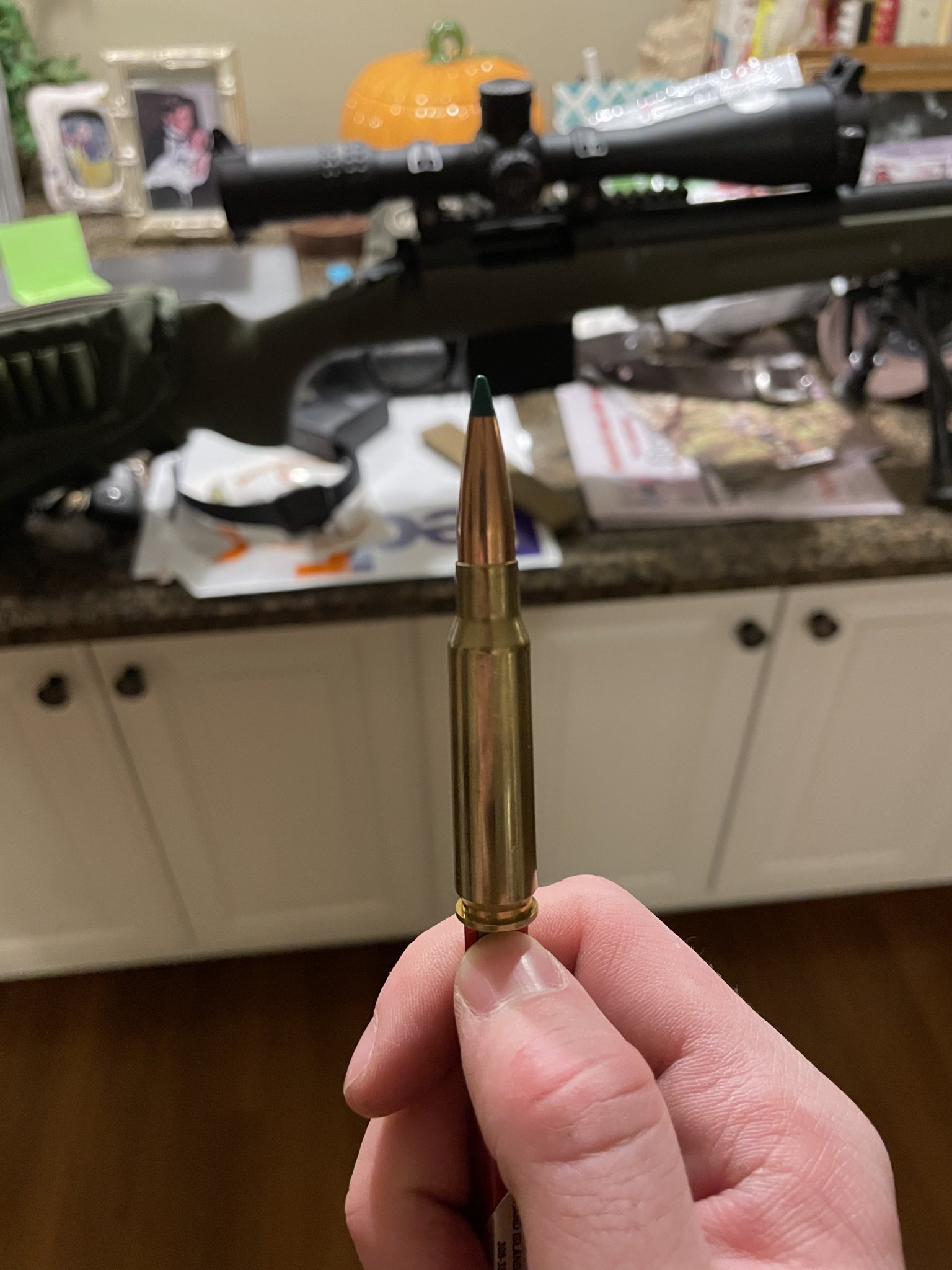

I ended up going 168 TMK for the BC. Had it throated specifically so i could seat them out. I think i did .130 freebore and David Deep South nailed it. This is what it looks like in the oal gauge. I’ll have to get the XM3 notched no doubt. But i plan on shipping it to LRI this weekend.

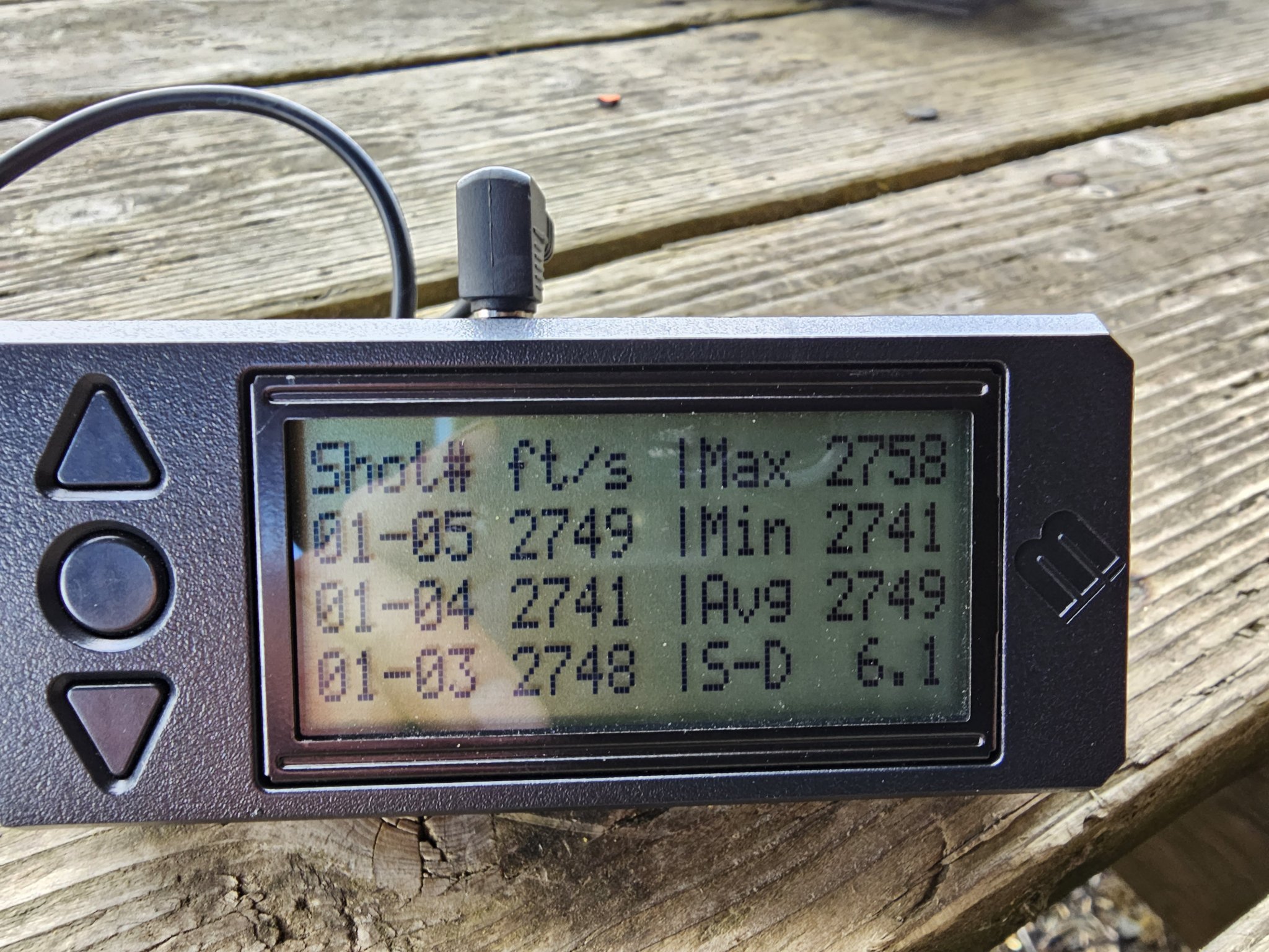

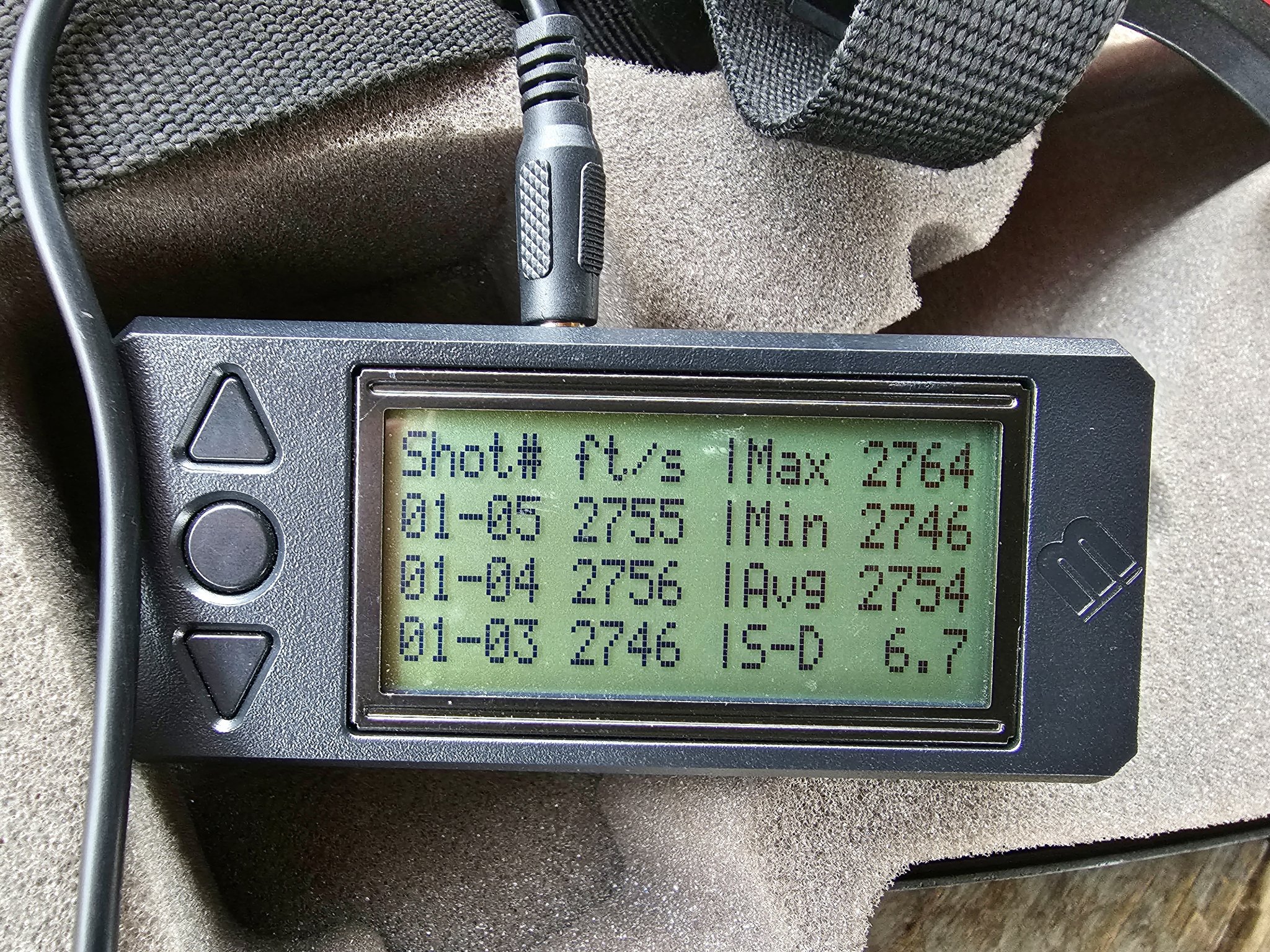

Well, I have been playing with them in 2 of my 308s. I have been using recycled Hornady TAP brass, BR2s and Varget. Found a great node in my 24" gun that shoots pretty darn good without touching seating depth. Set that at .030.
And then I tried them in my 20" work gun and the node I fou d was at the same speed and the brass look good but I am tempted to redo it and try and find a slower node, I am just use to slower nodes out of my 308s.
