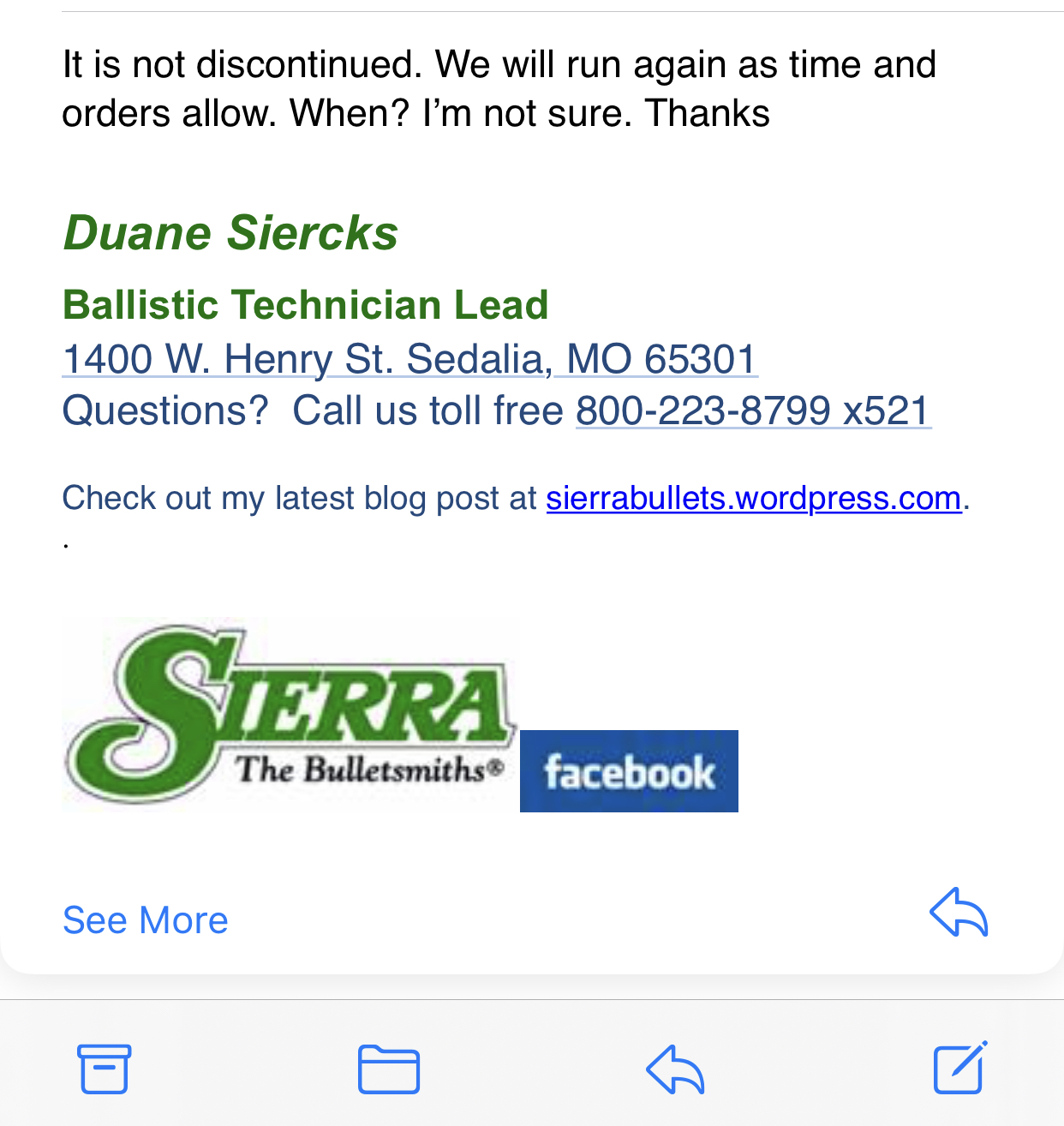

It gets even better....this bullet is now pulled from Sierra's website... I had it bookmarked. I just clicked on it to check the BC again to confirm what I have in my Kestrel... Sorry product not found...... If you go to their website and click on .308 bullets... its no longer listed in there either... What the hells going on??
Emailed Sierra and they responded saying the 169 is not discontinued but not sure when they are going to make another production run. Sucks, I should have ordered 1000 of them when they were available.

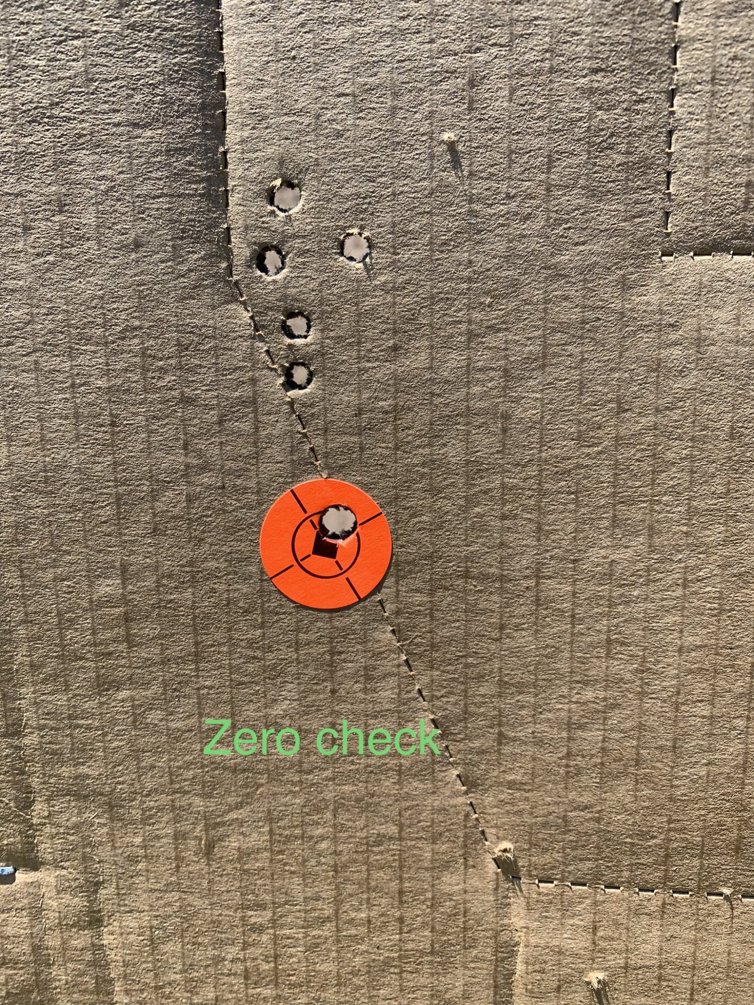

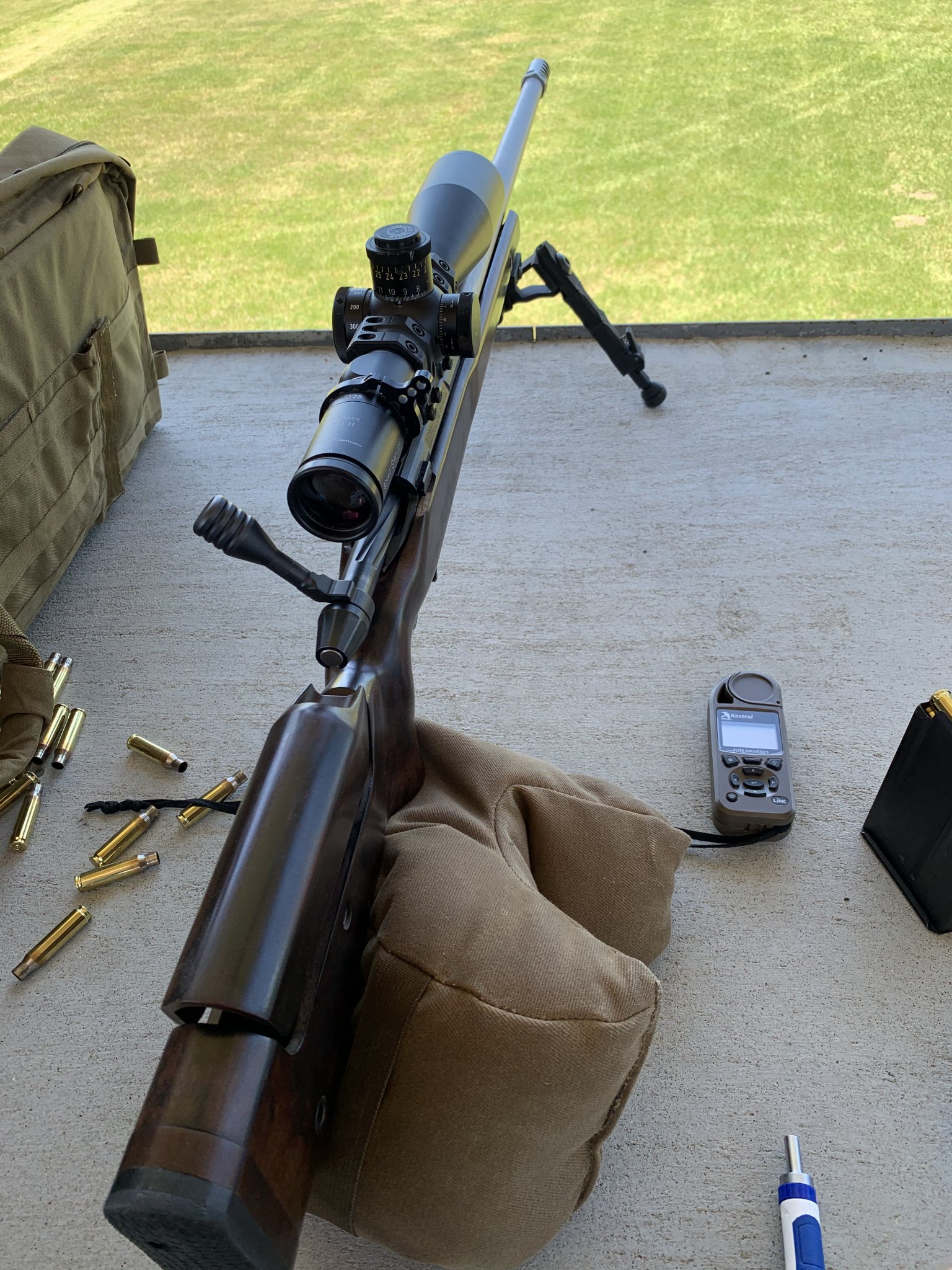

Well enough snow melted that I was able to drive downrange to paint steel and really true these things at 700 and shoots some targets at 300 and 500. It was a gusty day, not the best day for group shooting at distance but they did not disappoint. Constant 6mph gusting from 6-15.

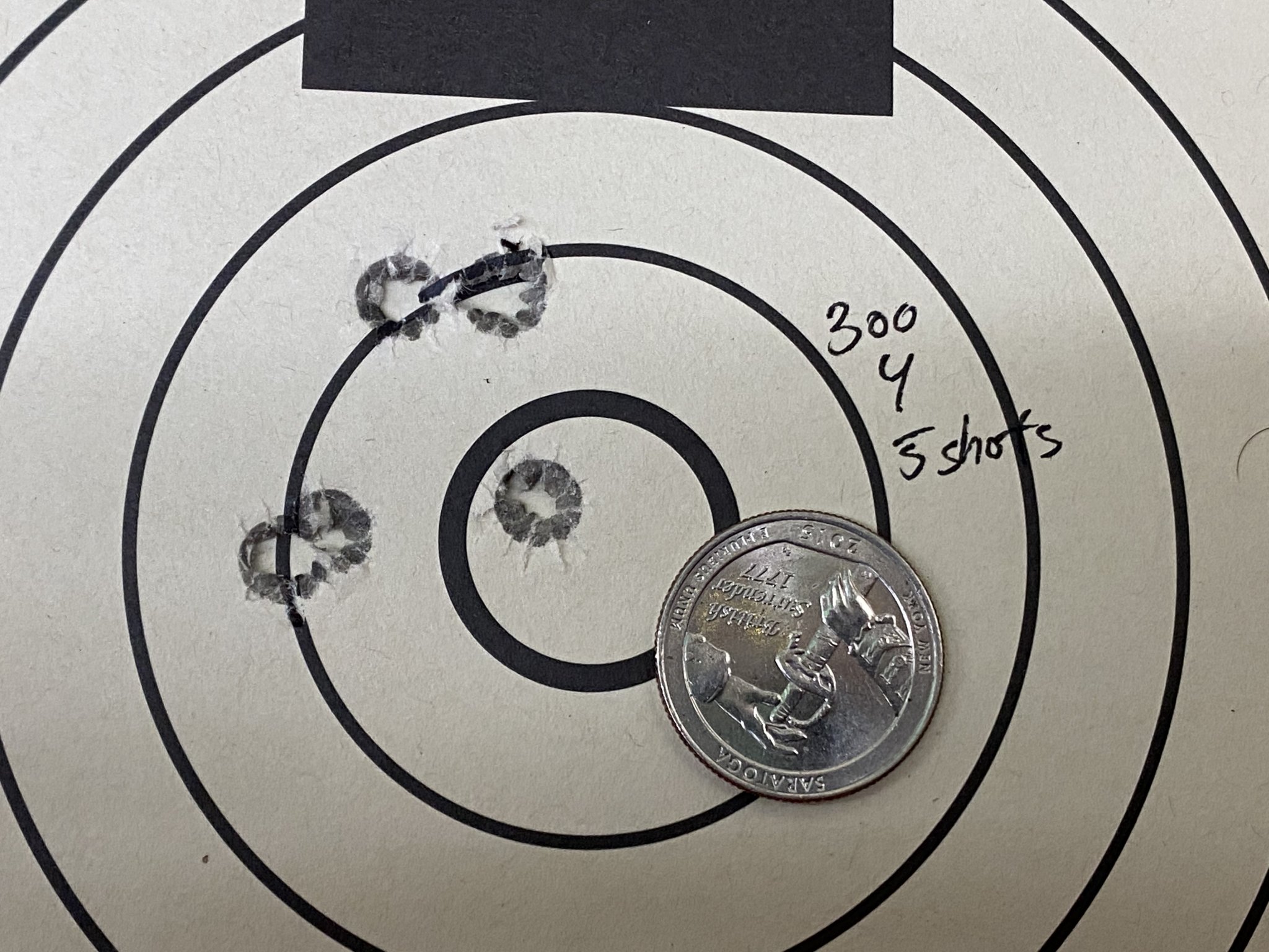

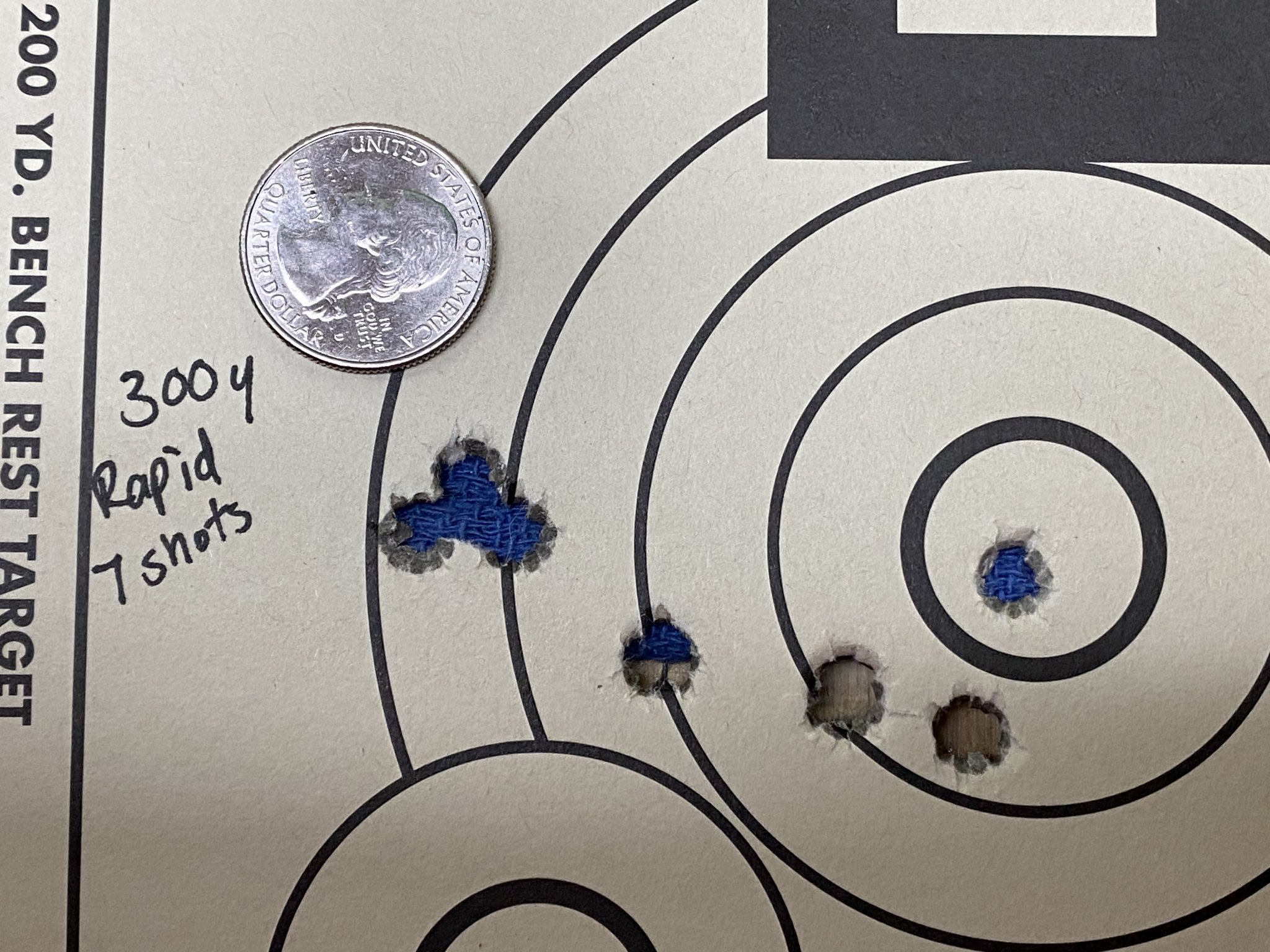

300yd Groups were shit, wind was gusting pretty bad when shooting the 300yd groups. Didnt even bother measuring the second group, you can see its bigger than the first one. First group 0.589 MOA.

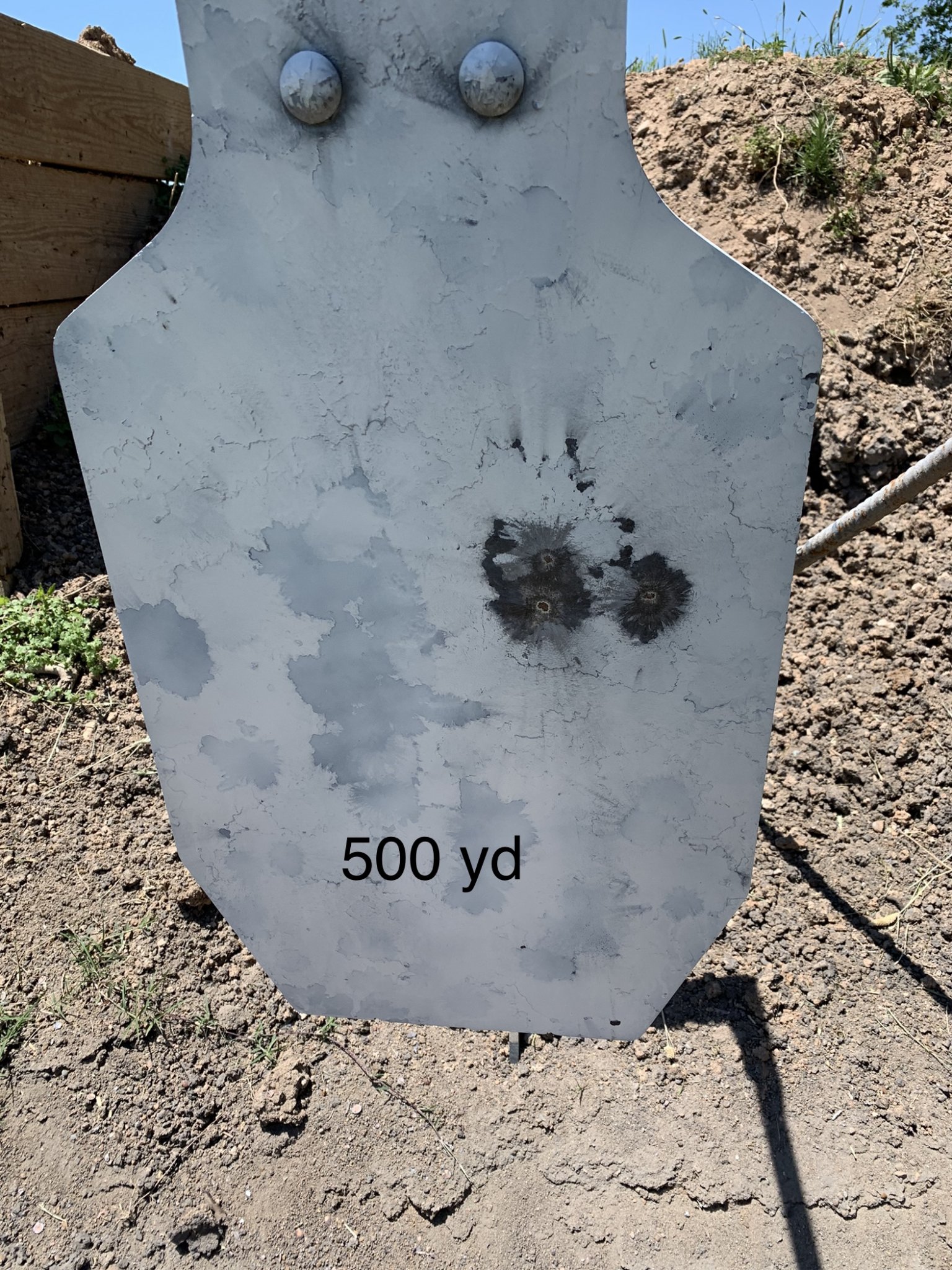

500yd groups were better. Wind mostly stayed calm long enough for me to shoot the 5 shot groups. Caught a few gusts that opened up the groups but still good results. First group 0.676 MOA and second group 0.485 MOA. 4 shots in that second group meausure 0.231 MOA. On a calm day, these these will group nicely at distance.

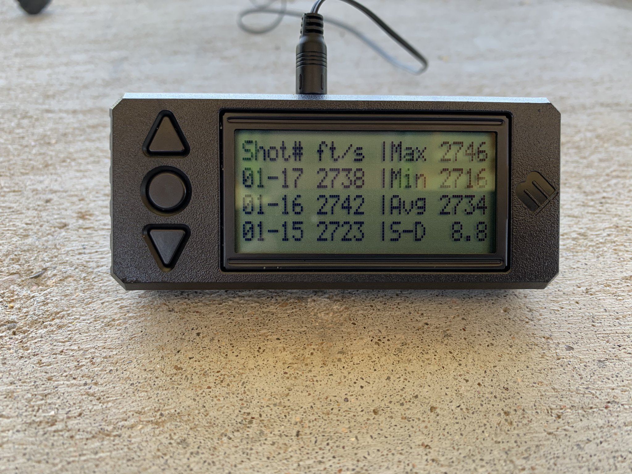

After truing these 169's in my Kestrel, I shot a 5 shot group on an 8" round swinger at 700yd shown below. Wind was pretty consistent when I shot this group, first shot, didnt hold enough wind and just missed off the edge of the plate. Held another .2mil and the next 4 shots grouped about 1.75" CTC (0.238 MOA). 5.3mils elevation @ 700yd.
Also, I loaded 25pc of virgin Peterson .308 Palma brass with the same load as these 169 SMK's to form the brass. I had no idea what my velocity was. Just put in 2715 and trued them at 700yd then shot them at 500 and 300 as well. Dead on exact same elevation as the 169 SMK's....
