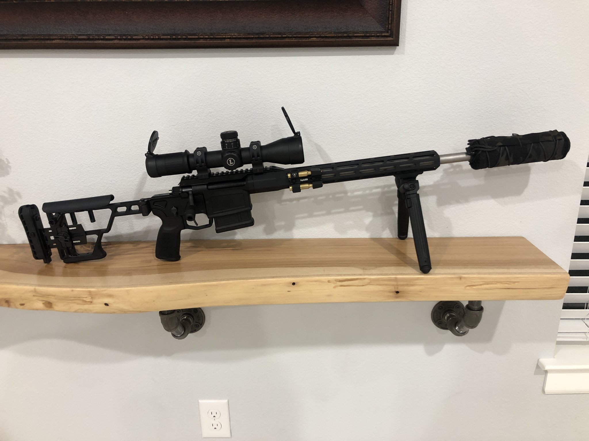

Pretty impressed so far. Picked up on Thursday and put rounds down range yesterday. Only had 10 rounds of factory Hornady 140 ELD's but they went into half-inch and 5/8 inch 5-shot groups. Played around with some home-rolled 123 gr Noslers over Staball 6.5 and had a couple of half inch 3-shot groups (yeah, yeah, I know) at 44.3 grains. Basically just trying to get a feel for the Staball. These were loaded on my 550. Looking forward to playing with that combo some more.
My 140 grain BTSP Sierra/RL17 hunting loads hovered around 3/4 inch.
Folding the stock is an acquired skill but mine is not too difficult after getting a feel for it. The mag release is gonna take a bit of getting used to but I think it makes sense on a hunting rifle.
9 pounds 15 ounces as pictured with optic & suppressor.

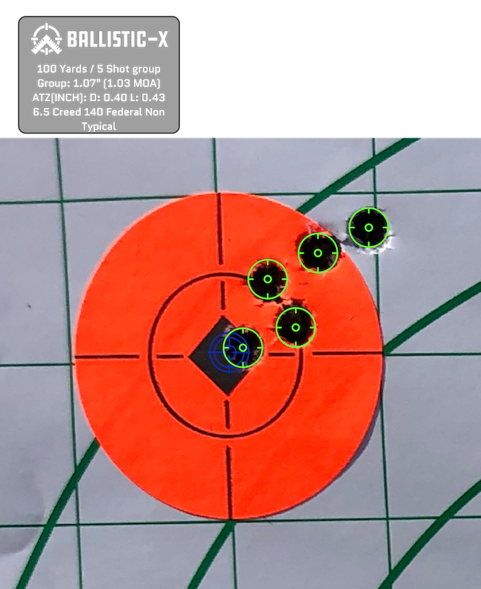

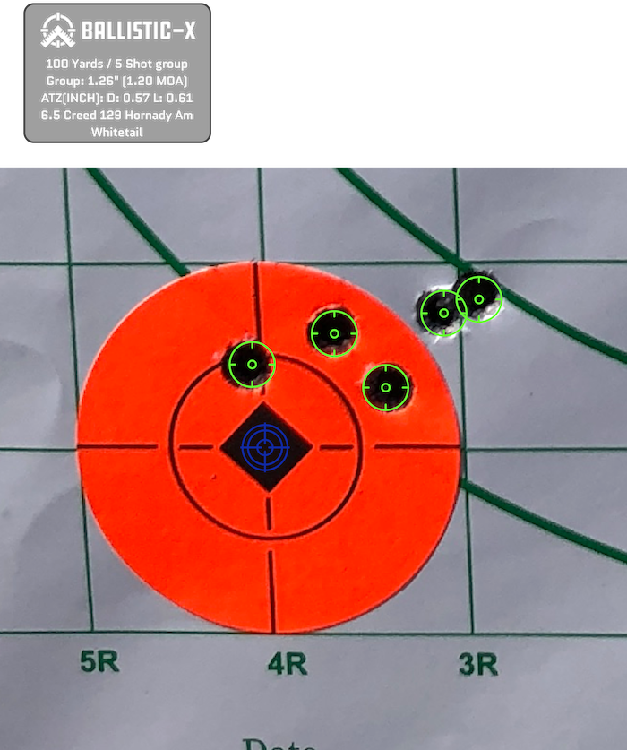

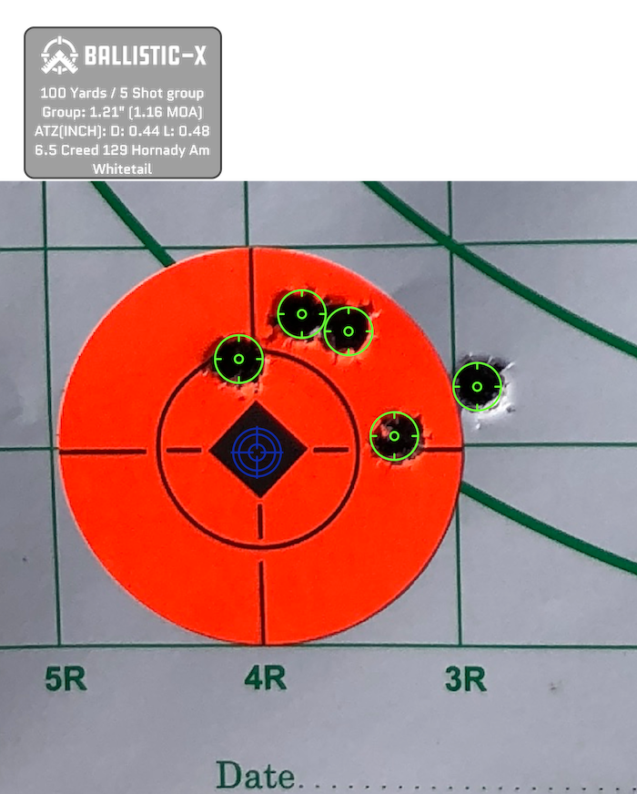

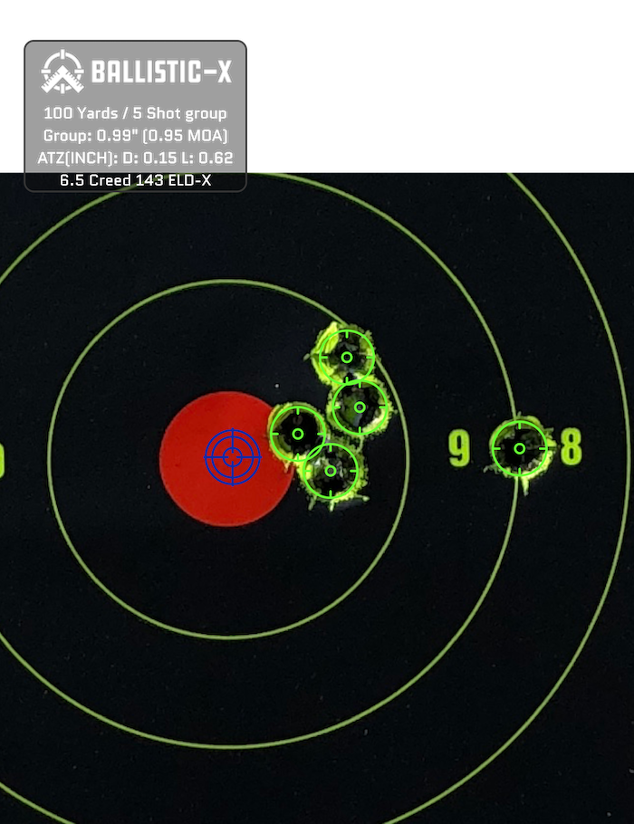

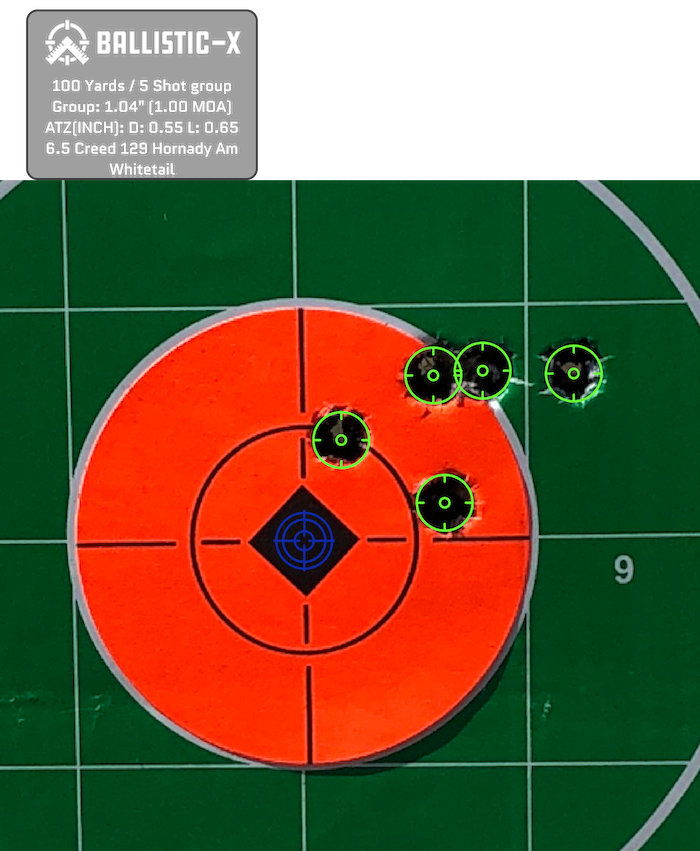

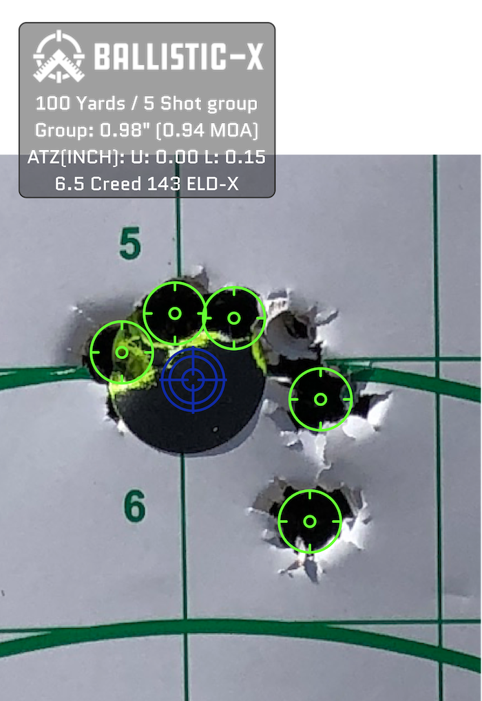

    All set up and hitting the range tomorrow with 143 eld-x, 129 American whitetail and 140 federal non typical. Pretty much everything I could find on the shelf locally.
    Also swapped the low arc rings for the mediums on the Leupold Mark 6, it’s better at this height but I probably could have gotten away with the high rings as I have the cheek comb all the way down currently.
    brazz04
    Feb 10, 2018
    82
    86

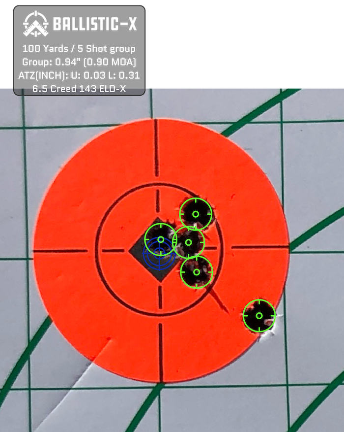

    Ballistic-X-Export-2020-10-10 18:44:24.670882.PNGBallistic-X-Export-2020-10-10 18:48:10.320595.PNGBallistic-X-Export-2020-10-10 18:49:17.133740.PNGBallistic-X-Export-2020-10-10 19:07:20.271370.PNGBallistic-X-Export-2020-10-10 18:54:44.891616.PNGBallistic-X-Export-2020-10-10 18:53:50.440303.PNGBallistic-X-Export-2020-10-10 18:51:28.339582.PNG
    Was able to put 60 rounds trough the rifle today with no issues, the Hornady Precision Hunter 143 ELD-X really shined (if I could have kept from pulling shots). Super happy with the rifle and recoil as it definitely has less than my Remington 700 in 308. Next time I go, I'll take it to 200 and 300 since thats the longest I have available until I can get out to a friends place.
    As an aside, they guy next to me was shooting a factory ruger precision rifle in 6.5 PRC that he told everyone at the range was a "1/3 MOA all day" rifle. He proceeded to shoot one sub MOA group out of the 16 groups he shot. Some people.

    View attachment 7443069View attachment 7443070View attachment 7443071View attachment 7443072View attachment 7443073View attachment 7443074View attachment 7443075
    What—you didn’t have any dimes with you to cover those fliers for the pictures?
    Thanks for the honest and straightforward results.
    brazz04
    Feb 10, 2018
    82
    86
    Ha I did have a guy to my right with a brake on a 18" 308 that made me jump a bit so two groups didn't make the cut because they were truly useless!
