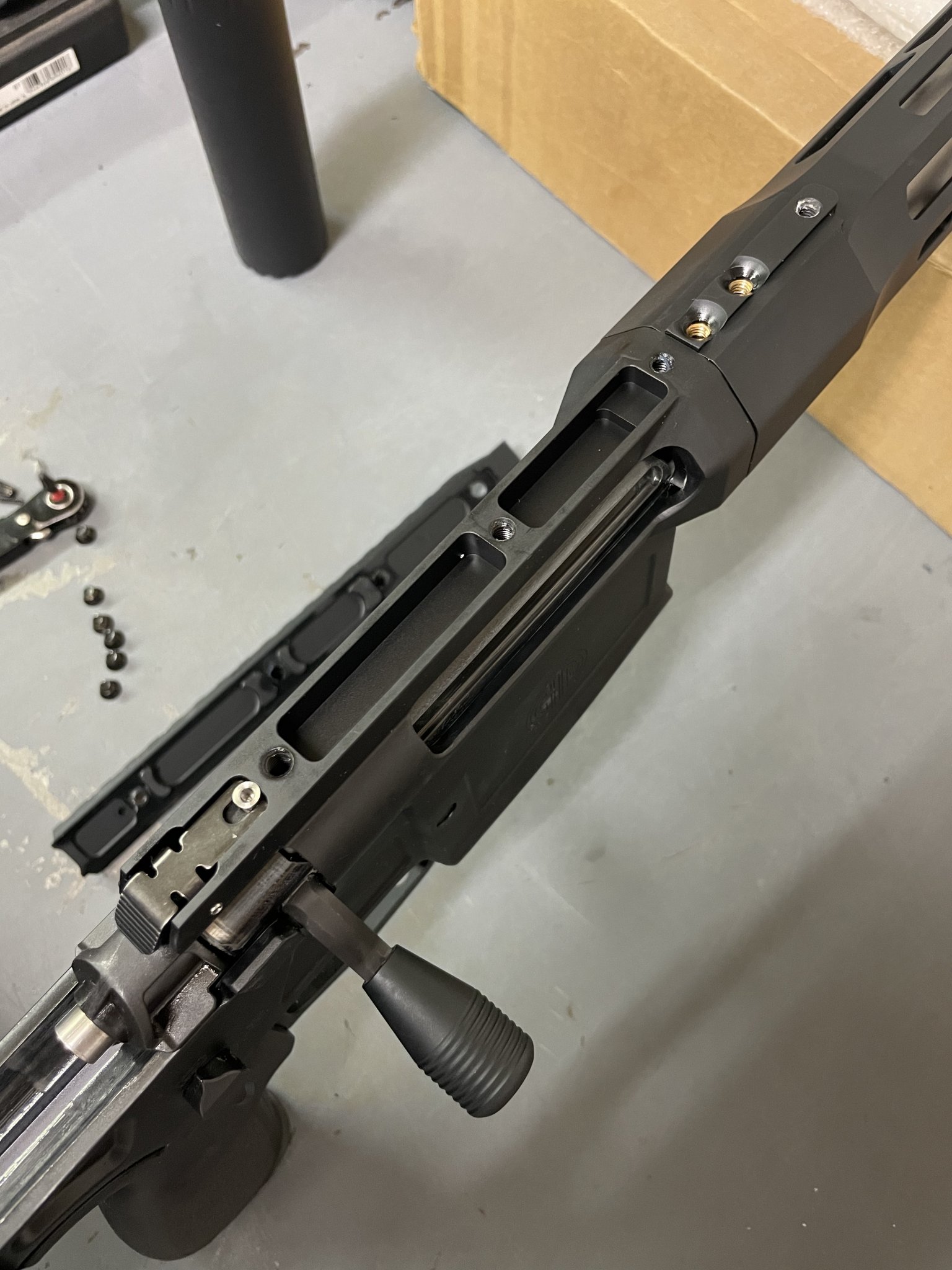

p.s. don’t lose the little bolt catch spring under the scope rail if you take the rail off.

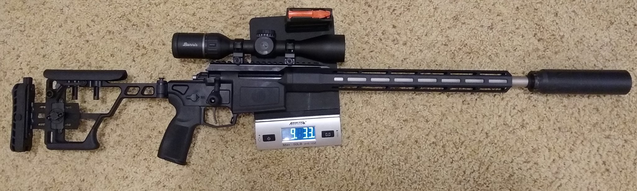

What does everyone's' Cross weigh scoped and fully loaded? I put a 3-15LHT and my suppressor and I am pushing 10lbs. I guess it all adds up, and is lighter than my old rifle all kitted out, but still not ultra light.
9.5 lbs with 3-15LHT, warne cantilever mount, sling (ferro slingster), and suppressor Nomad TI using area 419 hellfire direct thread mount.
Yeah I had just reused a fairly tall ADM mount I had on a chassis rifle I sold. I ordered some lighter rings which should help. That one piece mount was a chunk.
Did you just use a Magpul QD Mlok socket for your sling attachment up front?
That's with my Nomad 30 and a Plan A mount. So about 5.5 oz lighter with my Nomad Ti and Ti plan A type mount ~ 8lb 14 oz.
Pretty light all up for what it is, but a hair over 2 lbs heavier than my Kimber Montana with can, lighter scope and sling.

In an effort to save some weight I just ran the sling through the handguard and stock using the trislides. At work now, I'll try and post a pic later.
