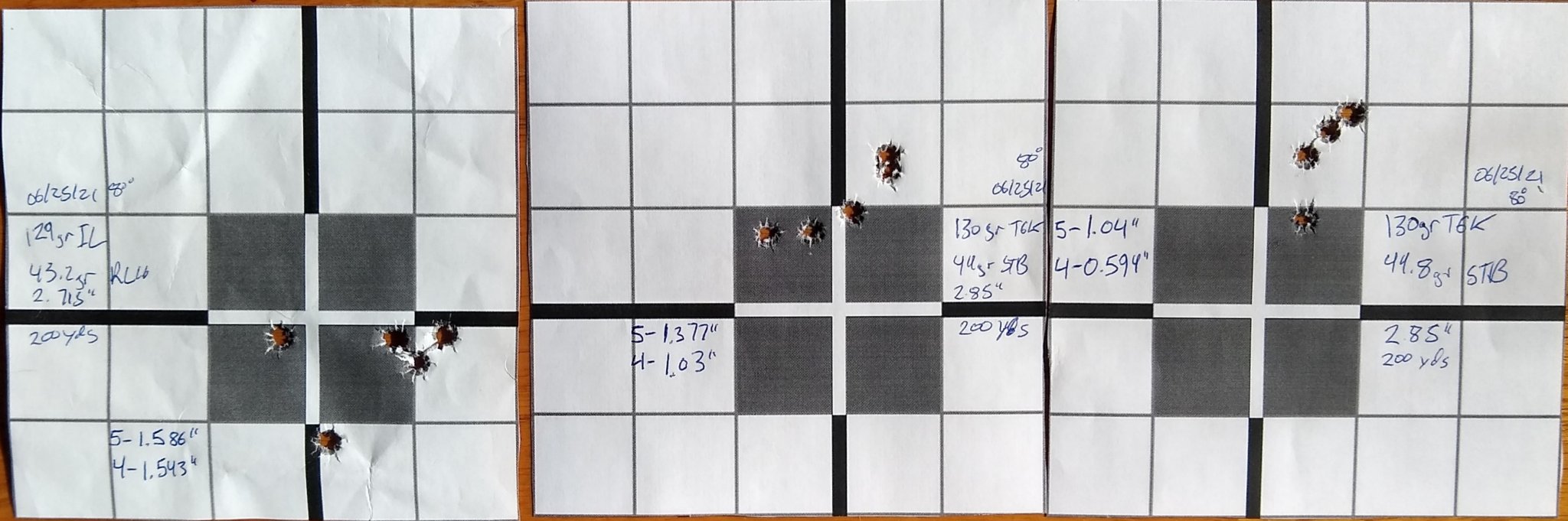

Did some initial load development with my 6.5 using the 123 and 109 absolute hammer solids and IMR 4064. Looks like I have a node at 2880 with the 123s (40gr of IMR 4064) and a node at 3050 with the 109s (41.6 grains of IMR 4064). Gotta narrow in on those two spots and see how wide the nodes are and then I'll true the BC on both bullets.

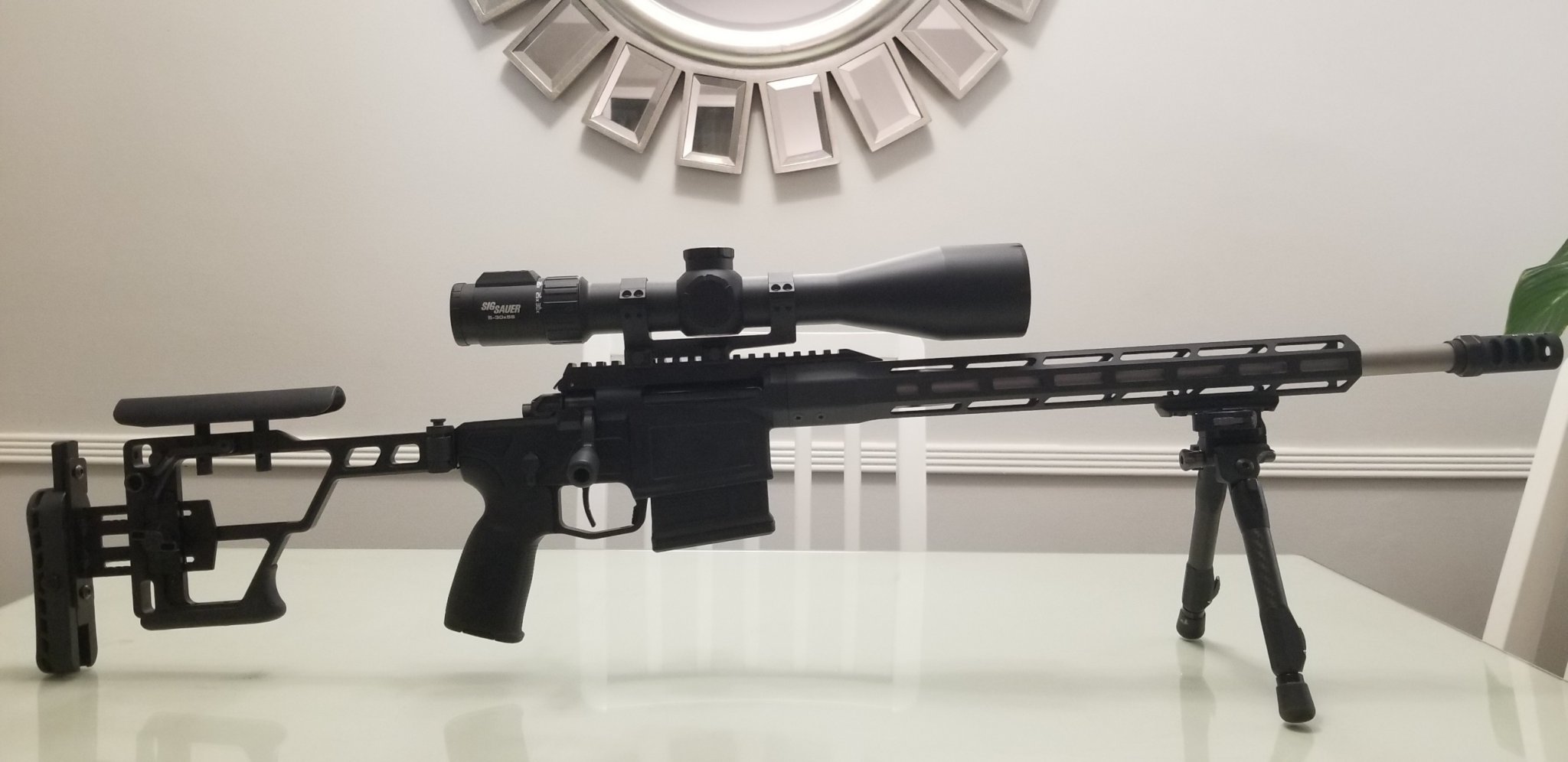

Sharing so no one else has this problem with their cross. I picked up a Sig Sierra6BDX 5-30 x56 scope nd was advised by Sig to use the Alpha 2 ring mount with a 20 MOA offset. I had it gunsmith mount it because i wanted it to be perfect but he mentioned that the gun will shoot 8 inches high at 100 yards with the vertical adjustment maxed out. This doesn't work because it would shoot out o like 300 yards before the radicle would pair up with the shot placement. The BDX should be zeroed at 100 or 200 yards IMO because this is going to be my hunting rifle. and need that close up option for hunting. Long story short... Sig is sending me the correct mount with no offset but this will cost me the gunsmith fee again. All good... live and learn but didn't want any of you to go through the same. ohh and for yall that think i am over scoped, I am... but i want to eventually use this rifle for with the 277 sig fury and also wanted to have the option to zoom way in for identification or glassing purposes.
Cross 6.5, APA little bastard muzzle break, Tier-one Tactical Carbon Bipod from the UK
Sharing so no one else has this problem with their cross. I picked up a Sig Sierra6BDX 5-30 x56 scope nd was advised by Sig to use the Alpha 2 ring mount with a 20mm offset. I had it gunsmith mount it because i wanted it to be perfect but he mentioned that the gun will shoot 8 inches high at 100 yards with the vertical adjustment maxed out. This doesn't work because it would shoot out o like 300 yards before the radicle would pair up with the shot placement. The BDX should be zeroed at 100 or 200 yards IMO because this is going to be my hunting rifle. and need that close up option for hunting. Long story short... Sig is sending me the correct mount with no offset but this will cost me the gunsmith fee again. All good... live and learn but didn't want any of you to go through the same. ohh and for yall that think i am over scoped, I am... but i want to eventually use this rifle for with the 277 sig fury and also wanted to have the option to zoom way in for identification or glassing purposes.View attachment 7680294

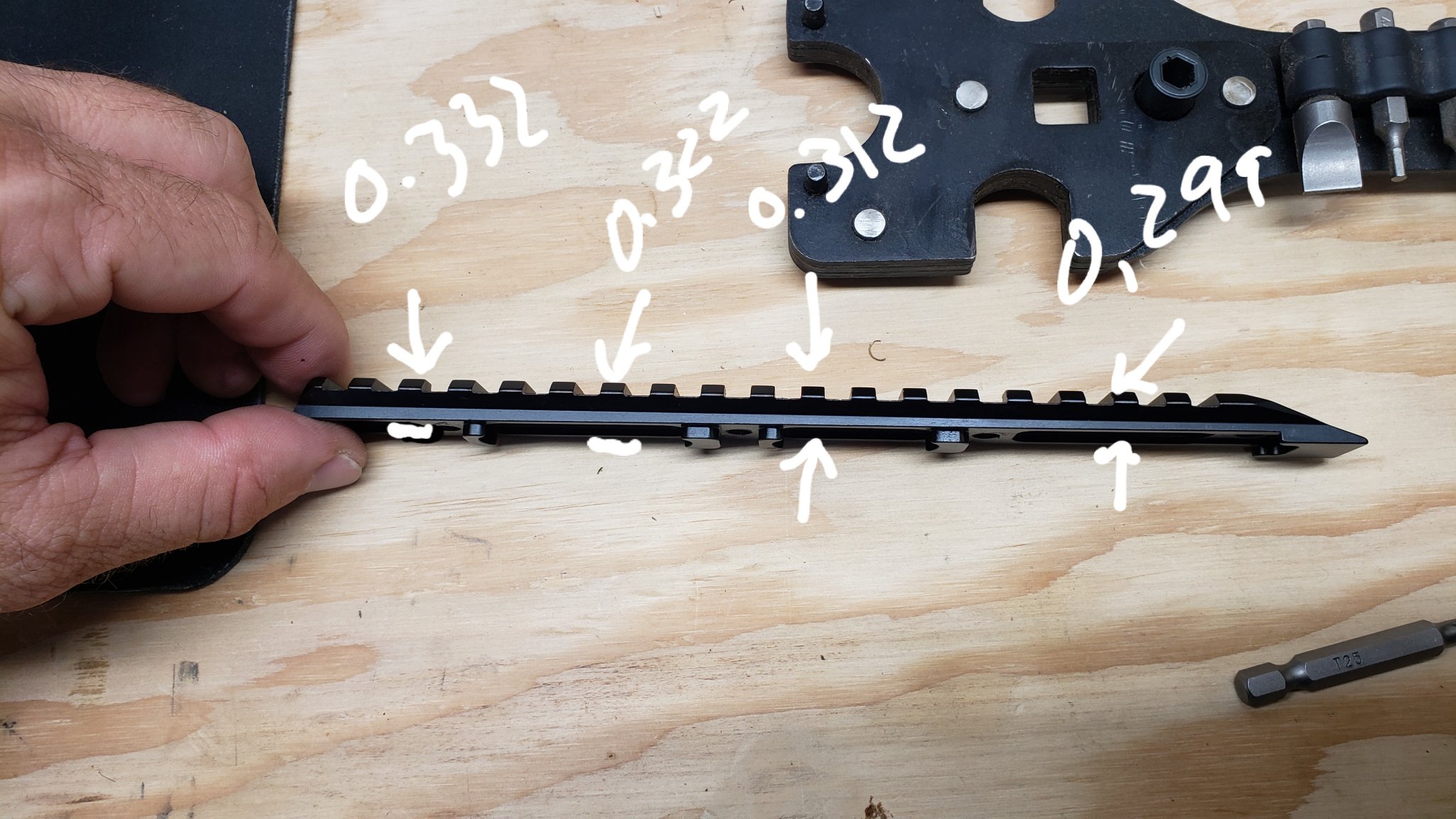

I'm a little confused by this post. Do you mean 20 MOA offset and not 20 mm? Also, why would the gun shoot 8inches high at 100 if you zero at 100?
good catch.. Yes 20 MOA. i fixed it to reflect the edit. I could not get the radicle up high enough to match the bullet hole at 100. the scope was maxed out with no additional adjustment. Other words, it wont work for a 100 or a 200 yard zero.
Does the sig cross's rail have 20 MOA built into it already? Something ain't right if you can't even zero at 200 yds without maxxing the adjustment.
not sure if the rifle comes with the offset already. I agree. this scope should have enough adjustment to account for 20MOA but it didn't and the gunsmith confirmed it when he barrel sighted it.
just spoke to the gunsmith. He confirmed that the Cross already has a 20 MOA pic rail from the factory. It all makes sense now. FML
Interesting, because the cross is suppose to come with a 0 MOA rail. If you go to their web site, a 20 MOA rail isn’t listed as an available option yet.
I checked my rifle rail this morning and it does seem like there is a measurable bias in thickness. I was eye balling it with a pair of calipers.
I didn’t remove the scope or rail for the measurement. But yeah something like a .020” delta, depending on mount spacing that could translate to 20 MOA.

I just pulled my rail and it is 100% a 20 MOA.
That explains my inability to zero when I put a 20 moa mount on it.
