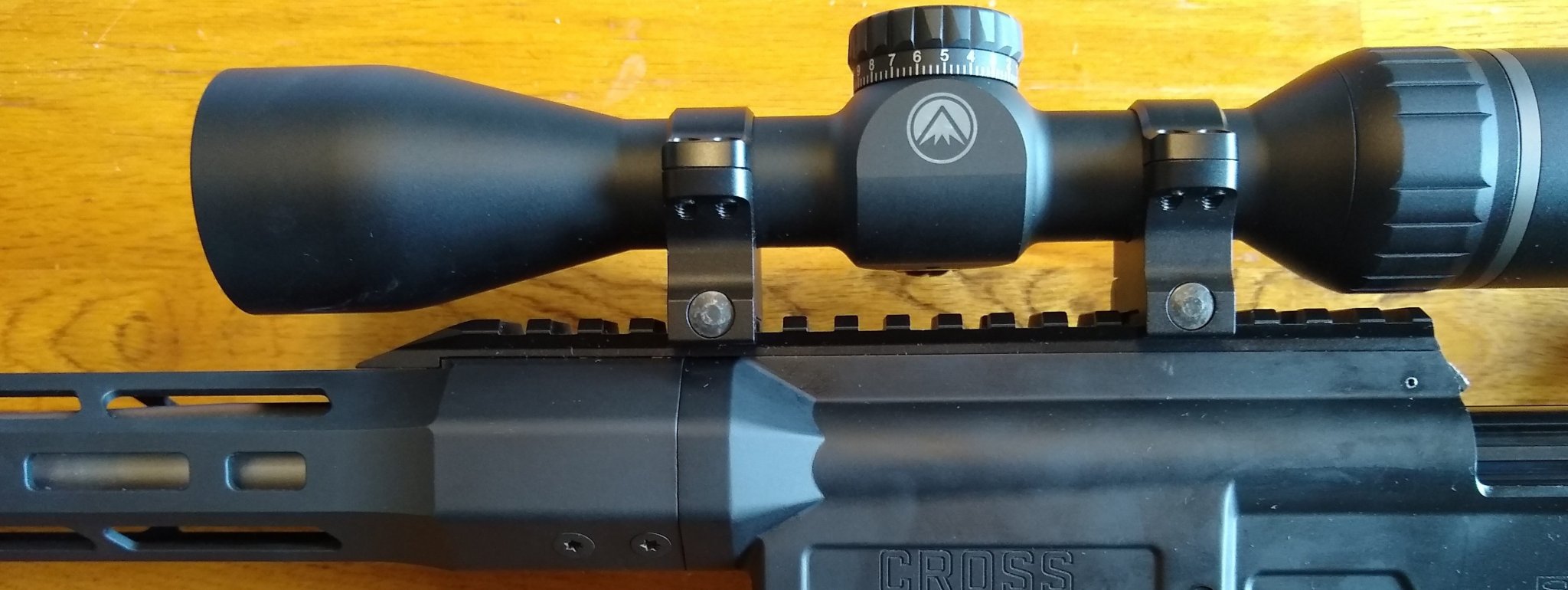

What height rings are you boys running with 30mm tube and 50mm objectives?
I’m currently running a Sierra 6 3-18x44 in a set of High Vortex rings. I’ve also mounted it in medium Sig rings and had all the clearance I needed. I think high rings would be a safe bet for a 30mm/50 setup.
Reactions: Bluedog82
If you look at post #2322, those are Athlon medium height rings with a 34mm body/56mm objective. The ring height is 1.069" and there's maybe 3mm in between the front objective and the hand guard. Conversely, I've run a Scalarworks LEAP with the 1.57" height with a 30mm tube/50mm objective and there was plenty of clearance. Something around 1" or greater would work.
Here's what I finally ended up with. I used 3M spray adhesive on the inner side of the rings instead of rosin and torqued everything down to specification. I moved the front back to the railing over the upper receiver and then moved the rear ring back a bit more. Hoping it's good to go and won't move on me again.

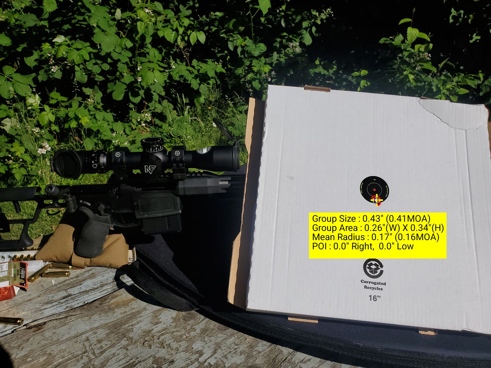

Went back out today with a clean barrel and yep, she's a sub-MOA rifle. Did nothing more than clean the carbon. I didn't do any copper cleaning. As of today, I probably have a bit over 100 rounds through it.
I brought two loads I developed for my AR10 and both did quite well when I did my part. The first load was a standard Hornady 150 grain "plinker" load that just happens to shoot really, really well at 100 yards. Second was a Nosler 155 custom competition. Didn't do bad, a bit hotter load than the Hornady 150 grain but loaded them early on in my loading career. I can do better but thought I'd use them up. Had an SD of 23.3 with an average velocity of 2644 over 20 rounds. Last shot, which sat in the chamber for a bit, threw it off with a 2699 velocity.

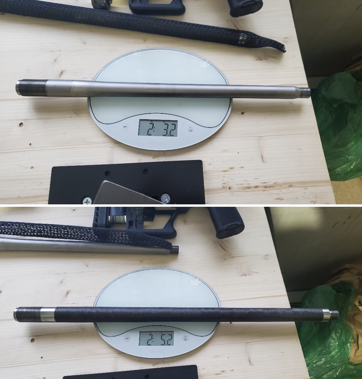

Does anyone have the actual weight of the cross with a carbon barrel? Either in 6.5 or 308? Is it even possible to get the rifle under 6lbs?
If you don’t mind having a 4” barrel probably!

I don't recall if the published weight of 6.5 pounds for the 308 version is dead on or not, but the factory barrel profile isn't super light. I wouldn't be surprised at all if you could recontour it and shave half a pound.
I believe the 20" carbon barrel in 308 reduces the weight by about 1/4 of a pound. I do know they'll produce other lengths, shorter lengths, which would help reduce weight. Other than that, it's going to get expensive to remove any real weight and they'd all be one-off items (other than say a Smoke carbon grip) since no one seems to be making lightweight anything for the Cross (not even Sig!).
So my 308 cross weighs 6.9lbs with the empty mag and the muzzle break for my can. Add 2+ pounds for the scope and mount and it comes in over 9lbs. I would like to shave it down a little bit if posible. Carbon barrel seems like the easiest option but I am not sure if there is enough of a difference to make it worth it?
I don't think the carbon barrel is going to save that much over the factory barrel. The factory barrel isn't that heavy of a profile to start. I would be nice if someone was able to weight their factory barrel for us.
See post above yours. I'm just waiting for my carbon barrel to come back from CarbonSix and have it installed. Hoping any day now.
Reactions: jafo96
I may have my rifle back tomorrow with the carbon barrel swapped in. Waiting to hear back from the gunsmith tomorrow and I'll fill everyone in with the issue I had. Was a Sig tolerance issue (shocker).
-ON MY SCALE, the original Sig barrel weighed 2.22 pounds with the shoulder bushing and thread protector on.
-The Sig Cross, in 308, with the Schnee's 20" carbon barrel and a HUXWRX (OSS) muzzle brake weighed just over 7 pounds (like 7.03).
-The Cross with all of the above and a Athlon Cronus BTR II weighed in at 9.7 pounds.
-My scale is a cheap POS digital scale so it's not pinpoint accurate by any stretch but it's decently close.
It'd almost certainly be more than with the factory barrel.
I don't understand why people think carbon barrels are lighter. They're only lighter than a steel of the same contour, which most steel barrels are not. A thin steel barrel is lighter than any carbon.
going from the 16" 308 barrel to a 20" sendero contour carbon barrel, here is the weight difference. Not a huge difference, for 4" more length and a heavier profile.
