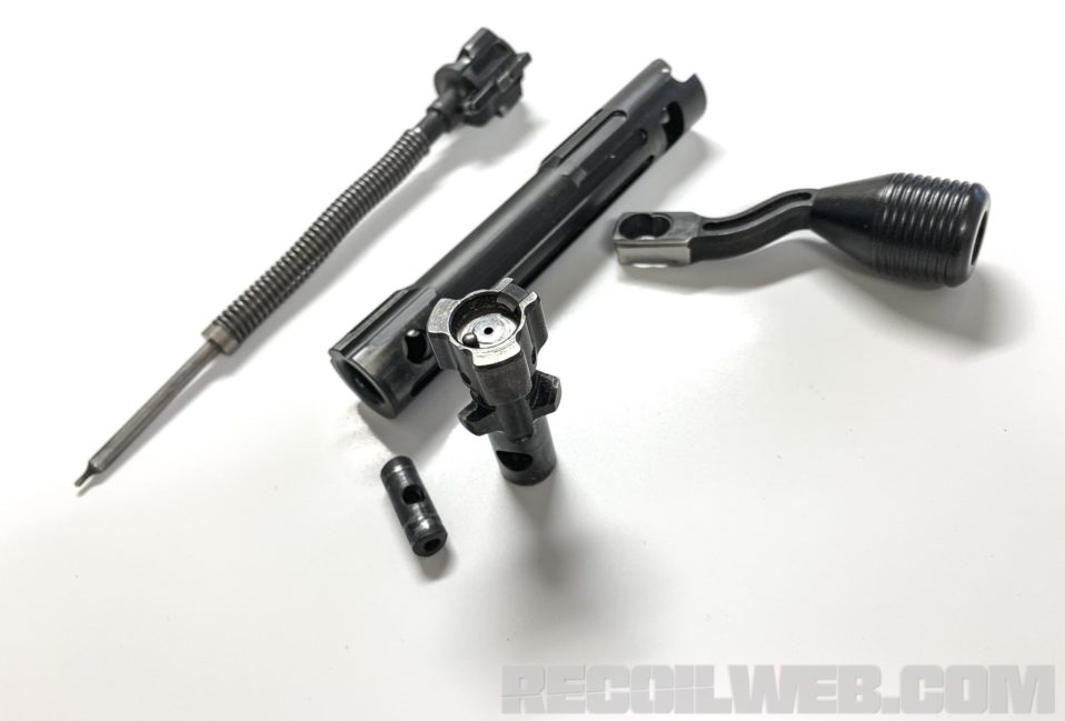

The thing is, other than it looking a little similar and the action/magbox being one piece that the barrel and hand guard mount to, it's really not a copy.
Looking at the action from the very non detailed pics I've seen it's a standard bolt gun other than that. I don't see how it can have the sear in the bolt like the Q does (which is a great design) so it most likely uses a standard style trigger, extraction and camming aren't going to be like the Q rifle, and I'd venture to say it has a typical 3 lug bolt design too.
There's a lot more that goes into the Fix than people realize that make it a truly great and unique bolt gun. People can call it a copy, or whatever, but it's really not, and I don't see it coming close to a Fix in any way.

Speaking of copying, Q also copied the Denel NTW20 primary extraction method in the Q Fix, they just put the impingement on the bolt shroud instead of on the receiver and they're trying to patent that too. We'll see if they bother to tell the patent office about that one. The trigger counterweight is copied from the HK MSG90/PSG1. Clear anodizing has been used on firearms since at least the 1960s.
